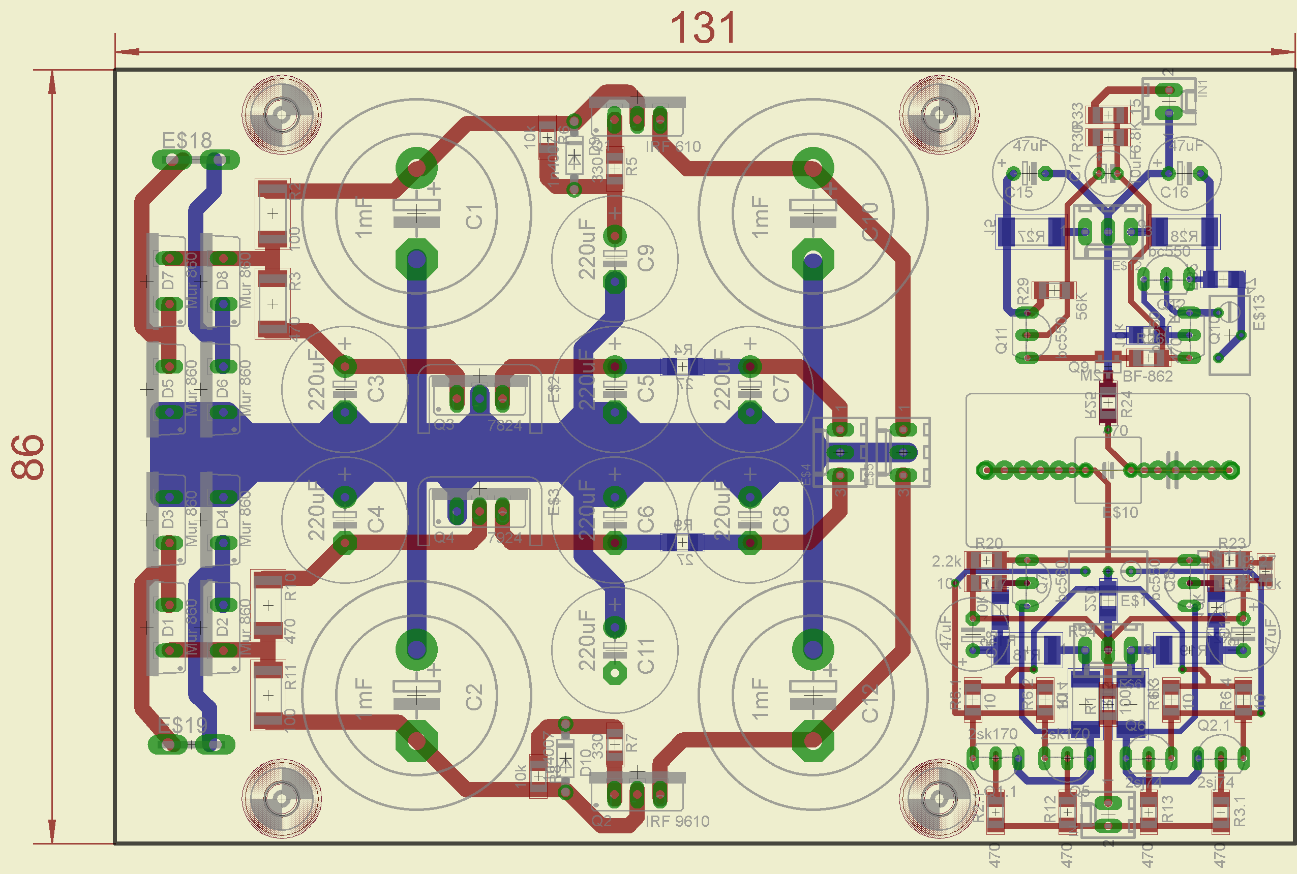

Updated schematic with changes to few errors. If anyone wants to put a second set of eyes on these, it would be much appreciated.

Hi juma,
Just new to this thread and on post #66, you have a power supply diagram that has 4 x 220uF electro caps in series with the secondary windings, before the diodes (double bridges) - could you possibly expand on this a bit, as I've not seen this before and quite puzzled about the use of them.
I use 4,700uF electros for mains supply 'dc traps', but puzzled about the 220uF ones.
Actually, voltage is not being doubled in that PSU (post #66) - it's just the same secondary (~36V CT) being used twice (through C1-C4) to create positive and negative rail (re. to CT=GND) out of the same voltage source.
Have in mind that reactive resistance of the capacitor (Xc) is reversely proportional to its capacity and frequency of the AC voltage, so where higher current is needed use larger value caps.
Sorry juma, having a 'brain fade' here!
The supply obvious works quite well (working version) but I'm a bit puzzled at the inclusion of the caps C1 - 4 between the secondary winding and the diode bridge - please excuse the dumb question, it is Xmas eve ....
If the +33 volt rail (for example) is supplying 50mA to the circuit, there's a voltage loss of about 4.5 volts across the IRF610 fet C multiplier, and another 5 volts across the 100R resistor, so raw supply has to be about 43 volts out of the diodes, if I've got this far okay?
So, if the full bridge produces somewhere near 48 volts from the 36 volt secondary (?), minus 1 volt (maybe) across the bridge, then where does the missing 5 volts go?
...where does the missing 5 volts go?
There's a nice Christmas mystery for you to solve - build it, test it. It won't cost you much and is a lot of fun! 😉
Those are approximate values. It depends on parts you use - not all 10VA/~36V CT transformers behave the same way under load. Diodes and caps too. Maybe you'll have to use 150R instead of 100R. Those things are trivial - with little effort you should be able to adjust such a circuit to your needs, no matter what specific parts you got...
