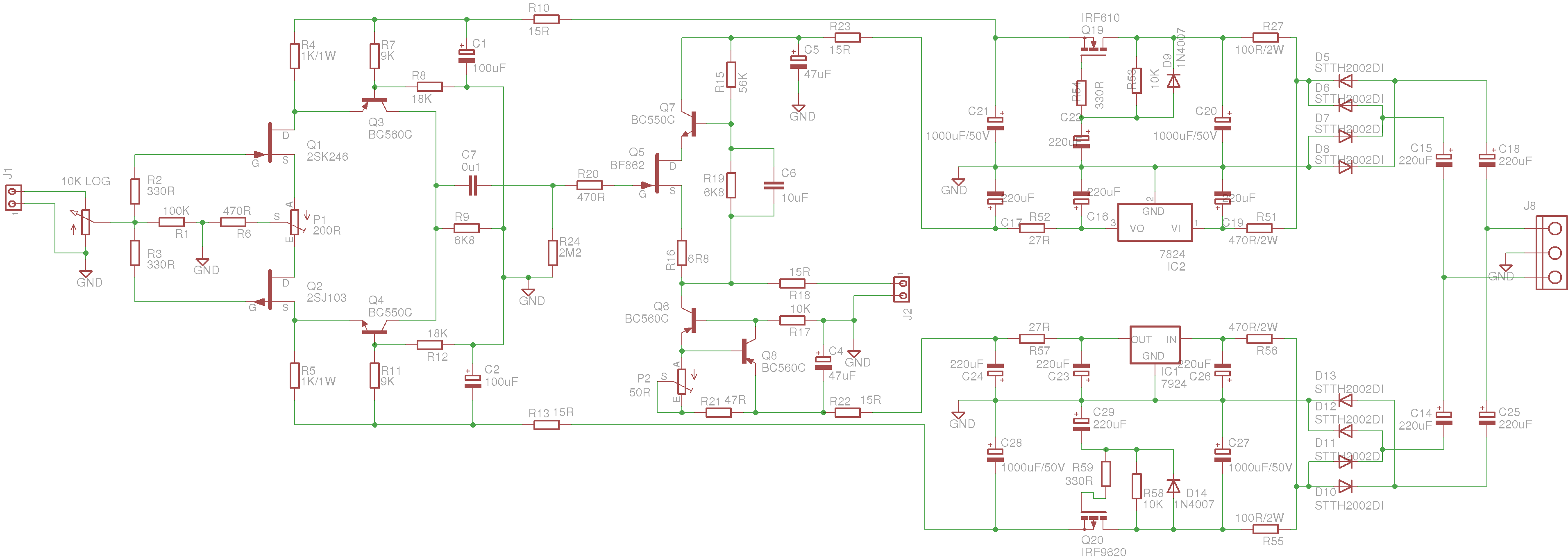

One more thing - I forgot to post the version with k246/j103. The buffer on the output is obligatory here.
I'd like to build version with k246/j103. I'd like to know the following:
1. Does both R9 and R24 are required?
2. How big heatsinks is recommened for 78/79xx and mosfets?
3. Is it good enough to use one power supply or one per channel is recommended here (not to say obligatory)?
4. I put C6 as film instead of elco. It that ok?
Many thanks.

prasimix,
watch your q6,q8
Huh, "copy&paste" error. Here is new schematic with two channel and single PS. First version of PCB single layer (no jumpers required) if finished. If this layout is correct I can also make version with single channel if someone find that interesting.
Maybe everything is too small and I put very small heatsink on 78/79 to spare some space.
Thanks in advance for comments and suggestions.

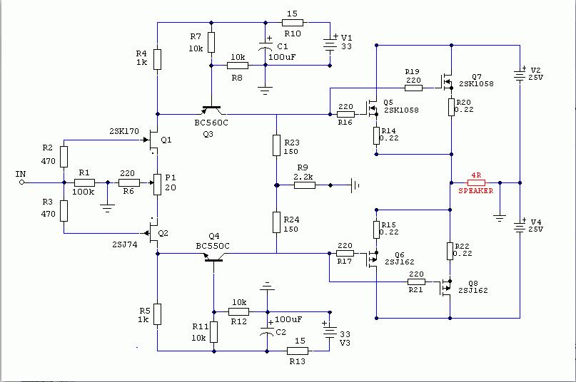

Hi Juma,
Thanks a lot for the great bjt cascode version implementation of the PASS BAF2013 LSK preamp.
I came up with an idea and hope that you do not mind my using photoshop to merge several of your schematics of LSK Preamp, F5 meets Buzquito and addition of 2x150R at (R23 & R24) for an integrated with no global NFB. Any comments or suggestions for a build with sk/sj pair at idss about 10ma?
Thanks in advance.
indra, are you going test it ?
any reason not to try configuration, but with irfp240/9240 as output fet, in conjunction with higher pre rails and r9,23,24, changed for proper bias and gain?
...though input jfets might not like higher rails that much...
