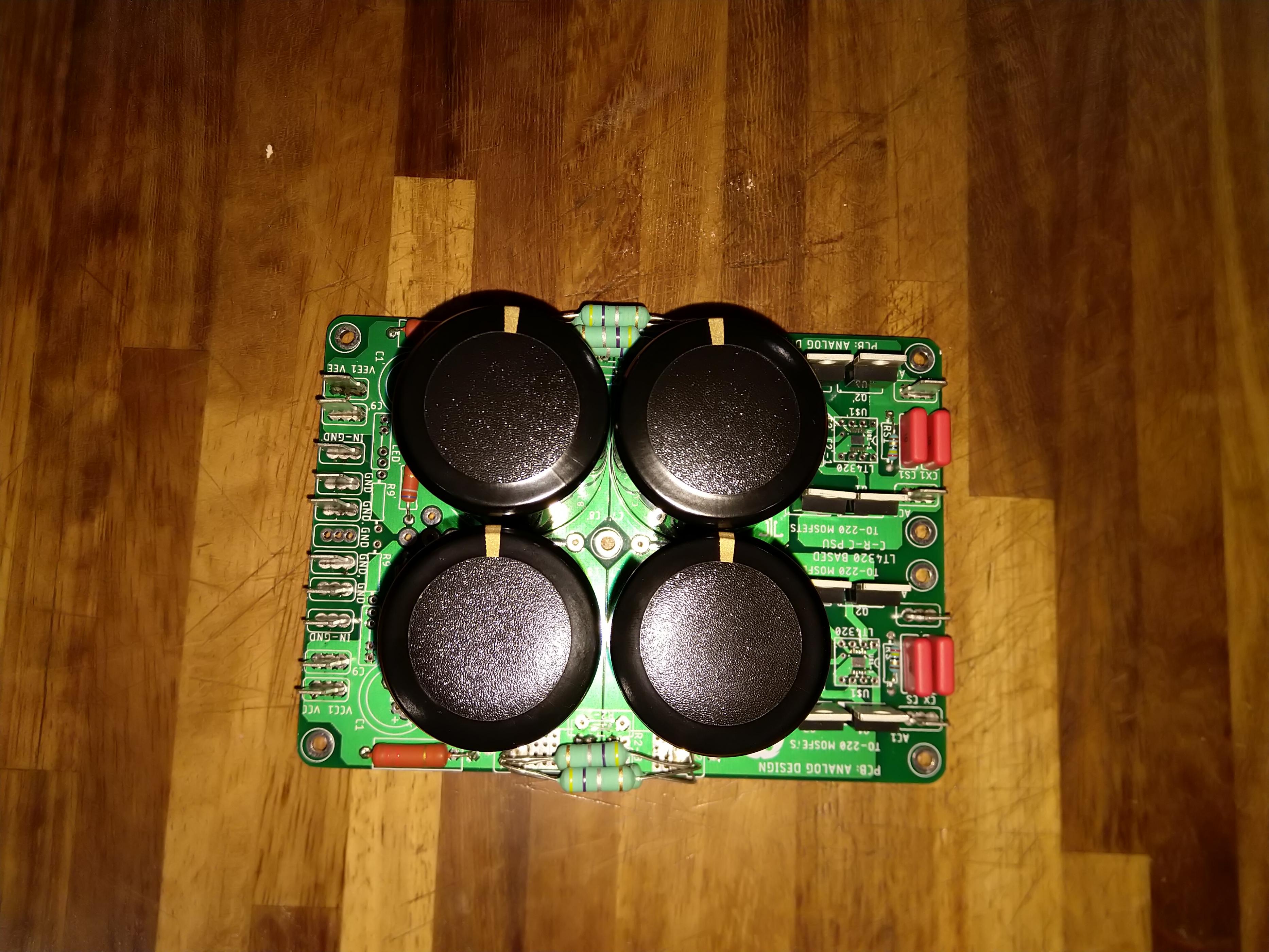

\A couple of pics of the boards to see if everything looks ok? Minus the LT4320's as I can't mount them until I get the correct DIL sockets.
Make sure your FET's are soldered well; that the thru hole is filled by soldier. It's a lot of current draw with the thru hole plating.
My two cents.

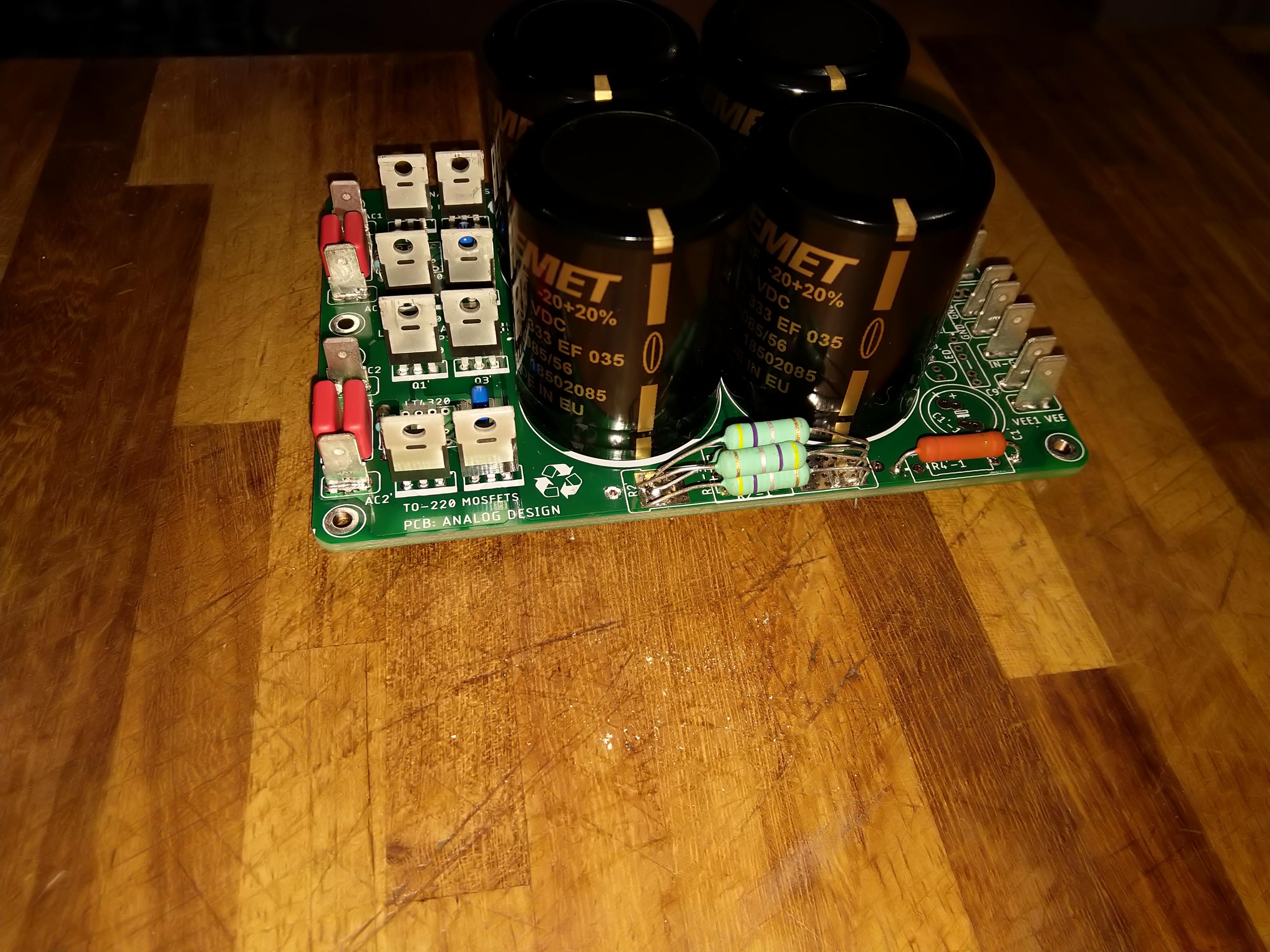

Just about to stuff my CRC PCB's but I managed to order the wrong DIL socket so will have to wait for some more
A couple of quick questions from a noob though! What is the purpose of C1, C9 and R9? Are these all optional?
Hello mpa,
nicely done.
C1 is a small electrolytic about 220uf, that would help reduce inductance. suggested by a kind member.
C9/R9 is an output snubber.
You have the DIP package part - 584-LT4320HN8-1#PBF?
Wouldn't it be possible to directly solder that through hole part onto the PCB? Or that is not advised?
