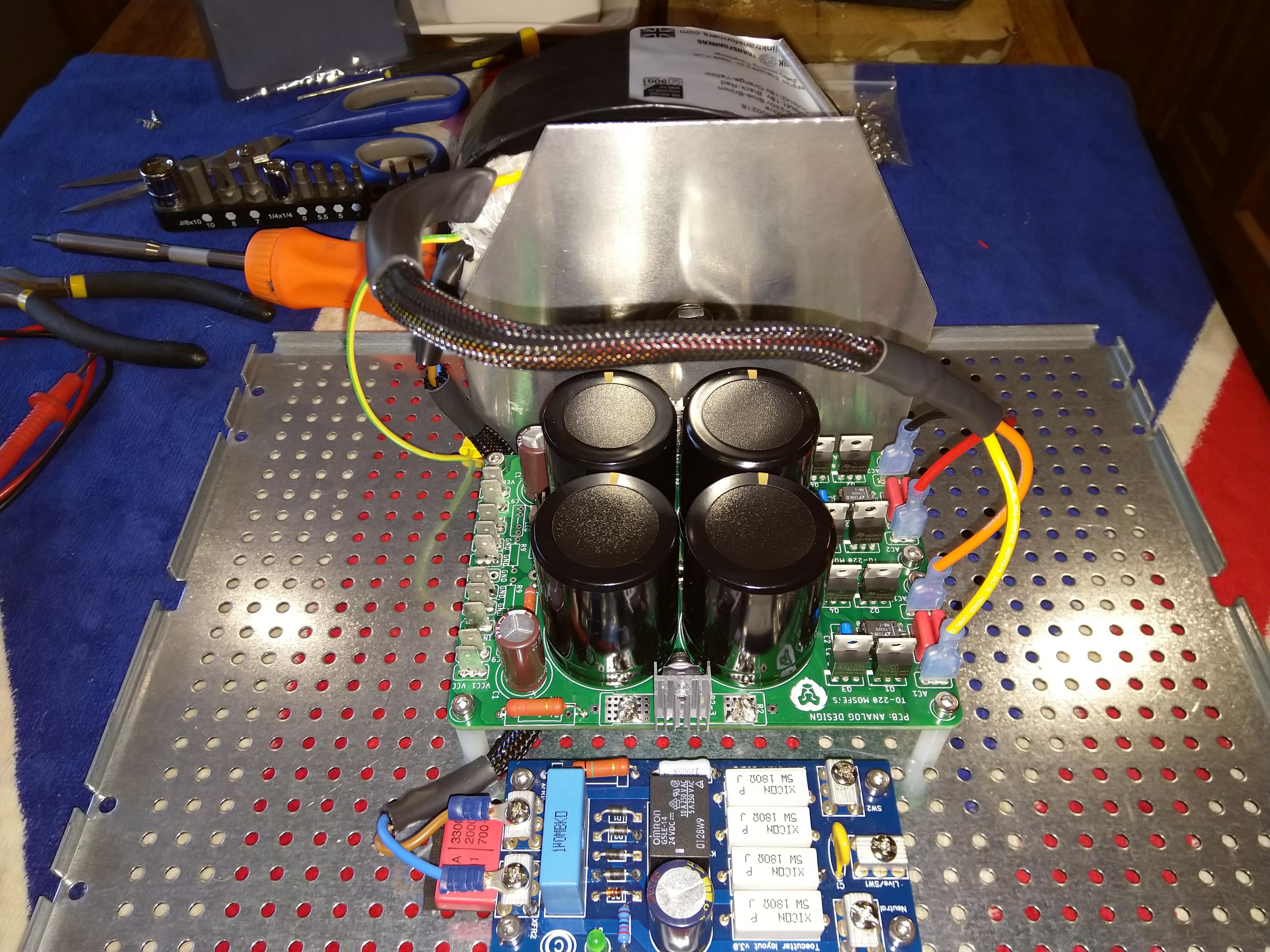

All assembled and mounted in 4u chassis, delivering a constant 26v (with no load). Just got the Aleph J boards to assemble and test now!
Nice work mpa!
Would you please share the following:
1. Your transformer secondary voltage ratings in VAC
2. Primary (input) voltage spec
3. Mains voltage (if you have measured)
