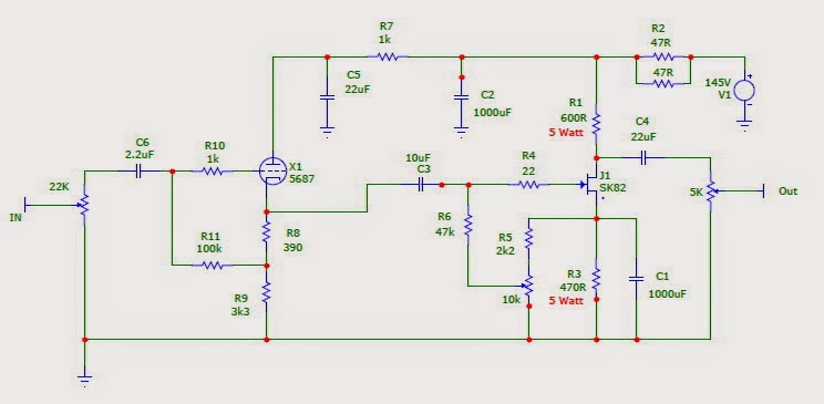

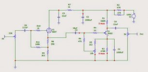

this different approach seems interesting, replace buffer transistor with tube
Yes that would be interesting.
But I will try the original taste first.
Here's a little secret: I chose that particular topology on the buffer so I could try a 2SK79 in that spot, but knowing there weren't many available for diy, I made it so the depletion MOSFET would work just by changing resistor values. And that's why the odd choice, and not the garden variety 2SK170 circuit.
Now you know...the rest of the story.
