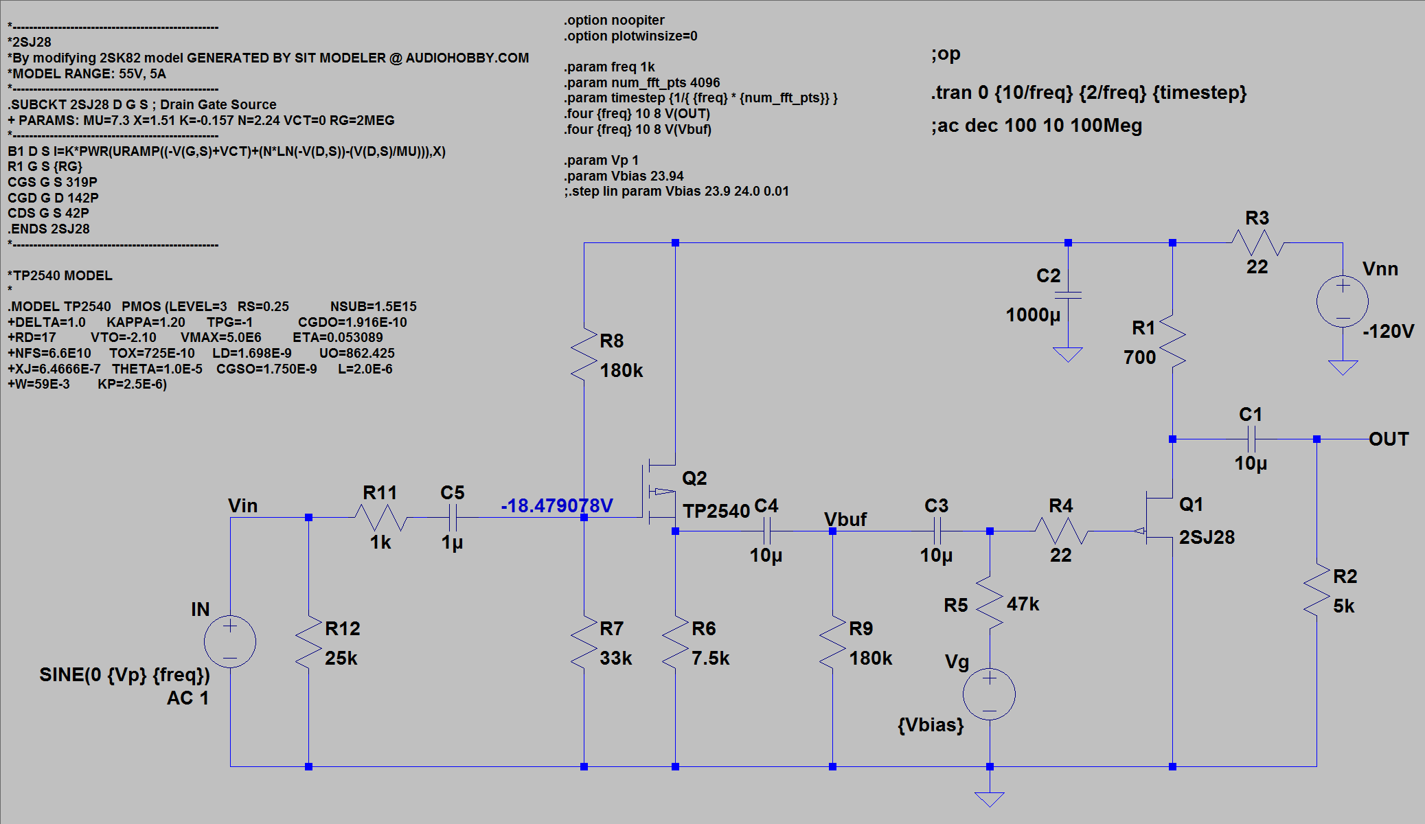

I'm sure the J28 would work. Conceptually, you'd just change all the pluses to minuses and vice versa. Practically, a little experimentation would be needed to find the sweet spot. Fixed bias would make that easier.
I did a simulation with 2SJ28 to see it's operation, but I encountered a problem when I tried - I cannot find any depletion mode P-MOS, or small signal P-JFET which can support such high voltage, so I cannot make a P-channel version of the original buffer, with self bias and bootstrapping. To complete the simulation I just put a basic source follower as buffer, it worked but I'm not sure that's a good sounding buffer.
@Michael, what sort of buffer you would recommend for a P-channel LuminAria ?
Thanks and regards.

@Michael, what sort of buffer you would recommend for a P-channel LuminAria?
You could do a P JFET buffer such as B1 or simpler.
But, I'm also struck by the possibility of using a bi-polar supply and using an N buffer with a P SIT to see if some extra cancellation might be achieved.

... But, I'm also struck by the possibility of using a bi-polar supply and using an N buffer with a P SIT to see if some extra cancellation might be achieved.
That's interesting, and since I'll have a positive supply for the bias to the P-SIT anyway, I may as well use it for 2 BF862 in a B1 manner.
