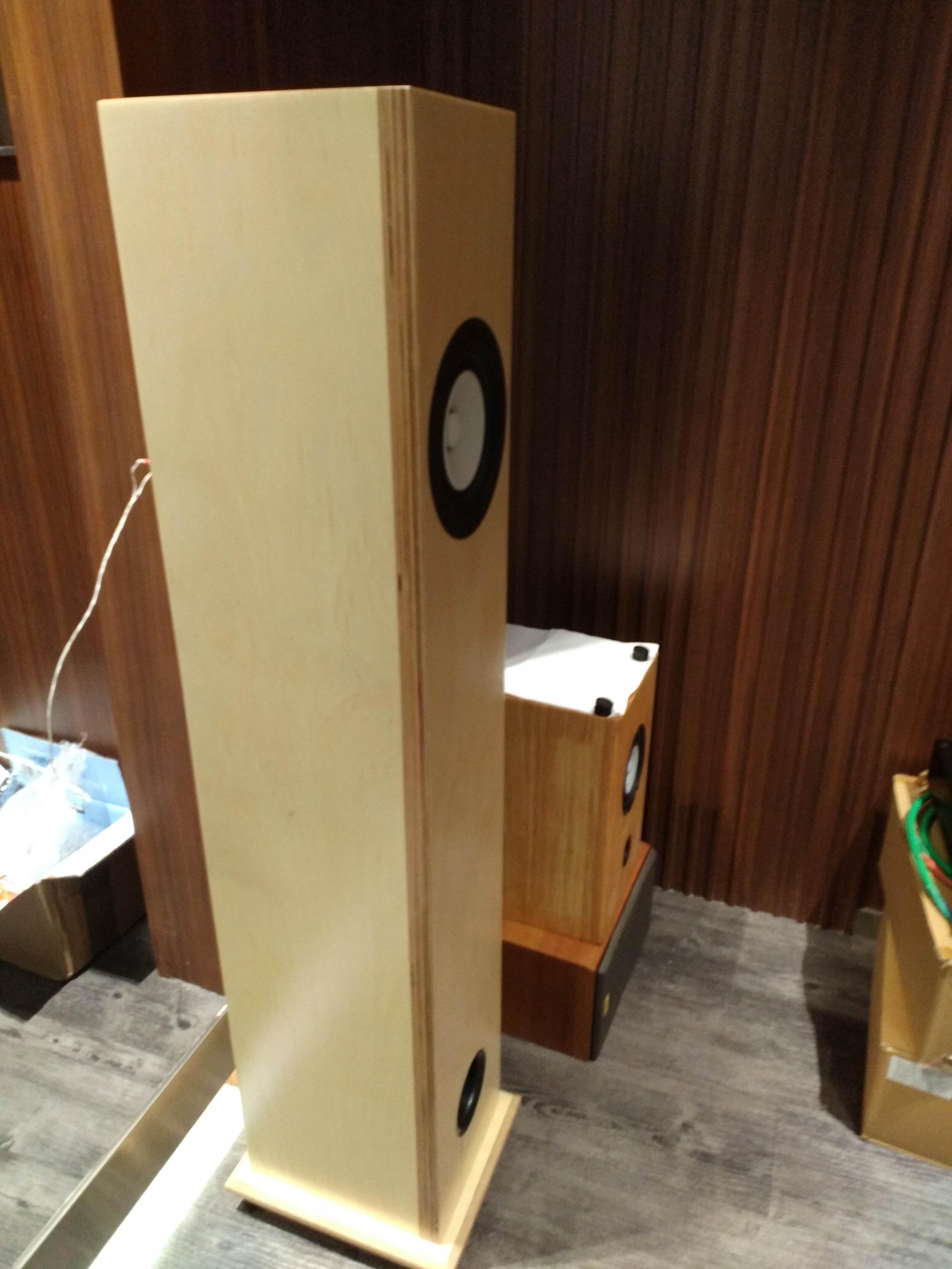

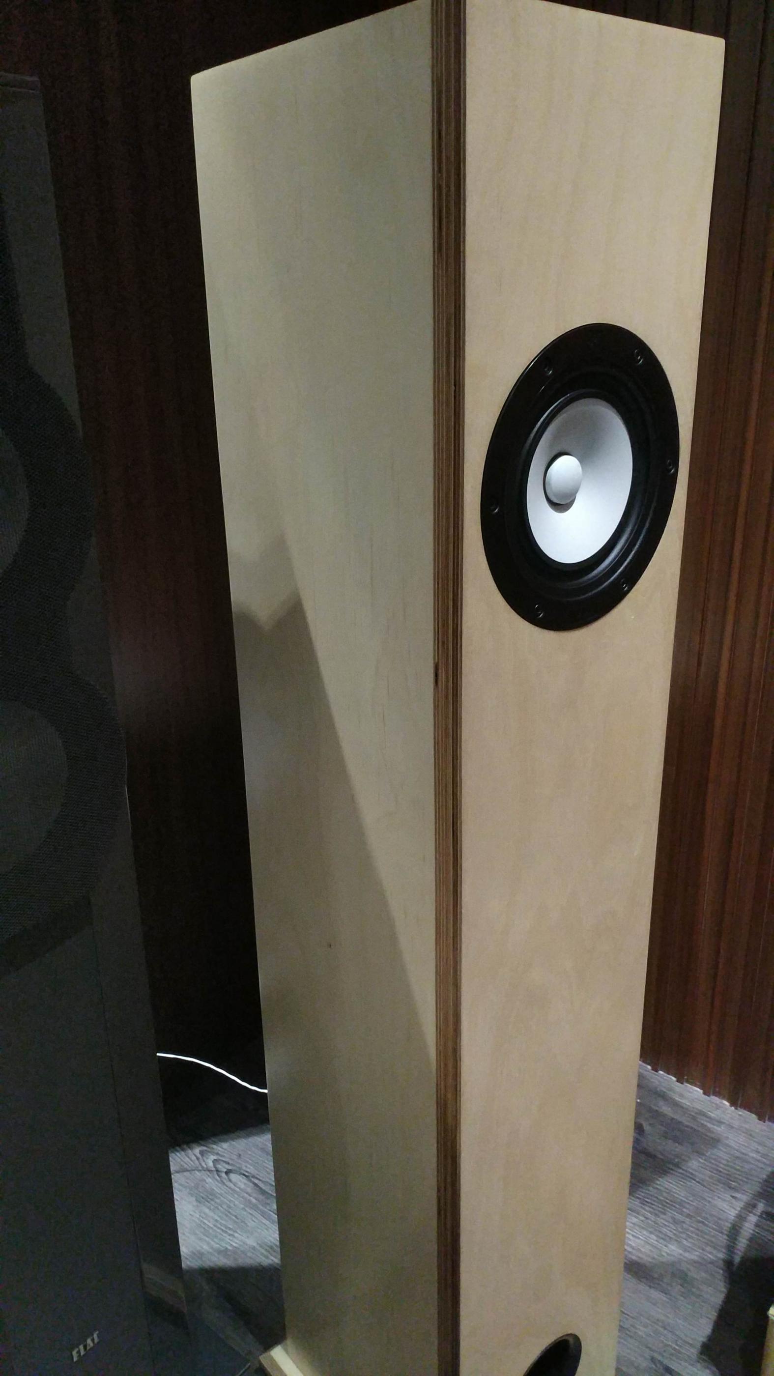

thanks, understand, i need to cut it short then. The radius is 33mm, it should be roughtly 137mm long if i follow the metal cone specification or 114mm long for paper cone specification. Now my existing Port is 150mm. I probably need to cut it shorter to somewhere in between 137-114mm.
Now, the sound is ok but i am still waiting for burn in.
here is the photo. I read some post saying it needs 500 hours run in time. Is it true? Anyway, it's great now.

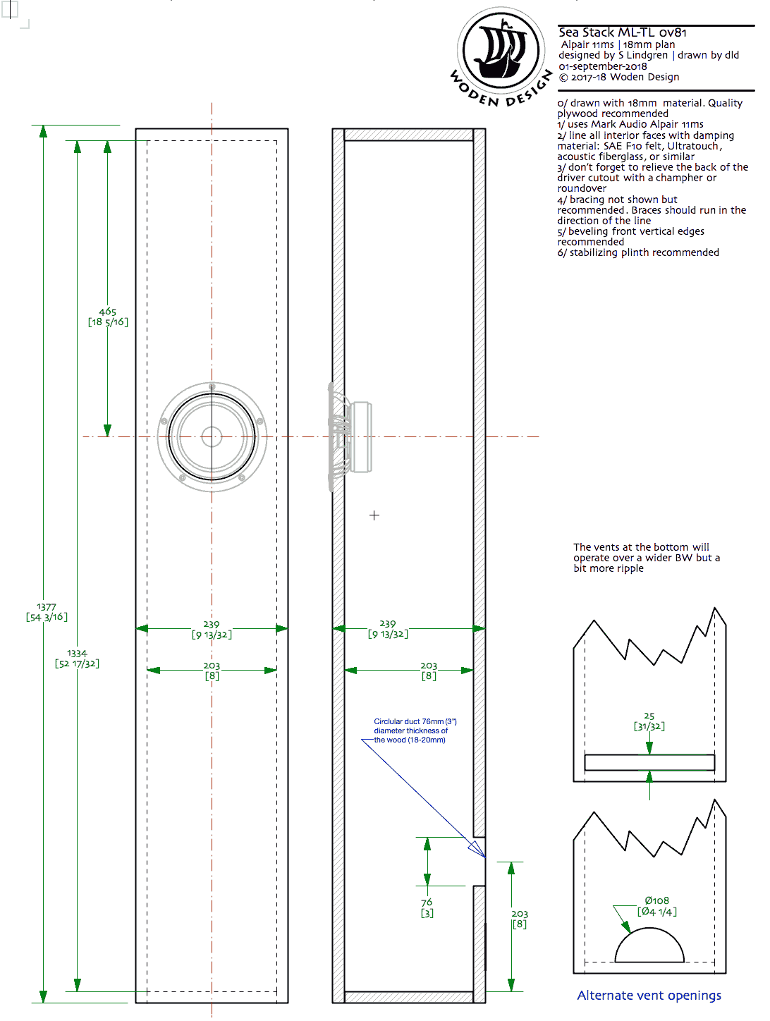

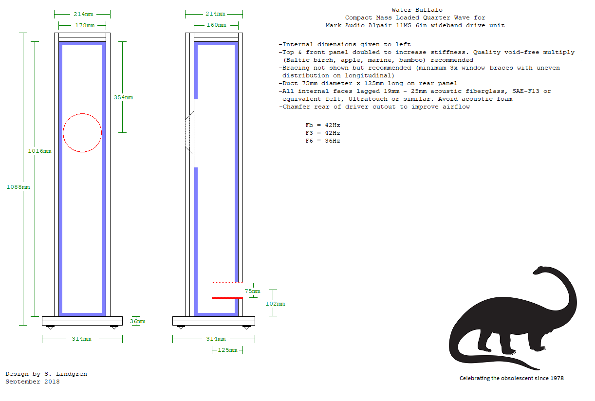

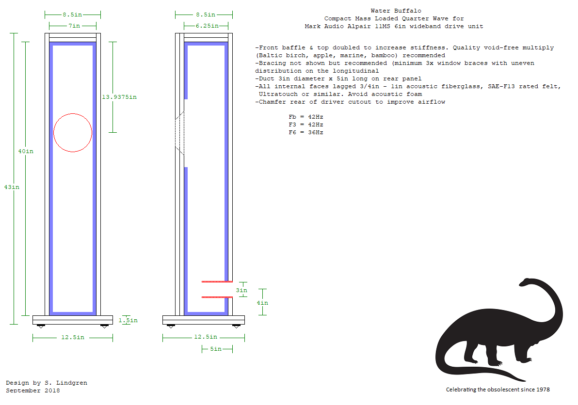

Markaudio are lousy at updating their site, but FWIW, I've done quite a few more enclosures than are currently there. I'm no Dr Griffin, but in the meantime these might be of interest:
