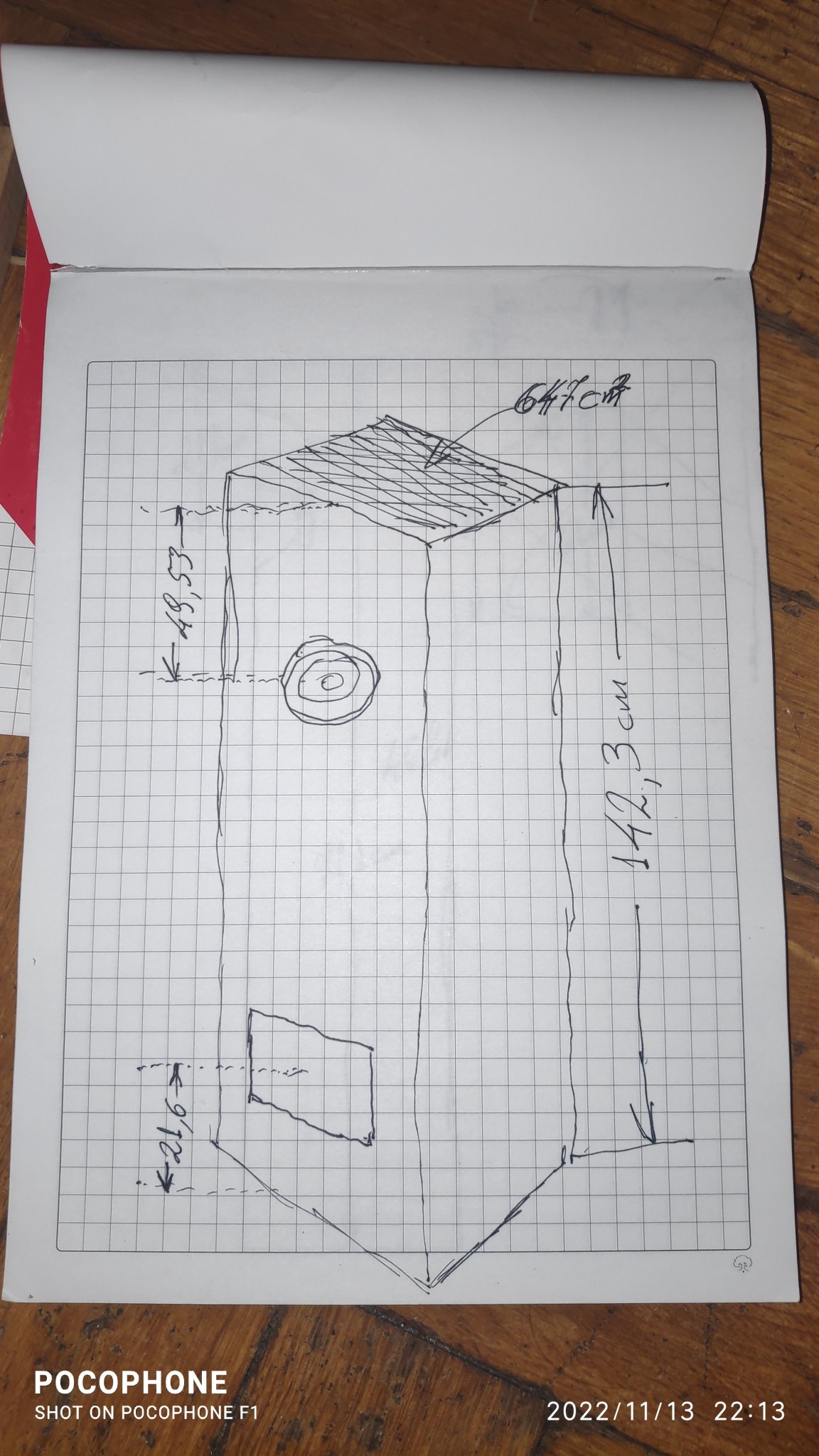

GM's proposal is something like this ?It is a file from hornresp.
MLTL box 94.94 litre
Driver is placed 49.53 from top of box.
Port is placed 21.62 cm from bottom and have area 285 cm2 and 1.8 cm deep.
Area is 647 cm2 from bottom to top of the box. Hornresp dont tell the width and depth. Only the height.
49.53cm+71.09cm+21.62cm=142.24cm
All measurements are internal.
An excellent hiding place for my 3,5 y.o. little son toys ! The baffle thickness has to be at least 18mm. It will need extremely strong bracing to avoid resonance. So with a baffle width 21cm the depth will be 30,8 !!!
It is bigger than an A4 page. Unpractical .

Size is relative; to me its a floor lamp base.
When going low though, 'BIB' (bigger is better) rules!
Right, the minimum I recommend for most cab alignments regardless of size.
Such high aspect ratio cabs are like cylinders, so acoustically very strong along its axial length, requiring minimal ~ full length bracing (board on edge) and only one horizontally behind the driver(s) to do double duty mass loading the driver(s) plus either double top, bottom plates or angle board on edge bracing if singles.

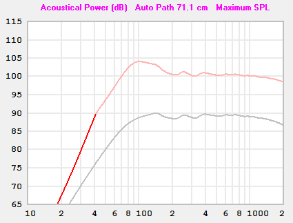

Same cab 'shrunk' to T/S max flat alignment size is 15.15 L with Fb = Fs with basically little/no useful (mid) bass unless jammed in a corner. 106.24 cm^2 (i.d.) = ~10.31 cm square, so now small enough for your son/pet to knock it over if not on/in a substantial base, so might wind up with ~the same size footprint as the full size model.
Red trace +4 dB peaking referenced to a 14 W input.
edit: Note both cabs are inside dimensions (i.d.) based on 0.75"/1.8 cm no void plywood or similar.

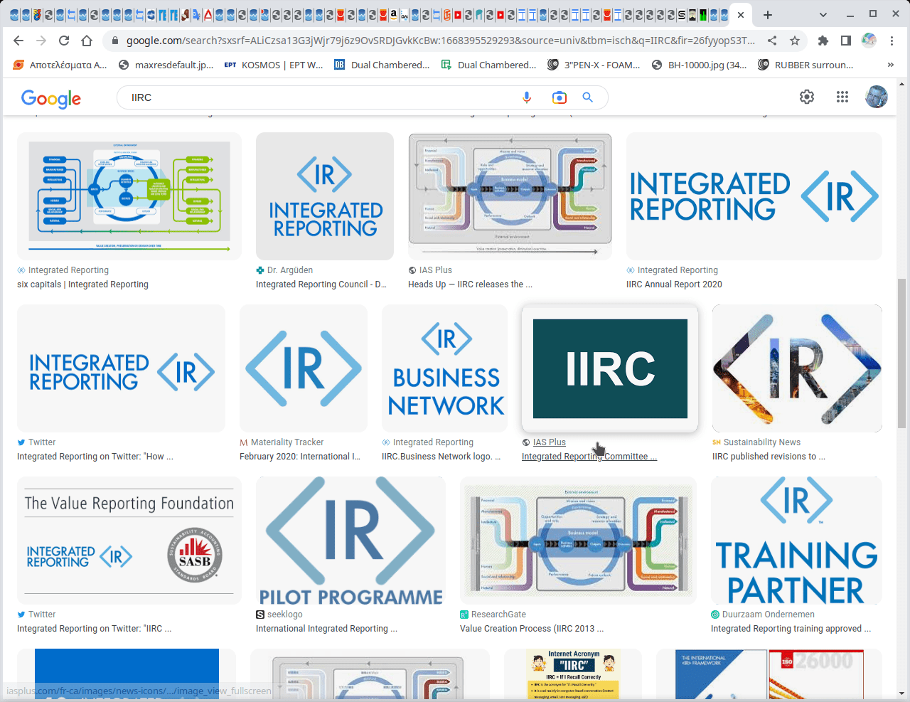

HR ? Google for "HR" is giving me "Human Resources". I didn't understand . Will you give the full name of the program ?You must install HR to import the file to view the sim.
Is it a "uniplatform" one ? I use only Linux machine .
Is my sketch correct ?
Elias
I didn't have the time to read 661 pages. What is IIRC or who is ?IIRC your answer is in the HR thread I linked to.

If I Recall Correctly. You can search it for finding out how to use HR in Linux.I didn't have the time to read 661 pages. What is IIRC or who is ?
THANKSIf I Recall Correctly. You can search it for finding out how to use HR in Linux.

Hmm, my sim was strictly to optimize bchang's sim to be closer to measurements, so please define 'improve' since one has to use less damping, so likely bigger and more optimal driver, vent offset to audibly improve it. Also, it's Xmax limited to ~10 W/< ~150 Hz with the CHP90.
