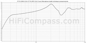

.........This is why I like the mic-in-box technique. It automatically measures the summed response of the woofer + port (or passive radiator), so it does away with the crosstalk problem. It would be cool to see a comparison between mic-in-box with a ground-plane measurement, but I assume you don't want to drill a hole to insert the microphone into your speaker box. 😉
Matthias, here are some comparisons of merging technique vs MiB (always think on Man in Black when i write 🙂 ):
Measured woofer and PR nearfield and merged:
Microphone inside the box:
Source: Puri Bliss - BeWg | HiFiCompass - всё для акустических систем и не только

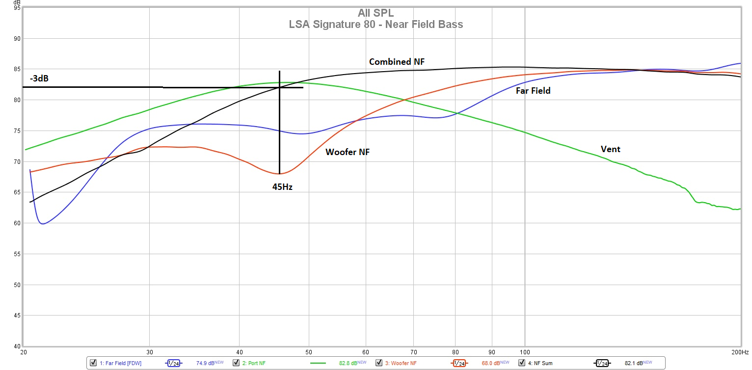

I tried out the Keele NF method to measure my recent 2-way reflex box. It worked quite well once I figured out how to scale vent response with main woofer response in NF.
I use the Audioexpress article linked in post 111 above (although I found it on my own out of necessity).
I decided to match far and near field based on 150Hz response.
This gave a -3dB value and overall sensitivity that matches the predicted bass reflex calculator which predicted 45Hz tuning (which also matches impedance sweep saddle between the two reflex peaks).
Overall a nice result that tells me a lot more than the far field curve that always seems to drop below 100Hz.
