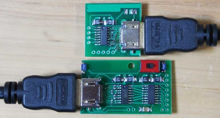

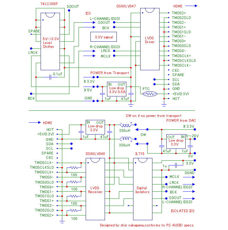

Apart from the topic, I'd like to report the use of I2S interfacing on LVDS/HDMI connectors & cable. As some of you may know, PS Audio employs "I2S through HDMI connection" as an interfacing method for connecting their PerfectWave Transport to PerfectWave DAC. This specification is open and a Japanese audio vendor, Fidelix, provides a transmitter module (the smaller board at upper in the following picture) and a receiver & digital isolator module (the larger one at lower).
These module uses National Semiconductor, DS90LV047 (Tx) and DS90LV048 (Rx) & IL715 (digital isolator).
I listened to sounds by connecting our SDTrans192 to their CAPRICE DAC through this transmitter & receiver module with 1m HDMI cable for playing WAV files ranging from 44.1 kHz/ 16 bit to 352.8 kHz/ 24 bit. I thought it was fully feasible and I did not detected any distinct degradation of tones.
Chiaki is planning to incorporate a transmitter module with a HDMI connector in the next version of SDTrans192 Rev. 3.0.

I2S on LVDS/HDMI ( differential I2S )
The company, Fidelix, has stock and they can sell the modules.
Their regular prices for end users are;
Transmitter : 5,000 JPY/piece
Receiver with Isolator: 10,000 JPY/piece
If you are interested in the modules, please contact to Bunpei. He will support communications between you and the company.
(The company has no experience of direct oversea marketing and sales.)
Bunpei has connected SDTrans192 and Buffalo II DAC using the interface modules with 1m HDMI cable and confirmed that the interfacing was perfect even on 352.8 kHz/ 24 bit PCM data transfer.
