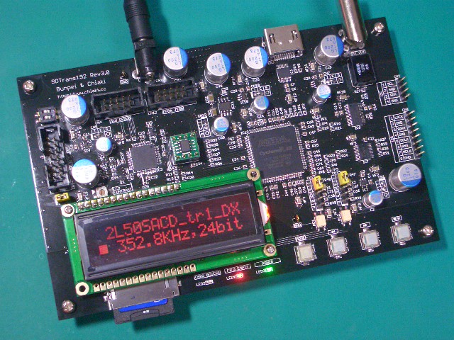

Prototype of SDTrans192 Rev. 3.0
At the beginning of this month, we started an evaluation of prototype board of SDTrans192 Rev. 3.0.
We are now requesting comments from SDTrans192 Rev.2.1 users in Japan by giving them demos.
Sound quality has changed when we compare it to a Rev. 2.1 board.
My impression is a better SNR and reproduction of more details that are originally recorded in CD. However, in some environments, some people may feel that "bass becomes weak" or "not enough energy". I believe the bass is never degraded, instead, getting more accurate.
The new board has a PS-Audio type I2S interface on LVDS/HDMI Connector & Cable. We confirmed that it is compatible with the receiver side implementation on CAPRICE DAC (ES9018 based) produced by Fidelix.
We will announce soon the expected release date and price for the new kit.

Bunpei,
thank you for the update.
Just looking at the PCB, I see you have moved almost every part compared to rev 2. A major task.
Reading about the objectives
"Main objectives for the coming update are;
1. Improving sound quality
2. Providing better connectivity to peripheral devices
For Objective 1.,
A. Adopting NDK low phase noise crystal oscillator modules
B. Improving power supply circuits to obtain low noise profiles
C. Improving signal line print patterns
For Objective 2., the following interfaces will be on board
(in addition to such existing interfaces as I2C, I2S (single end, logic level),
S/PDIF
A. I2S on LVDS/HDMI connector & cable (PS-Audio spec)
B. Serial interface for outputting necessary file and play information
C. External master clock signal input connectors
D. External operation switch signal input connectors
what has been implemented in version 3?

Dear IngemarR,what has been implemented in version 3?
Oh, it's a good question. I'm sorry for my late reply.
Exactly speaking , the following items are partially implemented.
The interface hardware is prepared but a firmware support is not achieved yet.
Not BNC connectors but pin headers are provided.
All the other objectives are fully implemented.

Revision 3 confirmed to be superior performing and better sounding
Yesterday, December 11, I had the great honour of having Bunpei visiting my Tokyo home bringing along the brand new SDTrans 192 Revision 3 as well as a particular power-supply tweaked SDTrans 192 Revision 2 that we previously had found to be the best sounding among all Revision 2 samples. Bunpei also brought an elaborate, self-built Buffalo DAC with an NDK 100MHz oven-clock and multiple (transformer, battery, instrument-supply) power supplies for different parts of the DAC and the SDTrans itself. I also had the Fidelix Caprice at hand, so we ended up comparing not only the two SDTrans Revisions, but also with playback from my MacBook Pro (run by internal battery) and M2Tech Evo (powered by external Lithium battery) with AyreWave and Audirvana playback applications.
In the Buffalo configuration both SDTrans 192 Revison 2 & Revision 3 were connected by direct, extremely short I2S wiring. Unfortunately the Fidelix Caprice at hand did not have the available I2S option, so we were only able to connect the SDTrans 3 via S/PDIF. SDTrans 192 is also equipped with HDMI/LVDS port compatible with PS Audio and Fidelix Caprice (among others), but testing this was left for another day.
By the way; it is important to understand that the Revision 3 is actually more than just a simple tweak of a Revision 3. It is a physically larger unit (the shorter side is the same as before, while the longer side (width) has grown a lot). There are more regulators and the local power supplies are more sophisticated, among other changes that in effect amounts to a BIG update almost amounting to a full model change.
The system used for testing was: Lyra Connoisseur 4-2SE line preamp, 2 x Accuphase A20V power amps run in normal, non-bridged mode, and JBL 4333A (all Alnico drivers) studio monitors.
We played a wide variety of program material including High Resolution Music DOWNLOAD services files including DXD 24BIT/352.8kHz, but also normal EAC ripped CD-files. Many of the files we played have become "standard comparison" files that we have played on various equipment and in various locations, so this program material is very well known to us.
Our conclusions from comparing the SDTrans 192 Revision 2 & Revision 3 was that the Revision 3 has an even more detailed, more sophisticated, more capable musical presentation than the Revision 2. Even though we both agreed that the Revision 2 still holds its own and is entirely satisfying to listen to; in direct comparison to the Revision 3 it sounded a bit simpler, rounder and not quite as articulate. We can imagine that some listeners would personally prefer, and also that some system matchings would favour, Revision 2 over Revision 3. Especially bass reproduction of the Revision 3 feels like it goes deeper and favours the really bottom octave, something that depending on the speakers used could under some circumstances give the impression that the bass is weaker and less powerful on the Revision 3 (than on the Revision 2). However, with capable speakers and careful listening, the bass on the Revision 3 is more articulate and have better definition than on the Revision 3. It produces the kind of bass that can make you tell the differences in tone colour between different types bass instruments, and you can even tell the size and position of these bass instruments.
The midrange and treble of the Revision 3 is richer and more detailed than the Revision 2 (and the Revision 2 ain't bad ;-)). Depending on how the bass reproduction ends up with YOUR speakers and YOUR system, some listeners who have heard the Revision 3 reports hearing more (a bit too much?) energy in the treble, but I personally think that this is a balancing issue depending on how the bass is reproduced. The Revision 3 NEVER sounded bright or uncomfortable in my system.
As mentioned above; we also tested the Revision 3 via S/PDIF into the Fidelix Caprice (using the bypass internal preamp/volume mode), and this also sounded extremely good, albeit not quite up to the level of the ultra-short I2S to Buffalo DAC connection. However, other tests of the Fidelix Caprice with the MacBook Pro and M2Tech Evo shows that the potential of the Fidelix Caprice is really at top level, so I am looking forward to testing the Revision 3 with Caprice I2S input. Another comment in this regard is that my recent tests of AyreWave from sbooth.org with M2Tech USB interface http://www.m2tech.biz/ has finally made it possible for me to truly enjoy direct computer file playback. (I prefer AyreWave to Audirvana). But still SDTrans 192 playback is superior again!
As far as I am concerned, I am giving Bunpei & Chiaki my unreserved thumbs up for the SDTRans 192 Revision 3 (and I have ordered a unit
