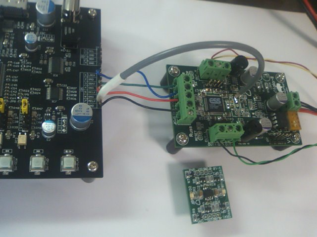

>How do you connect the SDTrans clock to the Buffalo2?
>A photograph perhaps?
First of all, you must remove Crystek TCXO from Buffalo II board. You would be unable to use BII with other transports by doing this.
Then SDtrans' special EEPROM -Chiaki san kindly sent to me- for this purpose enables you to feed 90.3168mhz or 98.3040mhz to BII' s XI pin
from SDtrans' MCLK pin. You also need moving SMD "JP5" to "JP6"

Chiaki and Bunpei would like to recommend ES9018 DAC chip users try "synchronous master clocking" scheme on the chip.
In order to try this, the first thing you need to do is removing (temporarily) an original clock device on your DAC board.
The second step is to connect MCLK output pin of I2S connector of SDTrans to ES9018 XI pin.
There are two ways at this stage. The easier way is to provide 22.5792 or 24.576 MHz MCLK. In this case, you need to set "OSF =OFF" on ES9018 so as to maintain a stable lock on ES9018 from 44.1 to 384 kHz. You need neither EEPROM upgrade nor hardware jumper change. The users of SDTrans192 Rev. 2.1 can also try this.
The another way is to provide 90.3168 or 98.304MHz MCLK. In this case, you can set "OSF=ON", "DPLL BW=LOWEST" on ES9018 and have a stable lock from 44.1 to 384 kHz. The high frequency MCLK is generated in FPGA and you need to have Mark 17 EEPROM upgrade. You also need to moving the jumper SMD chip on JP6 position to JP5. SDTrans192 Rev. 2.1 is not compatible this setting. My opinion is the setting does not necessarily bring the best result. I rather favor "OSF=OFF" mode.

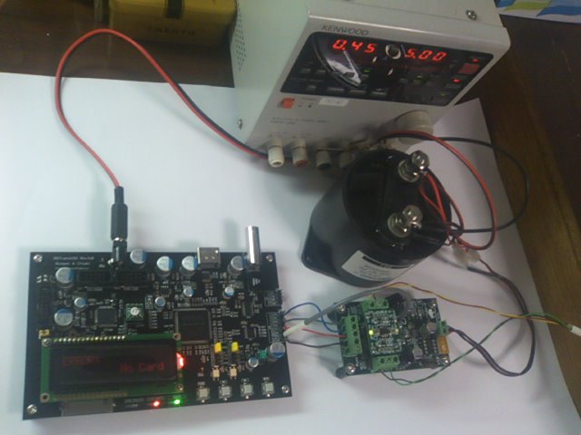

Effect of Cornell Dubilier Electronics (CDE) Film Capacitor
Some of you may have known very well the great effect of Cornell Dubilier's giant film capacitors.
I recently added the big film capacitor in the picture below to the +5V power line of my SDTrans384 and Buffalo II.
The effect is amazing. More power, strength in all ranges maintaining purity and resolutions.
In my case, 944 type, 100 microF 1200V DC.
The cap is made by Cornell Dubilier Electronics (CDE).
Digi-Key - 338-1921-ND (Manufacturer - 944U101K122ACM)
(The largest capacitance available is 220 microF/800V DC.)
I'd like to recommend you try one!

I am a bit surprised that you seem to use a standard laboratory power supply, but I am not at all surprised that you will get better sonics if you add a large PP cap to this supply. I would ague that lab PS are not at all suited for audio use.
I would never use a laboratory power supply for audio equipment. That will for sure not give optimal sonics from the digital or analog sections of audio gear, IMO.
Personally, I use a dedicated transformer for my Buffalo2, and two separate transformers for the analog IV sections (dual mono) PlacidBPs. All my Placids have modified rectifcation sections, and added decoupling polystyrene caps on all outputs and inputs.
And my SDTrans192 has its own linear regulator supplied from its own transformer.

I agree.
I have the tridents and they make a good sonic improvment with many improvements, for ex the sound stage and a more organic sound. For the price the Tridents are a bargain sonically.
Hi Bunpei,
I noticed that you do not have the trident regulators for your buffalo II. While that cap no doubt improves things (for $60 it had better!), I'd be willing to bet the tridents would be even more of a benefit.
Dear staccatiss and alazira,
Thank you very much for your comments and recommendation.
It's true that a versatile laboratory power supply is not one of the best power supplies for audio use. However, it's also true that some of them provide a certain quality level.
In this case with the giant film capacitor of CDE, even the usual laboratory power supply showed a very good performance. It was a surprising change for me. That's why I posted the previous recommendation.
I could not buy TPA Trident regulators because they had been sold out for a long while. Now, they are on sale again. I think it's time to buy.
I appreciated much your recommendation.
Bunpei
