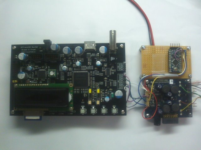

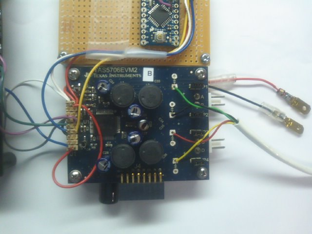

Connecting to TAS5706 Evaluation Board
I could connect TI TAS 5706 (full digital input Class-D amplifier) to SDTrans384 via I2S by setting some registers on the chip using Arduino.
The chip on its evaluation board could play PCM WAV files ranging from 44.1 kHz/16 bit to 192 kHz/24 bit without any problem.
DAC chips and full digital input Class-D Amplifier chips I have confirmed the compatibility of SDTrans are;
<DAC>
Wolfson Microelectronics: WM8741 ( - 192 kHz/24 bit)
ESS Technology: ES9018 ( - 352.8 kHz/24 bit)
Asahi Kasei Microdevices: AK 4399 ( - 352.8 kHz/24 bit)
Texas Instruments: PCM1794 ( - 192 kHz/24 bit)
<Class-D amplifier>
STMicroelectronics: STA328 ( - 192 kHz/24 bit)
Texas Instrumenents: TAS5706 ( - 192 kHz/24 bit)
