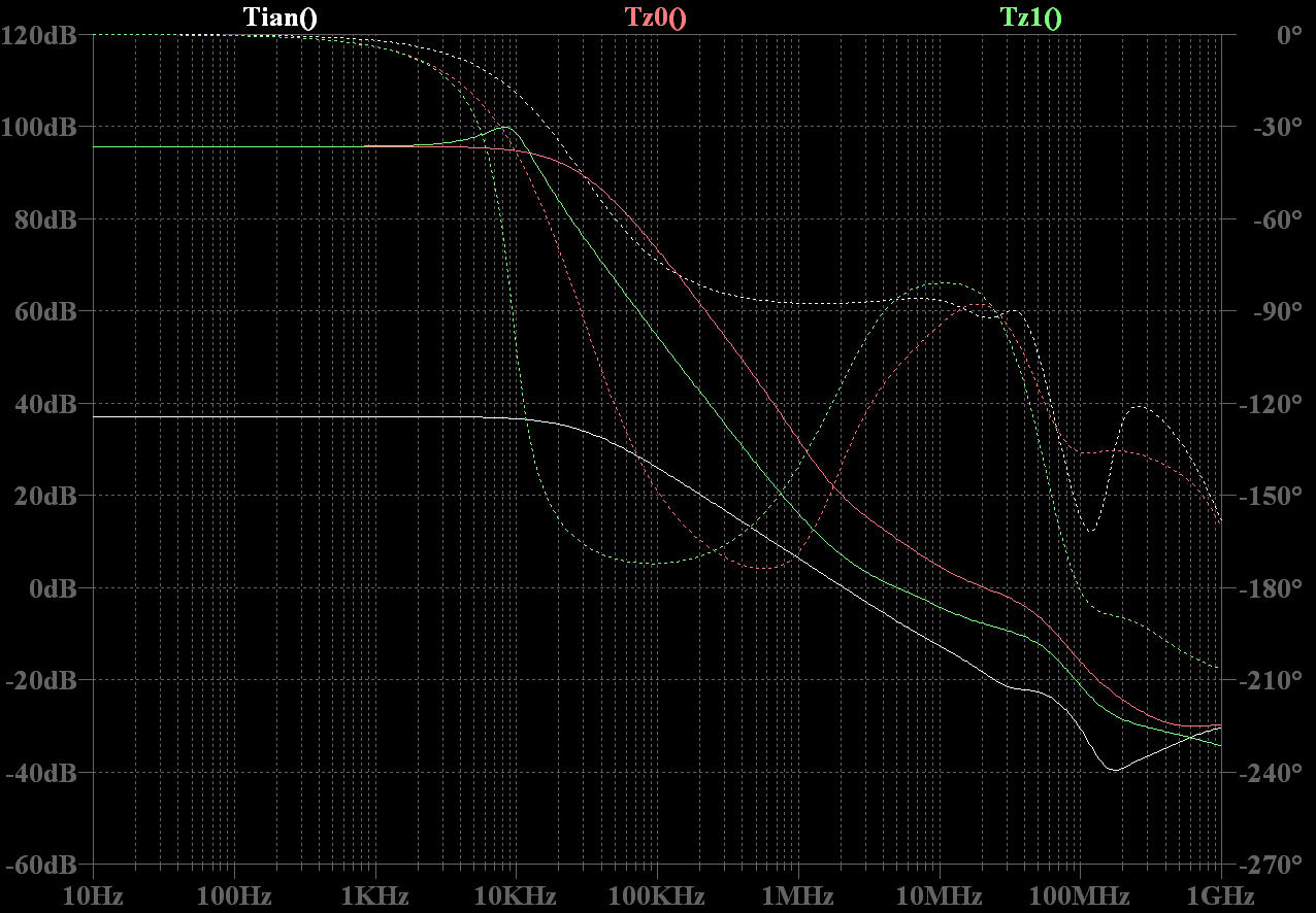

... the compensation of the main amplifier
Hi Arthur
As promised, here are the loop gain plots.
Tz0 is the inner loop.
Tian is the common mode loop. As you can see it's very docile.
Tz1 is the outer loop. As you can also see, I could have a bit better stability if I pushed the outer loop cross-over frequency up even further.
This makes theoretical sense but will scare people.;)
Me included, so I will have to experiment with this.
I have just found practical transistors for the CMCL so will have to redo this but I believe it's essentially what I will prototype.
Hope this answers some of your questions.
Best wishes
David

Hello Dave ,
Thanks for the update, I presume everything was done with the Tian probe.
Looking at the graphs the main poles are at 10kHz-20kHz and the unity gain point of the outer loop at 20MHz and inner loop at 5MHz and 2MHz for the CMCL stage. Well that in part explains the simmed low THD performance at 2ppm 8R@20KHz.
You should build this thing and I am sure it will give you problems that you cannot sim because of the quality of the modeling of the layout and spice device model accuracy. Unfortunetly these problems from my experience can only be solved by having the hardware to play with. I suspect you can make this thing work but you need a very good hardware layout to meet these levels of performance.
Can I ask how may layers you plan to use for your PCB.
Regards
Arthur
...was done with the Tian probe.
Yes - Tz() is my implementation of an auxiliary Tian probe, so I can look at two loops at the same time.
As you probably know, when you try to improve one loop the other one usually becomes worse and it's nuisance to have to swap back and forth or duplicate circuits.
...Well that in part explains the simmed low THD performance at 2ppm 8R@20KHz.
The main part, I'm sure. The basic amp is reasonably orthodox, there's no secrets, just careful optimisation.
...problems that you cannot sim because of ... the layout and spice device model accuracy...
I have modelled some of the layout PCB manually, which is slow and that restricts me to only critical areas. I just hope reality has the same opinion about what is critical.
There must be automated tools to model PCBs, any info appreciated.
... hardware layout to meet these levels of performance.
So far 2 layer looks like it can meet the requirements.
If I run into problems then I may consider 4 layer, but it seems more complicated than I want to tackle.
Best wishes
David

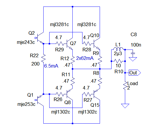

Hello Guru kgrlee :) I've given that zobel arrangement a try and so far stability seems just fine with it. I've tried various capacitive loads ranging from 10n to 100n (and higher) and it worked just peachy.
...And it uses only 3 bits instead of 4 :D
My version of this is similar but uses a few more bits;)
I drop the resistance across the inductor but put a resistor in series with the Zobel capacitor.
The idea is to have similar overall load on the amp but the inductor better damped.
I also have experimented with a second Zobel in a Pi network, similar to what is discussed in Bob's book.
But I connect this Zobel directly to the OPS transistor emitters rather than after the emitter resistors.
The idea here is to minimize stray inductance so I can push the ULGF up.
At the moment I have 1.8 uH inductor with 2.2 ohms across it, haven't decided on the Pi Zobel values.
Best wishes
David
I believe the extra Zobel(s) at the O/P device emitters is a Cordell favourite.
I have a lot of 'real life' & theoretical stuff that supports smaller resistors across the Inductor for the 'usual' networks.
There's also RFI which mandates a Zobel AT the speaker terminals but this means its probably too far from the OPS.
However, the PCB may not be the best place for the Thiele (L // R) cos its very close to the huge distorted Class B current tracks.
So the 'usual' networks may be the best in practice after all.
