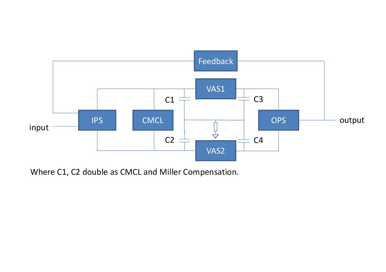

I usually find it easier to draw the amplifier as a block schematic like in the first picture below. This shows the VAS loop inside the main loop.
But I have yet to work out a neat way to show the CMCL, it would need a more detailed picture of the amplifier structure.
It is essentially an alternate mode, in parallel.

Hi David,
Here is my attempt at a simple man's block diagram of a symmetrical amp with CMCL where the compensation performs two functions.
Hopefully this is correct. 😉
Paul
Yes, your situation is probably different to mine. I realized after I sent the previous post that I had done my own CMCL tests on an amp with Miller Input Compensation, where the two loops barely interact.
This lack of interaction was not why I chose MIC but is a nice bonus.
I would like to believe it's not just luck, I chose MIC specifically to minimise other interactions, like component tolerances.
I see it as similar to database normalisation, if you have come across that concept. If you have the structure correct then many consistency problems just can't happen.
In this case it is nice to be able to optimise each loop independently.

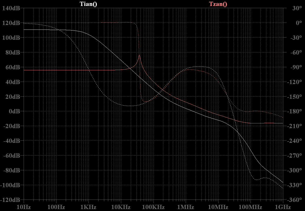

OK, as promised after bedtime.
..At the moment, for me the HEC is just an output ... block. ... It's another part to optimise once the front end has been dealt with.
There is subtlety here that I still haven't completely clear in my own head.
Bode proved that if it is possible to find a wire where all the feedback can be disconnected with one cut, then the system can be analysed as if it had one loop.
For example if we have nested loops then we can cut the innermost loop and this will break all the outer ones.
So the correct point for an analysis may be inside a block if it contains a feedback loop of it's own.
But the alternate view, proved by Hurst, is that a block can be treated as a black box, and if it is stable then the addition of feedback around it won't lead to instability if the outside loop is stable.
These two views must be mathematically consistent, somehow the correct analysis inside the block must always work out so that the view from outside the block doesn't need to know about it.
Maybe it's just me but I don't find that completely obvious.
Now the tricky bit is that HEC doesn't have a point that cuts all feedback loops, once you have TMC and Paul's complicated compensation.
So you do have to look "inside" the HEC box.
And then, even so astute an analyst as JCX has noted that it's not obvious.
So here is Paul's amp, the loop gain outside the HEC loop is Tian(), the loop gain around the OPS once you have HEC is Tzan().
Note the cross-over frequency is 3 time more and the PM is decreased.
I think this is the explanation for some problems.
There are minor differences in the HEC included loop, dependent on where you check it, perhaps due to the difference between Tian and Middlebrook GFT assumptions.
I haven't even started to solve that discrepancy, and it's where I came in.

Thank you for this.
Now this is pushing my understanding... 😉
Can understand the concepts of the first part of your reply. But you're right it's not completely obvious. Need to have more thinking time to try and get it clear in my head.
The analysis on my amp you have done is now beyond my understanding. However, can we say that TMC is not a good idea with HECs? Could moving to TPC be another option?
I can at least see that something is wrong with the Tzan loop gain plot. Peaks are always a warning sign. Now all I have to do understand your analysis. 🙂
Paul
Well it's taken about 3 hours to work out the probe placement for Tzan. 😉
Don't ask me for any reasoning but a capacitor in series with R4 in my circuit of around 5nF removes the spike. You loose overall loopgain in the main loop though. Is it strictly stable? Not sure...

It seems to be due to feed-forward in the HEC (feedback) network.
This is precisely why I asked about the Middlebrook GFT technique, because it covers this effect and helps to make it clear.
My initial reaction is almost shock, that it makes the usual HEC approach look suspect, perhaps misconceived.
I would like to be more certain before I start such a controversial debate.

I think the issue lies with 2 independant high-speed loops. When loops rival each other's speed while being autonomous, there may be events that 'disalign' their regulation, causing the loops to instantly fight and compensate each other. I have this issue when my HEC leaves clipping. I had this issue in the past when I was designing a powersupply with both a current and voltage control loop. Multiple 'solutions' giving the same answer so to speak.
