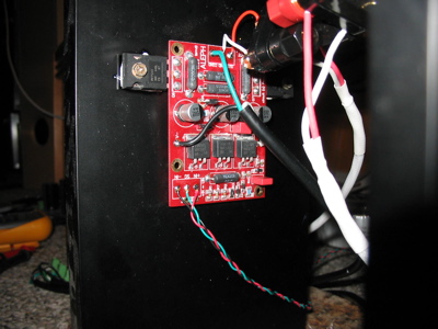

adwsail said:I must be blind AND stupid. The Mini A SMD board I have doesn't seem to match any schematic I've found.
The Mini-A version 1.0 is unbalanced input. sig in to R1, out R1 to R2/Q1 gate. My PCB is balanced in with the + input going to R1 (thats fine) then to R7/R2/R3/Z1. No joy with rev 1.0.
So I finally found a Version 1.01 schematic, dated 21/01/02. It doesn't even have an R1 that I can find. What I THINK is the + input is R2 (10k) to R4/R9/R5/Z1. R9 then ties to Q1 gate.
Is there a schematic around that actually represents the Mini A rev.1 smd boards??? If there isn't one I'll try to draw up one with matching part numbers for the rest of us that need such info to build confidently.

adwsail said:Just a quick glance at the parts list but all the resistors are leaded devices????? Haven't checked the rest but I'll get started on a SMD parts list which I'll post when finished. I would be interested in a Jfet version as well![]()
Sorry. I sent it to Brian, and he sent back the link. I did a quick check of the values, but did not pay enough attention to make sure it was what I had sent him.
Here is the PL.
There are tabs to for ordering from digikey or newark, you can just cut and paste into their bom loading pages.
Randy

I am guessing the schematic remark was in reference to the parts list.
But, go here
http://www.diyamps.com/aleph/aleph.shtml
BTW, this link was on the 3rd page or so of this thread.
Lots of good information on that page, and a link to the schematic PDF is on the very bottom of the page. No need to reverse engineer it.

Sorry what i was trying to say was that you don't need the schematic to build the amp. The Parts list is what i used. part for part..
After part for part i applied power and poof they work. Lots of testing to have this work like that tho.

Hello Mini-a builders,
A word of warning to the smd builders. There is an error in the parts list posted by randytsuch. In the Digikey parts list the digikey part number for R18 is for a 392k resistor and not for a 392R. Guess what i orderd and solderd to my 4 boards
A small cry for help here
I cant find anywhere in the UK that has 392R 1210 resistors or sells them in small quantities. It seems quite costly to buy just 10 from Digikey, does anyone feel generous enough to send me 4 of the correct resistors if anyone has some left over
I have 6 392k resistors if anyone wants them
