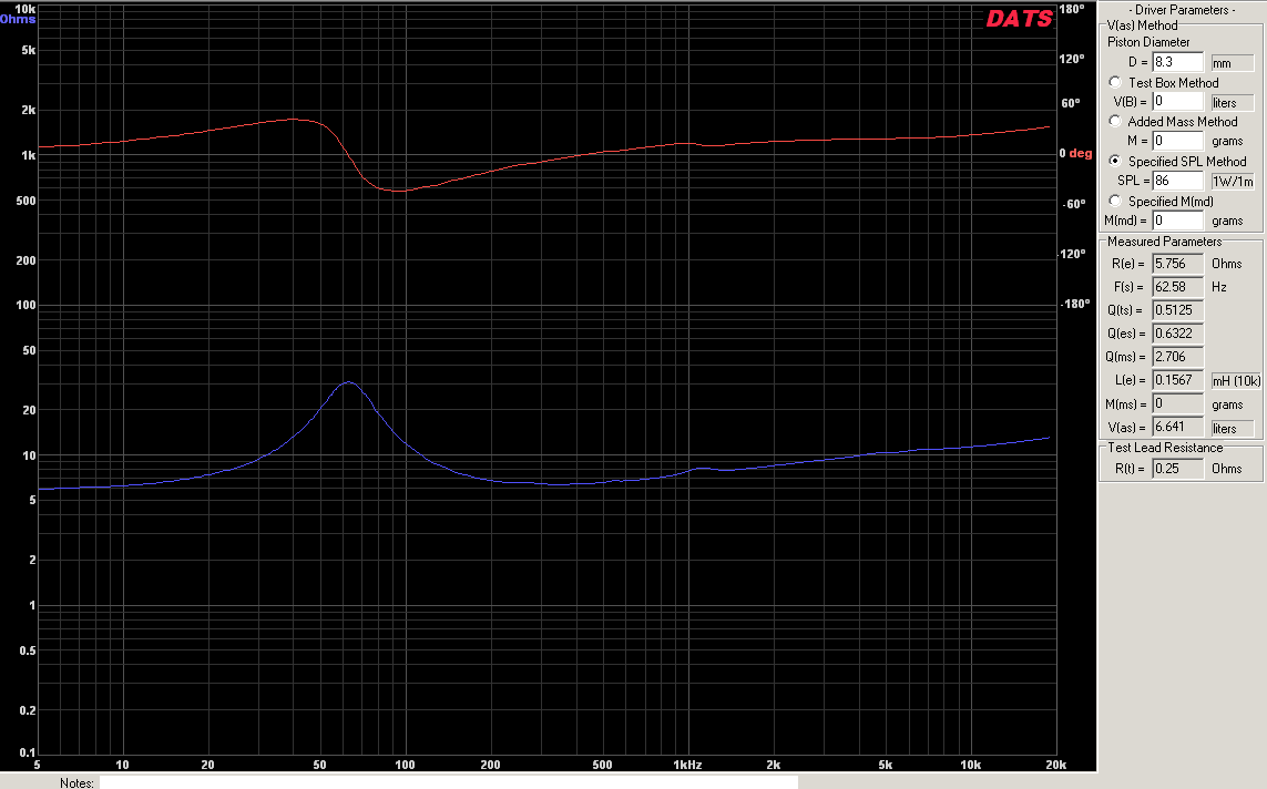

Ok, here it is as listed:
Re=5.75ohm
Fs=62Hz
Qts=0.51
Qms=2.71
Qes=0.63
Le=0.157mH
Mms=not given by DATS
Vas=6.65L
I don't know how to get Mms. I'll have to look it up.
Re=5.75ohm
Fs=62Hz
Qts=0.51
Qms=2.71
Qes=0.63
Le=0.157mH
Vas=6.65L
I think Mms comes from fact that I use the added mass method to get Vas. If you use the known volume box method to get Vas, you don’t have it. Having either Vas or MMs is enough I think.
For added mass I use silly putty shaped as donut to fit on dustcap cone interface. I measure mass with digital gram postal scale. Silly putty silicone based and is tacky and leaves no harmful residue on sensitive surfaces. Don’t get it on porous fabrics though it will never come out.
