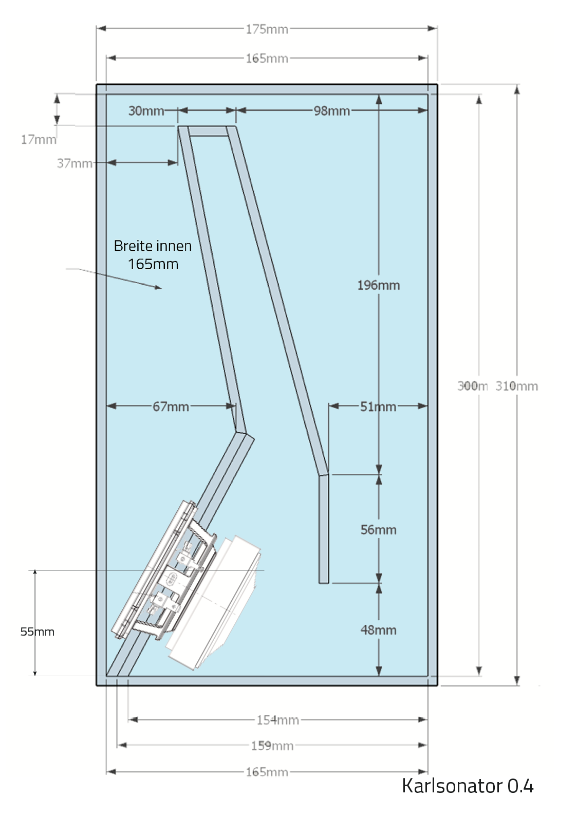

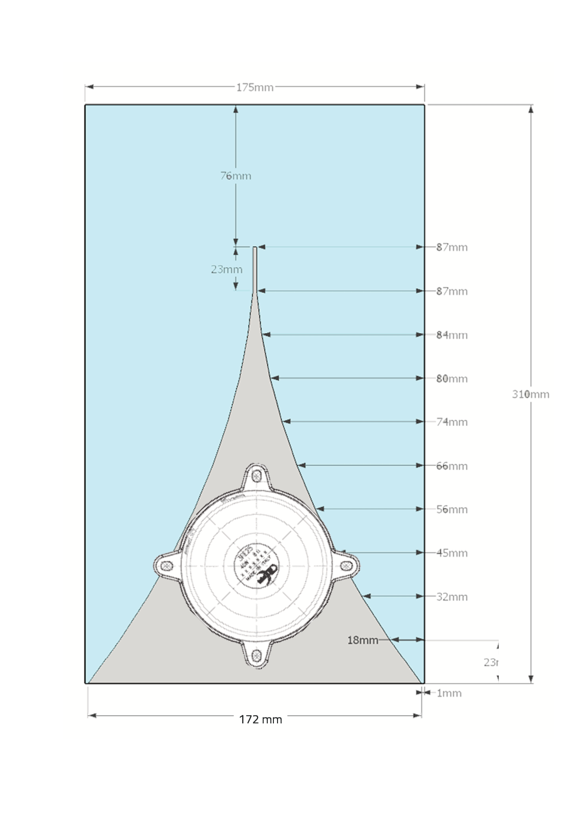

Kking,
Sorry, you are right - I was reading my own text incorrectly. The proper size is as the post title states:
0.44x/0.55xW K'nator with FE103
Kind of wide and short aspect ratio. If you tried on a 0.50x scale and it sounds great, use it!
Thanks for the clarification.
My issue is that the .50 I built houses both drivers. I'm trying to see what the proper size is if I split the pair for use as separate Left and Right speakers. This build was strictly for experience, and not destined for long-term use.
The other thought was to make Cornu out of them, on a 20x20" scale. Any thoughts as to how well suited these drivers are to that configuration?
