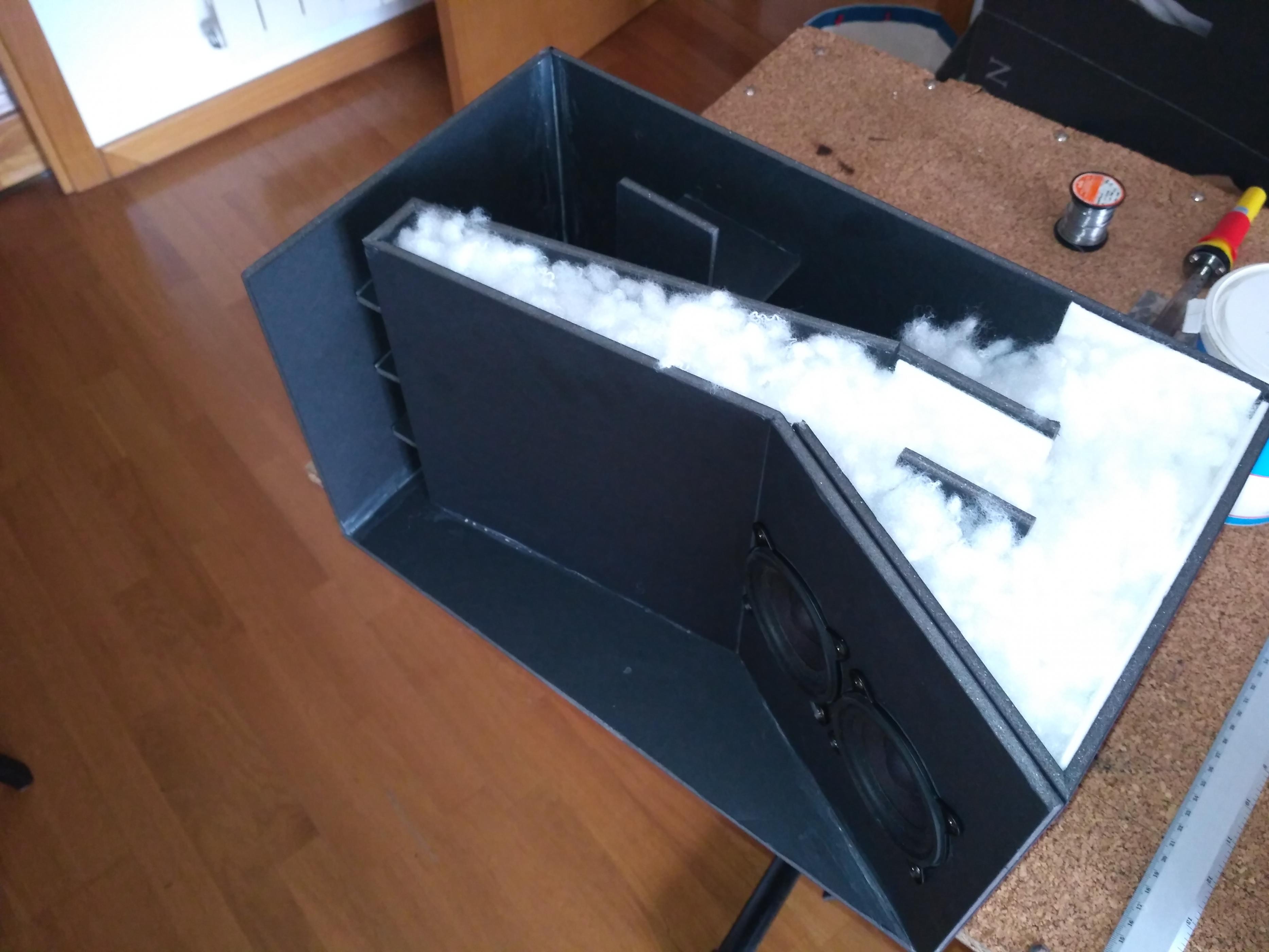

I have cut every piece and everything fits perfect, but one thing... The lower 3FE25 hits the base with its back and it is impossible to fit it in its place! What do you recommend me, should I lower the bottom? Should I put the drivers a bit higher? Can I using some "circle adapter" put the drivers a bit more outside (it should be around 1cm)?
Help! I am completely new to this and I don't know what could cause any solution I have in mind...

I finally built one. Compared to the plans, I had put the lower driver 1cm higher (on the plane that it is mounted) and the upper driver 5,7mm. They are very close to each other, but there is no more space...
I have tested it a bit, I can not test two of them because of the changes in the drivers posititoning I run out of foam core and I can not buy more until monday. The test is completely human, no measures at all. How I tested it:
- Since the cabinet is not closed yet, it was lying on its side with heavy books closing the upper lateral
- The K apperture is badly holded in its place
- The audio source is a sansa clip through an old onkyo A-8015 that I recently bought and repaired
- To compare, I have used a logitech 2.1 X-210 plugged in the phone connector of the amplifier
- As I only have one karlsonator by now, the output is in mono
Personal impressions:
- Obviously the 2.1 has more bass power, however I think the karlsonator response is good, maybe complemented in the future with a subwoffer
- About the mids and highs... much much better in the karlsonator. The only I can say against the karlsonator is that sometimes the highs sound too bright, or crisp, I am not sure how to describe it...
And now, the questions for the experts:
About the bass, I think this kind of driver can not handle more bass, my impression could be "good but not awesome". Is it normal? Would it improve modifying the stuffing or after a proper closing?
And with the mids and highs, could it be because of the stuffing? should I add or remove? I put more dense stuffing on the upper part than in the lower, and some adhesive felt (white), a couple of pictures:

Jiraiken,
Very nice work - looks beautifully made. I know the urge to hear it has you testing it without glue - but there are inevitable air leaks with that technique. A small pinhole leak will prevent the lowest bass notes from coming through. Hence reserve judgement until after it is glued and air tight. This is a ML TQWT transmission line. Kind of like a woodwind instrument. If you have ever played a flute or recorder you will know that having the smallest leak on one of the finger pads prevents the lowest note from being generated.
The brightness will be less with a K aperture and a BSC circuit as described by Skylar. Depending on placement you may or may not need he BSC.
Reduce the amount of stuffing from behind the drivers on out and up. Just a loosely stretched out ball of stuffing needs to be here to let the driver breathe. This will improve bass as well. Having an attached K aperture improves bass as well. So you have about 3 things that will all
Come together to improve the bass. Be patient.
There is a fourth thing that will improve bass: having the second speaker, and with both speakers placed optimally in the room.
For me that is about a meter or so away from the front wall and very importantly, a little toe-in will really improve the bass and soundstage. The toe-in trick I discovered a few months after completing my Karlsonators.
To get proper soundstage, and bass, the distance between the listener and either speaker should be roughly the same distance that the speakers are apart. That really works for me and it's the only way I listen now.
As a side note; Yesterday I had the opportunity to listen to Klipsch bookshelf speakers about the same size as my 0.53 K's. There is no comparison. The Karlsonators sound much, much better! Thanks for a wonderful speaker, X. :cheers:

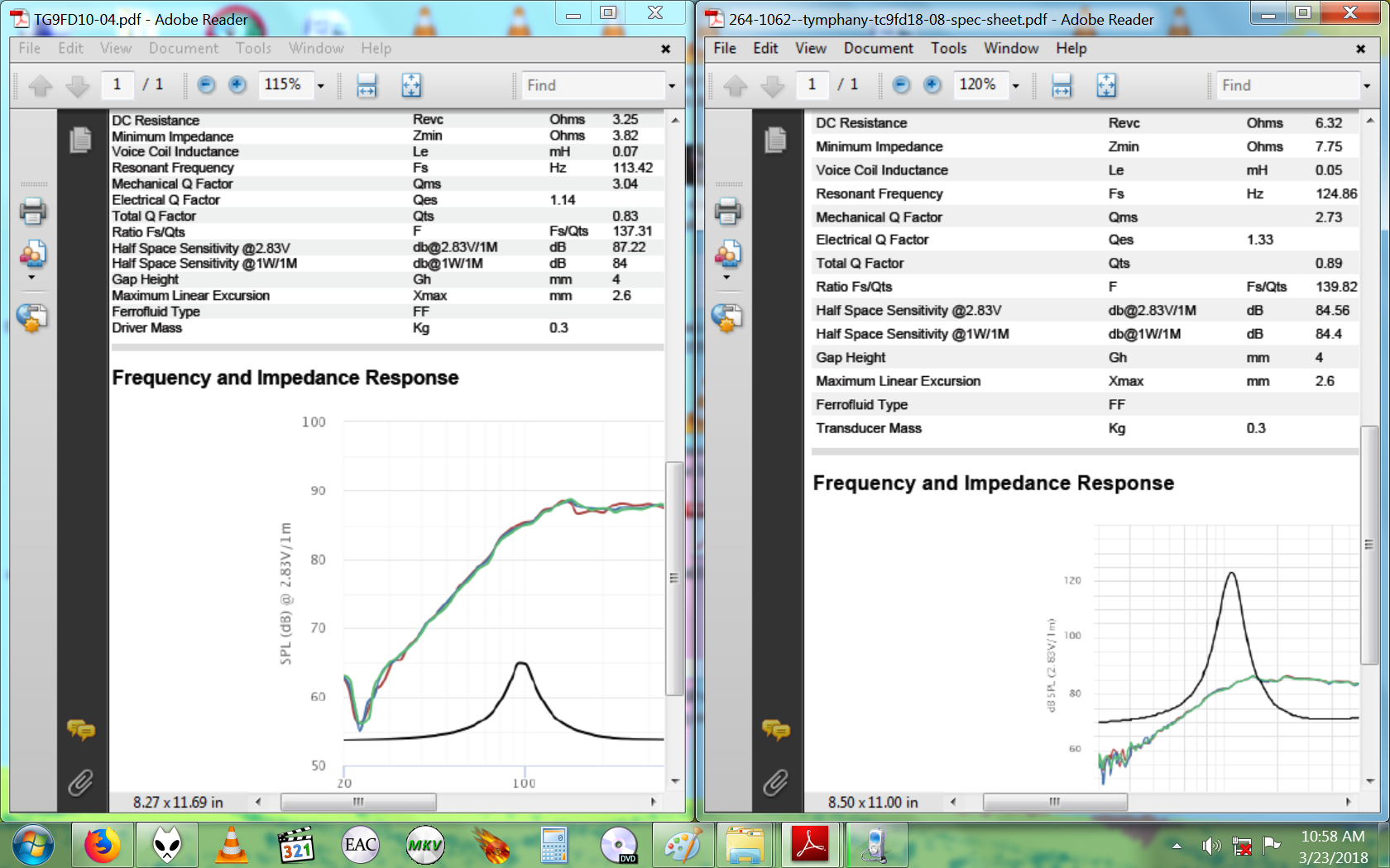

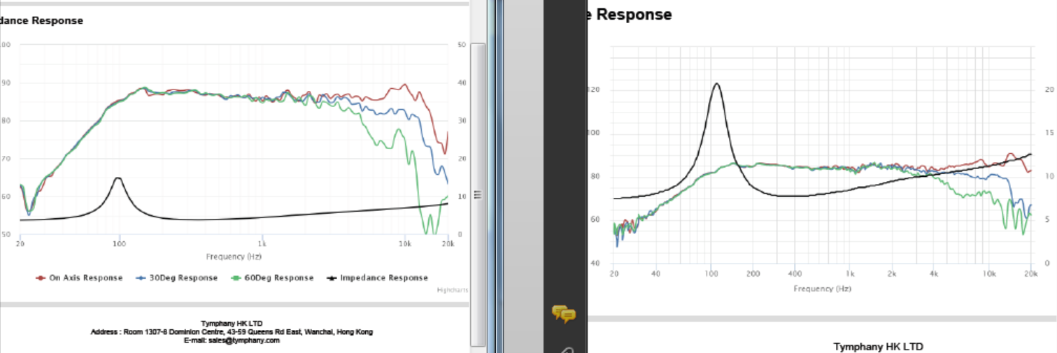

TG9FD drop-in replacement for TC9FD ?
I've got the 4 ohm TG9s, are they a drop-in for the TC9s in all these great designs?
TG TC
Qts .83 .89
Qes 1.14 1.33
Qms 3.04 2.73
Fs 113 125
Vas 1.29 1.24
View attachment TG9FD10-04.pdf
View attachment -tc9fd18-08-spec-sheet.pdf
TG TC
Qts .83 .89
Qes 1.14 1.33
Qms 3.04 2.73
Fs 113 125
Vas 1.29 1.24
