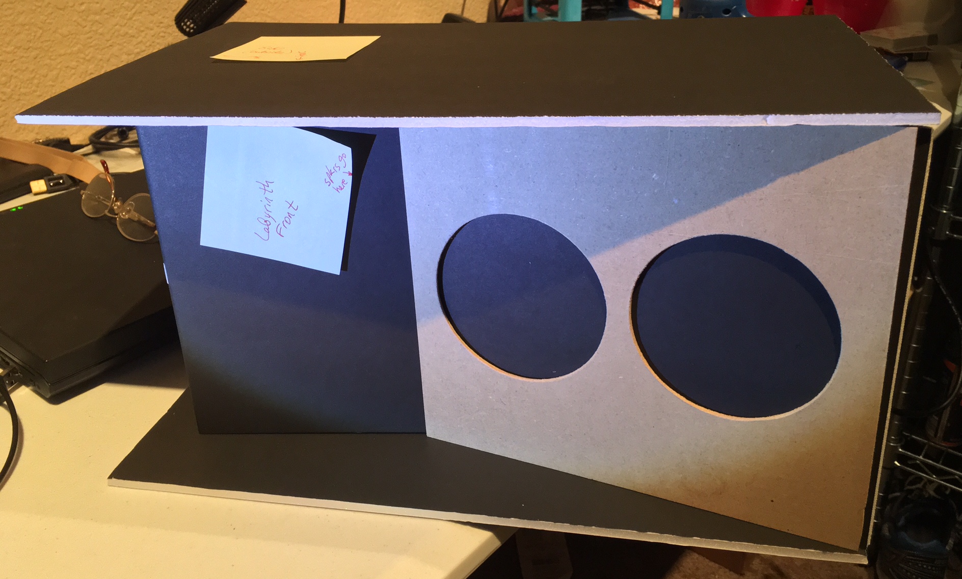

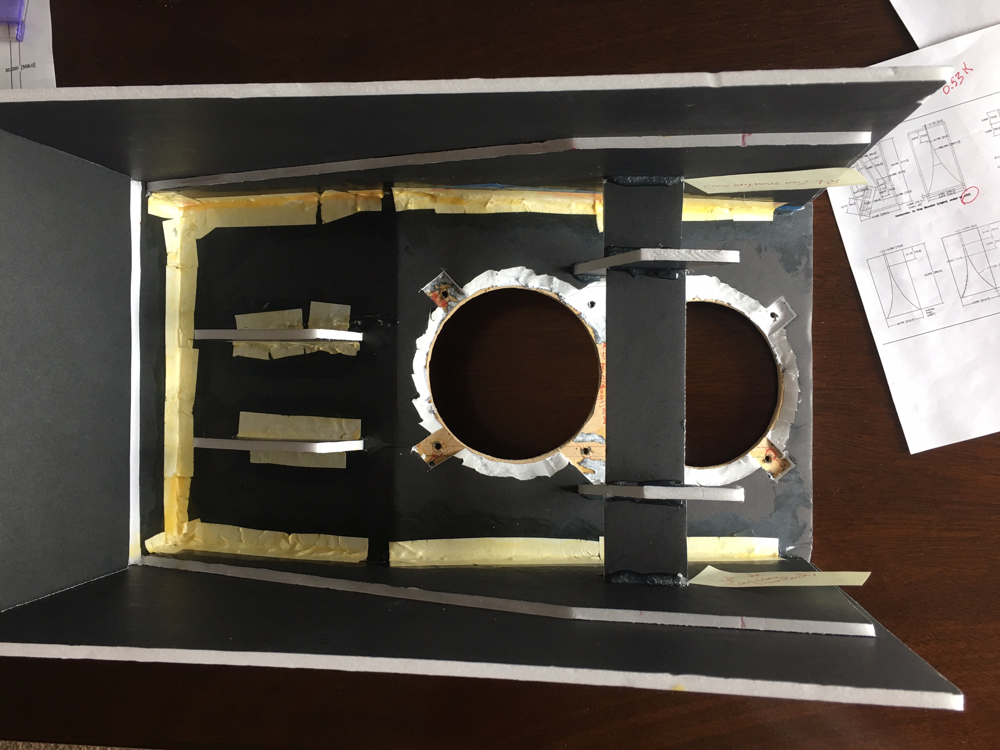

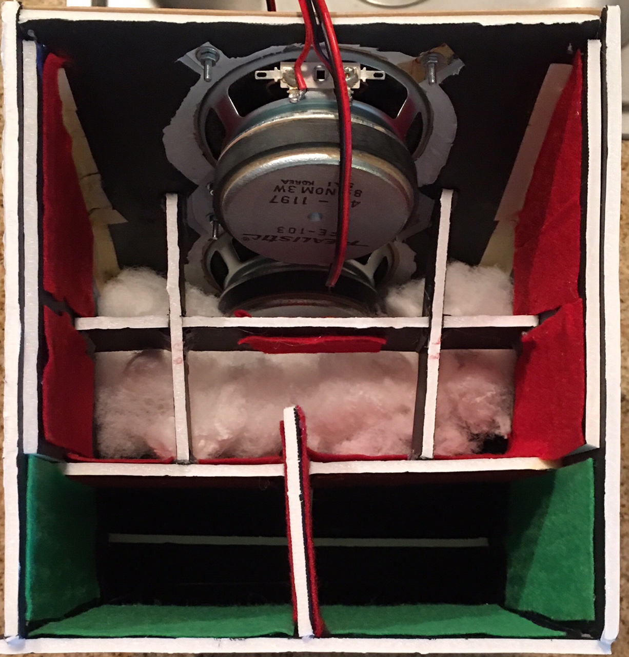

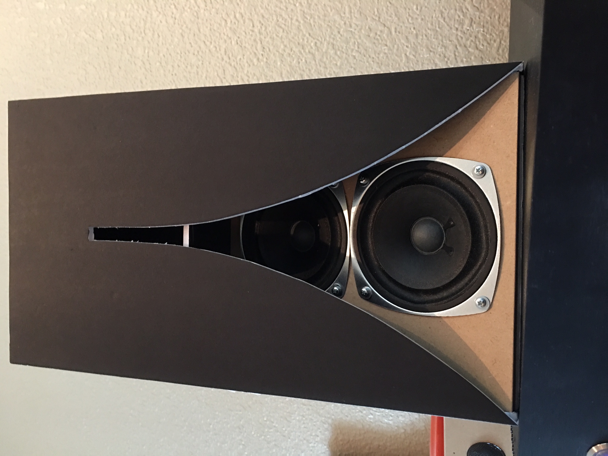

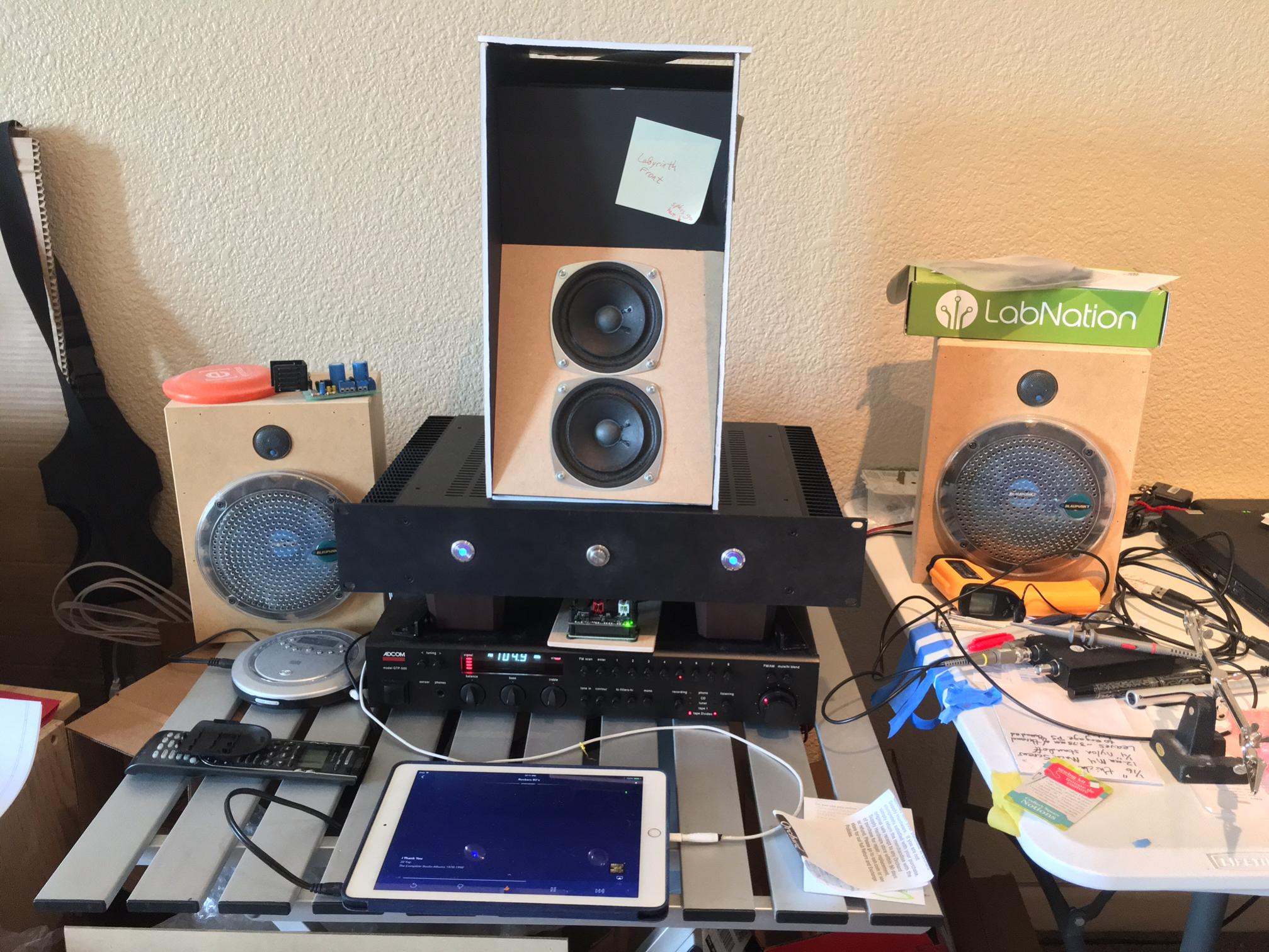

Ok, I finished my Karlsonator dry run with a pair of old Radio Shack FE-103 4" speakers.

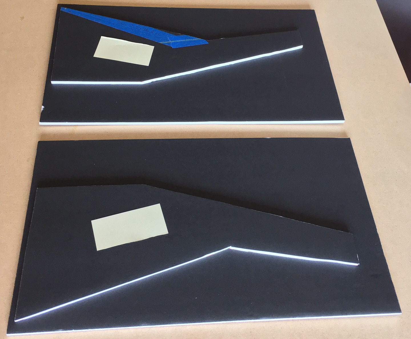

My first concern was having something to keep the labyrinth in place, so I cut a piece of foam to go just inside the labyrinth so I could glue one to each side and put the speaker together with both sides in place.

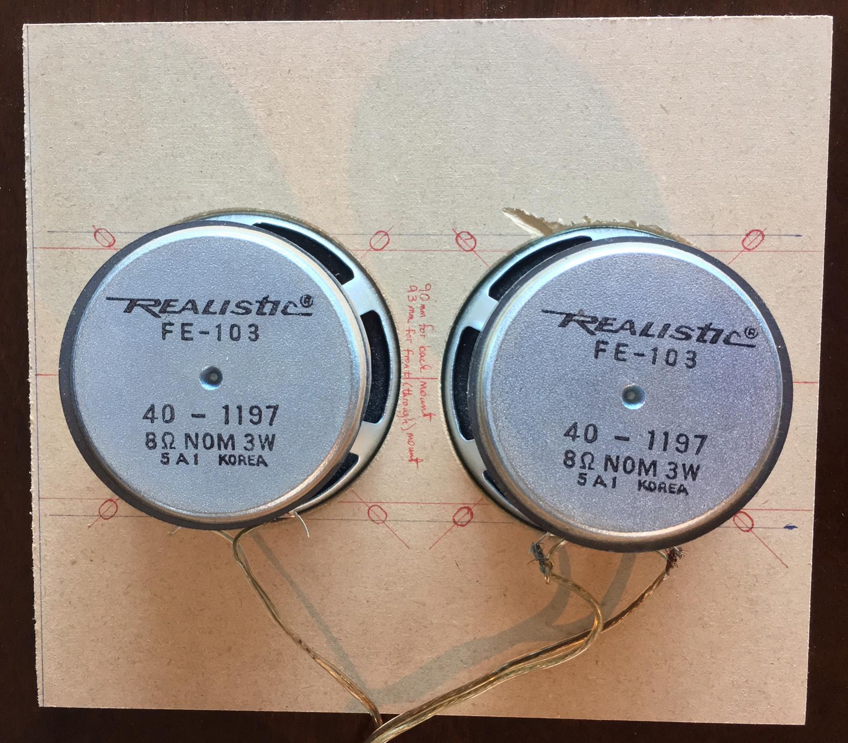

I followed the plan, but had to make a modification to fit the bigger speakers in. I used some paper (with the speaker size and shape included) into the space where the bottom of the labyrinth would go and then re-cut the foam brace. The blue tape is holding the part I cut off in place, while I re-cut the guide panel.

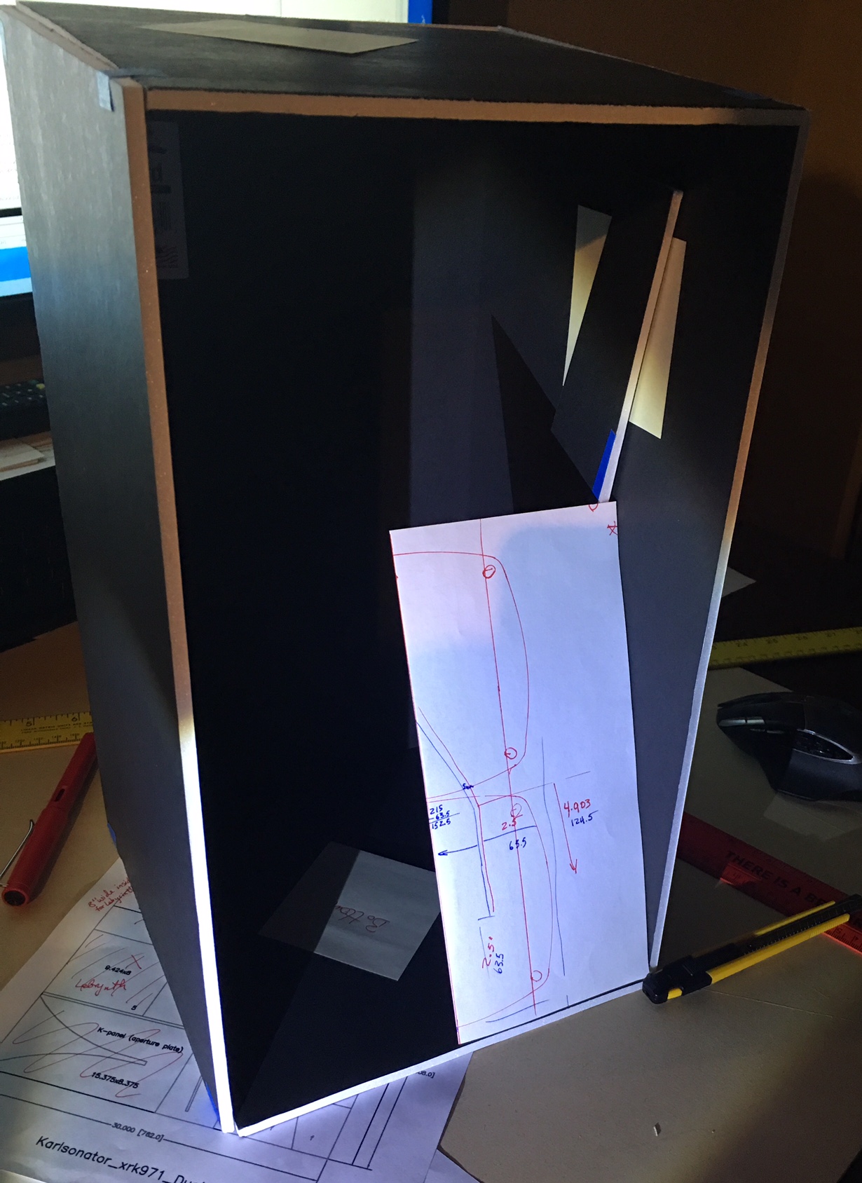

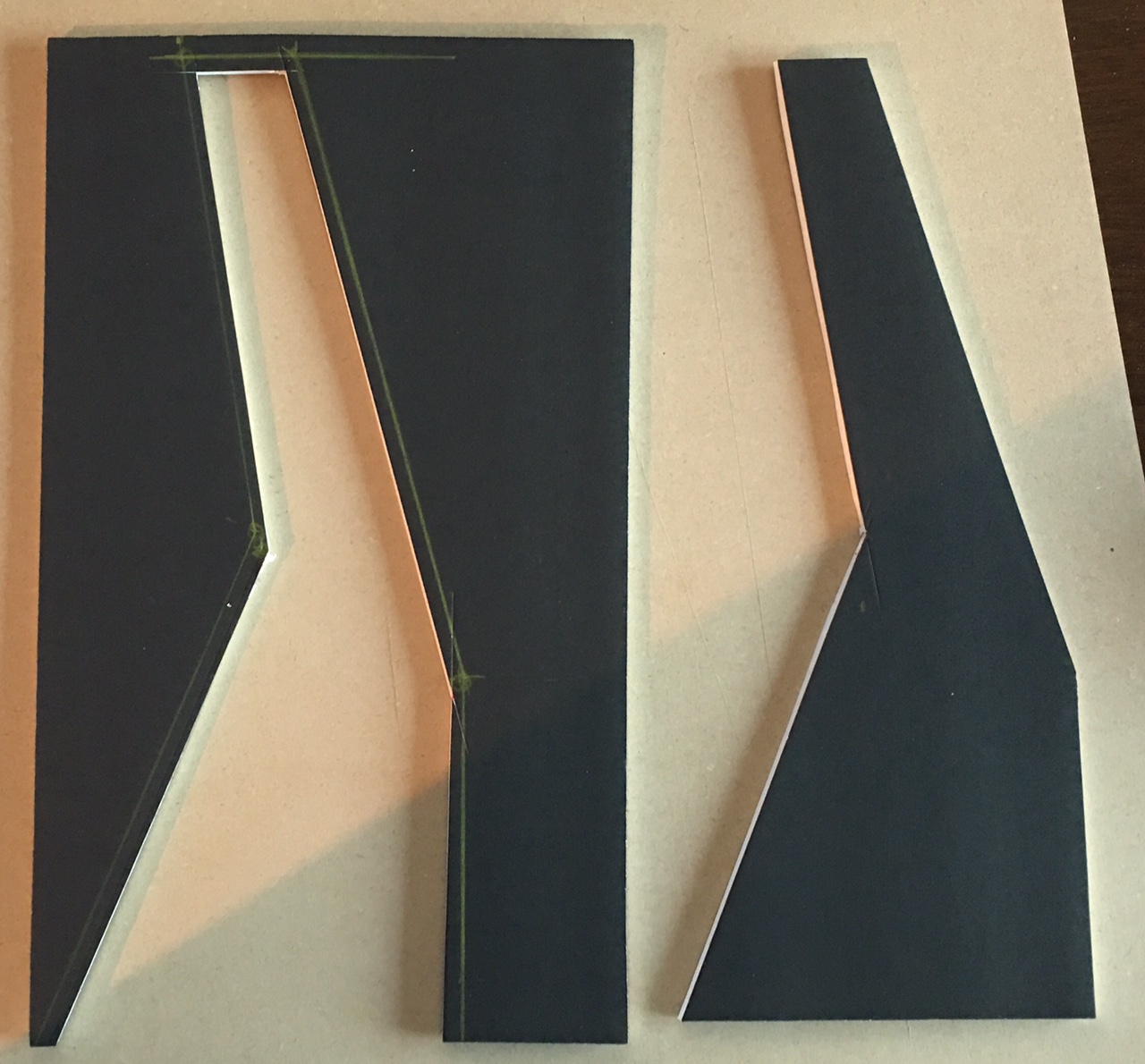

I glued the guide panels to each side and then started marking, cutting, bending and fitting the labyrinth. Then it was glue time. I thought it would be useful to tie the two sides of a butt-joint with some paper and glue (kind of like drywall tape), but it was a slow, messy and tedious bit of over-engineering.
The plans I had did not have dimensions on the braces, so I free-form cut them and glued them in as I went. Instead of regular glue, I want a little crazy with the hot-melt glue sticks. At 20 4" sticks for a dollar, how could I go wrong? (We'll get back to that later)
I used a drill and drill bit, circle cutting saw and a file to get the speakers settled in, and after a test fit, glued the wood (1/8" Masonite) to the labyrinth. Then a quick transfer of holes to the foam, a couple quick cuts, and we're ready to test fit the speakers.
Testing was done at different levels of completion, each one sounding better than the last. However, until it is sealed up tight and the K-aperture is on, you really aren't hearing the true beauty of this speaker.
Onward to finishing the bracing, adding some felt and pushing in about a quarter bag of 'acousta-stuff' (what can I say, 4 drivers was just $76 bucks, had to get to $100, right?) and I sealed it all up. The penultimate shot is of the speaker sitting on top of the ACA box, getting "burned in"... Nah, I took it off before it started to smell bad or melt the glue. 8)
Remember when I said what could go wrong? Don't click on the last picture unless you like seeing second degree burns from hot glue. Lesson learned. Don't grab a falling piece of foam after slathering it with hot glue - you might just catch it! And no, that's not glue, just the blister... But don't worry, I'm pretty sure I'll live. 8)
