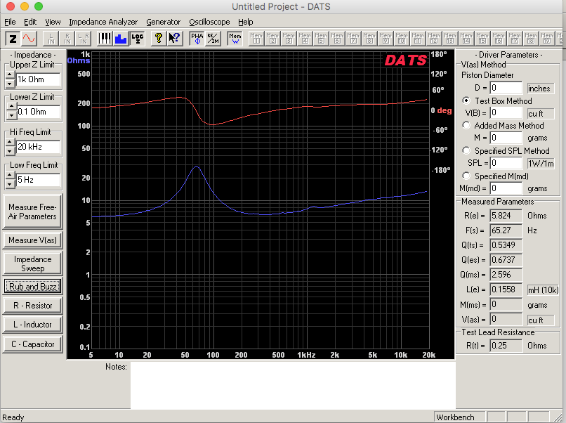

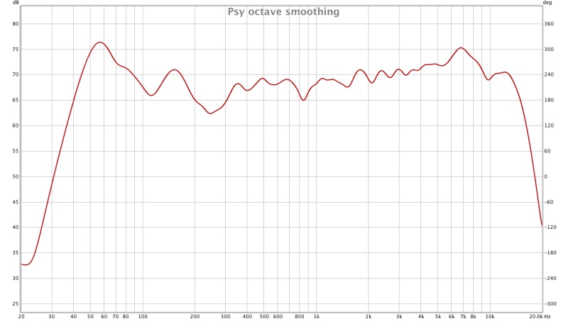

Hey X,
I've had this little driver around for a while.
It's not very special, besides the fact that it only needs a very small correction to get it pretty flat up to 12kHz, where it drops into oblivion after that.
It also was too boomy in the TABAQ, with huge spikes at 55Hz in the original dimensions (see the graph).
So, I thought it might fare well in a mini-K.
I haven't done the test for Vas yet... I know...
But at first glance, you think there's a chance this might work?
No rush on this... if you don't mind, whenever you have a moment in your busy life!

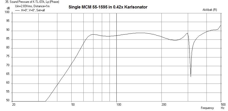

The MCM 55-1595 has a very low Vas and the only Karlsonator that works is a 0.42x with a single driver. All configurations with multiple drivers will require a box that has too much volume in order to fit the multiple bezels in. As a single driver unit, it has nice response and can handle a lot of power and good 88dB sensitivity.
