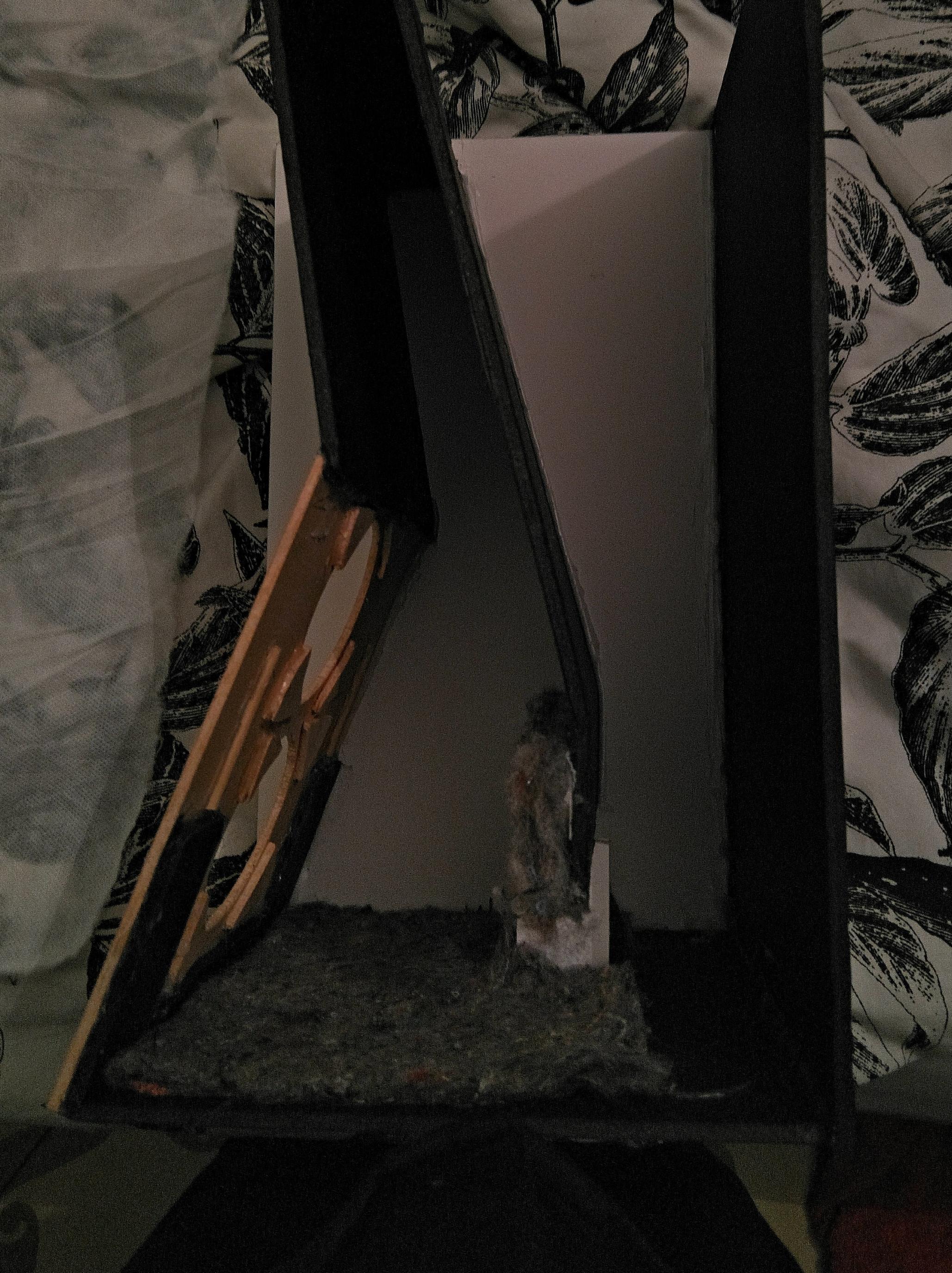

Do you have felt or foam on all walls immediately behind the driver? Without that t might sound boxy. Also, try adding somd felt to the inside face of the K aperture is still sounds boxy.
I'll try with some felt behind the aperture !
I have a picture of the felt placement and the baffle attached, how does it look?
And the way I applied the baffle, could that have any negative effects on the sound(foam board folded from bottom and attaches to the liteply on the edges)?

Didn't you stuff the space above the speakers with polyfill or something like that? Maybe that's where the boxy sound comes from.
+1
Guaranteed to sound funky if not stuffed here.

The picture is before bracing and stuffing, the felt was not even glued in place.
Maybe I will try that to see whether that makes the sound more pleasurable!

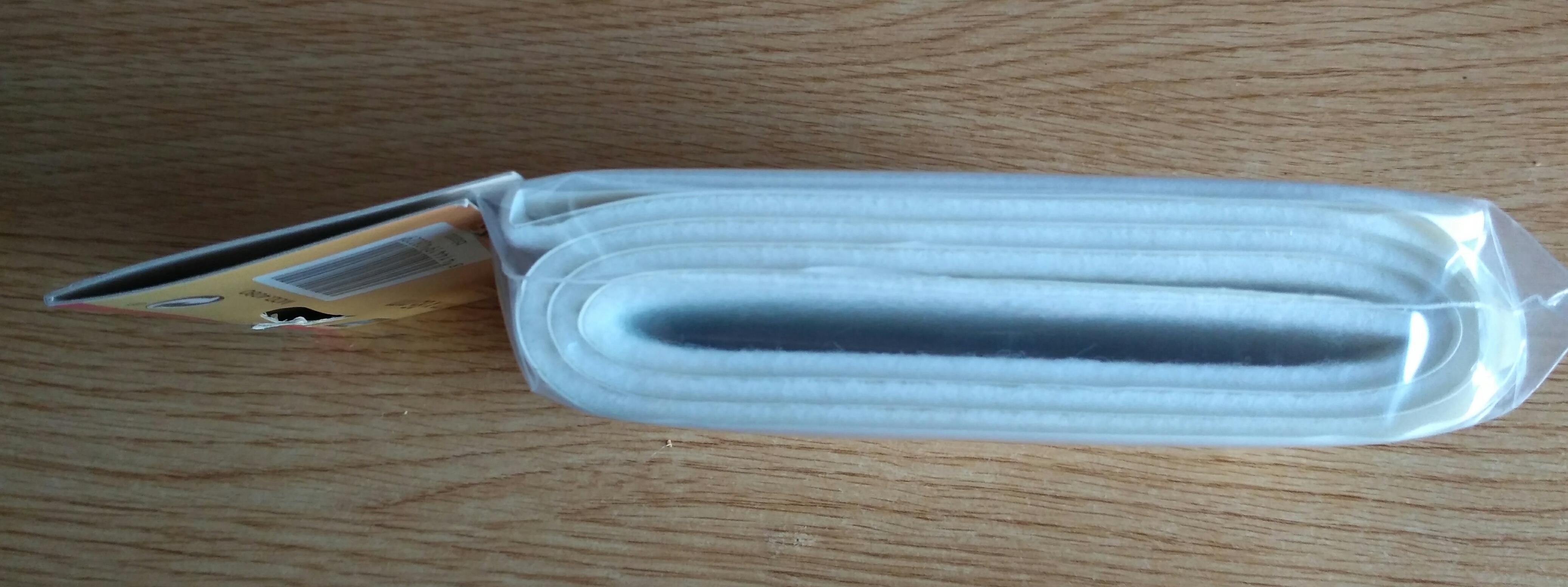

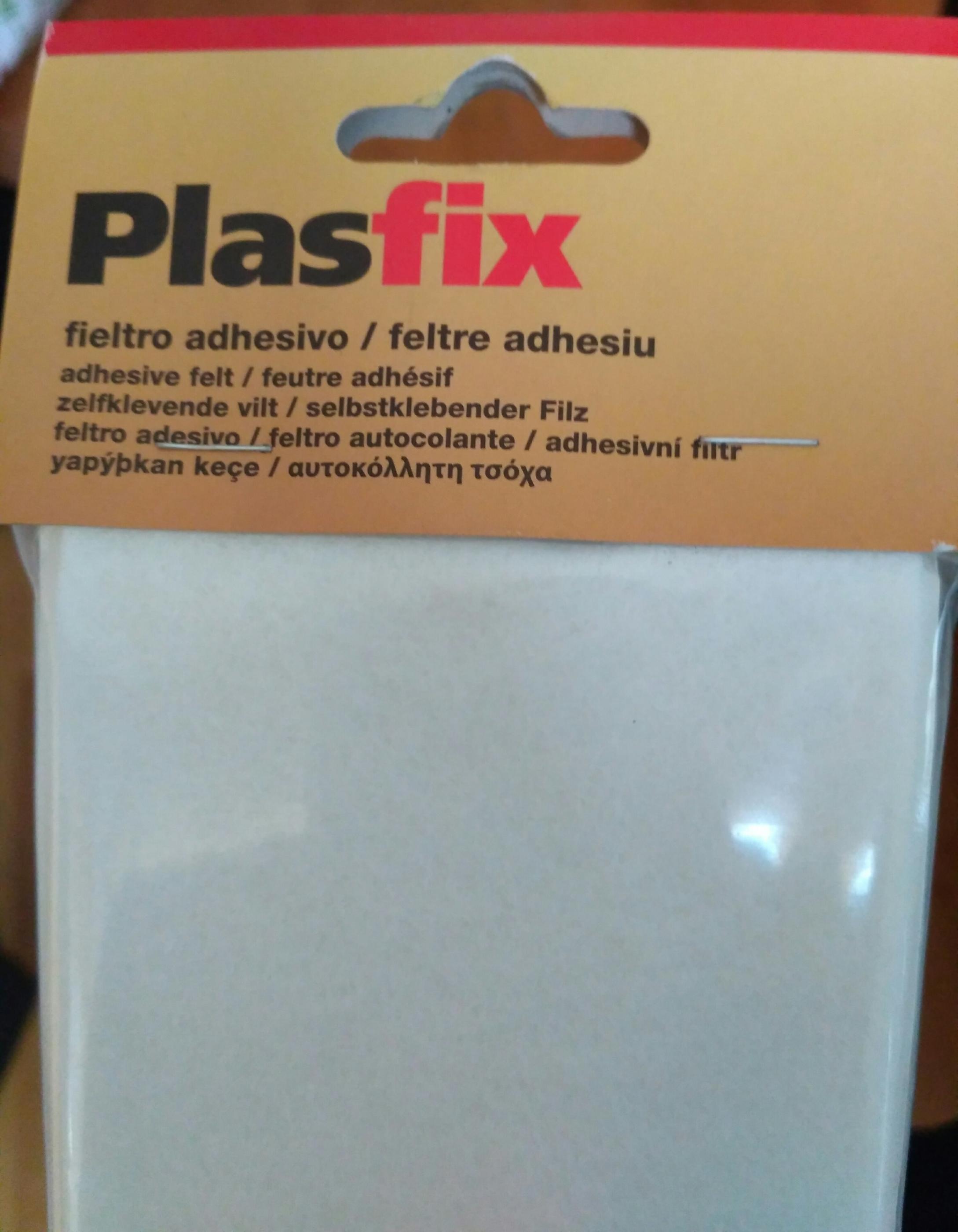

About the felp, I bought this, would it be good enough?
About the air leaks you are mentioning to hehejaa, I thought that it could be a good way to ensure every joint leaving in one of the pieces one of the paper side a bit longer, and overlap the other piece with this paper tab gluing all together... Unless somebody says something bad about this technique, I will try later.
