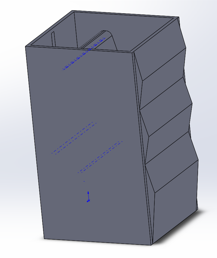

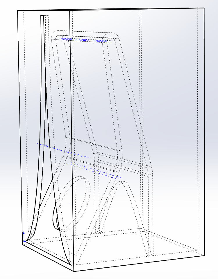

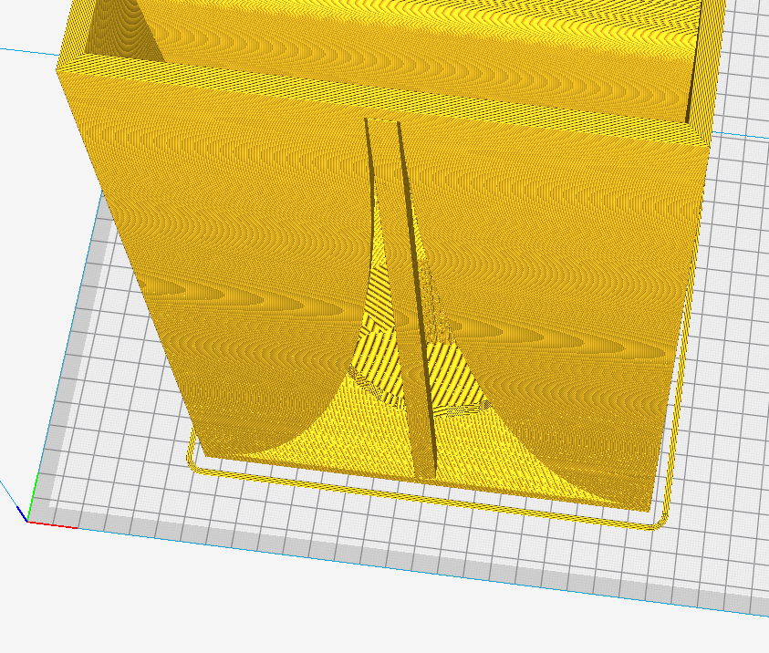

I just bought a somewhat large-volume 3D printer at 300x300x400mm. I have a couple TC9FD's kicking around from foamboard spiral horn builds a couple years ago, and I've wanted to print something for them.
I was browsing TC9FD ideas and came to this thread, and I've been working on modifying the design to be 3D printable with minimal supports.
Here's what I Have so far. I've modified the bottom opening so that it's printable, but with the same area as the original design. It would be printed upright, including the sides, but not the top as it isn't printable in this orientation.
I welcome any thoughts, criticism, feedback etc before I start printing. I've smoothed some of the edges/etc, but is there anything else I could/should do since I'm not constrained by foamboard?
Thanks in advance!
(would be happy to provide the Solidworks files for anyone who'd like them)
The design:
The slicer view (note the supports for the arcs and front panel:

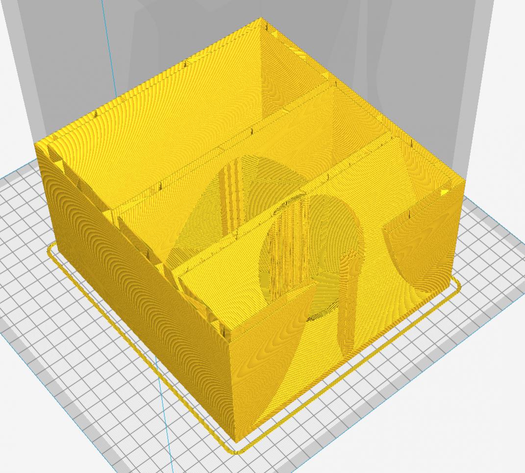

![2018-03-18 16_23_29-Ultimaker Cura.jpg 2018-03-18 16_23_29-Ultimaker Cura.jpg](https://www.diyaudio.com/community/data/attachments/601/601096-9a96f03b69326212da733c9f50d425f2.jpg)
![2018-03-18 16_23_44-Ultimaker Cura.png 2018-03-18 16_23_44-Ultimaker Cura.png](https://www.diyaudio.com/community/data/attachments/601/601111-58fa2b352fbbc0bccf7a13b3dc5dad67.jpg)
Great idea - but you need to add braces between the large panels. There should not be any span larger than 2-3in without a brace. Since printing - I would print “foam” panels by making interior porous - maybe 30% fill and sheathed by 3 layers of solid to make airtight. This saves filament and makes it faster to print and gives property similar to foam core which sounds better than plywood.
Thank you for the reply and helpful information.
If my understanding is correct, the braces are to prevent flex and especially resonance?

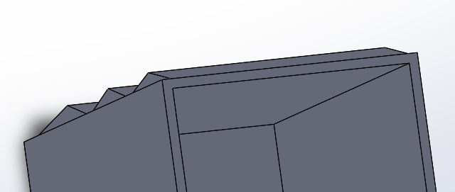

If this is the case, out of curiosity would non-uniform panels resolve the issues? Something like this (smooth on the inside):
![2018-03-18 17_13_08-SOLIDWORKS Premium 2017 x64 Edition - [ribbed.SLDPRT _].png 2018-03-18 17_13_08-SOLIDWORKS Premium 2017 x64 Edition - [ribbed.SLDPRT _].png](https://www.diyaudio.com/community/data/attachments/601/601210-92c9aacbcb60108c2ddb931f1b492638.jpg)
![2018-03-18 17_15_21-SOLIDWORKS Premium 2017 x64 Edition - [ribbed.SLDPRT _].png 2018-03-18 17_15_21-SOLIDWORKS Premium 2017 x64 Edition - [ribbed.SLDPRT _].png](https://www.diyaudio.com/community/data/attachments/601/601229-bcb9ed55e5af27ce496ef258101b8b84.jpg)
