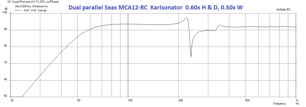

Would a single Seas MCA 12 RC be suitable for the karlsonator?
Very intriguing design and will definitely make one either a Vifa double or a single.
H1304-08 MCA12RC
I just ran the sims in Akabak and you will need to run these in dual driver parallel for a nominal 4ohm load. But the result is very good with 94dB sensitive at 2.83v and nice smooth bass that reaches F6 of 51Hz. Looks like a 0.60x scale in height and depth, and 0.50x scale in width will work really nicely.
Interestingly, a single driver doesn't really work as the box volume and aspect ratio becomes kind of impractical given the Vas. I recommend a dual driver config as shown.
Given the very nice smooth response of the Seas driver used here, I predict this could be one of the nicest sounding Karlsonators if you were to builld it.

These SEAS unfortunately, don't have much Xmax. Keep the pair under 4Vrms (4W) to stay below Xmax of 1.5mm, but that is 97db at 1m. Plenty loud for most listening I think.
If you want to keep it budget then a pair of TC9FD for $20 will be the way to go.
I'm more after sound quality than quantity.
I have ordered both 4 TC9's and a pair of Tang-band W5-2143. How does the former compare to the
W5-2143 XKi's?
The predicted response of the dual SEAS is what I would call very high quality. It has a mild roll off that will sound very smooth and deep when combined with room gain.

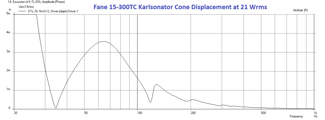

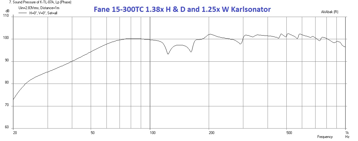

A member asked me to see if the Fane 15in fullrange (15-300TC) could work in a Karlsonator. It can but requires a very big one. Scaled 1.38x in height and depth x 1.25x in width. It will get 100dB sensitivity and have F3 of 57hz and F6 of 49Hz. Max output of 113dB is limited by 3.5mm Xmax at about 13Vrms (21Wrms). Response is surprisngly flat though.
Predicted freq response at 2.83v and 1m:
The very gradual slow roll-off in bass will integrate nicely with room modes to produce bass down to 30Hz easily.
Here is the predicted cone displacement for 21 Wrms:
I think you will be hard pressed to find a more sensitive full range speaker for nice loud bass that should be room filling and powerful.

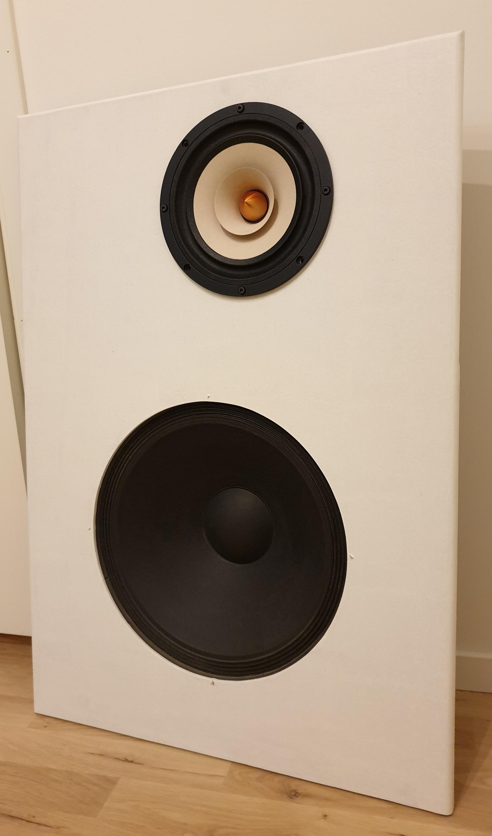

Too late, i have finalize the cabinets for Fane 12-250TC.
Never i had the knowledge that a Karlsonator cabinet would work using this speaker.

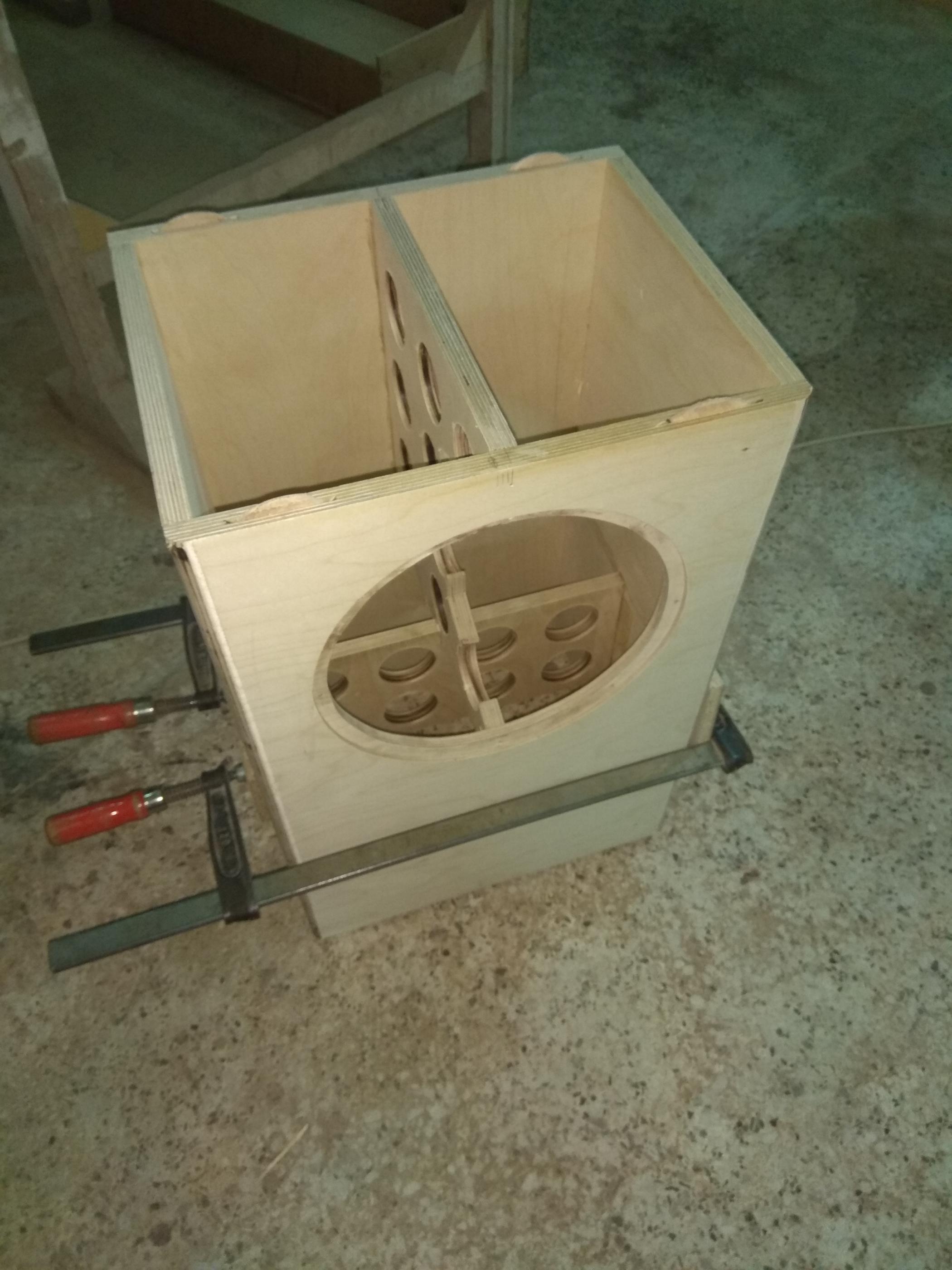

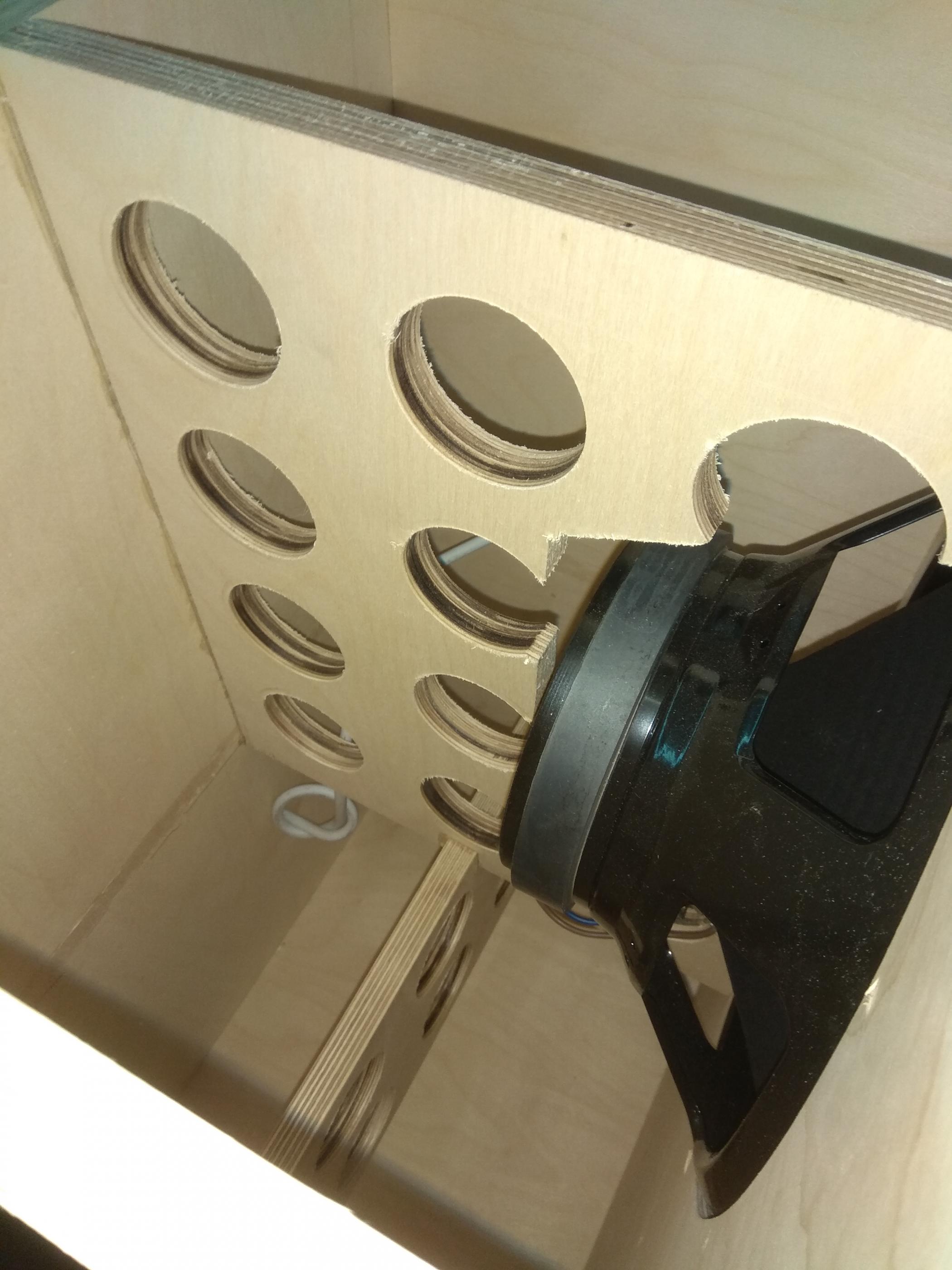

X, cabinets are sealed. I'm looking for suitable damping material and a microphone for measurements.Thimios,
Your cabinet looks great. Is it vented or sealed? With the high sensitivity this driver has, it will sound amazing in a variety of alignments. I always thought the cabinet would be too big, but this Karlsonator is not huge huge.

Wow. Where can I find the actual dimensions for this?A member asked me to see if the Fane 15in fullrange (15-300TC) could work in a Karlsonator. It can but requires a very big one. Scaled 1.38x in height and depth x 1.25x in width. It will get 100dB sensitivity and have F3 of 57hz and F6 of 49Hz. Max output of 113dB is limited by 3.5mm Xmax at about 13Vrms (21Wrms). Response is surprisngly flat though.
