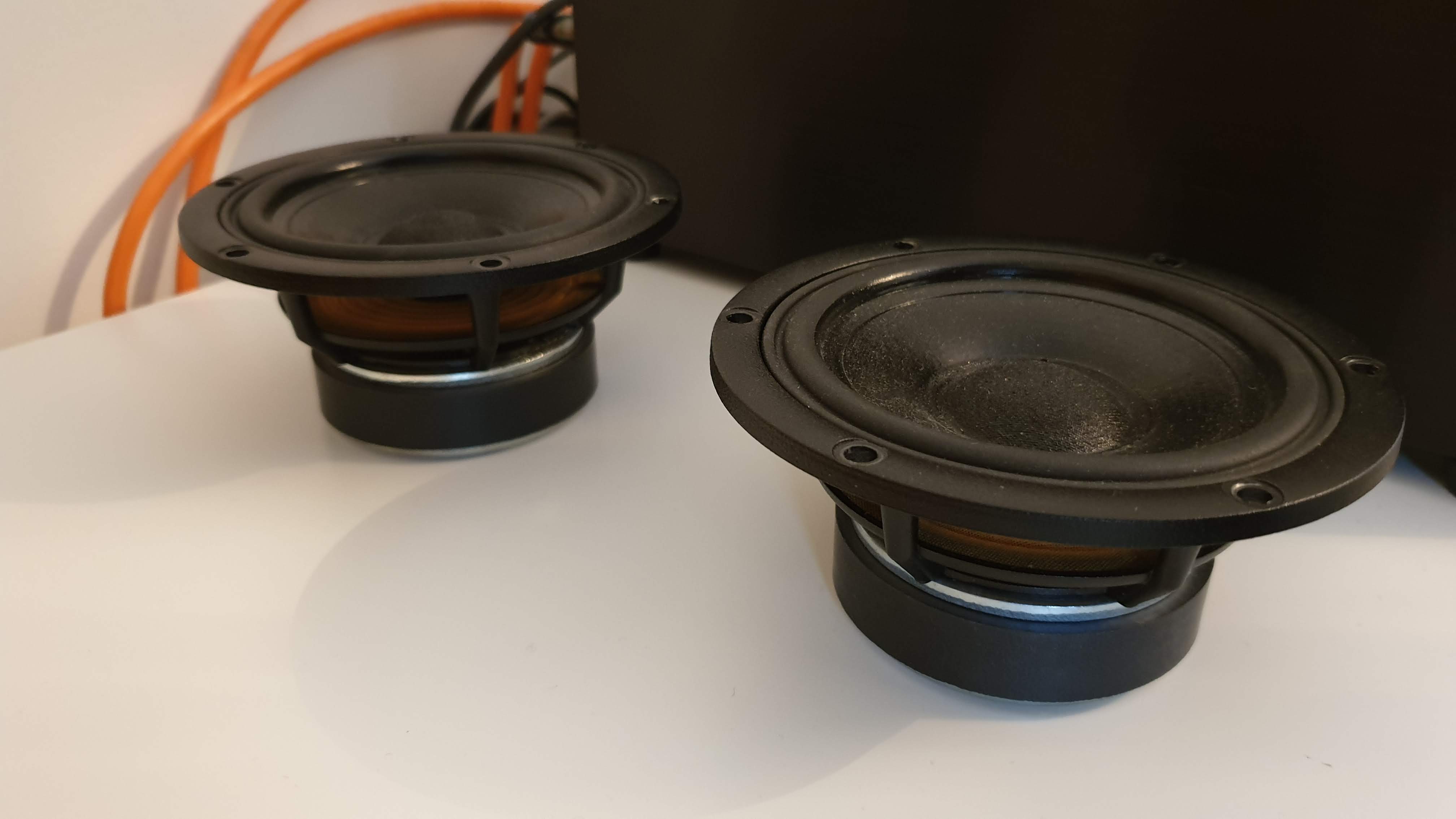

Seeing as I have only 2 drivers at hand, at can't easily get hold of 2 more (can you imagine - Norwegian Seas does not have a Norwegian distributor at the time being!), I am wondering if I should try to build one Karlsonator or two XKi's.
Try a 0.50x in H & D scale and 0.40x in W scale single driver Karlsonator for the Seas MCA-12RC. It should get -3dB at 60Hz and 87dB sensitivity.

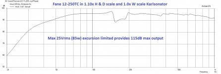

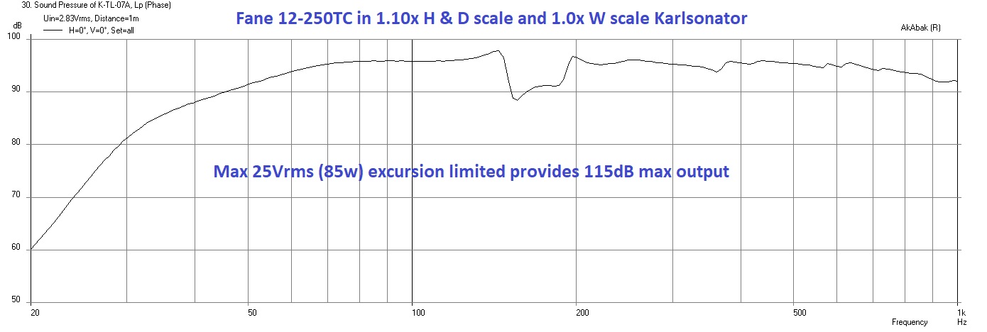

Try the Fane 12-250TC in a 1.1x in H & D scale and 1.0x in W scale Karlsonator. Should be 96dB sensitive with a very shallow bass rolloff like the 15in Fane and -6dB at 45Hz and -3dB of 56Hz. But still has -10dB at 35Hz - so very extended response. Should work well. The K-aperture will also have the natural ability to shape that rising response and remove that harshness without any electronic EQ. The model shows a typical "Karlson W" dip near 350Hz. I am not sure if the real speaker will have as deep of a dip - generally they don't so I would not worry about that too much. Often adding damping foam on the inside of the front chamber can help reduce this.

Much appreciated! I wil try a singel first to see what it sounds like in stereo, then consider a dual.
