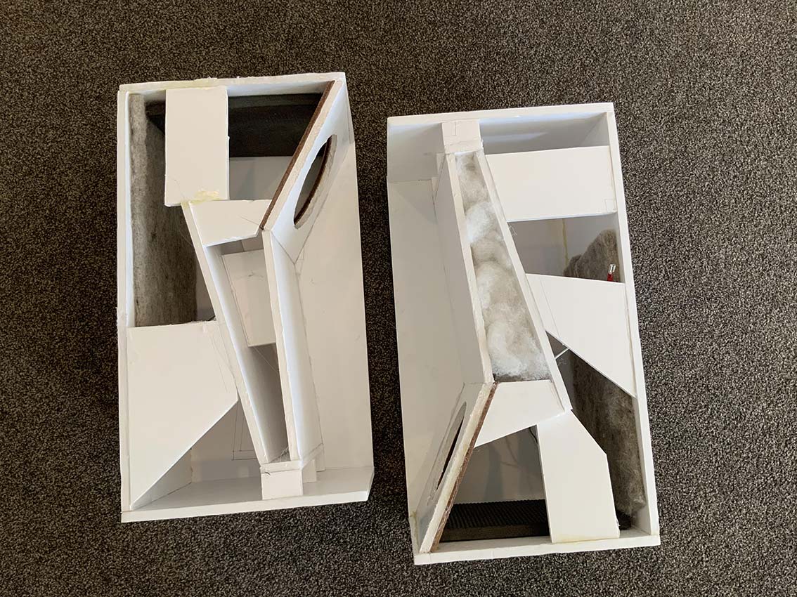

So in yet another weekend of lockdown, the final one thank goodness, I have had the opportunity to finish the 0.53x Karlsonators with W5-2143 drivers. Well, I will have by tomorrow, but once the glue dries I can at least fire them up tonight.

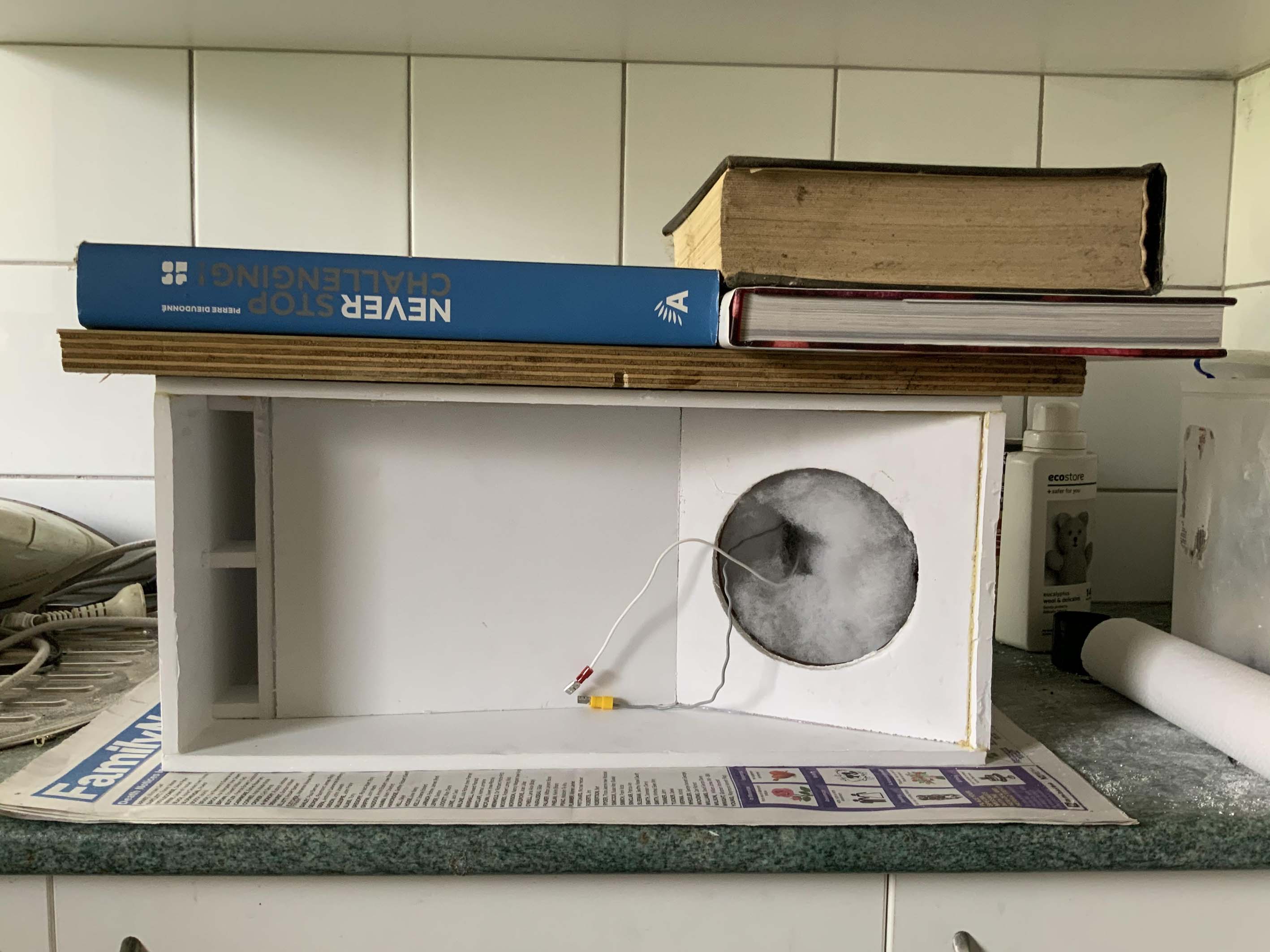

Because it is a bit trickier getting 1cm foamboard to align vs 0.5cm, I opted to use foaming glue for the final side panel. It isnt the best because it dissolves the foam but the paper bits stick nicely and you can be fairly sure that any gaps that were there before are no longer. It's just that it takes an awful lot longer.
My glue gun would have been way too slow for this panel. So Gorilla glue it was.
Seems to have worked nicely but you have to watch it for the first hour or it drips everywhere and foams out of all the joints. It also discolours white foamboard. But it does the job.
So just driver installation and the front to go now. Pics in a min. Got to take dogs for a walk.

So here was progress a few hours ago. Still drying and wont be ready to play til tomorrow. Then it is just a matter of cutting out the Karlson slot and attaching that.
Not sure how much if any bracing or sound absorption material I need to apply for this panel though. It's pretty rigid being 1cm thick.

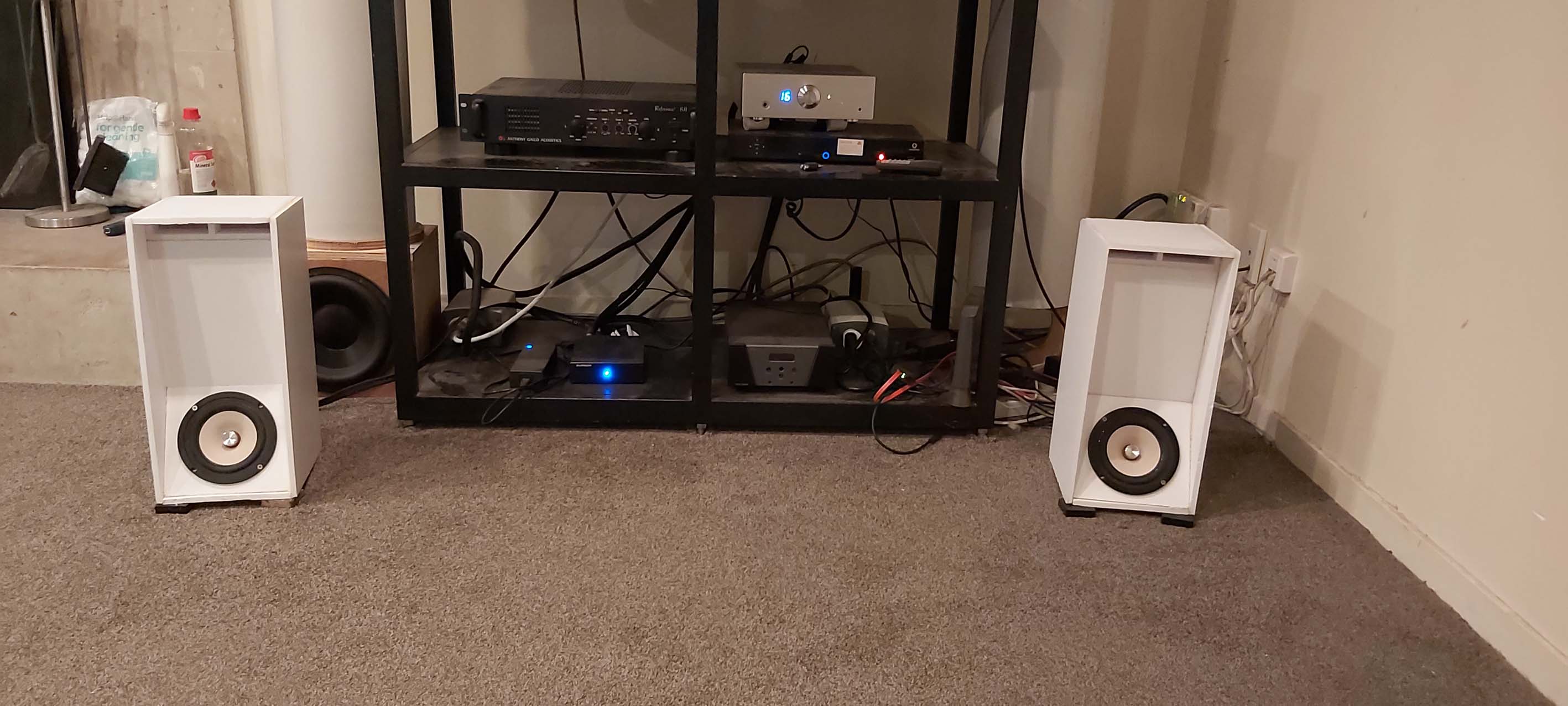

Been listening to the 0.53x for a few hours now and they are simply wonderful, even without the slots yet. Such a great balance. Love the bass from these, and the W5 is not exactly renowned for its bottom end. Imaging is great too. Im so glad I persevered with the build because for a while there I wasn't sure it was going to work out.
Many thanks for the steer X. Makes me wonder how a pair of Karlson subs would go with these!

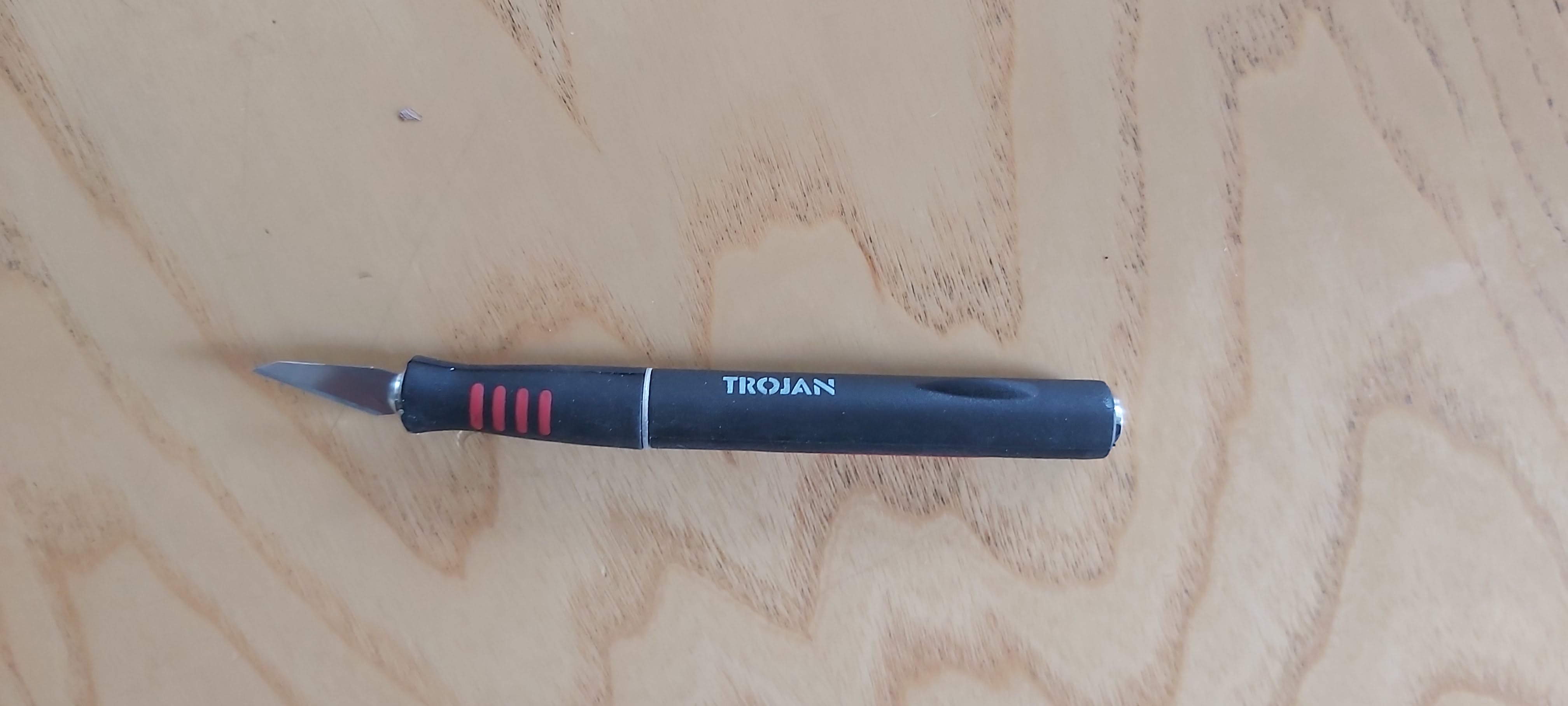

By the by, after all the cutting with a regular kitchen paring knife - a Swiss Army brand like for cutting fruit or veges - I happened across a Trojan scalpel-type knife for cutting the foamboard.
It is incomparably better. Like a surgeon vs a butcher's tool, poor analogy but the difference in cut edges is quite striking. Wish I had discovered this from the get-go.
I imagine this is like an Exacto which is what X suggested I use to begin with....

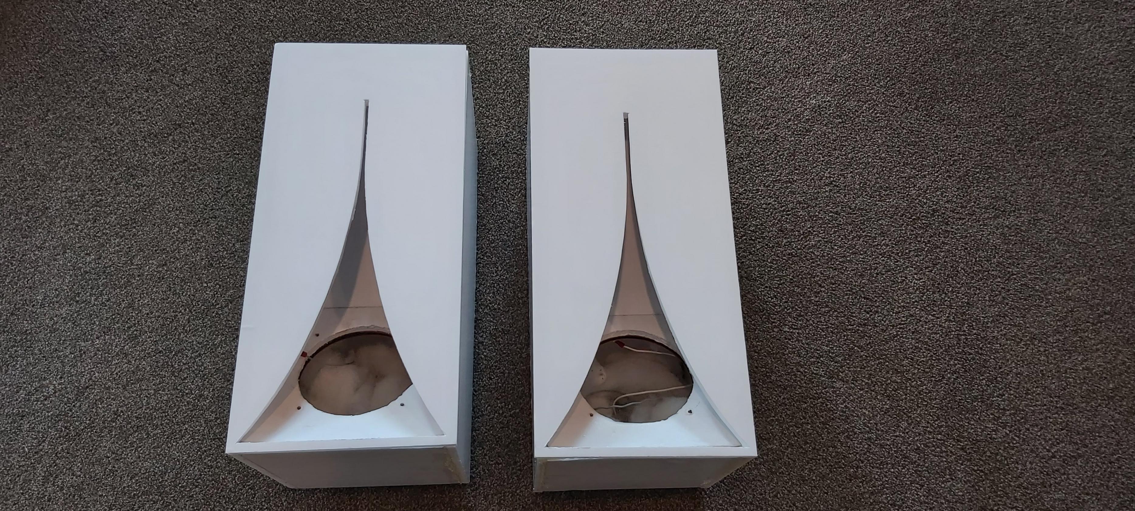

So I simply laid the exact sized templates over the top of the front panels and started cutting with the Trojan scalpel.
Seemed to work out okay.
But Im not quite sure whether the 1cm panels need bracing or not. Probably will.
And what should I use on the outside of the speaker baffle, if anything? Felt, foam or nothing initially?
And finally for the outside screws - I don't need to drill any pilot hole, right? Better just to screw straight into the foamboard, yes?

Thanks for the suggestions X and Freddi.
I had one other thought - will remove the baffle and attack the back of the slot, smoothing off the cut edge to more like 45 degrees instead of 90 degrees and see what effect that has. It means no more cutting but it will perhaps open things up just enough. Then again it may not too.
These boxes do a ridiculous amount of bass; what I mean is the bass is very generous and it is sooo articulate. I haven't yet messed around with stuffing.
I wont initially though because the bass sounded so good without the front panel in place. The slot certainly does make imaging wider, if a bit more muffled.
Overall my boxes probably sounded better with the slot off than on, though there is even fuller bass with the slot in place, no question.
Anyway, there are clearly lots of tuning options available here. So I will take little steps.
The nice thing is I can try different variations of slots quite easily; just a matter of a bit of foamboard cutting!
