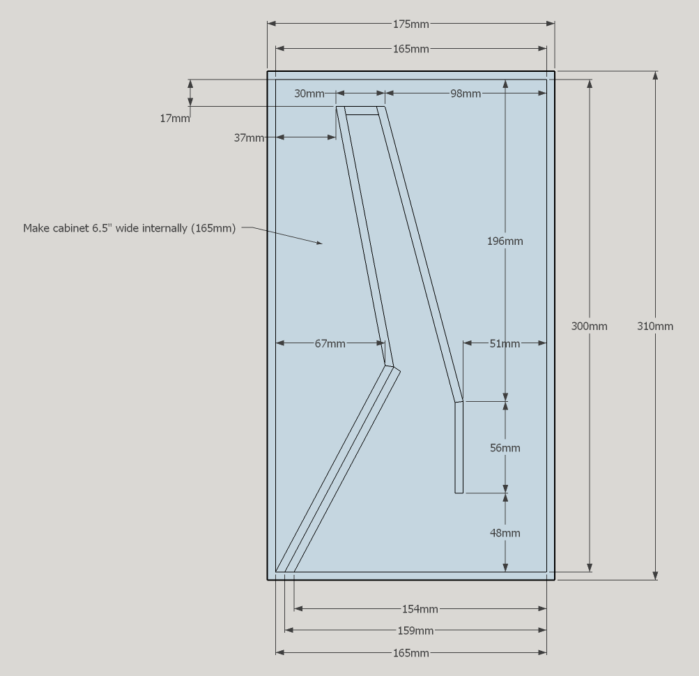

I was collecting data, I'll pass you everything I found from 0.40x.I was recently gifted a pair of 3fe25 and thought that I would make a pair of foam board Karlsonators. I've been looking through this thread for a while trying to find plans for the cabinet. Is this one in the first post the plans for the single 3fe25 version?

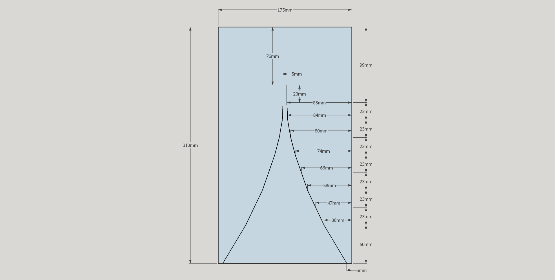

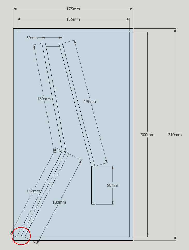

The measurements you put in don't match the measurements MuddJester posted on their pdf.
I was looking at it and if it is true that there are measures that do not match, let's see if the most knowledgeable take us out of doubt. I am also waiting for the drivers to make a 0.40x. I'm not sure about the thickness either, one seems to be 10mm and the other 5mm
I was considering doing this on a .40x. I got a few sheets of 10mm foam board, so doubling this on the driver baffle ends up being very thick. My plan was to glue 6mm ply to the front of the driver baffle. There's probably some different folding measurements to be considered when working with 10mm foam core. As far as I know, the "throat" measurements need to remain the same.I think a good "upgrade" is to use Lite Ply for the driver baffle

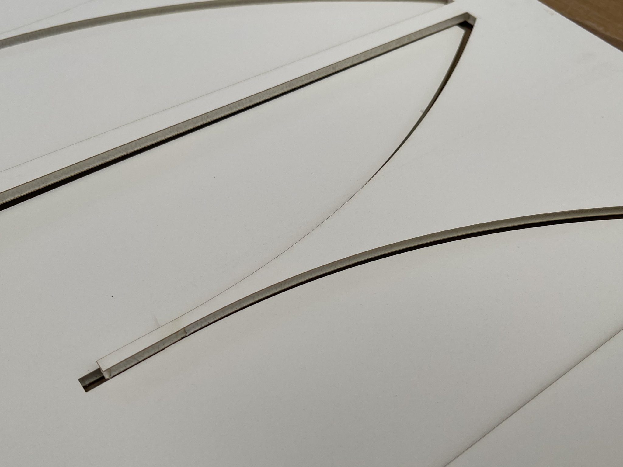

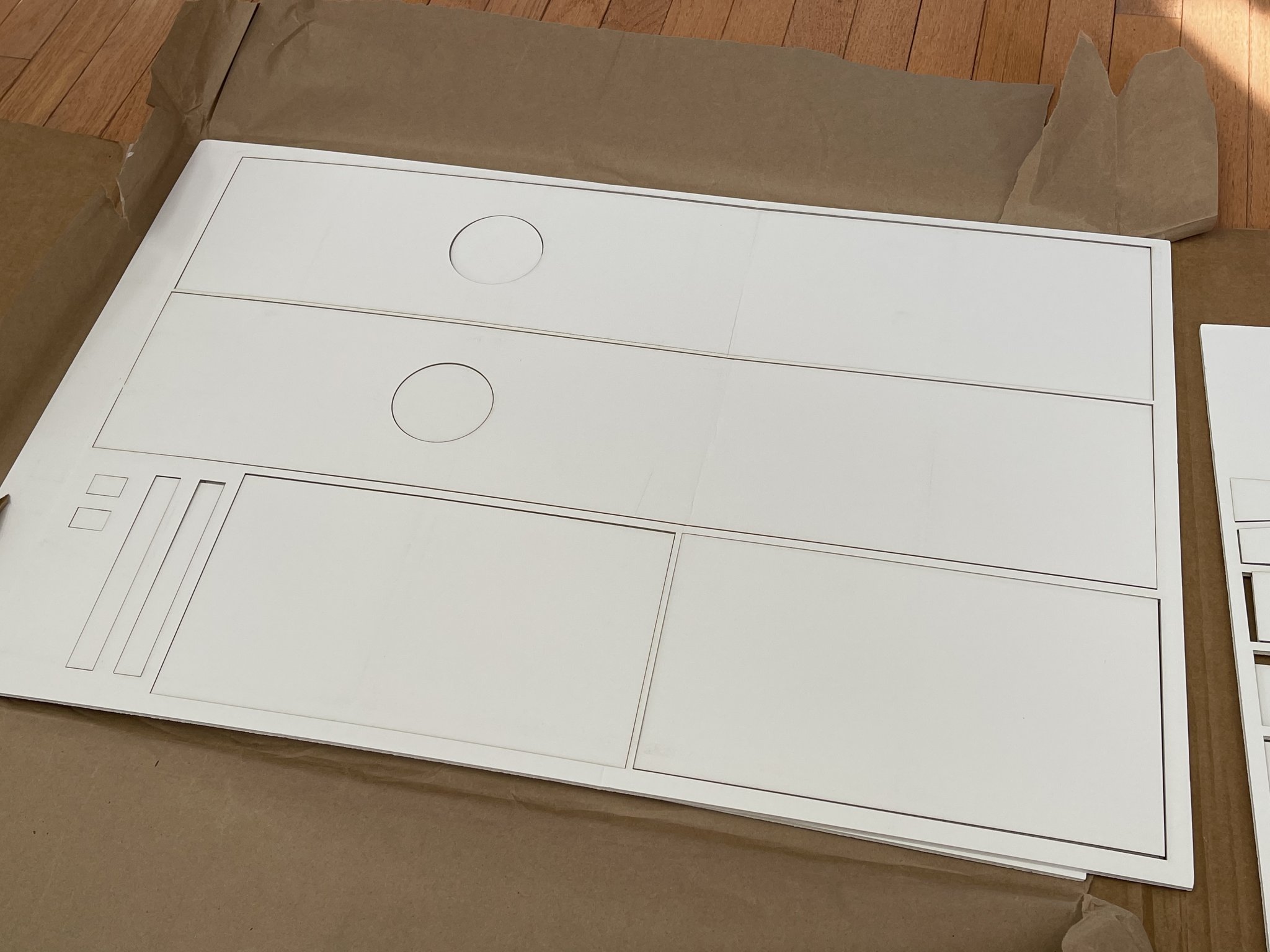

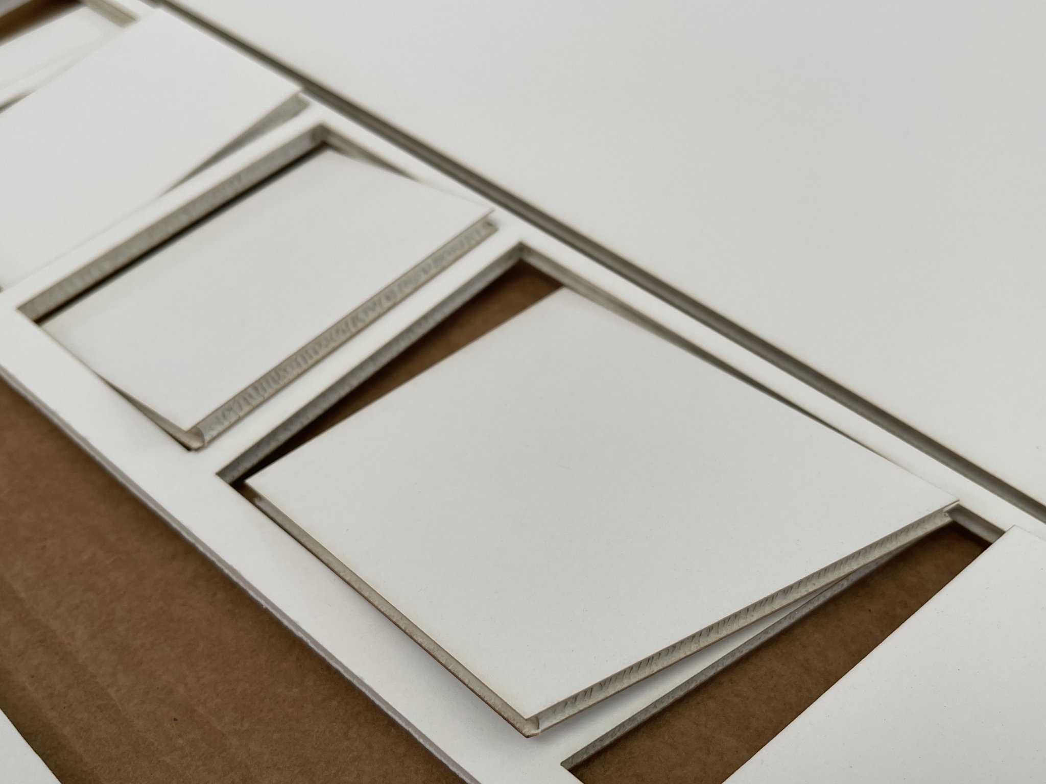

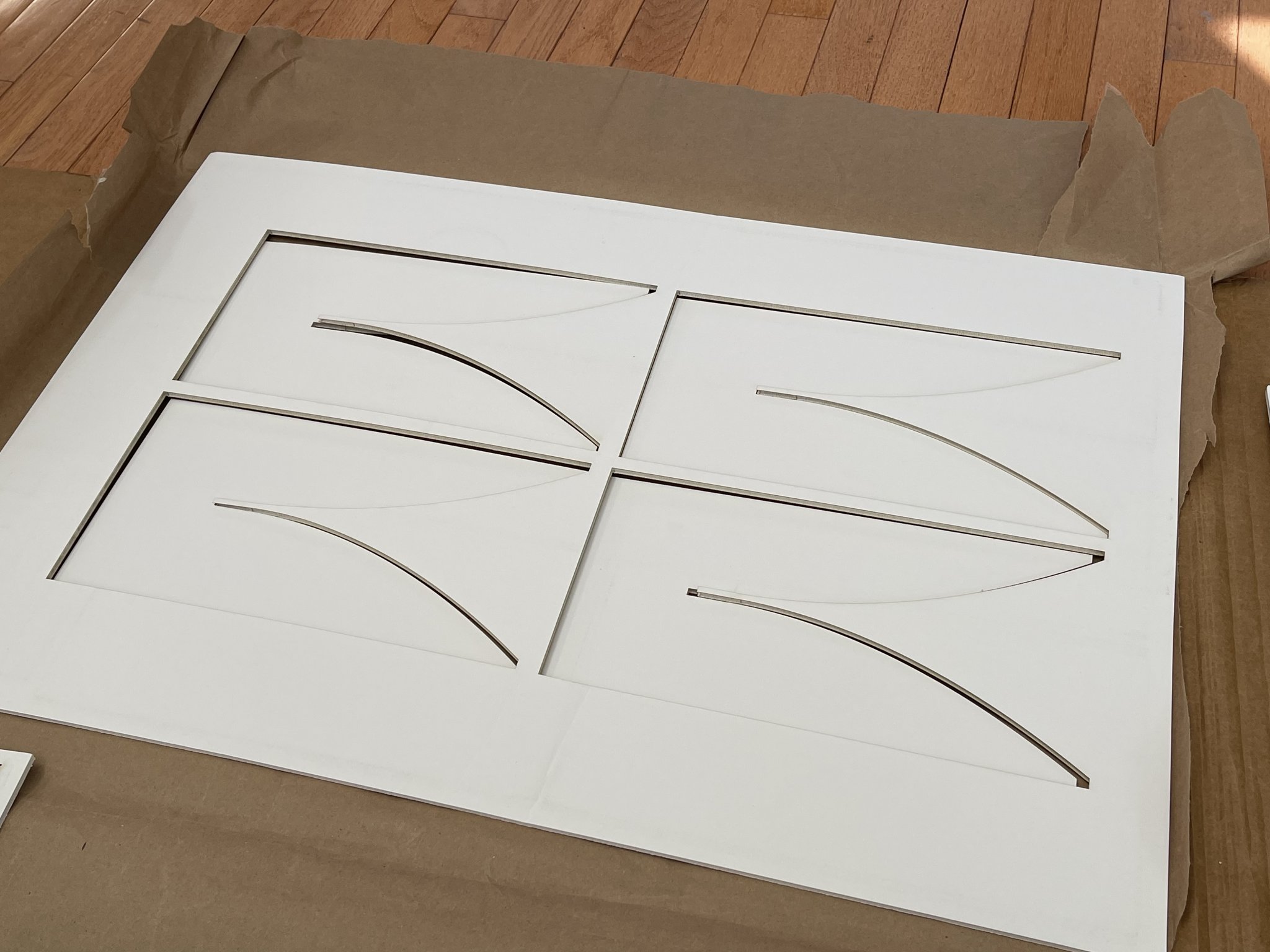

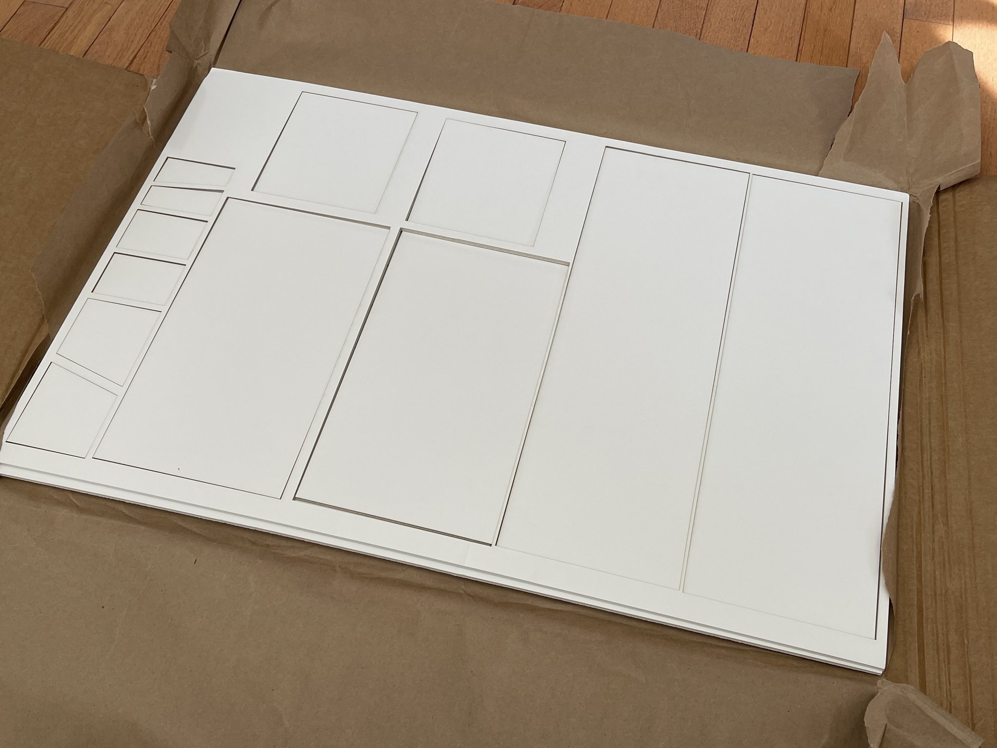

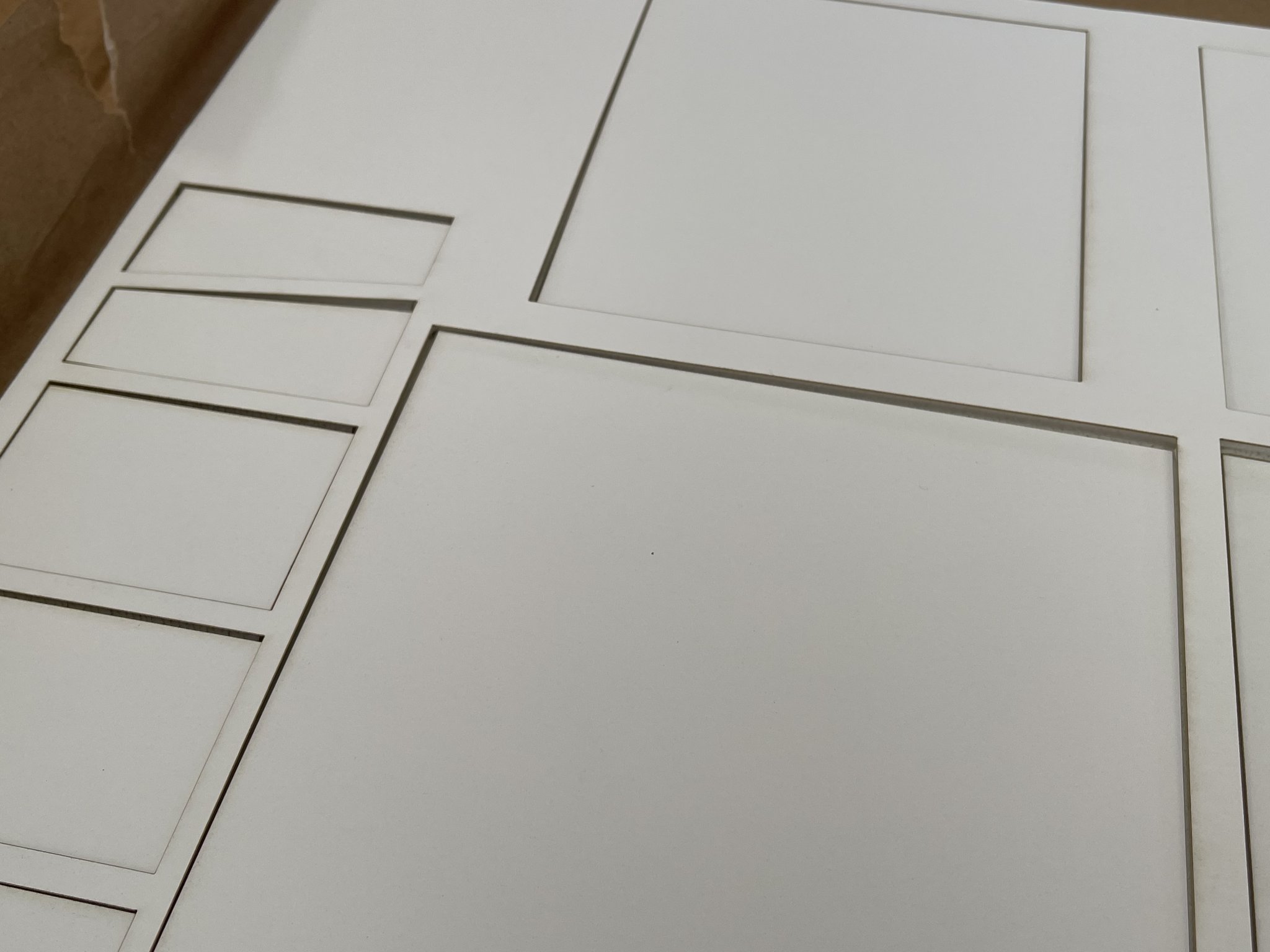

The laser cut flat pack for the 0.40x Karlsonators just arrived. It came as 3 flat sheets packed flat in its original master sheet so you know exactly what part goes where. The cuts are amazingly precise. The best from the laser also melts the foam into a solid non-porous sold under-lip. There is a slight smoky aroma to the foam - not strong or anything but a hint of the process used for the precision cuts.
Overall, I am quite happy with the result. This will make building and assembling the speaker much easier.
