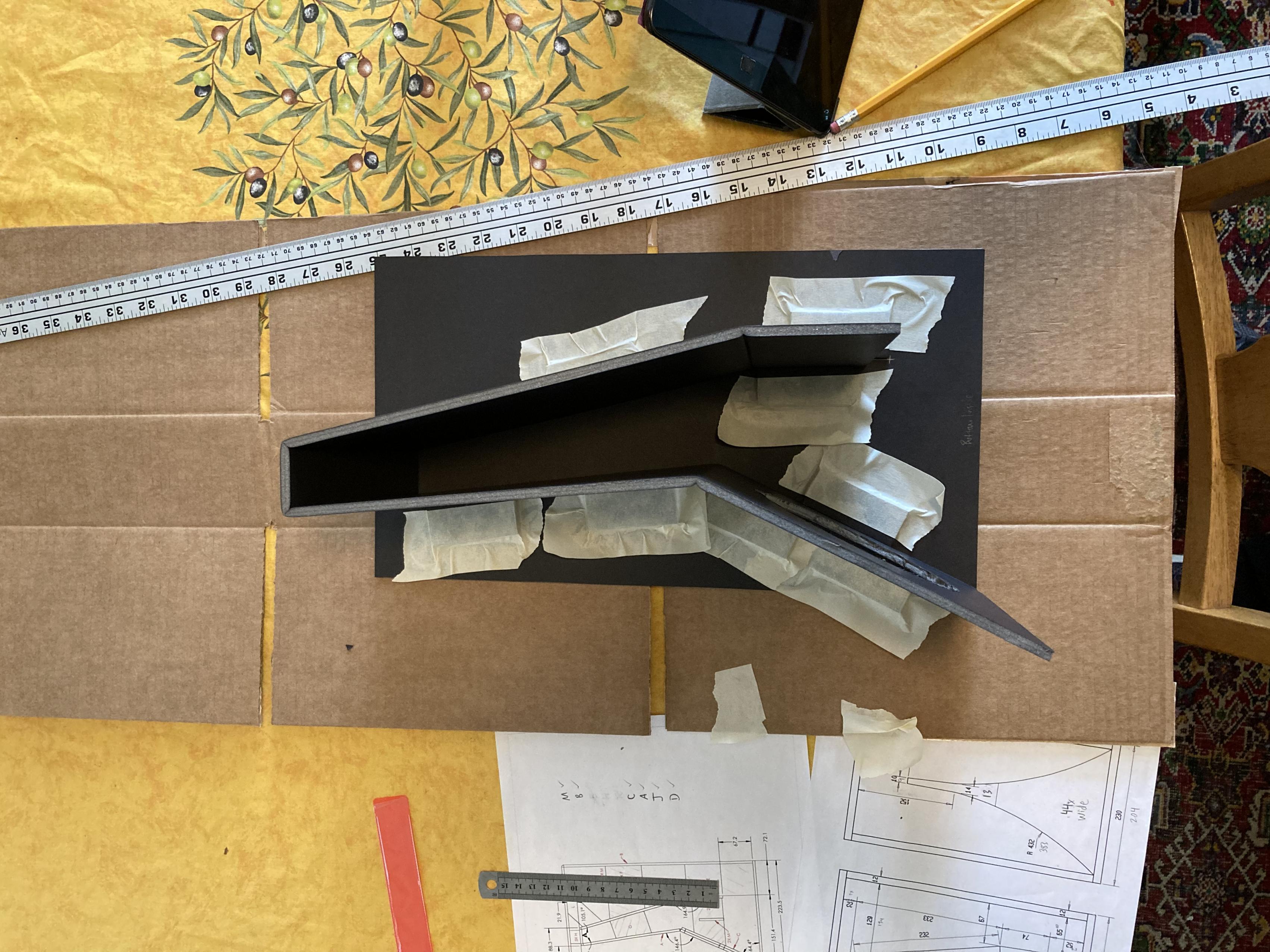

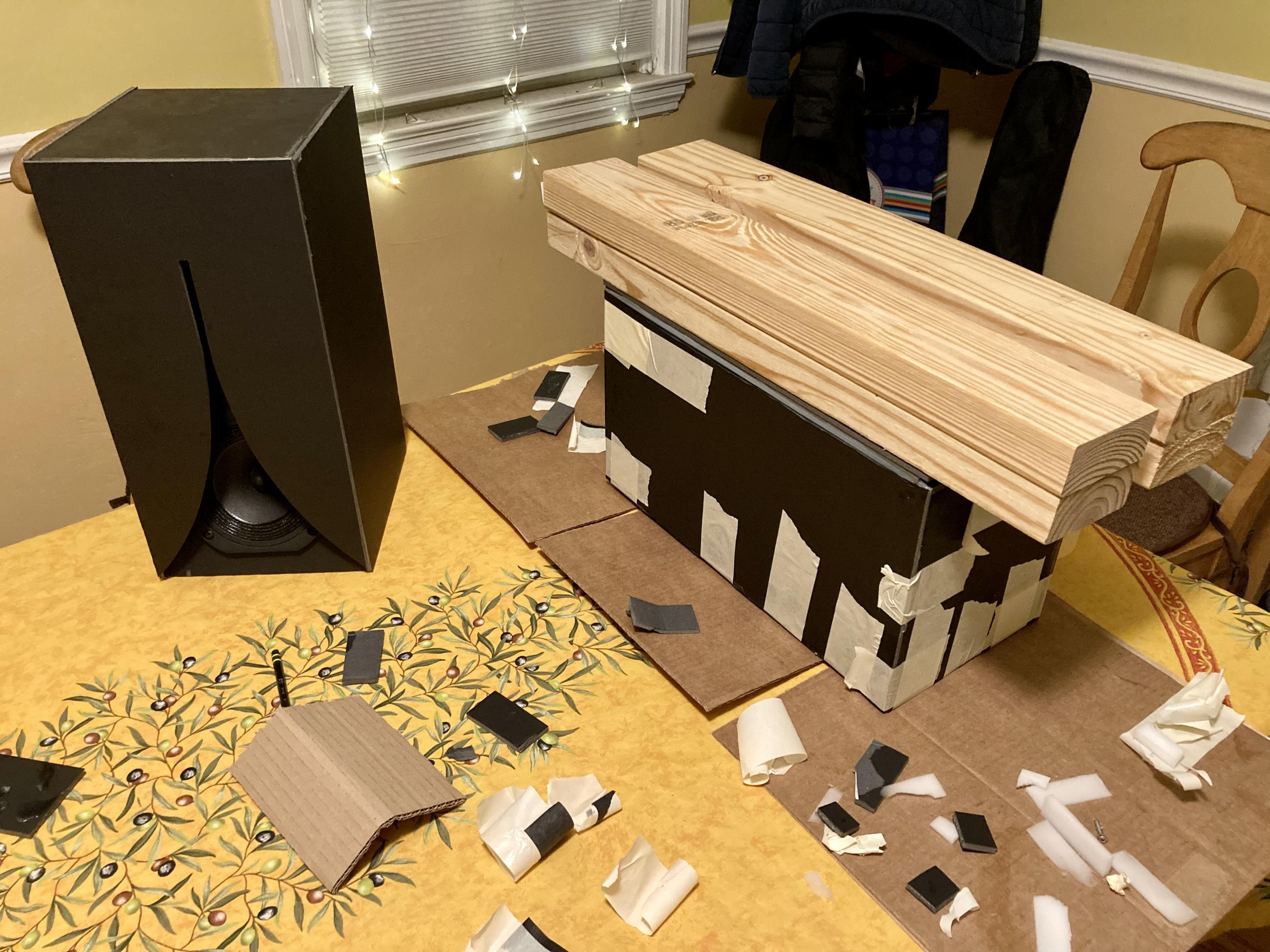

Overnight gluing!
Four months later, I’ve glued my second Karlsonator with Audax 13LB25AL together. 🙄
I used low voc clear silicone caulk, in case I made mistakes… Which I did. 😀

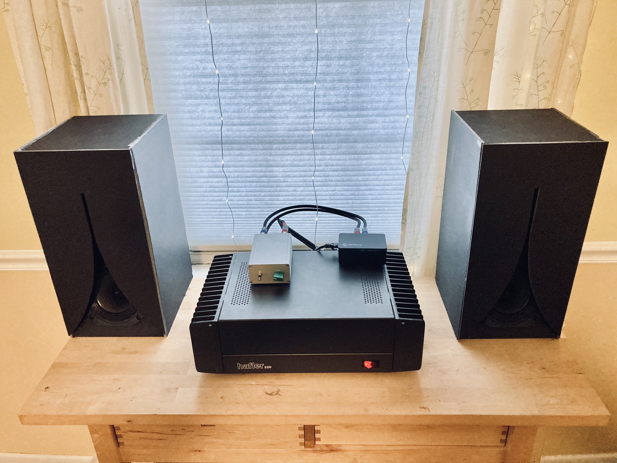

Mini Karlsonator (0.53X) with Dual TC9FDs
Looking forward to finally hearing these in stereo tomorrow.
Thanks again to XRK for the design, modeling, and support!

I couldn’t wait. It was cured enough. 😀
They sound really good… Possibly a smidge bass shy (understandably), but the mids and highs are very nice.
I’ll try to get some rudimentary REW measurements tomorrow.
I’m thinking these may do very well mounted in the ceiling corners of my dining room, turned upside down…

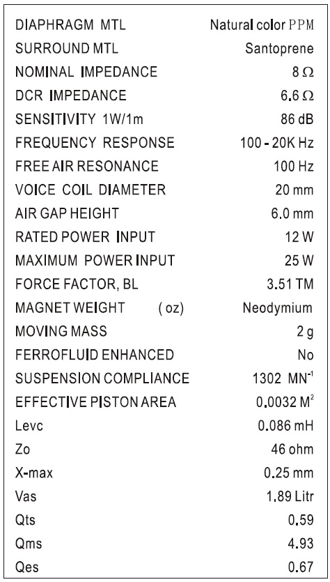

Got some drivers on the way (w5-2143 and tc9) to play with.
In the mean time I wanted to see from a best guess what size 2x these would work in? I tried looking through the thread for things with lower qts, but there isn’t “a lot” of info really.
Just a guess as I know the simulations aren’t coming any time soon.
I know qts is fairly low at 0.6. Just gives me something to play with while I wait for the “good” drivers! Alternatively. Does this look like any of the other speakers anyone can remember from this thread? Finding matching drivers is pretty hard lol
Thanks!

Nice work VonAh! Sometimes I listen to a speaker while it’s being clamped by a stack of books and glue still dripping wet. 🙂

That looks like 3in Tang Band with fairly powerful motor. Two in parallel with a scaled depth and height 0.53x and width scale of 0.44x is my guess. It would probably work fine in 0.53x all around and that lets you install TC9 when they come in.

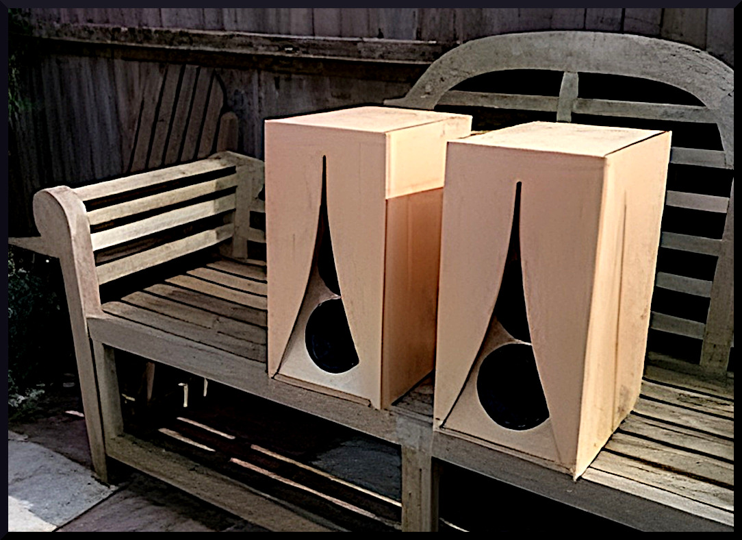

What is your opinion of them and did you listen in other configuration than the FC Karlsonators?
I haven’t used them in anything else. However I think they sound very very good. Quite sensitive. In this alignment they are great on axis full range, noting bass limitations. High frequencies fall off pretty quickly off-axis. On-axis in this sense means perpendicular to the internal slanted baffle in the k’nator. Up off the floor, the phase plug points over my head when I’m sitting down, and the highs suffer.
Nearfield there is not much to complain about. Bass is more articulate up close.

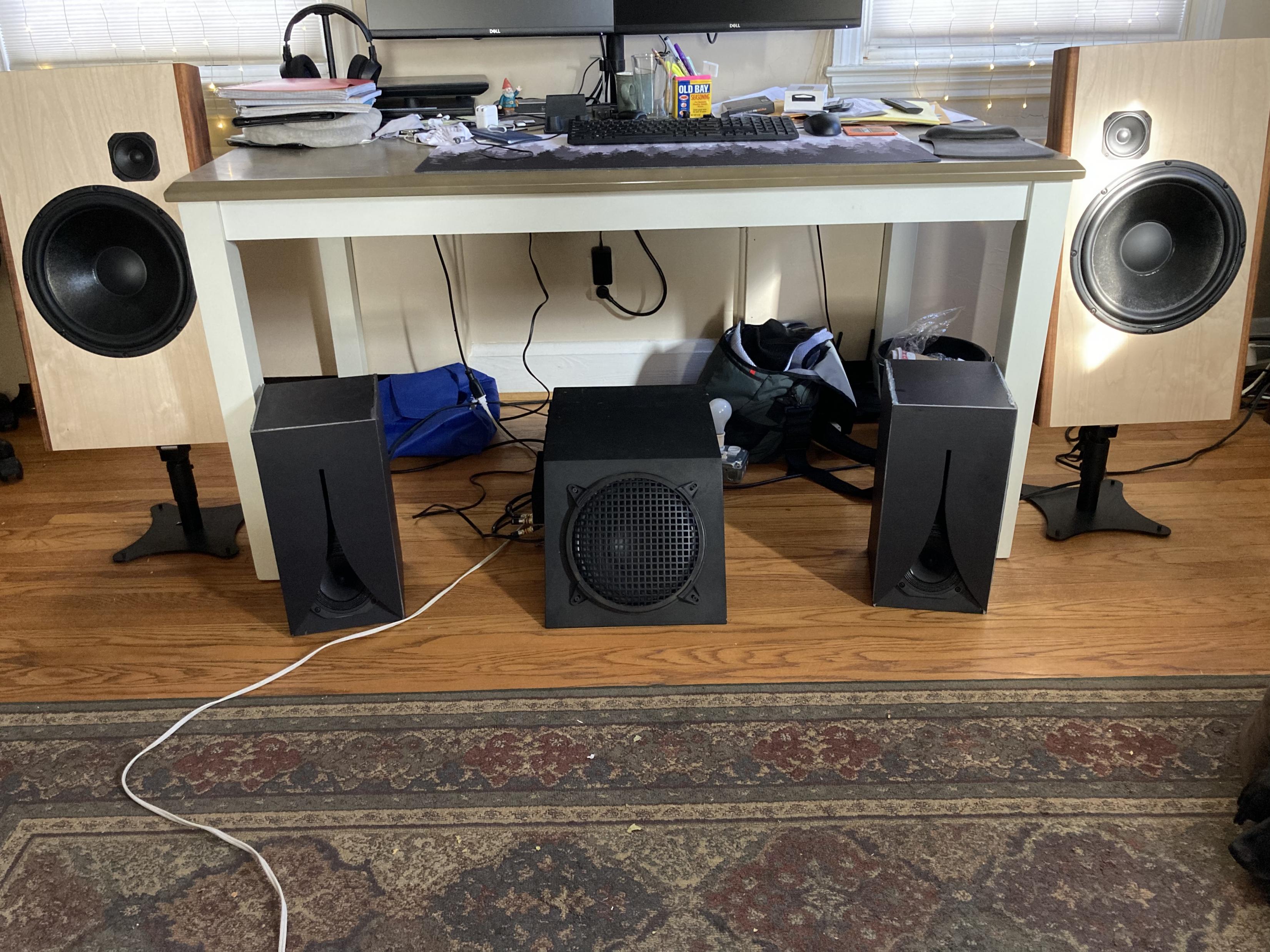

I have only one subwoofer (based on a Foster WF-100K plate amp) that I haven’t powered on in several years. Lightbulb went off that I could add it here for fun. Wow, does it integrate well. 😀
If these drivers would model well for transmission line (I’m not up to speed on that skill), I think they may be well suited for a large TABAQ-like box or an FH3-XL.
