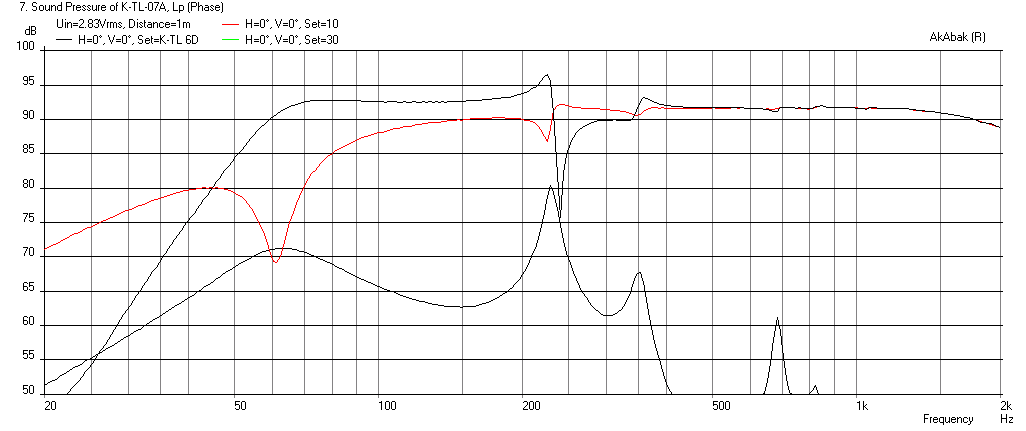

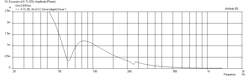

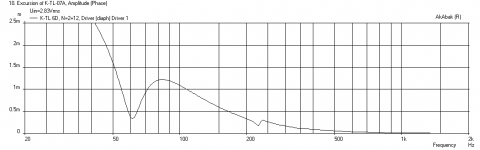

SynctronX Karlsonator
Here is an optimized design for your driver:
Scale the height and depth by 0.6x and the width by 0.4x.
It is kind of a narrow tall design 18 in tall by 6 in wide x 9 in deep. Should sound good and get about 55 to 60 Hz bass extension.
Good luck!
Good luck!

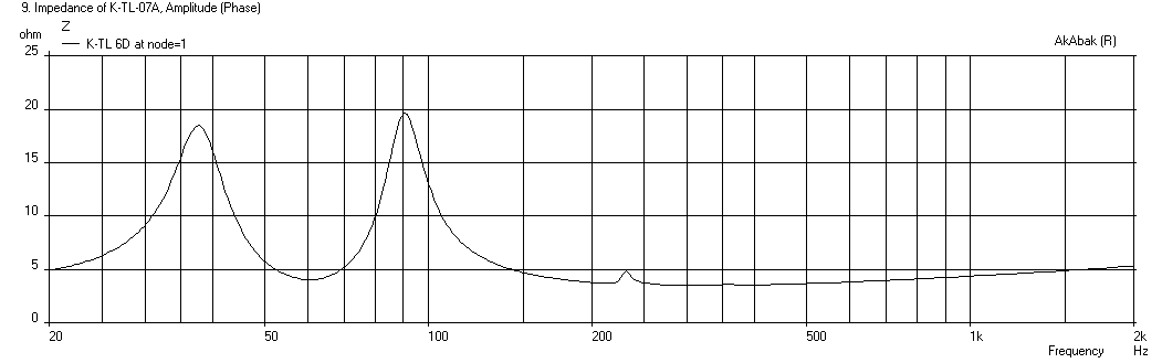

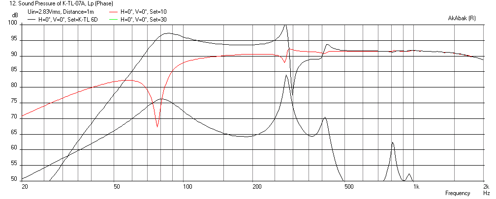

0.5x Scale SynctronX Karlsonator
It can work at 0.5x scale (all around) - you won't get as much bass extension but the efficiency is very high and there is a bass peak at 85 Hz. Some people don't mind this. You will still get bass down to 60 to 65 Hz.
I will need full T/S params if you want me to run a sim: Qms, Qes, fs, Re, Le, Vas or Bl, Sd
Or get me the model number or link to specs. If you don't want to draw attention, get the Vifa TC9FD and make the 0.4x. A pretty innocuous looking thing. 🙂

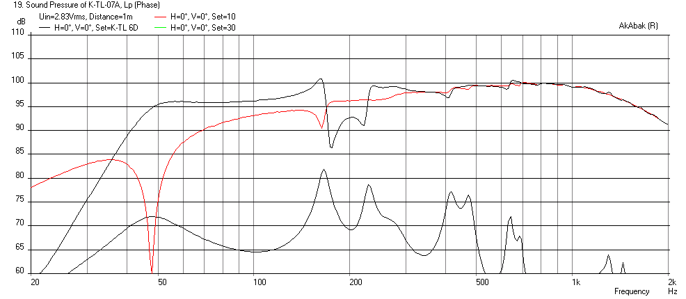

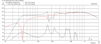

What kind of Karlson or Karsonator if any would you recommend for a B&C 10FW64? - (don't own one but it looks intriguing)
Resonant Frequency (Fs)63 Hz
DC Resistance (Re)5 ohms
Voice Coil Inductance (Le)0.9 mH
Mechanical Q (Qms)3.4
Electromagnetic Q (Qes)0.25
Total Q (Qts)0.23
Compliance Equivalent Volume (Vas)0.95 ft.³
BL Product (BL)16.4 Tm
Diaphragm Mass Inc. Airload (Mms)34g
Maximum Linear Excursion (Xmax)5 mm
Surface Area of Cone (Sd)320 cm²
