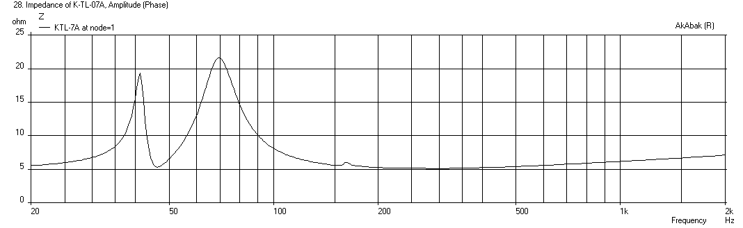

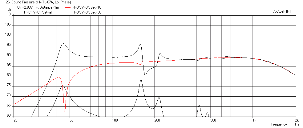

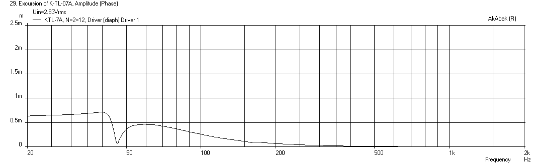

Freddi,
This looks like a strong candidate for a Karlsonator. It has good deep bass extension but with a bit of a peakiness. The cone motion is very well controlled and it does not go into run away mode below 40 Hz.
Design is scale 1x in height and depth and 0.67x scale in width.
Freq response, impedance, cone displacement.

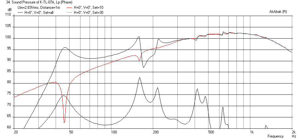

X- regarding the B&C 10FW64 in the 0.67 width Karlsonator why is the simulation showing 5 to 10 dB less sensitivity than Beta 10cx
(my keyboard's question mark key pooped out!) http://www.bcspeakers.com/products/lf-driver/10-0/10fw64
file
btw - its interesting to compare the neodymium version (Qt0.29) of the same driver
file
my 12PE32 is very sensitive in a classic K12 - sounds good with a K-tube
thanks - - assuming that's the result then 10FW64 isn't the best parameter pick for a new Karlsonator driver - would it perk up in a little K scaled from K15? Beta10cx looks really solid for a budget driver in the Karlsonator(12) - I can't remember if you modeled the popular Beta 12LTA in the Karlsonator (?)
