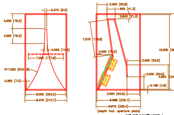

Hi X,
I'm trying to figure out how to draw up my front panels before
I cut them.
I'm about 1/2 way laying out the everything on the white panels before I start cutting on them. Will have to sharpen op and exacto blade...
like you. ; )
It's okay, though if you sharpen them yourself, the end up a lot better
than out of the box. The same thing with the box cutter blades.
Anyway, how do I adjust your formula for my box. I'm doing the
.6 hight and depth, .4 width.
Now, I'm not sure how to plot the nine sets of plots...x 2,, or more.
Also what function are you using?
I thought the Karlson was conic section type slot,
from a parabala or something, then split down the middle
separated by the 1/4 and folded over (one for each side).
Any way I appreciates eveyrones ideas and help.

TB46,
I can help you with how the script goes, I just didn't have time. It is described in earlier posts on the Karlson thread here (http://www.diyaudio.com/forums/full-range/213594-karlson-10.html#post3528706). Basically, I fitted the Karlson aperture curve to a non dimensional function as y= f(x) for x[0,1], and y[0,1]. The function is given by Y=0.974X^2+0.00874X+0.0207. This is for X=0,1 and Y=0,1. Simply scale function for any slot based on max height and width at Y(X=1).
Using that function, I can then apply scaling of any arbitrary K slot final width and length, and also an offset which determines initial gap width. Having this function, use to specify the width and height of a series of rectangular ports (vents) located along the front. The width will be given by f(x)*Y_scale, the width height will equal front panel height/number_vents. I used 9 vents for the front K-aperture. I tried 14 and found negligible difference. So step through the 9 vents and adjust the port width for each successive one according to the equation. You need to model the front chamber as a series of waveguides (following the cross sectional area profile of the front chamber). I chose 9 because that is how many segments were required to model the front chamber to include all the expansions, contractions, vent tubes, etc. The distance of each segment actually determines the height of the vent. At the node connecting each waveguide segment on the front chamber, connect that node to a duct leading to a front radiator associated with that duct. See diagram here
The tricky part is to code each duct radiator so that it is appropriately physically located in the correct place on the front panel relative to the driver position. Also, you need to specify the extent of the baffle width and height at the position of the duct vent radiator. All this is rather tedious coding and much of it is manually done. I figured out how to link it all together to the non-dimensional X and Y positions of the individual Karlson ducts.
I hope that helps. Think about it some and let me know if you have questions.

Regarding the shape of the front aperture. I used a function for the model so that I could automatically scale it. For actual construction I hand drew the curve by setting the gap from where it starts on top and drawing a smooth curve that is tangent from the gap which starts out straight for a couple of inches. The gap width and where it starts are probably more critical than the shape of the exact curve. The smaller the gap and the more delayed it is the deeper the bass extension. Don't worry about the exact shape. If you are really determined to use a mathematical function then plot the equation I have on graph paper. It is a simple quadratic.
X
Well I was going to start mine right on top with a bout 1/8 or 1/16 inch
slot. I"m trying to figure out how the function works and where the
origin is? Is the origin 0,0 right in the middle of the top?
I guess it is better to have ti closed at top then an inch or two later
have the 1/8 or 1/16 slot start?
Function...oh yeah, that works for anything I plug into it right?

Sync,
I made my slot start at 3/16 in wide and 3 inches from the top. This have it more bass punch I think. Regarding the formula - it is a normalized function scaled to 1. So think of y as the value out and x as the value in. X varies from 0 to 1 with 0 being at the top edge and 1 at the bottom. The answer is gives out varies from the gap width relative to 1. So if you have a 15 in tall box multiply the number in by 15 to get true position. Multiply the answer out by width of cabinet/w and that is distance from the centerline to the edge of the aperture at the given x position.
The chamber above the driver is part of the TL and helps to smooth the response and extend bass.

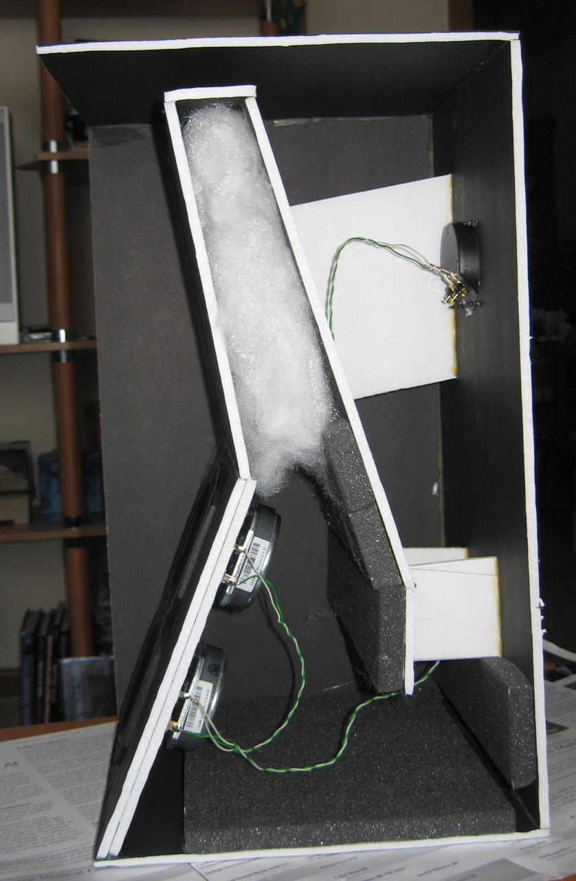

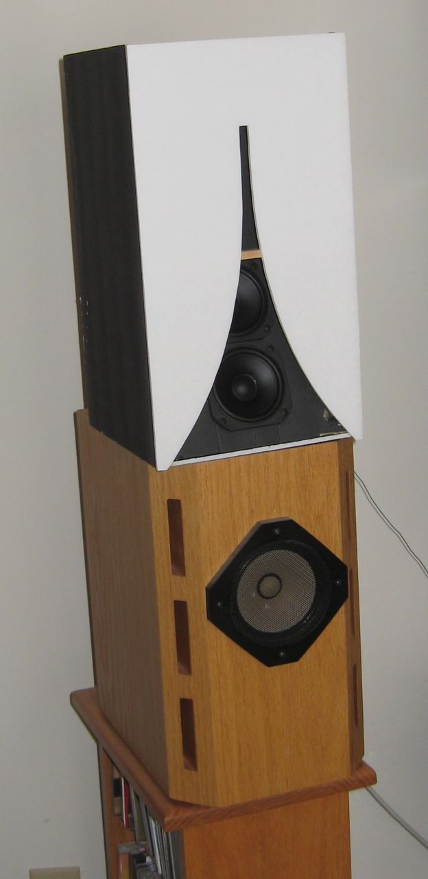

Hi X,
I finished the dual TC9 mini-Karlsonator a few weeks back, but have been too busy to post about it.
Pics below: first during the build before I put in the last of the braces; then the finished product sitting on top of my Fonken Prime FE127e (for comparison).
I put PE AcoustaStuf in the snub and 0.5" thick PE acoustic barrier foam on the bottom and surfaces behind the drivers.
They sound very good! Not as good as the Fonkens, but what would you expect?
I took them over to the studio today (I’m a volunteer sound tech for the Schenectady Theater for Children) to see how they would work in a large space— and to compare them with the mini-FH3 (also TC9 drivers) I built earlier. The rehearsal space is long & narrow; probably 20’ X 70’. Speakers were placed mid-way on the long walls, angled out 45 degrees. The mini-FH3 were seriously lacking in mid-bass, but presented the mids & highs beautifully with a great ‘disappearing act’. The mini-Karlsonator was clearly superior, with a nice mid-bass. In that space, they can’t provide ear bleed SPLs, but they are more than sufficient to provide music for rehearsals. My thought is to use them in the studio when the main system (EV 300 speakers IIRC) is out with our touring show.
So I may need to build a couple pairs in plywood. (Foam core might not last very long in that environment.)
OTOH, I’m wondering if a larger driver might be a better choice for that application? How do you think the Fostex FF165wk would work in a properly scaled Karlsonator?
The Madisound Speaker Store
Again, my thanks for enabling another fun build!
Cheers, Jim

Jim,
Very nice build there! I like the black and white treatment. It doesn't surprise that they work well to fill a large space. I recommended them to the guy who was looking for some speakers for his pub space where people play darts. It was poo poo'd as an idea but your experience confirms my suspicion.
Isn't that the best complement when a FC build graduates to a I should build one in wood? I have always liked these as one of my favorite all a rounders.
Thanks for sharing. I will look into one with the FF165wk for you. Is your goal studio use or filling sound in the hall like a PA?
