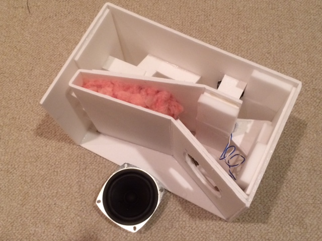

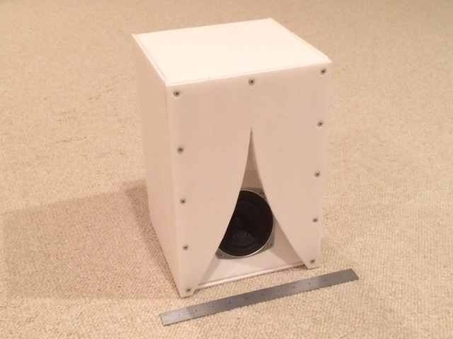

0.44x/0.55xW K'nator with FE103
I built the K'nator for the Radio Shack 40-1197(FE103) per the plans that GregB made with a few adjustments (rounded off to closest 1/8in). I used double layer foam core with liquid nails on select panels to reduce vibrations (K-aperture, bottom, top, internal front baffle and divider panel.

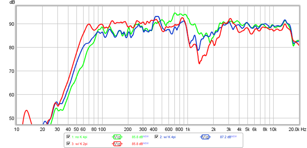

The measurements match predictions for bass extension and SPL: 61Hz f3 and solid 89dB in 2pi space (sitting on floor) and 86dB in 4pi space (on stand). If to be used stand mounted will need BSC circa 1mH + 5ohm. On the floor there is a floor bounce cancellation equal to driver height at 1.7kHz. The response is pretty balanced and flat other than the floor bounce. Just listened to a few songs - very good and tight percussions. There is no ringing at 7kHz like the FF105WK. This is a very sensitive speaker - doesn't require much amp power at all.
Frequency response measured at 0.5m away on stand and floor and without K aperture (the K-aperture extends the bass from 85Hz to 61Hz and smooths the response):

They are both great and I am glad I have both - they are different at the things they do well. For overall loudness and filling a large space with sound, the PA130's in 0.53x are better. The Dayton has about same sensitivity but more xmax and power handling so you can really crank it up. It has less of a HF top end and a bit of ring at 5kHz so percussions will not sound as crisp as the FE103 (or RS40-1197), which is more of an accurate speaker with controlled impulse response that doesn't ring. It has a much lower power rating (6 watts I think) and a flatter frequency response. Very enjoyable to listen to small live jazz ensembles or vocals. Both have about same f3 for bass extension. So to sum it up: PA130 for everyday listening and small party levels. FE103 for more of a near field hifi type application. The PA130 in an 0.53x box is quite a bit bigger - too large for a desk. The FE103 in an 0.44x fits a desk nicely.
