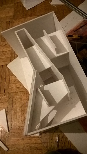

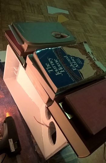

I finished a 0.53x dual Vifa. My first speaker project. Time passed quickly while cutting and gluing pieces, had to recut a few pieces due to being casual with my measurements.

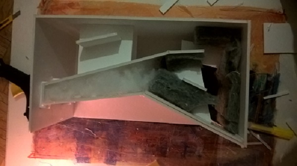

The sound is certainly unique, rich, and very listenable. I will play around with the stuffing a bit, there's some boxiness in the midrange, evident sometimes on male vocals/piano/sax. I put polyfill inside the divider, and 0.5 inch patches of dampening around the chamber. I'm thinking about doubling those for 1 inch thickness and removing a bit of polyfill to loosen up the bass.
Will start building the 2nd in the next days, and now I want to try the 0.4x too, should be easy after 0.53x . This foamcore/hot glue combination is a revelation.

Great news and thanks for sharing. Photos?

WRT the boxiness in the mids, nothing's free... You pay a bit for the extra gain in the midbass, kind of like with a horn. Still, you can get rid of most of it. It's more the front chamber than the rear chamber stuffing that affects this. Try sticking a bit of thin felt to the backs of the wings right in front of the driver. Something like felt furniture disks are good and easy. Those are the things used to keep the bottom of a vase from scratching grandma's furniture.

WRT the boxiness in the mids, nothing's free... Try sticking a bit of thin felt to the backs of the wings right in front of the driver.....felt furniture disks are good and easy.
Much appreciated, the felt on the wings seems to have improved things quite a bit.

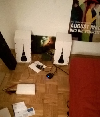

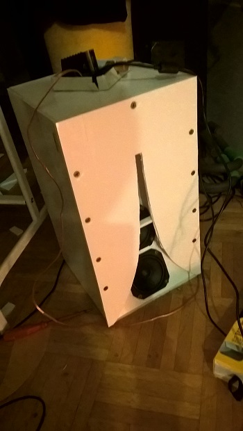

I have now finished the other side, and am very pleased with the results. I did not expect them to be this loud together. They are fun music-listening speakers that can rock or send you to sleep depending on the volume. I don't know yet where/how to place them in my room, but they seem to be fairly forgiving in that respect. I like how bass and mids are so lush. Just a good flowing sound all around. xrk971, thanks for being so encouraging in the foamcore threads, I wouldn't have tried this otherwise. I guess I won't be buying commercially made speakers anymore :D
Some pics from the building, testing with tda7297 and finally with the dual tpa3116.

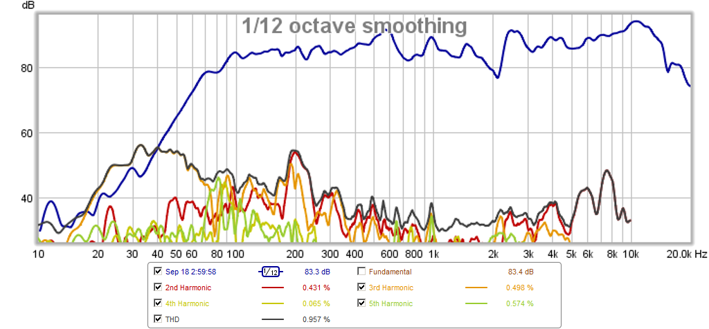

excuse me xrk971 on post 1182 of the TABAQ thread you showed a plot of frequency response with relative harmonic distortion. I wonder if you have a similar plot for the 0.4mini karlsonator. Thank you for all your contribution
I must have posted this before but here it is again. This is with Faital Pro 3FE25. I don't have the data for TC9FD (lost).
Note that much of the HD below 400Hz is vibrations from the foam core K aperture - most notably the 200Hz peak. Make a double layer one and glue with latex caulking and it should take it down significantly. There is a mechanical buzz in the structure at several other frequencies that can be eliminated with fix to bracing.

Thank you xrk971. It seems the TABAQ has lower and better controlled harmonic distortion. From simulation I expected the mini karlsonator to do better. Your charts show otherwise.
Thank you again and have a happy new year
You mean this one with the curved wall TABAQ and the P830986 driver?
That certainly was a clean HD plot - the structure is a long tube with curved walls so inherently stiffer. If you made the 0.4x Knator with plywood it would have lower HD.
But the way the sound is disperesed, the K aperture makes it sound bigger and it doesn't require a BSC like the TABAQ which loses about 5dB sensitivity. That means the TABAQ is a 79dB speaker vs the 91dB 0.4 K'nator with the 3FE25.
