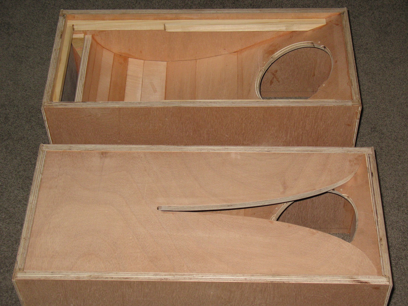

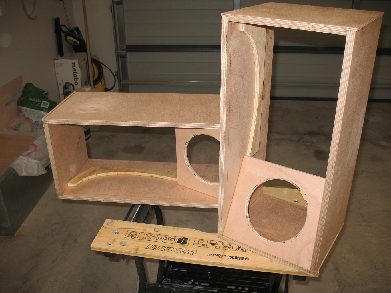

What is a good appriximation of a mathematical function for the curvature of the wings?
I saw some discussion somewhere, but i cannot find it anymore.
This is the first time i use ply wood.

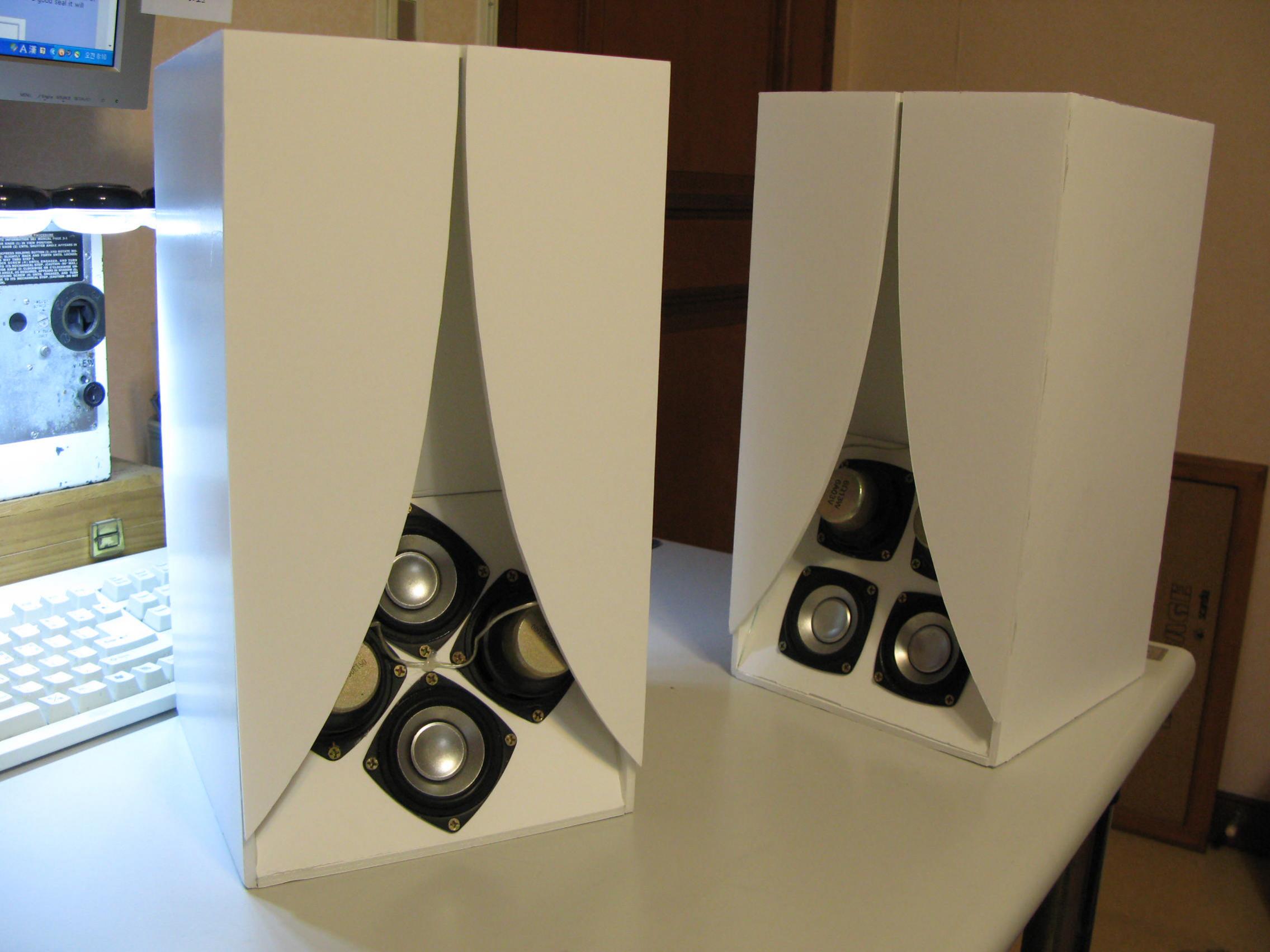

Well, freddi, to be honest, I can't really tell any difference in sound between the two arrangements(square/diamond)...
Maybe it's due to the fact that the drivers aren't delivering much in the top frequencies.(woofers from Promedia, after all) If there were, I could have perhaps picked up on some differences, but nothing for now...
IMHO, The diamond one looks better, and would probably help high frequencies, but the square one has the merit of being simple... 😉
bolexsbm- they look really good. Did you do much research on 2” drivers. I have plans for a 1.5 - 2” project. Would love to hear of any good prospects.
Thanks for the compliments, guys.

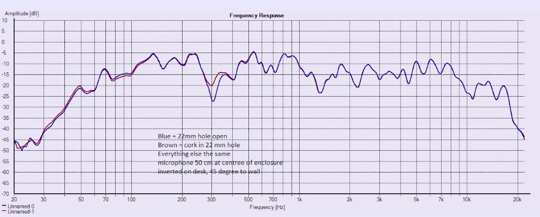

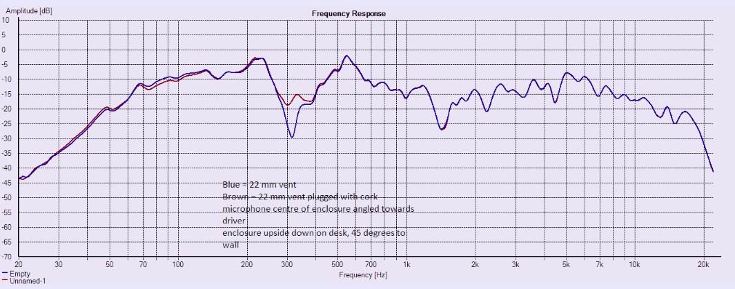

I'll just put this out here again since it seems thematically relevant. A few years back, I adapted the Fostex BK-10 back-load horn into a Karlson-type enclosure.

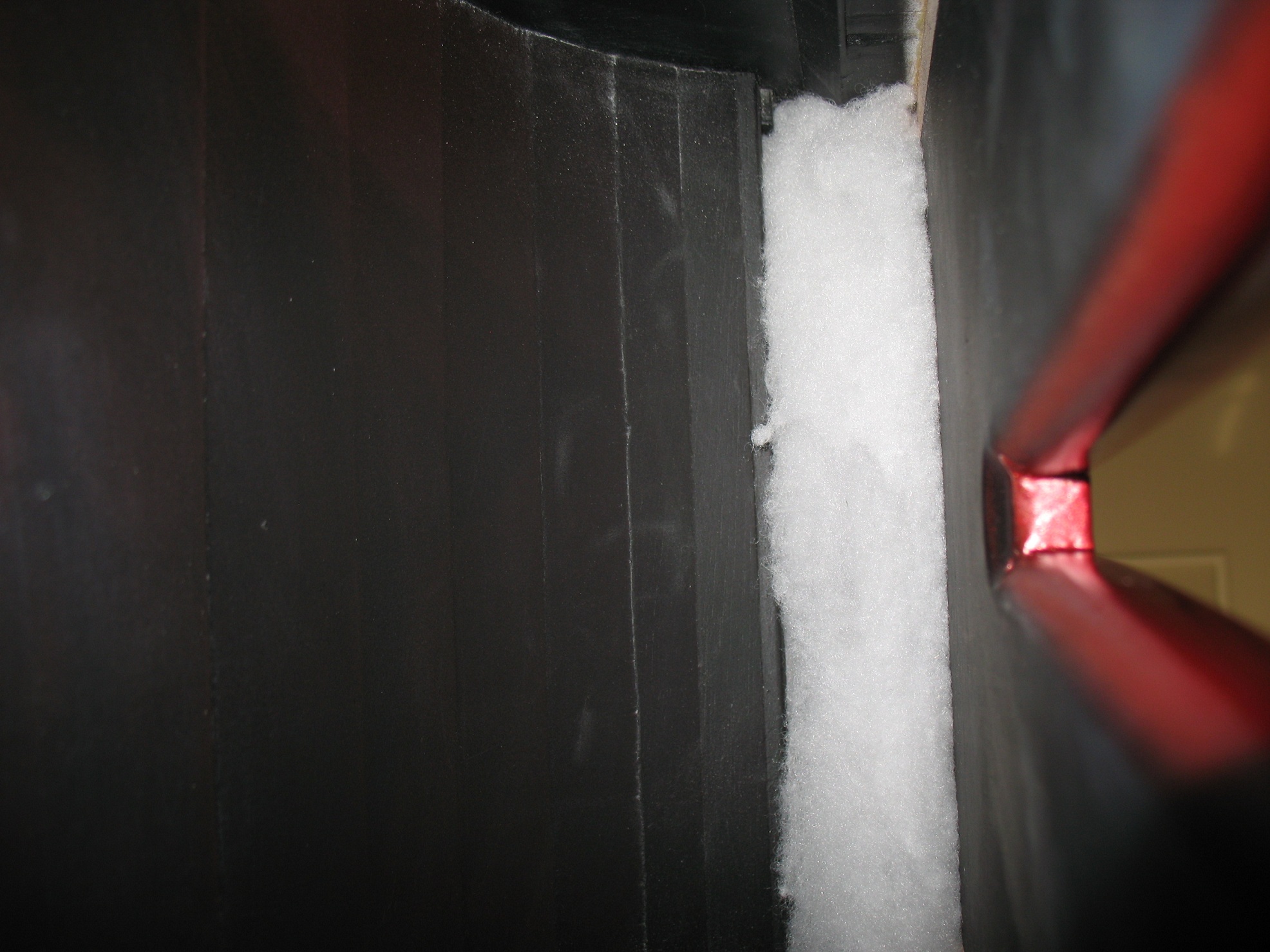

I conserved the driver chamber Vb, throat area, path length and expansion as well as I could. The K-slot area is about the same as the BK-10 mouth as well. It was never simulated or built. I did build an actual BK-10 out of foam-core though, before it got "all mainstream" too, btw. 😉 😀
Damping on back 3 mm synthetic felt. Some damping in the slot made a noticeable difference (for the better imho). In the end I left the hole open. Picture taken from the bottom towards the top shows the damping sticking out of the top slot. Drivers were mounted from the back.
dug out the backup of the old gainclone website for the measurements of the HAK 6.5. They were not taken under the best of circumstances - indoors and plaster wallboard, pretty empty room. Upside down on a table against the wall. Shows the effect of opening / closing the hole.
two graphs - one for each speaker. Drivers have not had a lot of use - perhaps 2 hours at low levels so bass will still improve a lot when more hours on them(and did - but lost those graphs). Microphone is a Samson Go-mic and was situated about 50 cm from driver and angled towards the driver. Objective of the test was to determine the impact of the 22mm hole.
