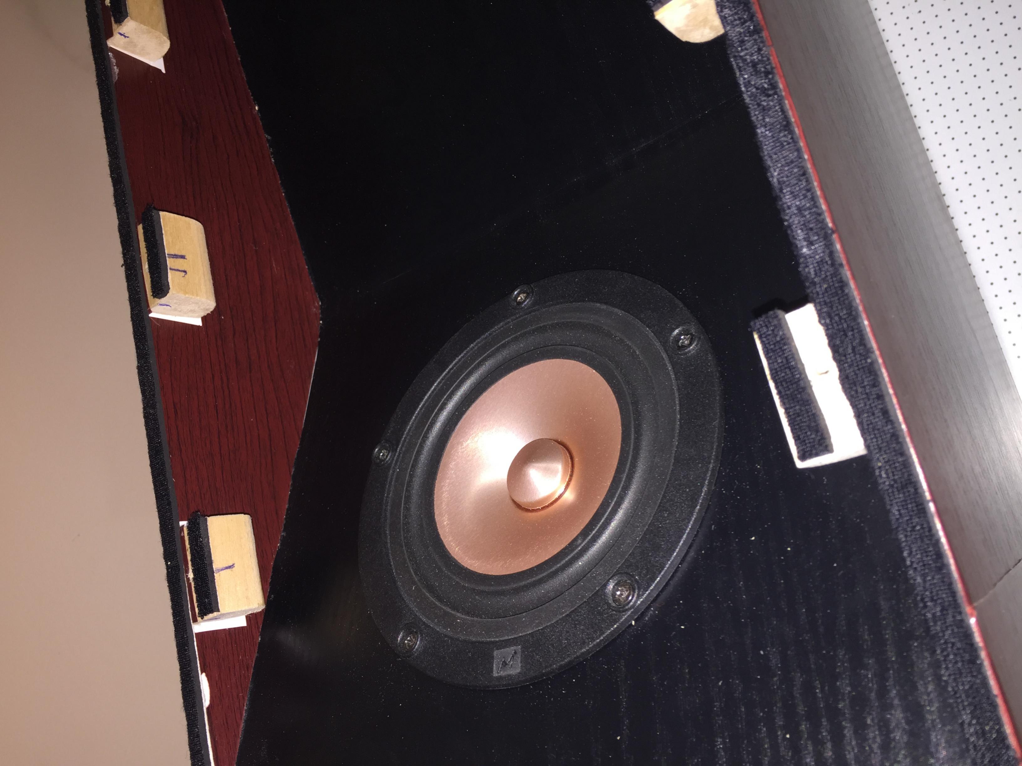

Mini Karlsonator (0.53X) with Dual TC9FDs

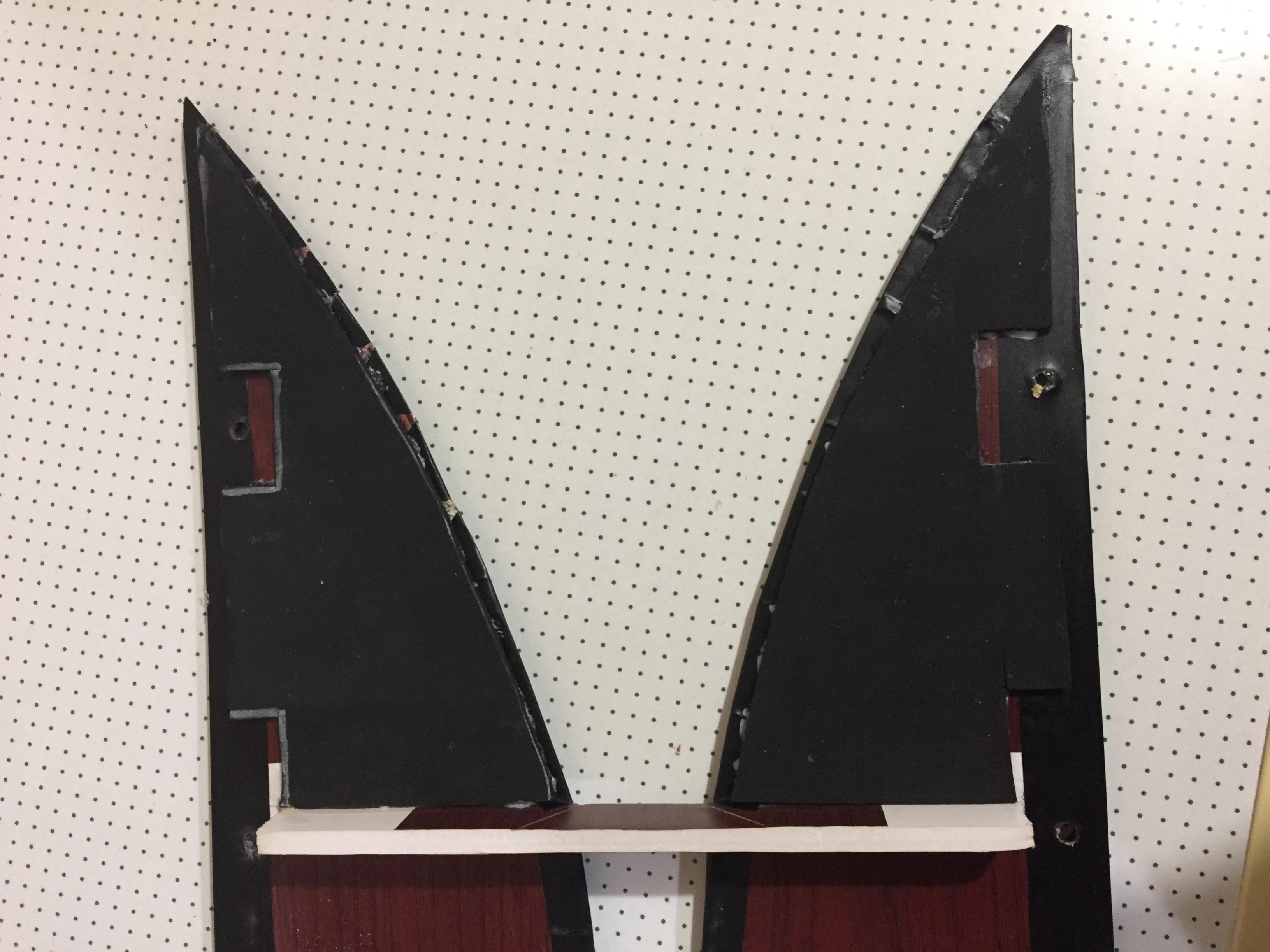

I've found some unpleasant sound effects appear from the middle to big levels (depending of source of music) probably caused by resonance frequencies from touching between K-aperture panel and cabinet.
I've added to the cabinet thin ribbons from 2 mm very soft Neopren with double sided bonding tape and the result was that the irritating noises disappeared.

There is a lot of pressure on K aperture. If you can use thin plywood here it is best. Then add material to absorb rattles is always good.

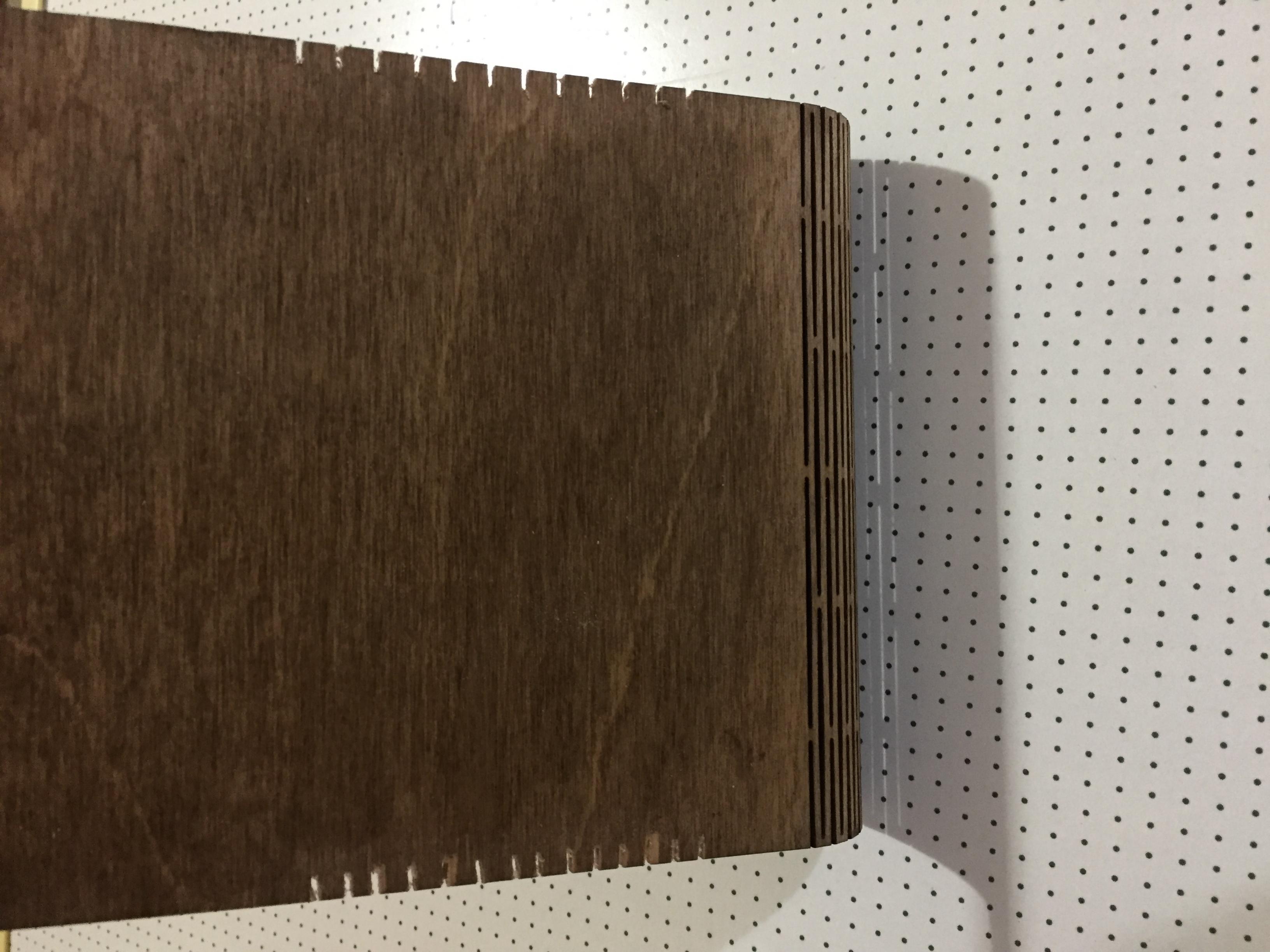

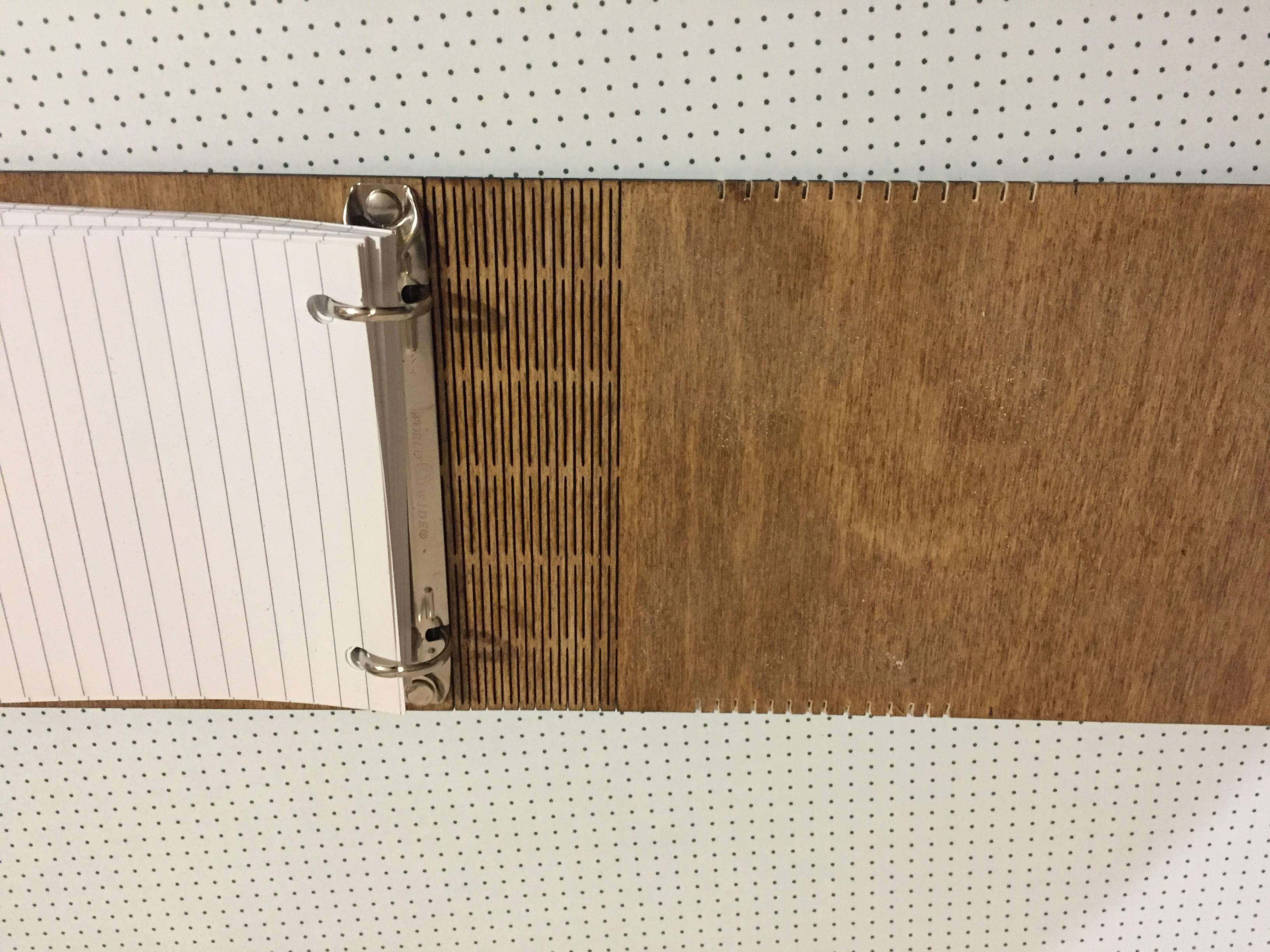

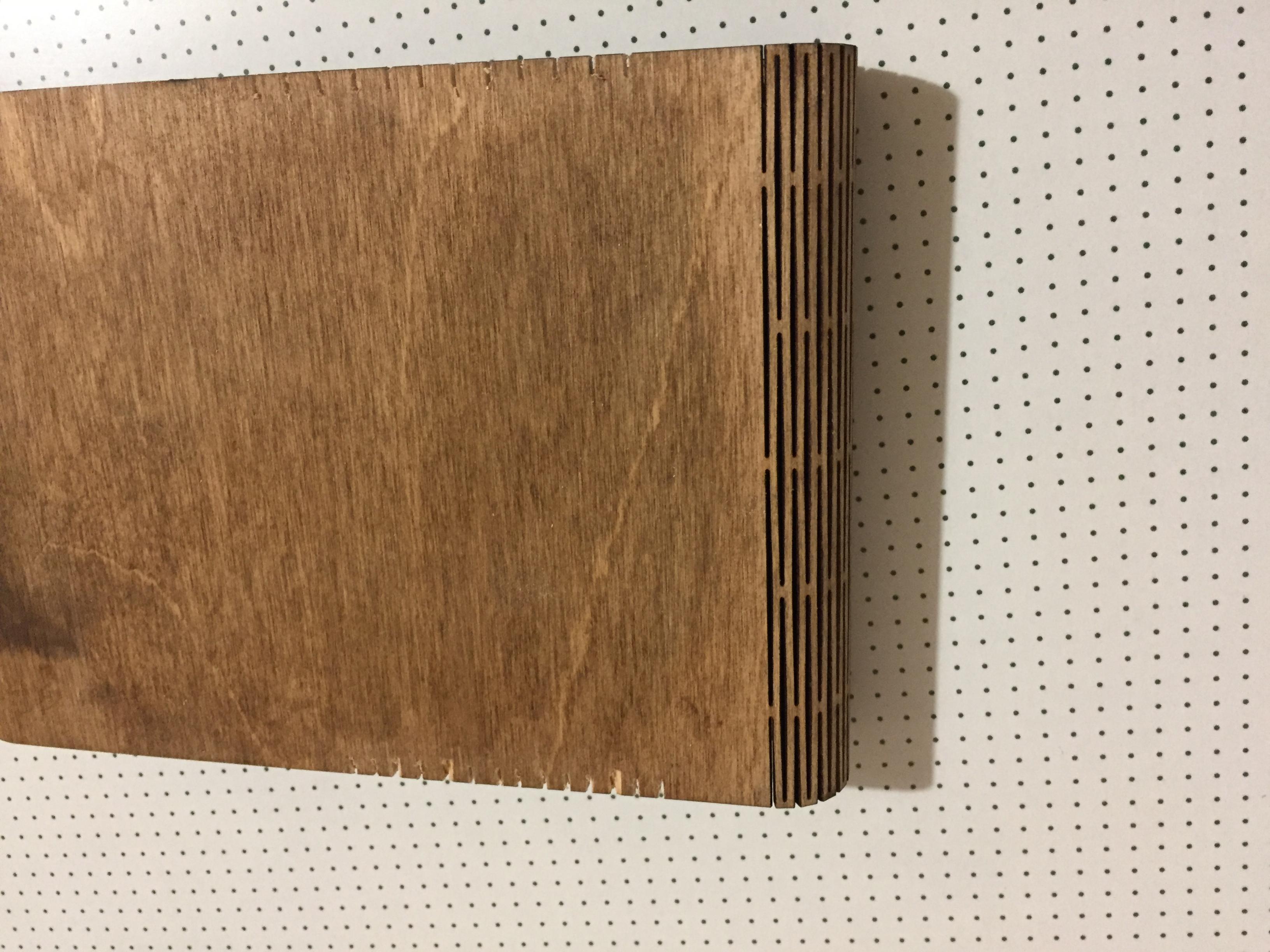

You're absolutely right! I've got an idea, inspired from advertising notebooks from my wife. She used for advertising needs notebooks covered by plywood, cutted by laser with relevant patterns. So expect my next Karlsonator design almost based on this technique for folding and cutting thin plywood:)

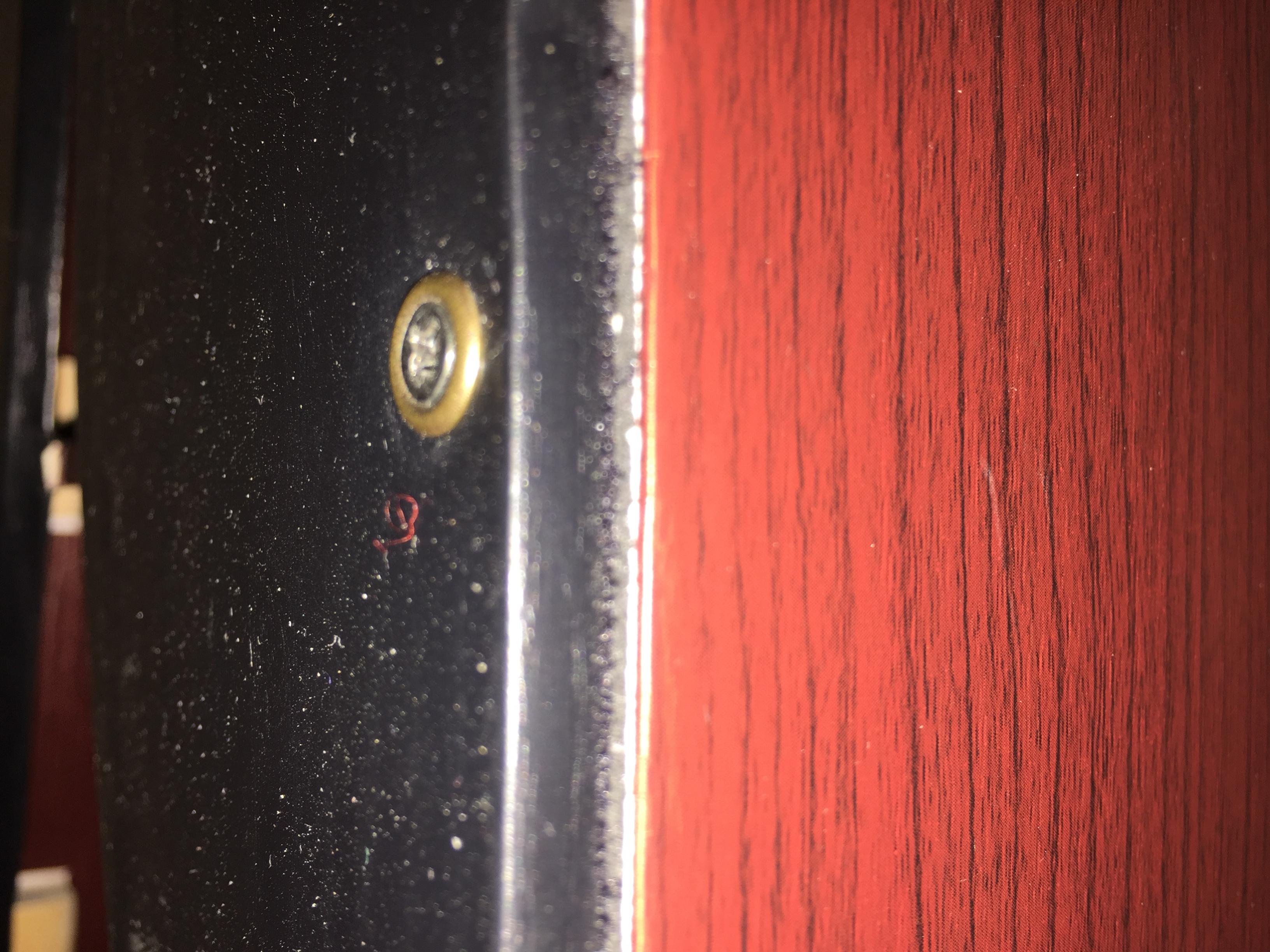

Transylvania Power Co., Acoustic Control, KK-Audio, Westwood, etc. all used 3/8" steel allthread with their little Ks which were made of Russian-Baltic birch plywood. I've seen 18mm Baltic birch plywood deflect plus-minus 1/4" when not braced. K15 type have a front "shelf" which is handy for using wood dowel rods.
here's one of my Acoustic Control cabinets - you can see the T-nuts which accept 3/8" allthread which runs from the wings all the way out the back.
Wing flex adds a type of modulation - it can also be heard on unbraced horns such as La Scala and unbraced U open baffles. Walter Zintz of Transylvania Power spoke of adding the bracing to reduce midrange distortion.
I think the pressure is greater with series vented Ks versus those with sealed back chambers, and maybe more so if the vent is located at the top vs the Karlsonette position (?) That said, my 18 inch klam with 3 cubic foot sealed back chamber, moved its wings a good plus and minus 1/4" on drum beats.

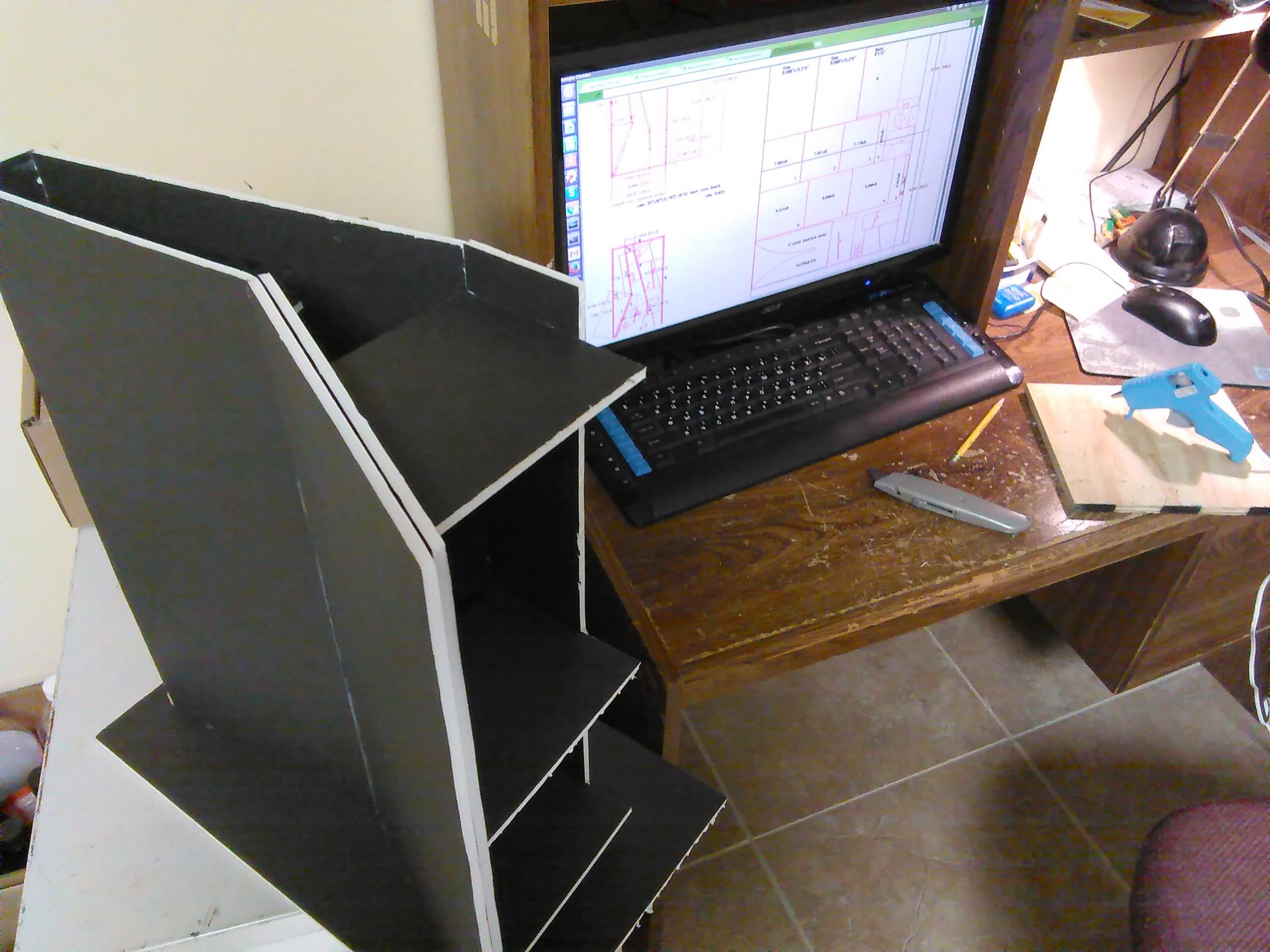

Well, I finally bit the bullet and ordered myself a pair of TC9FD Vifa's, and going to build a pair of 0.4x Karlsonators. I've grabbed a couple sheets here and there of black Elmer's foamcore the last few times I was at Wal-mart, so now I've got seven sheets to play with. The dollar store out here always has thrashed and beat-up boards, so looks like I'm starting out fancy :cool:

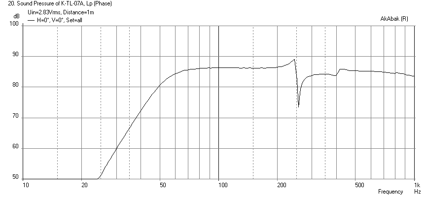

According to my model, if you use the default K-slot initial width (0.125 in) for the 0.4x Karlsonator with the Vifa you will get a response like this:
However, if you make the slot start as zero (a pinched off cusp), you get this:
Note the bass extension is deeper but the efficiency went down, but the discontinuity at 300 Hz is reduced.

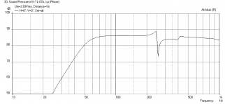

I just ran sim for Pluvia 7 and it works in a 0.50x scale (height and depth) Karlsonator that is 0.42x scale in width. It should give a smooth bass extension with F3 of 55Hz. Max SPL is only about 95.3dB (8v) because above that you may run into xmax issues if you have a lot of bass content.
