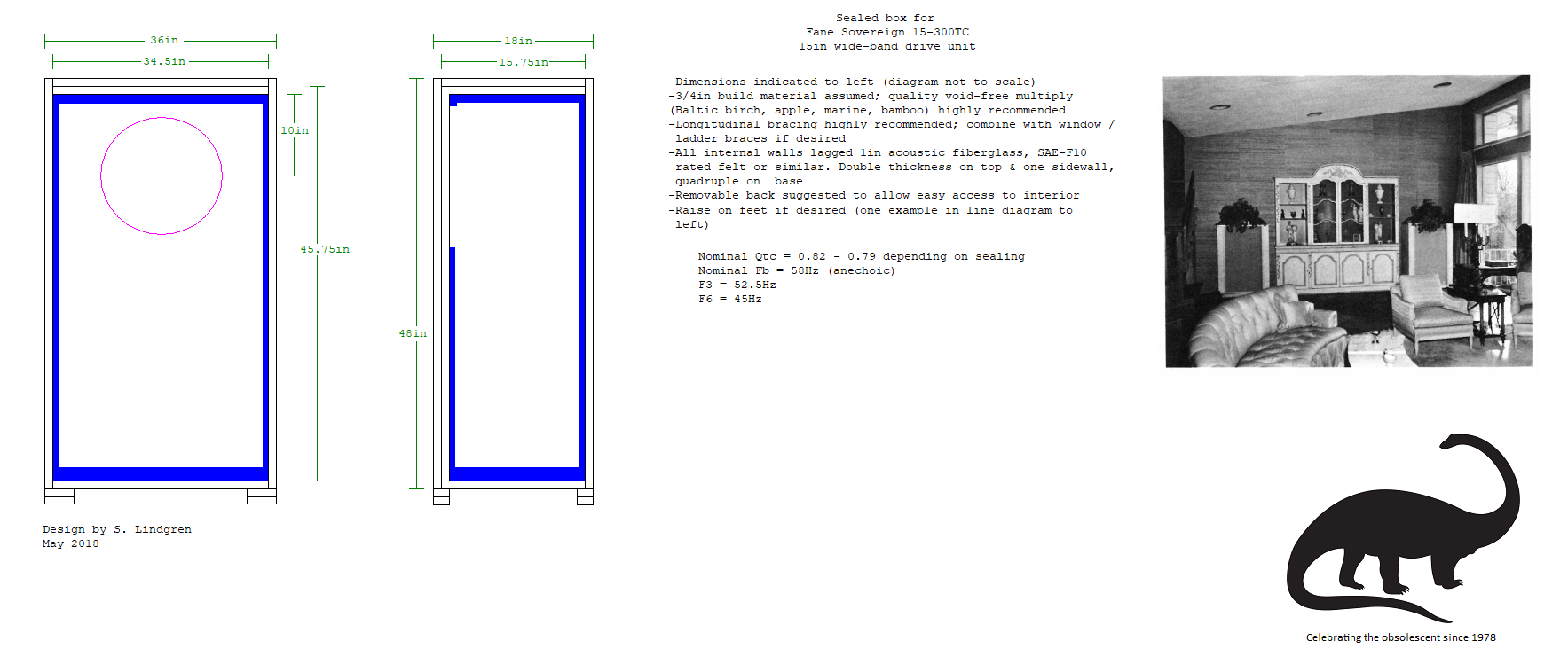

Well, I have done one for the 15in Fane. Actually there's two, but the other will have to wait for another time. This thread is a dumping ground for misc. existing designs I'd done rather than new ones, but I had one of my very few spare moments, so a quick one-off. Nothing fancy here, just a sealed box. Anybody who knows their audio history will recognise the original inspiration (pictured), although the construction & internal dimensions are different, along with the driver configuration.
Not small by current standards, so obviously of limited appeal, but the Fane likes a big box; it's heading in a traditional direction in terms of its basic EM characteristics. No bad thing, so long as you treat it as such, and fewer compromises in alignment terms than a smaller cabinet. I've called it a large sealed; acoustically speaking even this isn't 'large' per se for the Fane, but it's probably pushing it for a lot -there's no way I could house a pair of these cabinets for e.g.
I imagine Dave will have a big Fonken in the offing, so I don't want to get too heavily involved with this sort of load. The size here is sufficient that step loss is pushed right down into the region where room-gain should help compensate; Qtc is moderate, in the 0.8 region depending on damping & how good the sealing is.

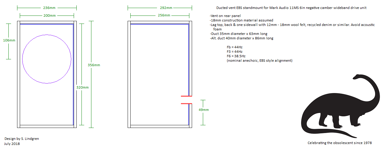

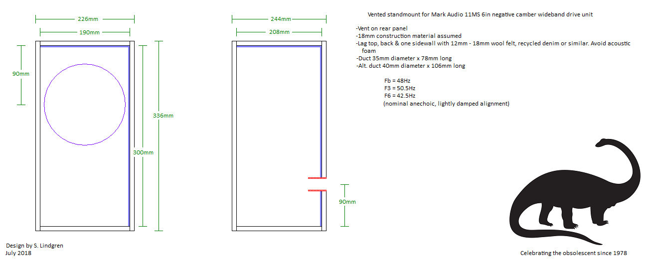

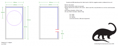

Some vented box designs for the new Alpair 11MS. Some other ones done too which will be uploaded on their relevant threads.

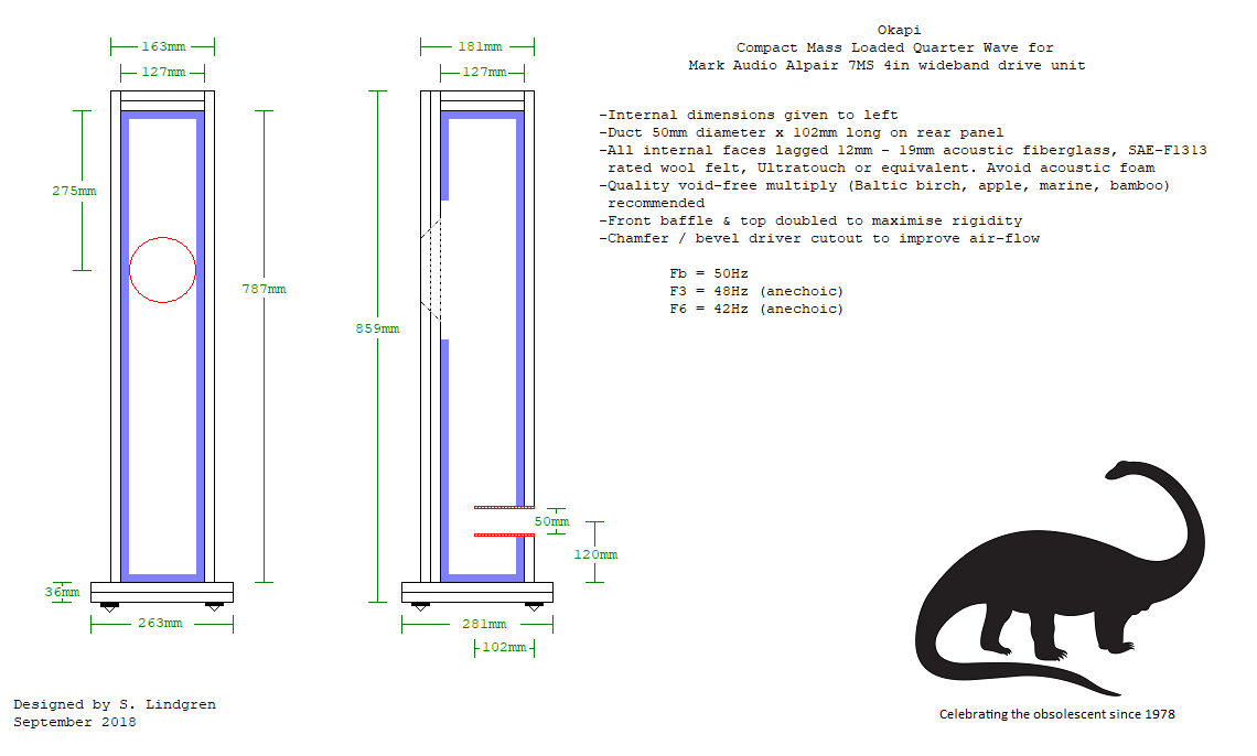

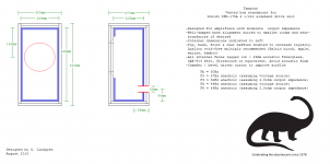

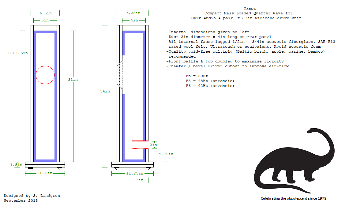

On that basis: I had a couple of requests for MLTLs for the new Alpair 7MS & 11MS units that are more compact than the pensils or the tall box in a post above for the 11MS.
They who ask shall sometimes receive (time permitting ;) ) so attached under the usual conditions.
7MS first. Quite nice, alignment targets a bit more extension than the pensil, without quite as much gain through the mid-upper bass, & with a slightly more conventional impedance load. Still mild though, an easy load. Name your poison.
Imperial & metric attached.
Shamelessly thieving Troels's text approach, Questions with the answer 'yes':
-Can I use MDF? (if you really, really must, but a quality multiply is preferred)
-Can I use xyz wire or binding posts? (providing you don't raise series R by > 0.2ohm)?
-Can I use acoustastuff, BAF etc. for the lagging?
-Can I omit the over-sized plinth? (providing you maintain a doubled baseplate)
-Can I tilt the enclosure back to angle the driver toward the listening position?
-Can I build a false base into the bottom to raise it up a bit? (although it rather goes against the object of a compact box).
Questions with the answer 'no'
-Can I omit the doubled top & front baffle?
-Can I move the driver?
-Can I move the vent?
-Do I have to use spikes?

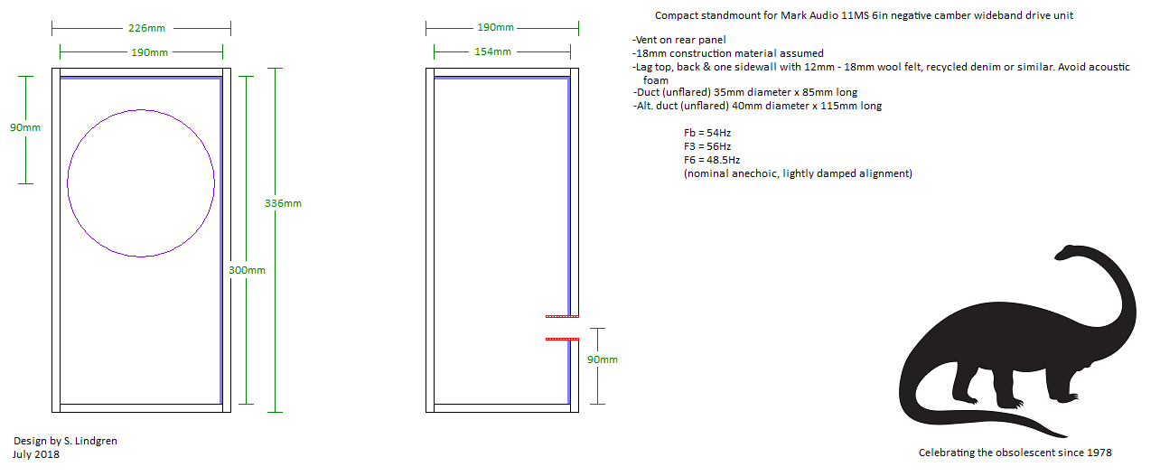

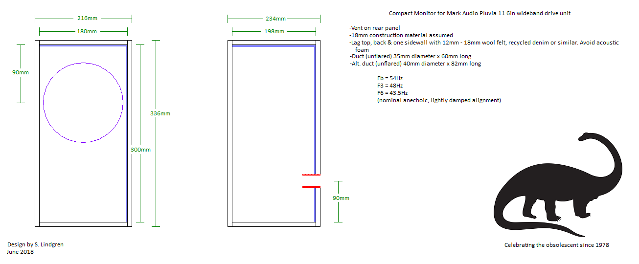

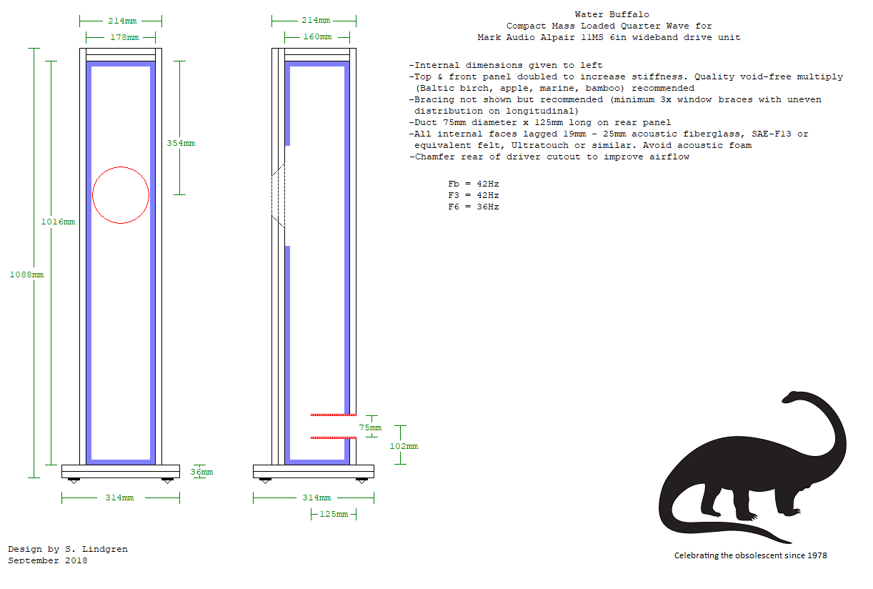

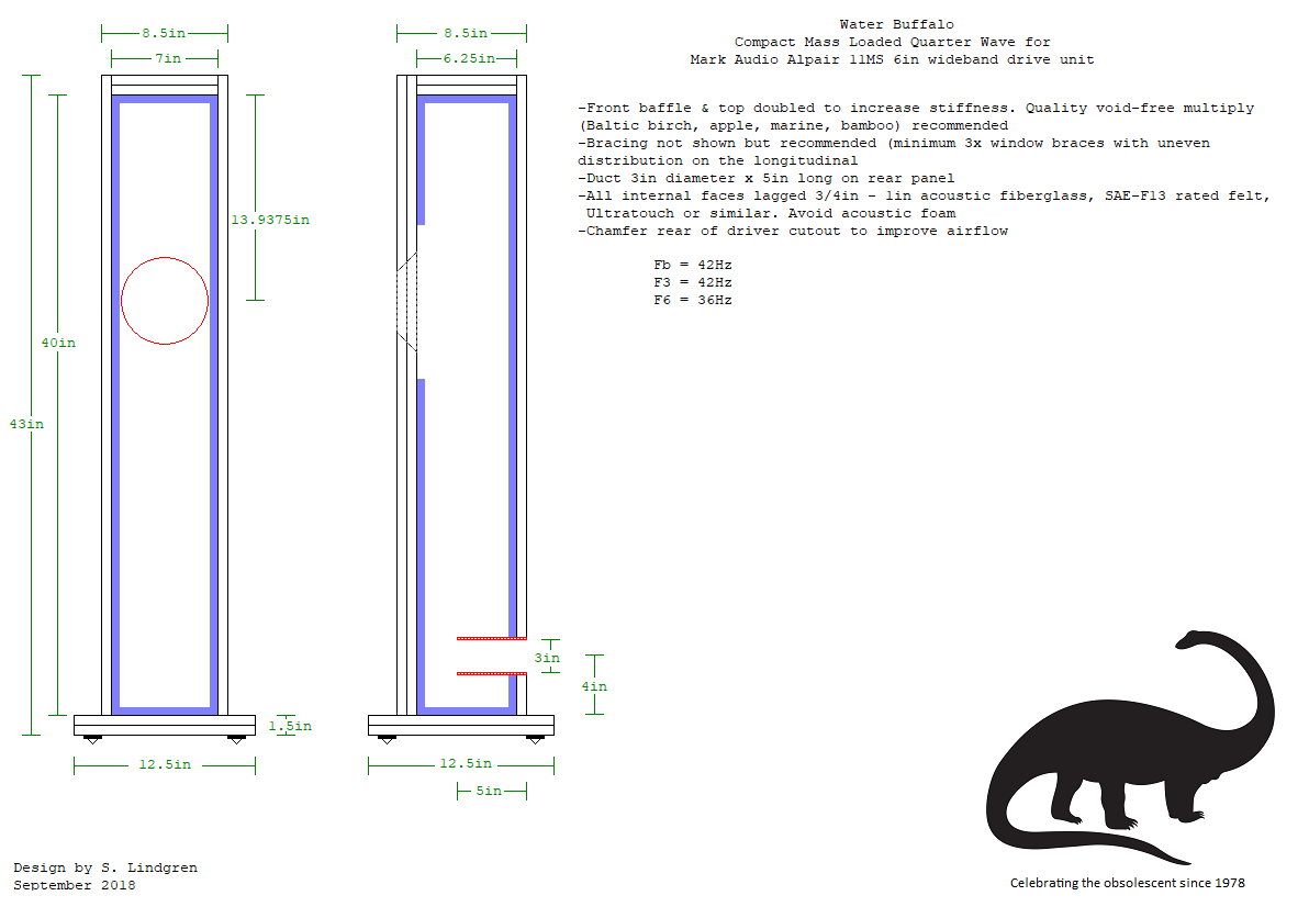

And for the Alpair 11MS.
Similar approach to the above; aims for a bit more extension than the pensil, without quite as much gain through the mid-upper bass, and with a more conventional impedance (again, not particularly reactive). Back to naming those poisons.
Following above, questions with the answer 'yes'
-Can I use MDF? (if you really, really must, but a quality multiply is strongly preferred)
-Can I tilt the enclosure to angle the driver to the desired axis?
Imperial & metric sketches attached. Poor quality, but I can't plague Dave constantly & they're not really rocket science.

Geeze , Scott, the q&n A11MS prototype I blasted together for Dave’s event were only single layer of 18mm on fronts - with of course some bracing between panels, and they sounded quite fine, at least to my ears.
Out of curiosity, whence the “Water Buffalo”?, these drivers are everything but ponderous
Idle whim really. I like water buffalo. Amiable sort of creature, wallowing away and enjoying some quality veg. :)
As for the panels -let's just say 'if enough is enough, then too much is just right.' Some people struggle with the bracing, so kicking up the stiffness of the panels themselves helps, plus the extra mass on the front baffles gives the driver something to work against. At least, it does in my mind... ;)
