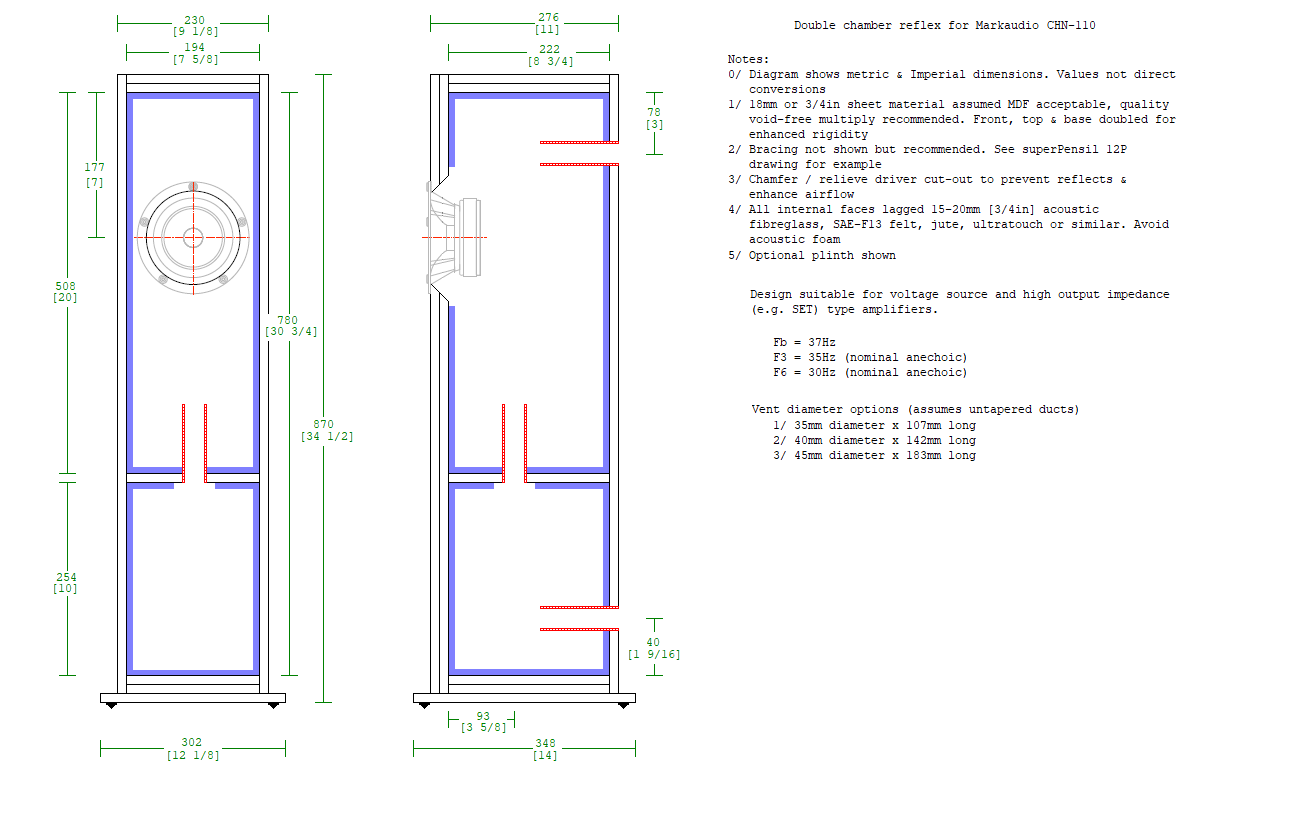

Could this work if I made the port into a slot and put it on the front - Pensil style? Keeping the cross sectional area and length of port the same of course.
When turning a duct vent into a slot you get an aspect ratio higher than 1 (a circular duct). If this gets severe resistance is added to the vent (and the vent usually ends up right at the end of the box), so it becomes at least not quit eteh same. We have almost always done something like this with the Woden designs we have built. We have had good success.

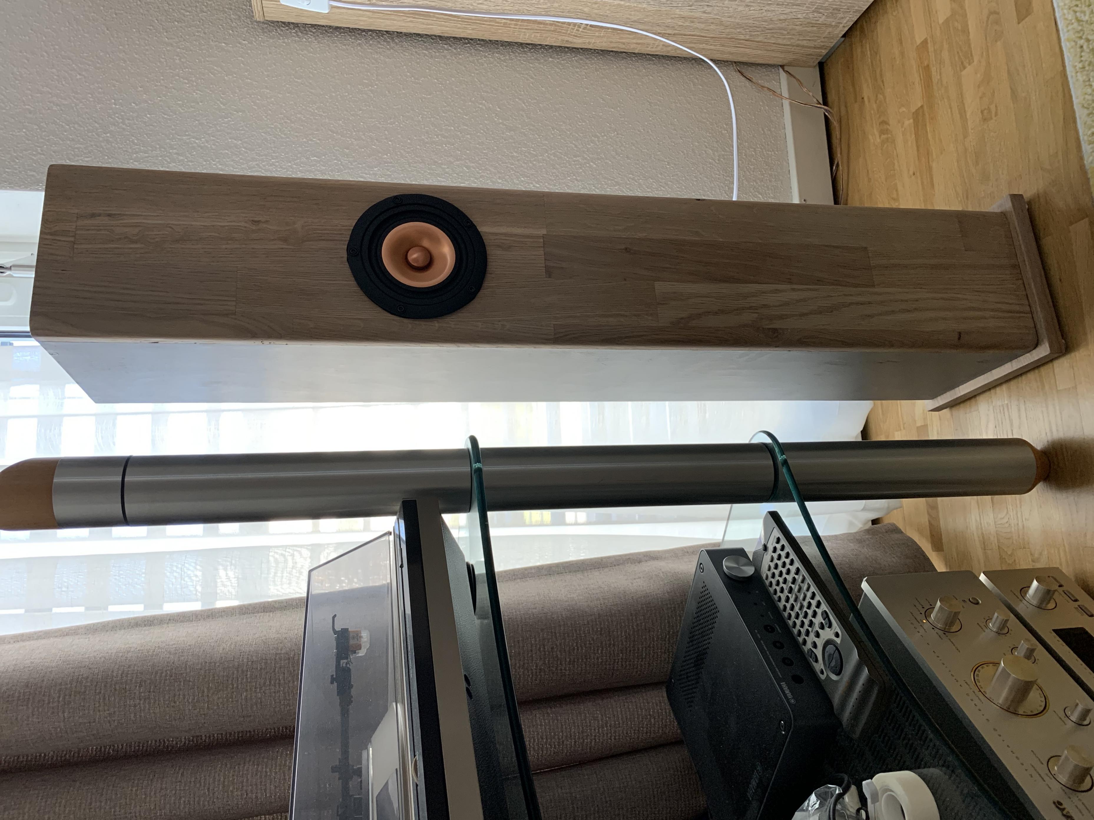

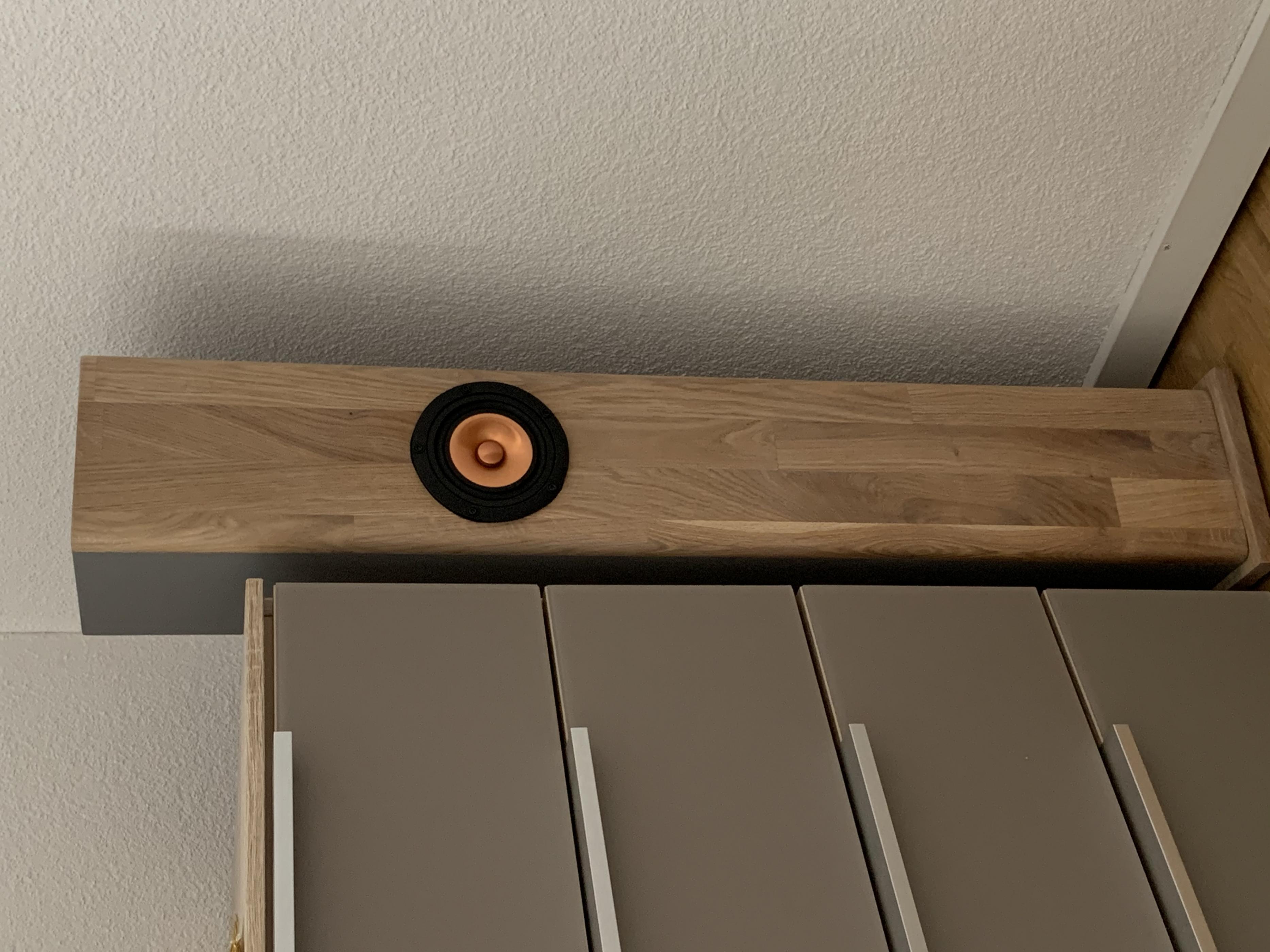

Thank you for Okapi 7ms design. I finished build today. Sounds great!
BR, Alexey
Beautiful wood choice. I just finished a pair up myself using birch plywood. I'll post pics when I get a chance.
Some proper drawings & a couple of my rubbish sketches of enclosures for the CHN-110. I thought I'd uploaded these a while ago. Evidently not.
- Full Range
- Miscellaneous designs - Markaudio, Fostex, TB, Dayton, SEAS etc
