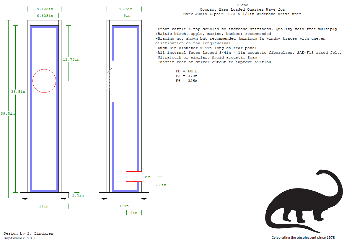

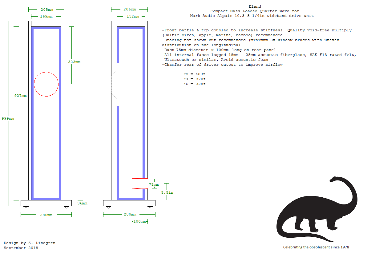

With a few tweaks could this be used for the Alpair 10.3m?
I didn't want to put out any other boxes for the 10.3 / 10P as there are plenty of quality designs for these units already available. If you want a relatively compact ML quarter-wave variation though: attached.
Following the above, questions with the answer 'yes'
-Can I use the Alpair 10P? (F3 & F6 rise slightly but a decent alignment)
-Can I use MDF? (if you must, but a quality multiply is preferred)
-Can I use xyz wire or binding posts? (providing you don't raise series R by > 0.2ohm)
-Can I use acoustastuff, BAF etc. for the lagging?
-Can I omit the over-sized plinth? (providing you maintain a doubled baseplate)
-Can I tilt the enclosure to angle the driver to the desired axis?
Questions with the answer 'no'
-Can I use a different driver (including different generations of the Alpair 10)?
-Can I omit the doubled top & front baffle?
-Can I move the driver?
-Can I move the vent?
-Do I have to use spikes?

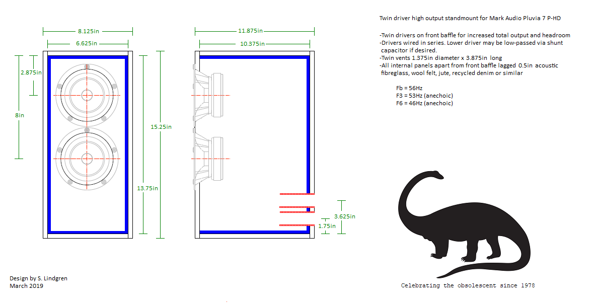

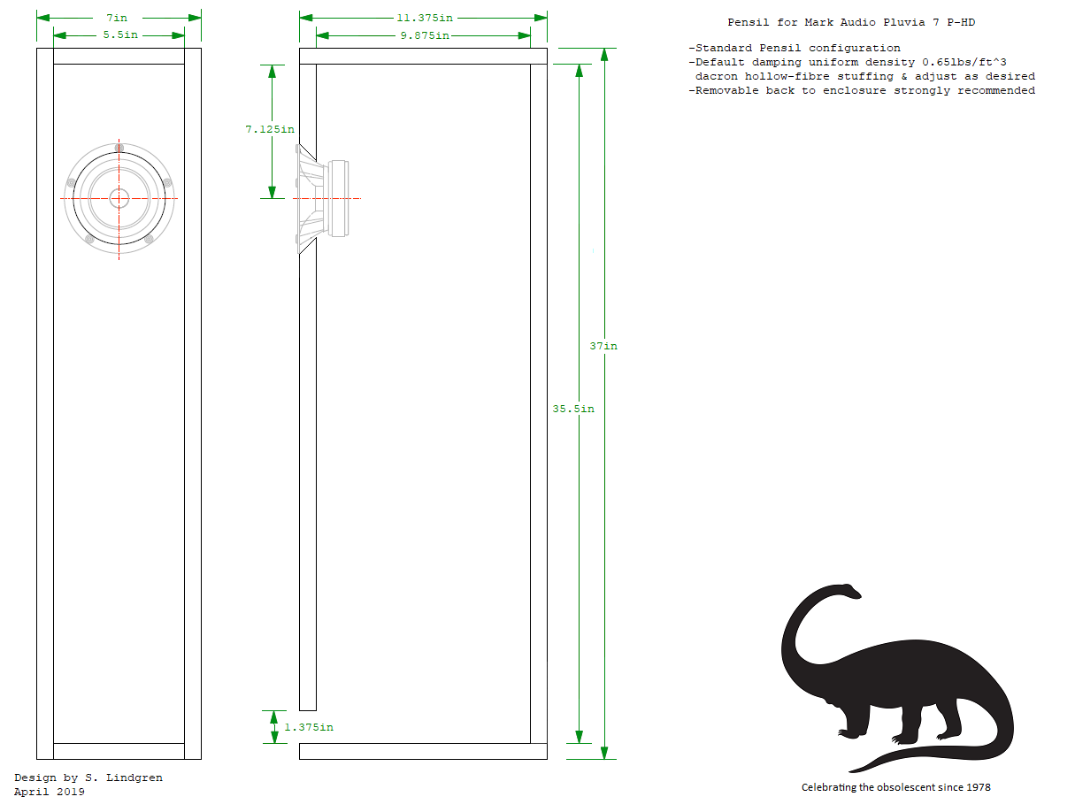

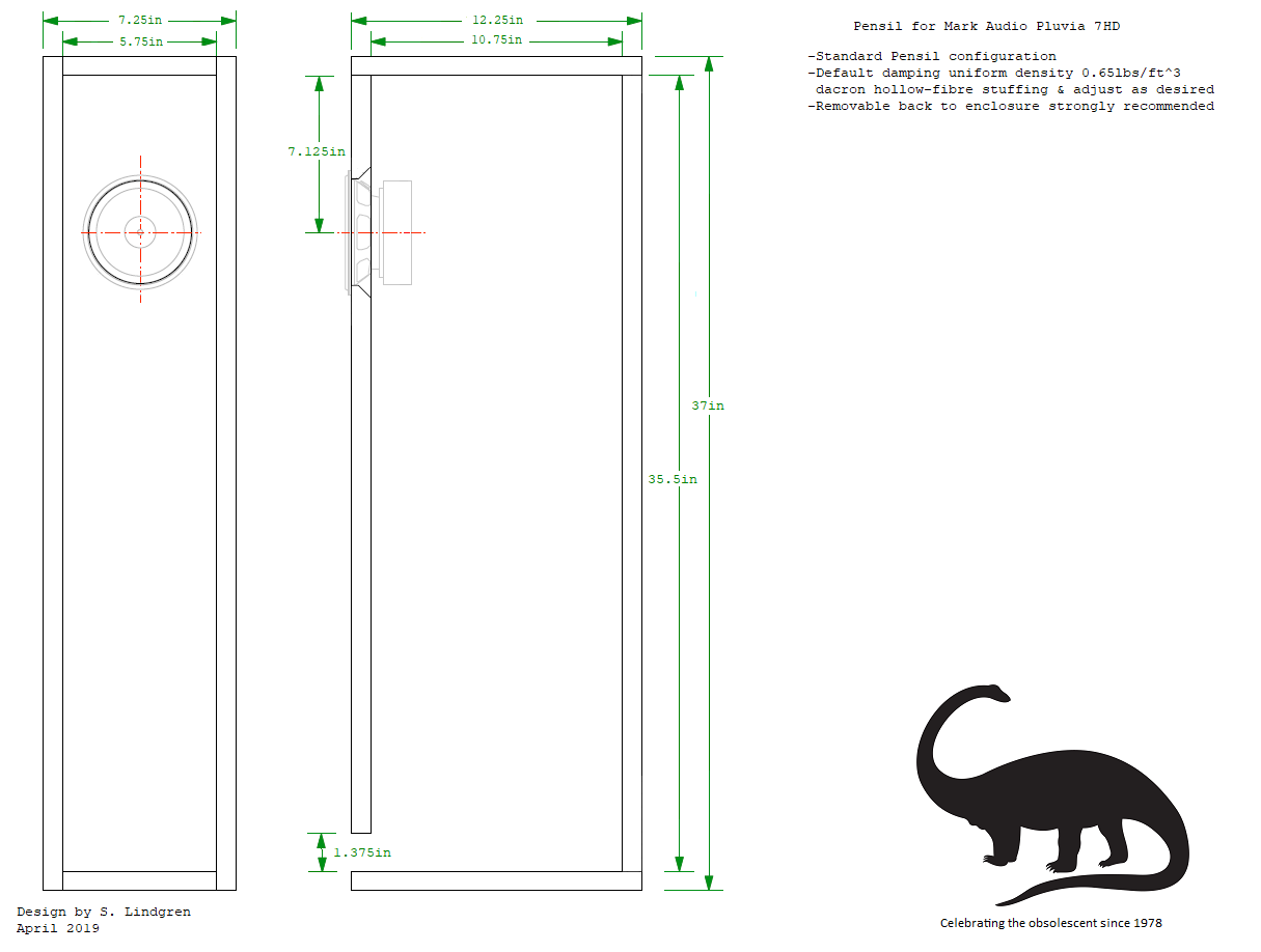

Continuing my dumping ground for misc. designs I've come up with, here are pensils for the new Pluvia 7HD and Pluvia 7 P-HD. Like some of the above, these are new[ish] rather than old designs, but I haven't anywhere else to put them, so they can live here. Note that the HD and P-HD are very different drivers in design and balance, so try not to get them mixed up.
Apologies as always for my rubbish sketches (some parts plundered from Dave's CAD drawings and adapted. Very badly).
The metal cone Pluvia 7HD is basically the guts of the Alpair 7.3 in a Pluvia basket with a couple of tweaks. The paper cone Pluvia 7 P-HD was created largely by the Japanese distributor & company co-owner with feedback from a specific set of his clients; the response caters for their particular requirements.
Shamelessly borrowing again from Troels Gravesen's text layout, :
Questions with the answer 'yes'
-Can I use MDF for construction? (if you must, but a quality multiply is preferred)
-Can I use acoustastuff, BAF etc. for the lagging? (yes, but you will need to experiement with density. Since they're designed for this to be adjustable in the first place, you're bobbing)
-Can I add a plinth?
-Can I add bracing? (providing it doesn't distrupt the longitudinal standing wave)
-Are the Pluvia 7HD and Pluvia 7 P-HD interchangable, acoustically? (you can, but the alignment will shift away from the target)

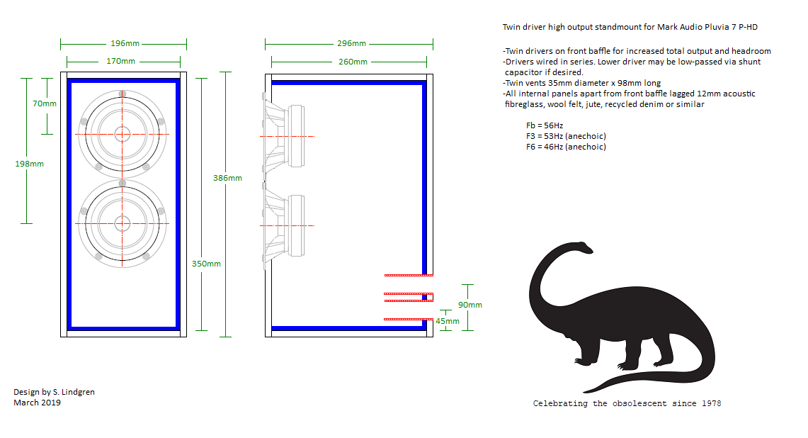

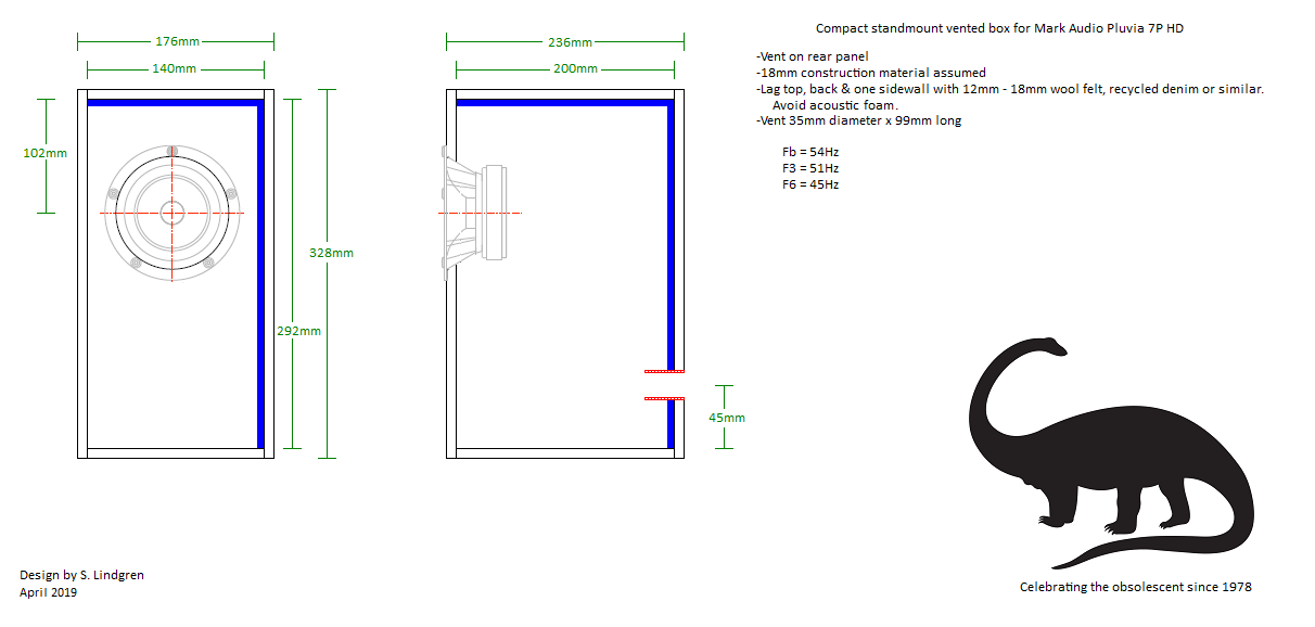

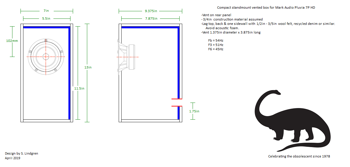

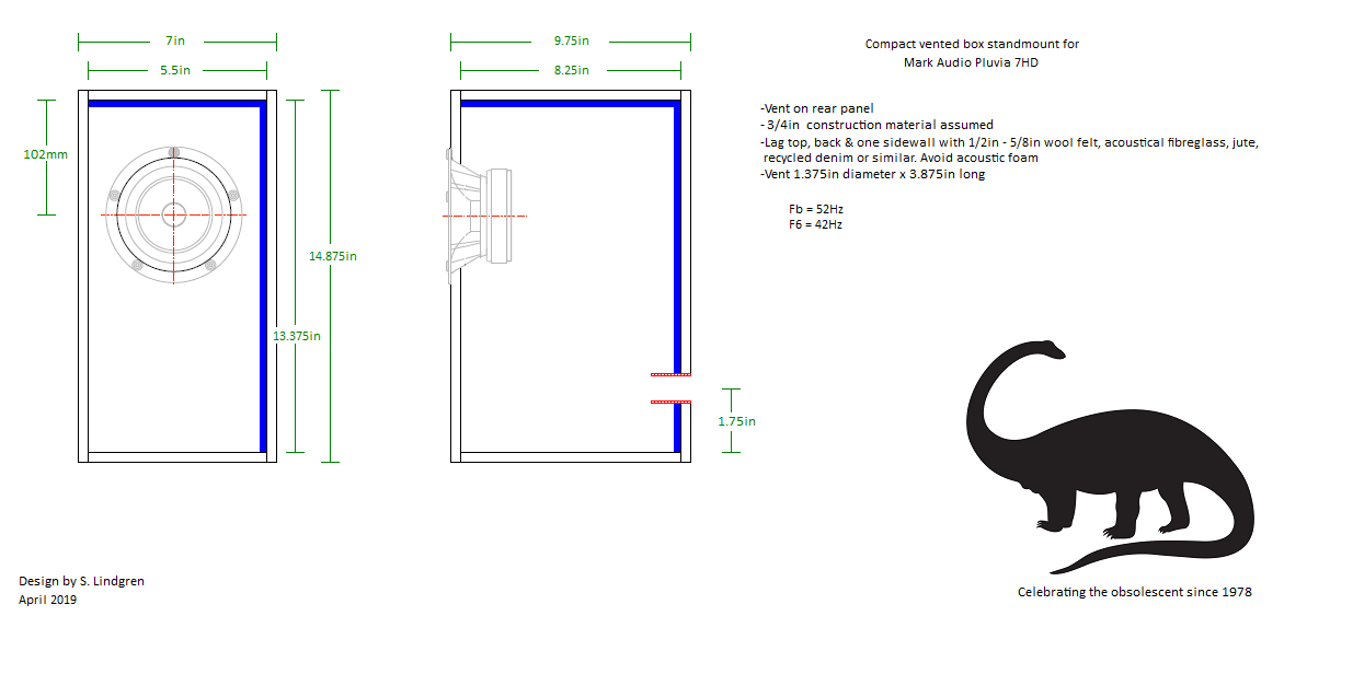

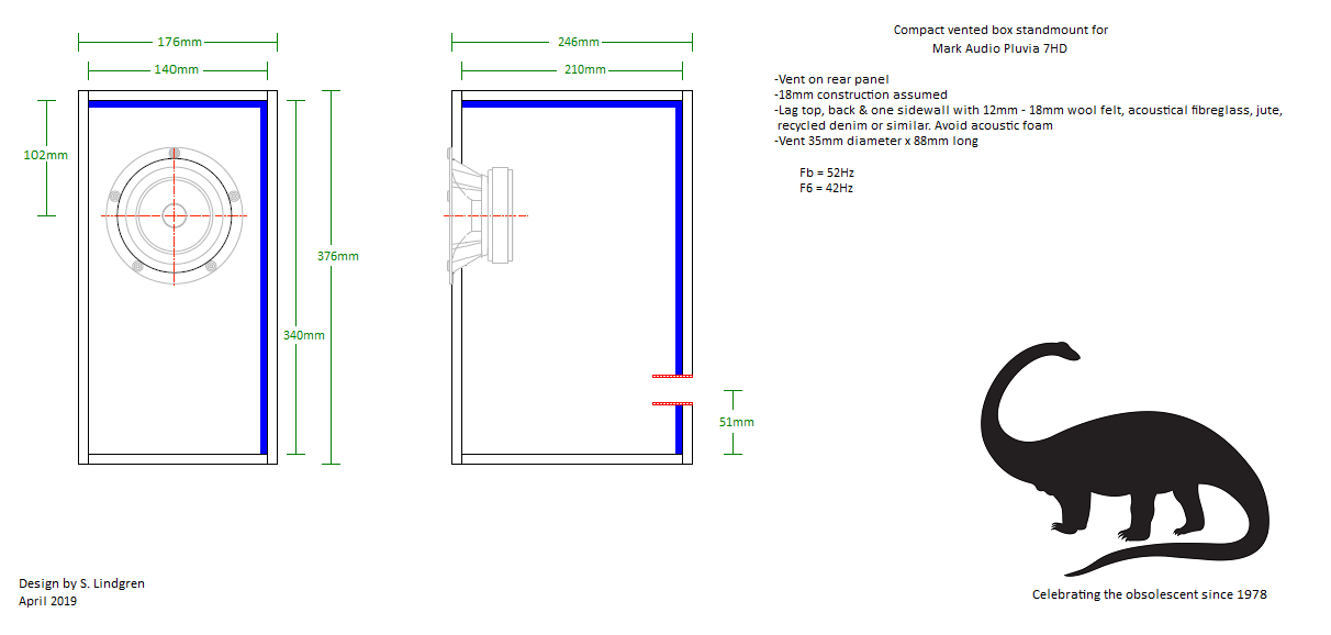

And while we're at it, a few more for the new units. Compact vented standmount for the Pluvia 7HD. Perfectly standard, meant for smaller spaces or at least where space is at a premium.
And two for the paper cone version; single and twin-driver boxes.

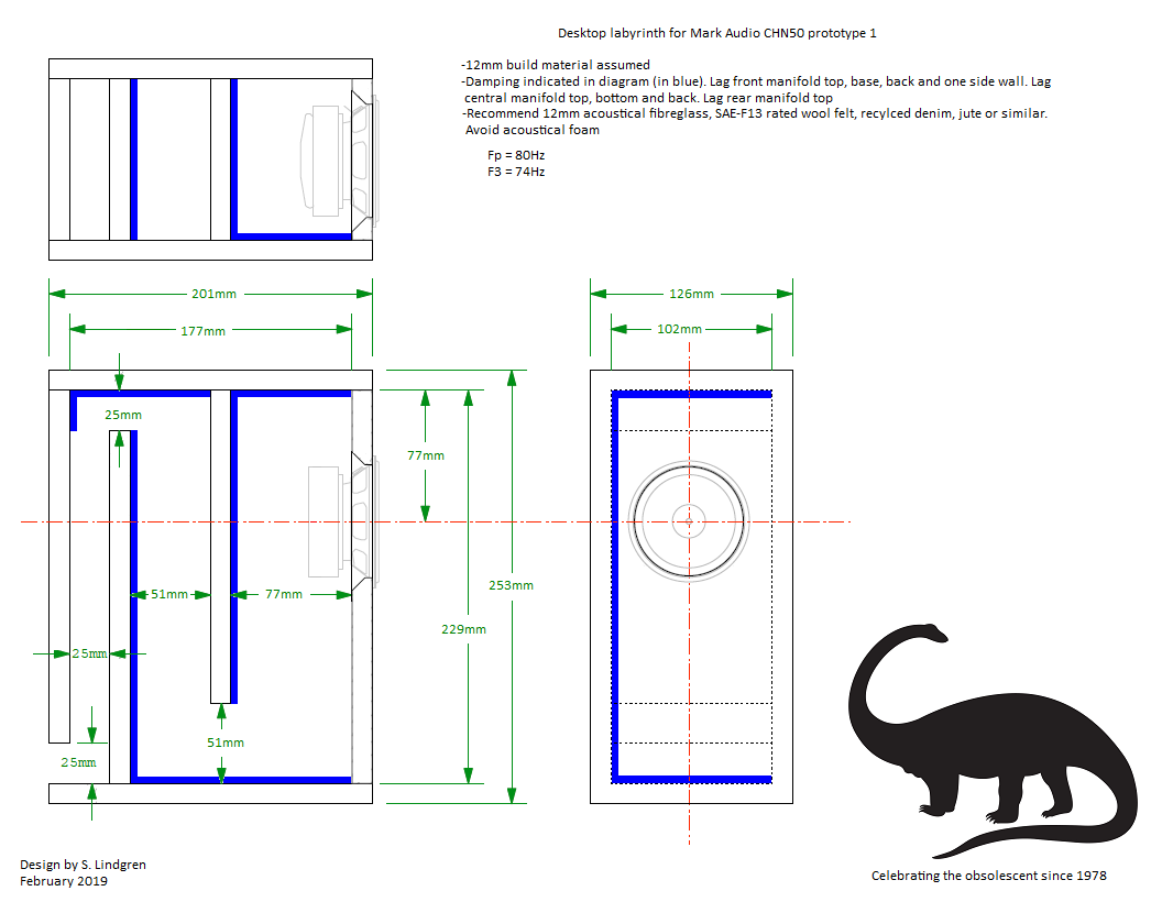

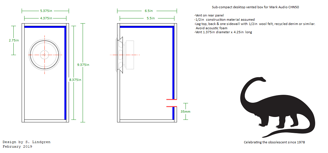

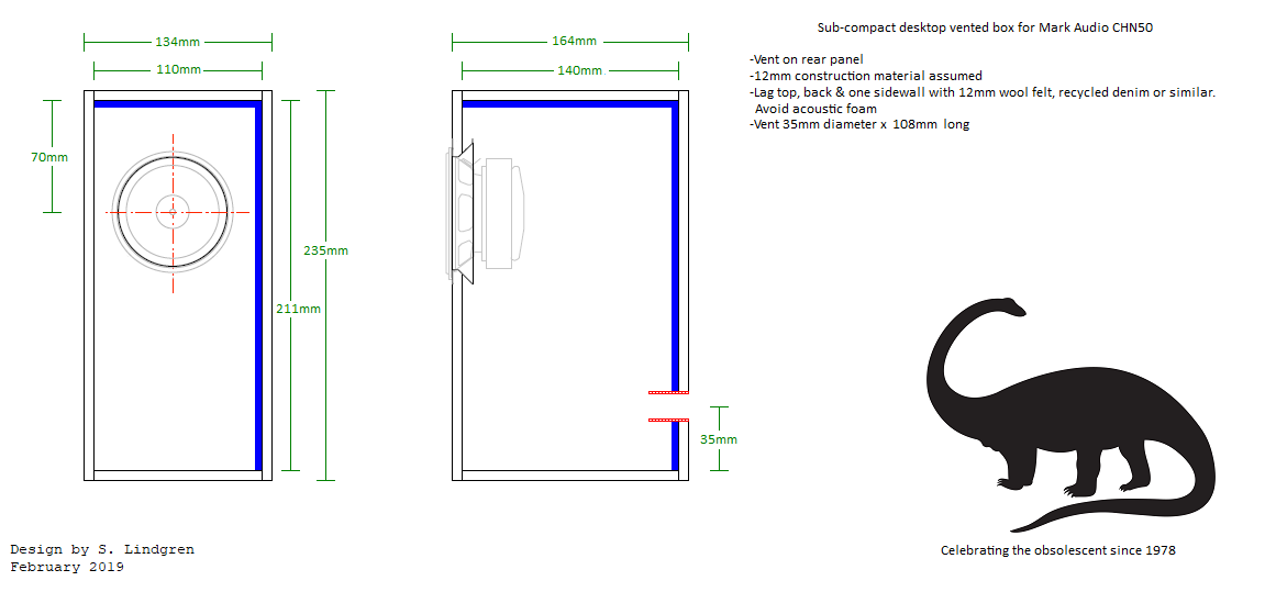

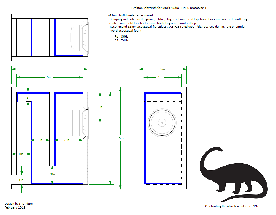

Blast. Forgot the ones for the CHN50.
Two compact vented desktop & a compact desktop labyrinth.

Hi Scott,
Could you please provide the F3, F6 for these enclosures.
Which is the successor to alpair 7.3 , is it pluvia 7hd or alpair 7ms?
Or is pluvia 7hd successor to pluvia 7?
alpair 7.3 and alpair 7ms are similarly priced, which is significantly more than pluvia 7hd price.
Hi Scott,
F3 no (not important or meaningful to the human ear/brain, ref Toole). F6 estimated yes.
A7ms is the successor but P7HD is supposedly a direct evolution based on A7.3 soft parts.

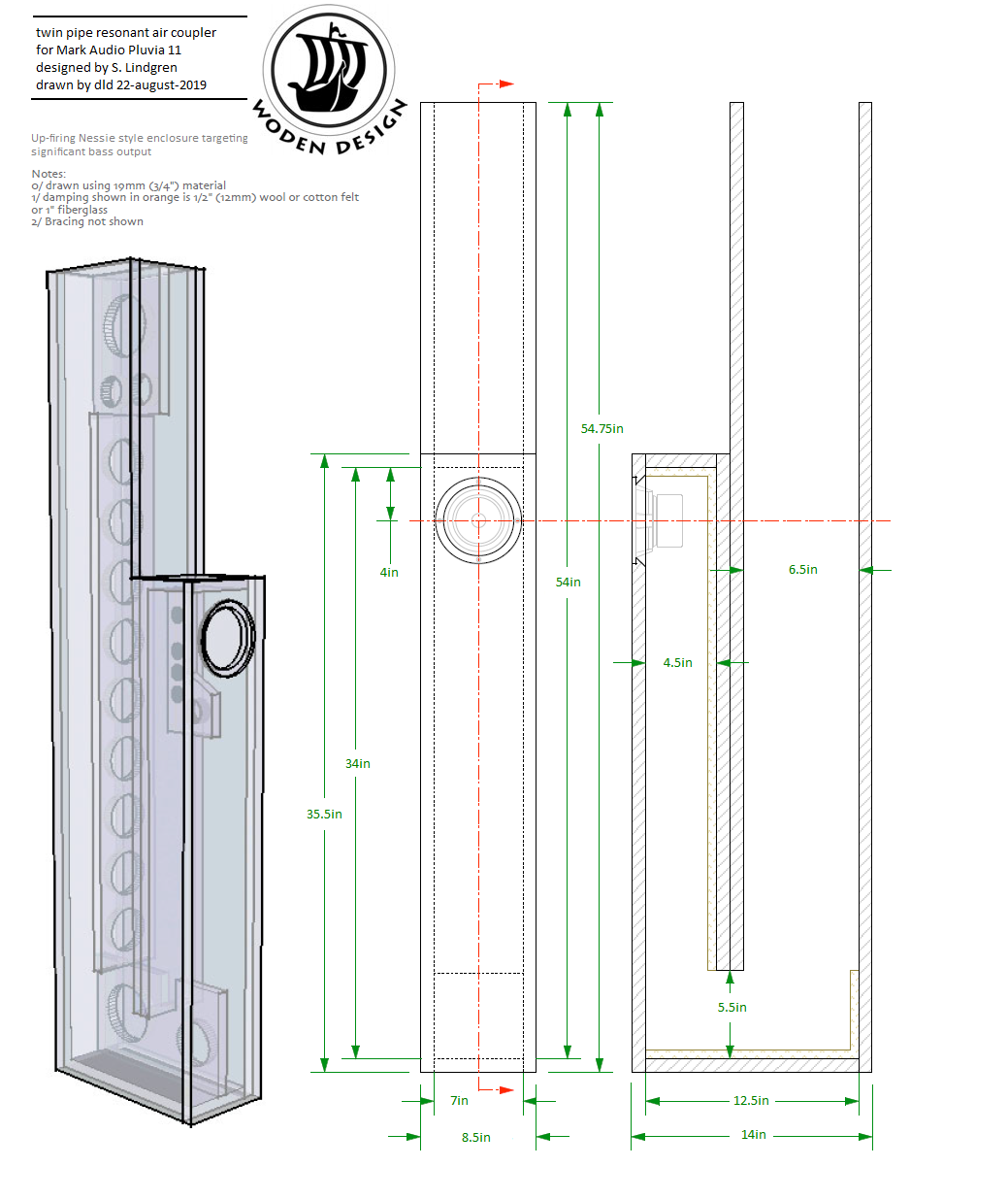

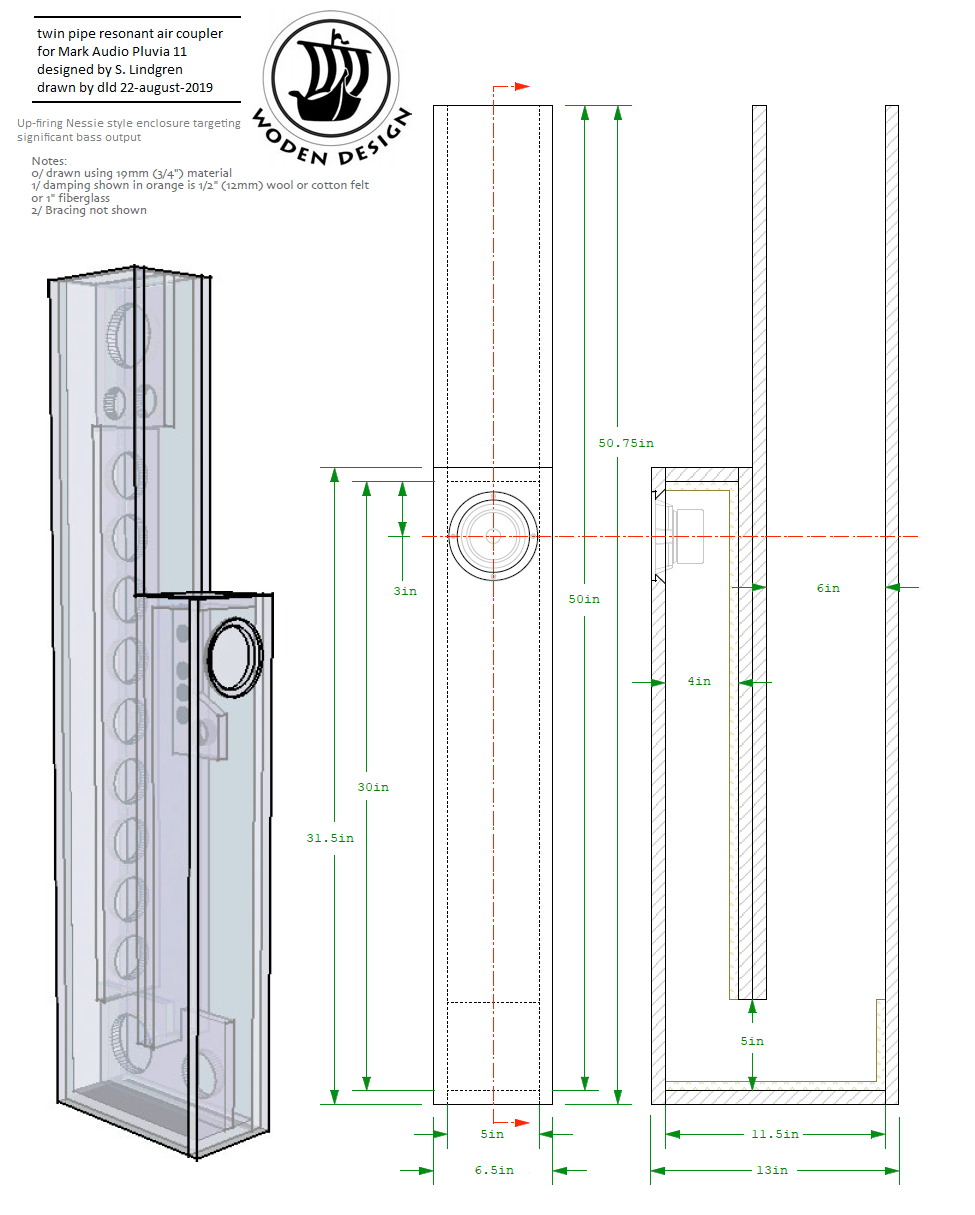

With the current interest in Loch Ness and our resident survivor, it seemed time for a couple of Nessie enclosures. I haven't done one of these for years, but dug out my 'Nessie Alignment' spreadsheet I created a decade ago & fired it up.
Nessies do not look very pretty on a graph, like most big QW pipe variations, but those who like them really like them; they also look a bit different to the norm. The smaller driver versions need you to go easy on the volume knob as excursions are relatively high.
Note: the drawings credit Dave for the CAD work; actually I modified one of his existing drawings (all the bad bits are mine) as I can't plague him constantly, and it looks a bit better than my miserable 'from-scratch' efforts; he still should get the credit though.
Pluvia 11 Nessie:
Pluvia 11 Nessie:

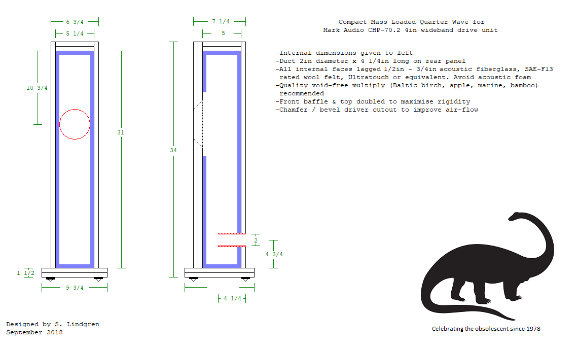

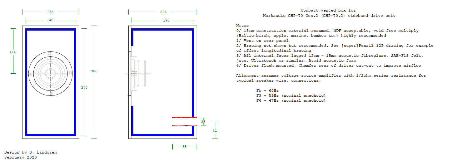

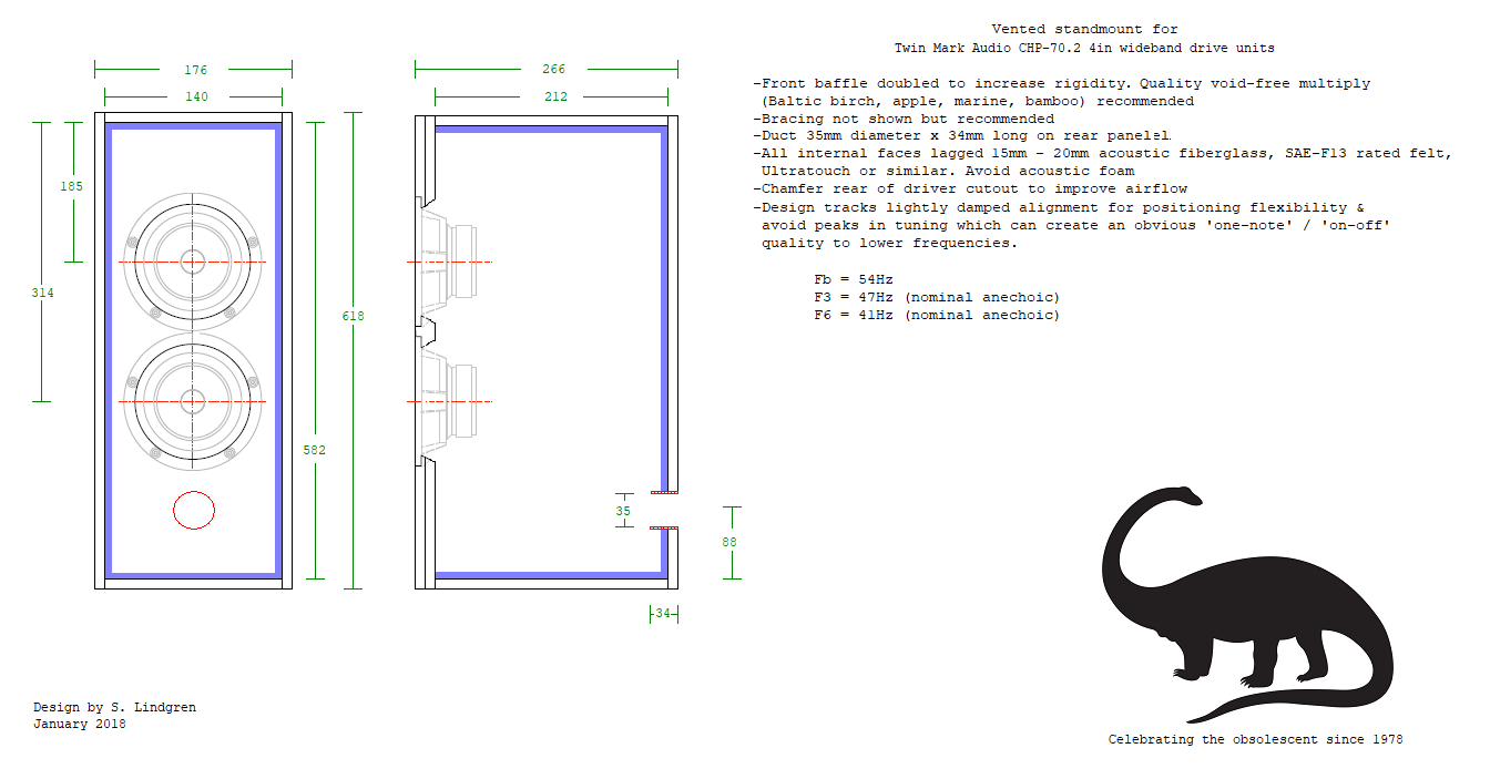

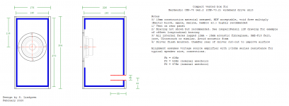

Since I'm currently selling a stash of brand-new-in-box CHP-70 Gen.2 (aka CHP70.2) drivers in the appropriate part of the forum, it occured to me to have a traul through some of my more accessible HDDs to see if I had any unpublished designs. I've found one at least, so adding here, for completeness. Looking it over, I see I missed a depth dimension for the plinth, which should be 10 3/4in. Fb as I recall is 47Hz, output to the low 40s. Flat anechoic alignment (I don't normally do that, but in this case it gives it a bit of a kick that suits the driver) & adjustable length spikes are suggested so you can tilt it back to aim at the listening position.
I hadn't intended to do any more boxes for the CHP-70.2 (not for the time being anyway), but since I've sold some of my stash of NIB units and there aren't a vast number of designs out there for it, here's one I've run my own pair in. Nothing fancy, just a smallish vented box; I've played off the alignment to suit the driver's own character; lightly damped around tuning with a slight increase an octave above Fb due to the system Q. I've also found one I did a while back for two of the units; acoustically slightly larger volume & tuned a bit lower. One can be rolled off if / as desired, or both run wide open as the builder prefers.
