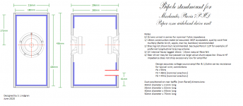

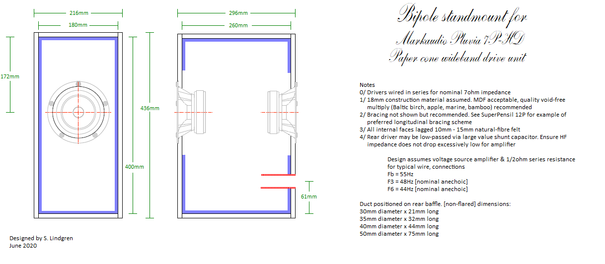

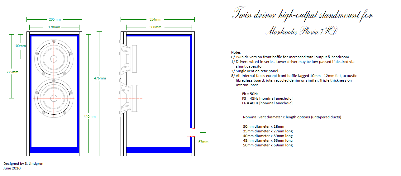

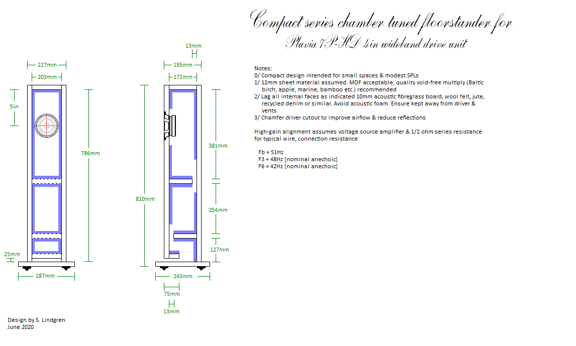

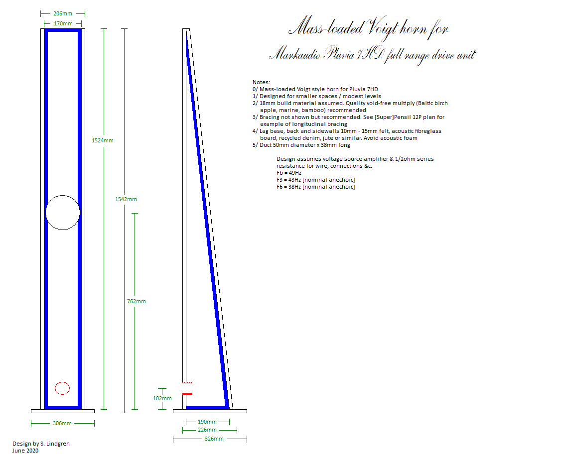

Lockdown blues or no, it was at least productive in that it gave time for designing new speakers / enclosures. Since none of these have a suitable home on other threads, I'll drop them in here. Usual disclaimer applies -I make no pretense these are good drawings, state of the art designs, 'perfect', or to all tastes. They're just what I did assuming various targets (since most people want different things, I try to cover a reasonable number of bases).
First up, three more for the Pluvia 7HD to go with the existing designs. More to follow for a modest variety of drivers over the next week.

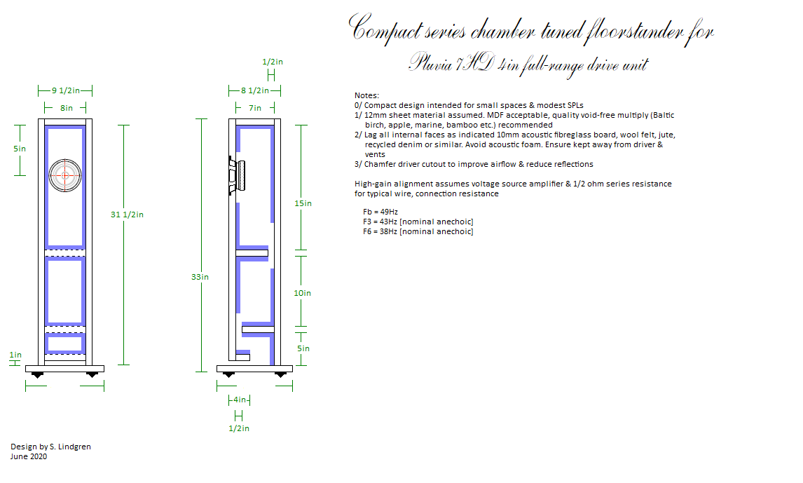

I have been looking at these plans and doing mental experiments based on a number of designs I have built and/or heard over the years. It's a lot of fun to think of the types of rooms, music, amplifiers, etc. where each of these designs would shine, or not.
I purchased the Poplar plans because that is the cabinet that will best fit the bedroom 5.2 HT setup I am in the process of building. There has been this niggling concern, however, giving me pause that I have been unable to articulate. It has something to do with the "presence" or "impact" that is sometimes demanded of HT material. I have used the A10.3m before and it is a great all round affordable driver. I already have a couple that have been in different enclosures. I thought it was bass extension at first that was concerning me. But looking at the dual driver designs in this thread I now think that a dual driver Poplar with a pair of A10.3m's would do a better job for the FL and FR. The center and RL/RR would be fine as single driver Poplars. The bass extension of the Poplar/A10.3m is plenty adequate in a small bedroom with two subwoofers. But now I realize what has given me pause is the amount of skin or square inches of driver in the game. What modification to the Poplar would allow it to become a dual driver enclosure? Or, am I barking up the wrong tree?

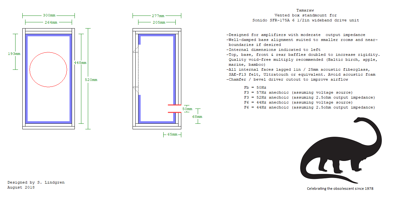

I've been thinking about building this Sonido stand mount because it's not too large of a speaker and my room isn't that large. But i also think that you (Scott) have mentioned working on other Sonido designs which I'm assuming is a frugal horn. Are any of the Sonido enclosures you haven't released going to be smaller? Smaller to me means less than 1000 mm tall, 300mm wide?
Sonido has a smaller enclosure for their oval driver as well that I'm considering also.
I did; they were only part-complete though & I wasn't happy with them, so they didn't progress from there. Those particular designs are consigned to the bin; I've something a little different up my sleeve for them which will appear on the Woden site; however, right now Dave has enough on his plate without me dropping a complete new range of 'site speakers' on him, so I'm holding fire until he's cleared some of those & custom commisions.

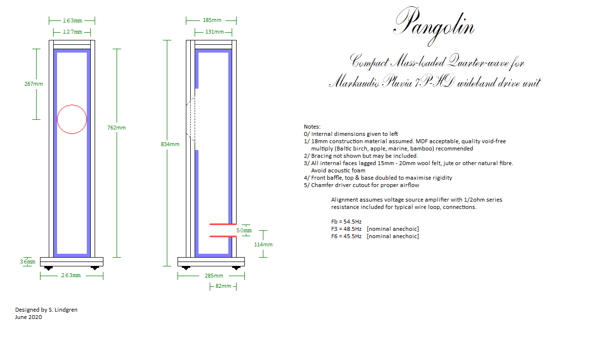

Meanwhile, continuing the lockdown designs, three more, this time for the paper-cone Pluvia 7P-HD.
I'm particularly pleased with Pangolin, which (unusually for muggins here) is a maximally flat box tuned to 0.707Fs. Max-flat isn't an alignment I usually like, but it should suit the P-HD characteristic, so for once, here it is.

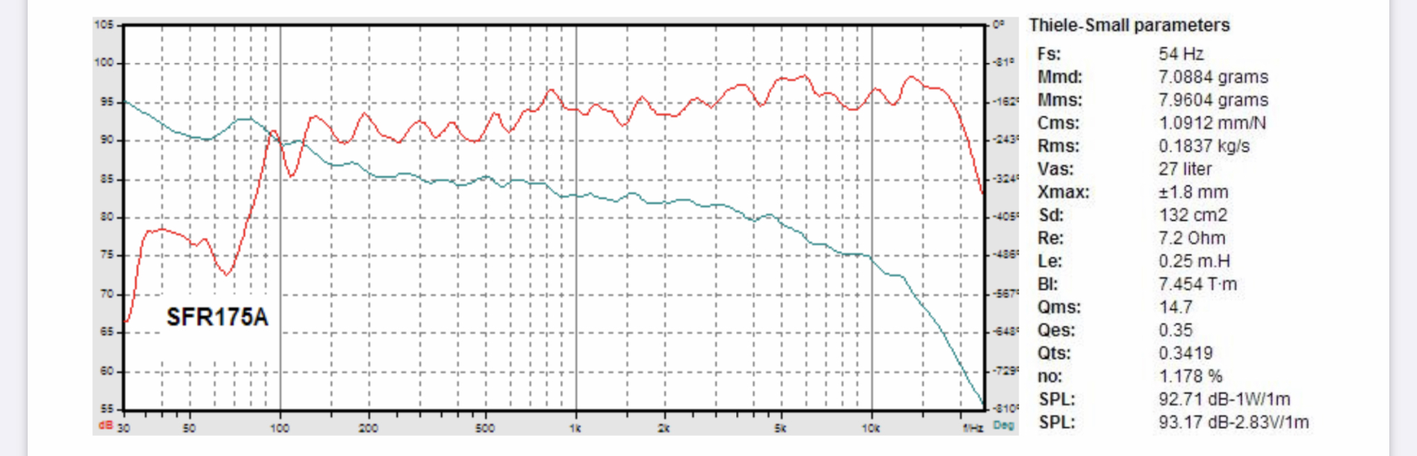

The driver specs show a rising response. Does that need to be compensated for in some way? I don’t mind trying different things to To correct it and see it as an opportunity to learn a few new things.
I’m getting restless and need some sort of project to work on.
Short answer: 'it depends' I'm afraid. The measurement conditions of the driver are not stated, and paper assumptions of necessary 'correction' do not generally take into account system behaviour -amplifier characteristics, room acoustics, position of the speaker within that space, and whether you are listening off-axis, which is what is intended for most wideband drivers with a rising axial response. So my general ROT / advice in such cases is to build it, and see what EQ, if any, you wish to apply based on actual experience and requirements / preferences.

Scott,
I've ordered the Sonido drivers and they are in transit from Hungary and I'm working on the box. However I'll admit I didn't fully understand some of your notes about voltage source amps and "moderate" output impedance.
I spent some time simulating the box and I'm pretty much matching your posted specs and see how the output impedance affects the curve.
One of my amps is a voltage source amp (Aleph J) but it's output impedance is on the lower side - .4 ohms.
Is the solution as easy as putting a resistor in series with the output of the amp to bring up the output impedance to 2.5 ohms? Or does that just raise the impedance at the speaker?
