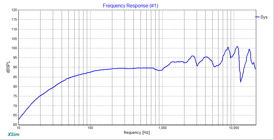

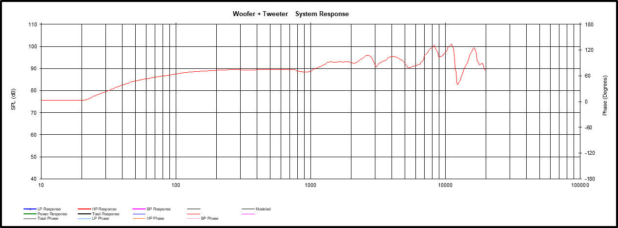

Decidedly not great (by spec) up top. I strongly suspect phase plugs and a little whizzer tweaking could help with that issue at least a bit — same one that fits the FA22 should work. Looks like real worls sensitivity is about 85dB.
attachment.php

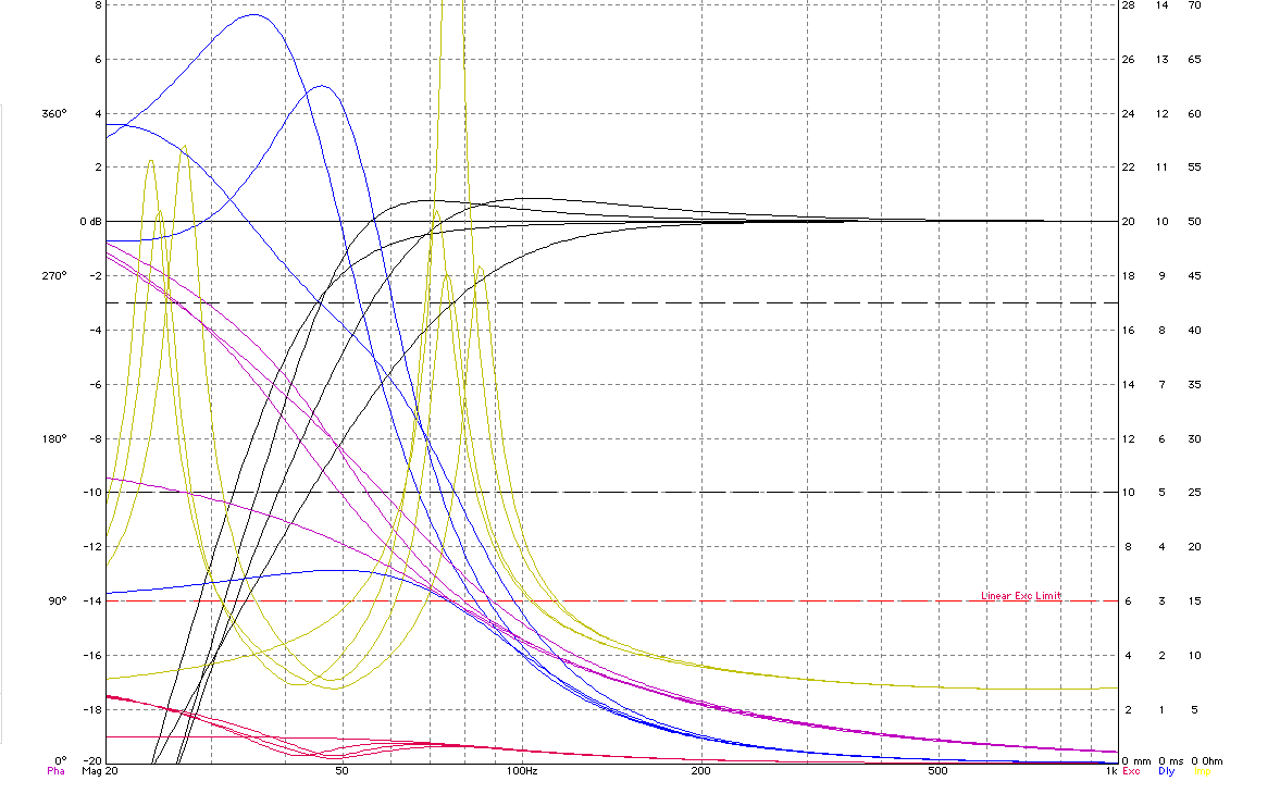

Looks like 25 litre for an optimum miniOnken, could go as low as 13-15 litres, sealed would be about 13 litres. F10 in the low 30s vented, low 50s sealed.
attachment.php
1 sim 25 litre, tuned for high ratio resistive vents, one with plumbing pipe, 1 15 litre, tuned for high ratio resistive vents, and sealed butterworth.
dave

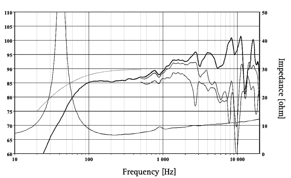

The 19 litre vented to 47Hz in the application note is OK if you want a smallish box. Bit acoustically under-sized so the usual slight rise a touch under octave above Fb as they mention, but overall well-damped LF alignment below that.

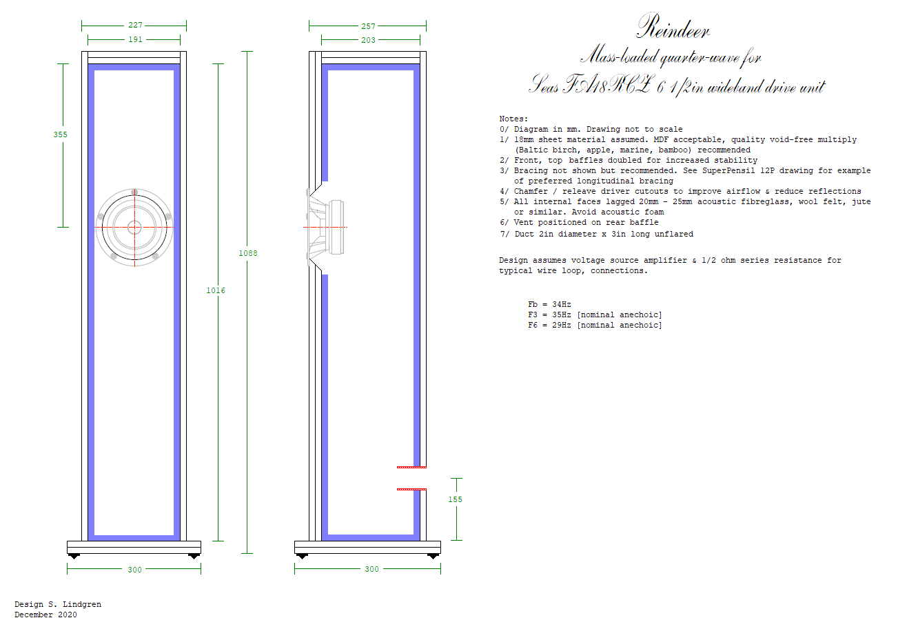

Here's a floorstanding alternative, FWIW. Add a low-pass shelving filter (or anything else) as desired.
Thanks so much guys! I appreciate the pros adding there thoughts! I was leaning towards a smaller size BR cabinet but could go up from 19litres for sure.. Also they mention a inductor and a resistor in series with the driver to attenuate the HF of the driver... What do you think about that?

Recently found a pair of the SEAS FA22RCZ's on sale and bought them, now planning on building the ml-voigts for them you posted on page 1. Just two questions about them before I really start: will a rectangular mouth like on the graphic you posted be good for mass-loading it or would a vent of some sort be better? Also, since I cant find any strictly acoustic felt, would just a heavy 1cm (2/5") thick felt do the job well enough?
Cheers
