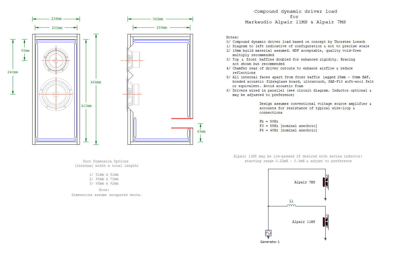

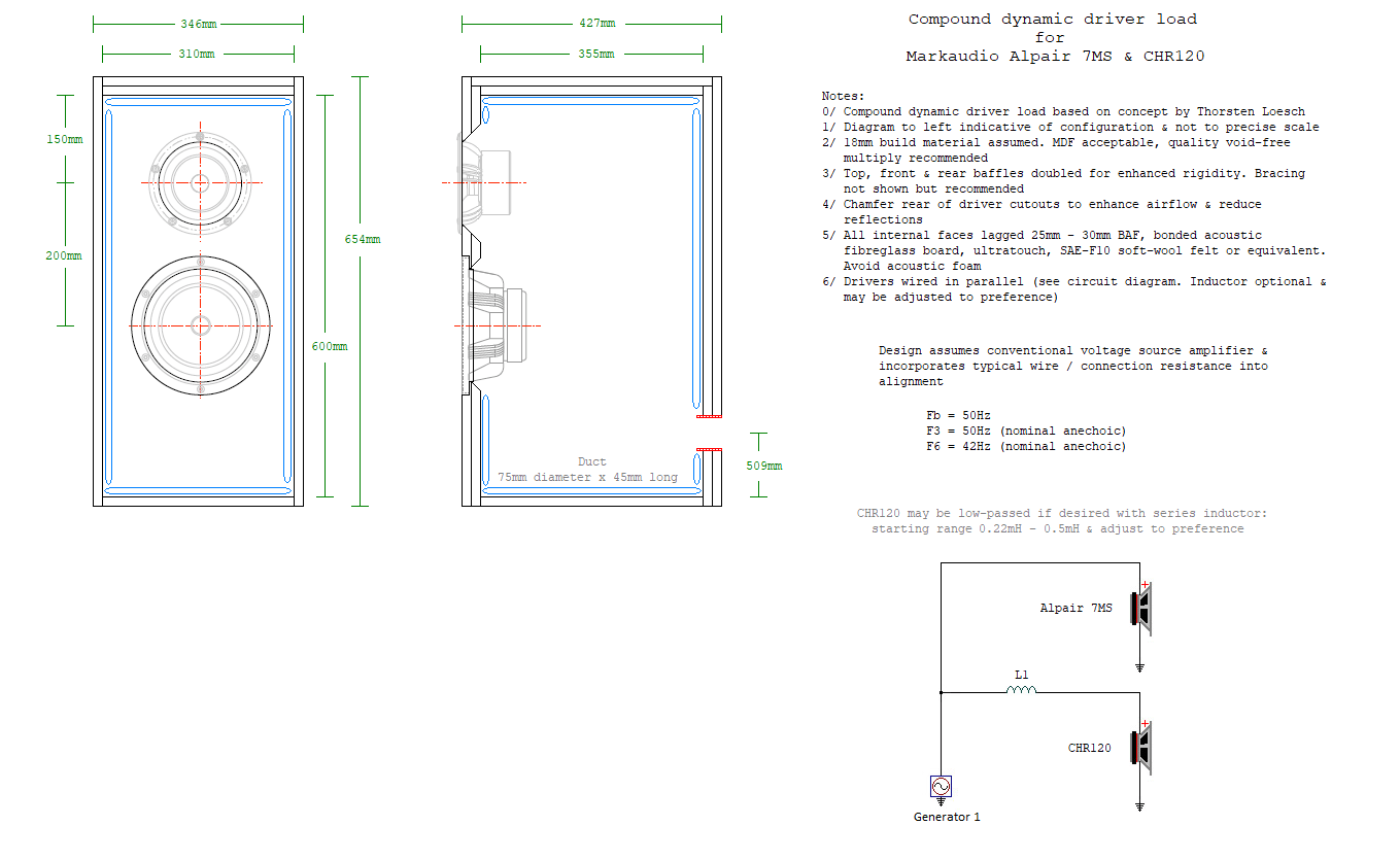

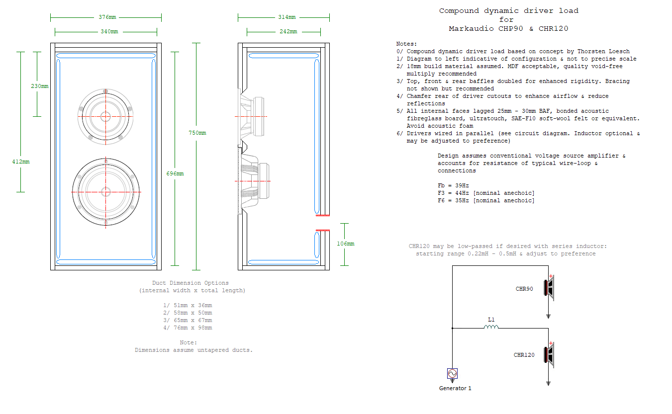

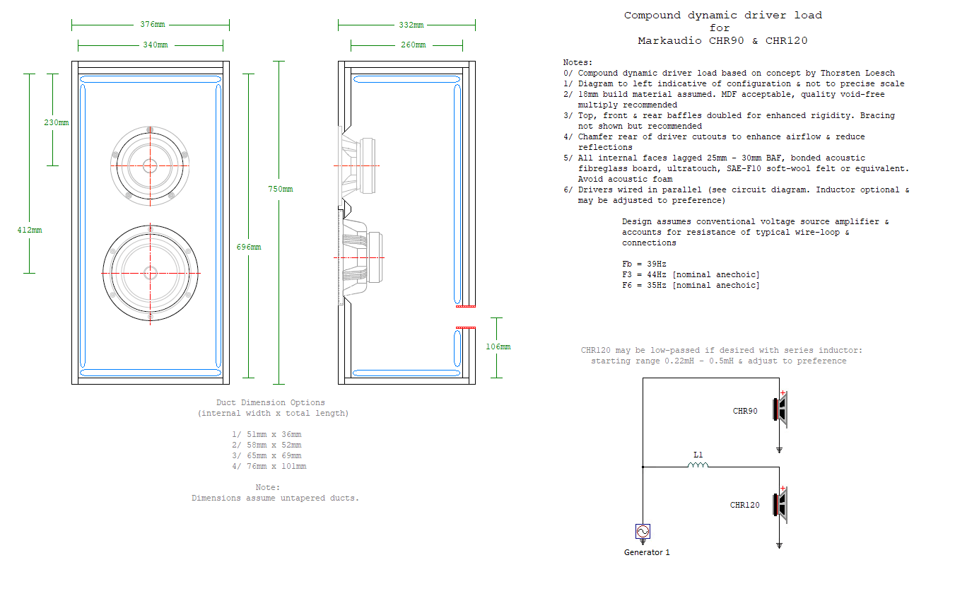

Relative levels on the MS version are a little skewed with a nominal bias toward the LF; a different version of that in the works at present, but added here 'for experimental purposes', for anyone so-inclined.
Humour aside, these are tweaker's designs really; ideally, since these are in the '70s retro dimension theme, you'll likely want them on an equivalent relatively low-level stand, and with a modest degree of tilt-back to help align the coils at the listening position -remember, we're dealing with widebands, with no, or slight filtering rather than a conventional multiway, so some individual adjustment is expected.

It may be found a bit 'biased toward the low end' -not massively if used away from boundaries, but within the context of what it is, it's aimed that way as the 7MS is fairly gentle at the top end & the relative sensitivities work out like that. But plenty of room for people to play as they see fit -these are for people who like experimenting.
Reactions: LeifB60
Well, the compound 11MS/7MS box does an easy 50Hz - high-40s; I could have got more but I wanted to limit the box size to keep dynamic range reasonable, so we're on a vintage alignment here to help load the drivers. As for alignments, assuming vented, a conventional voltage source amplifier & the usual 1/2 ohm of series R for wire loop, connections etc., then they individually work well in similar volumes by virtue of the elevated Q on the 7MS, though the 11 is a bit better in a slightly larger box, tuned slightly lower. At least, that's how I do it, since as far as vented boxes go I'd usually aim to limit Vb for the 7MS solo given its size and mono suspension. Plenty of room for variations there though, proscriptive this ain't. 😉
Reactions: LeifB60

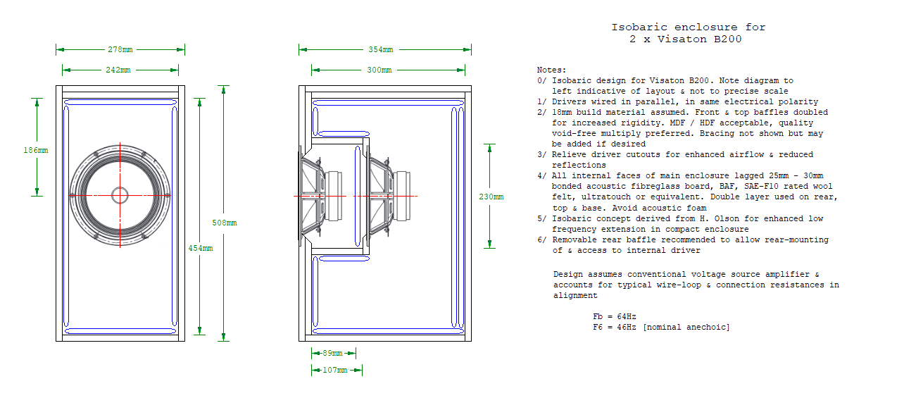

Well, it had to be done (possibly).
Not often done with widebands (obviously) but with the rear unit firing into the magnet of the forward through a hanging layer of damping, the HF should be killed quite effectively. Impedance is a bit low, but this is also assuming the usual 1/2ohm series R for typical wire-loop, connections etc. which should prop it up to my nominal '3ohm minimum' & over a lot of the band it will be higher anyway. Apologies as ever for the tragic sketch, but I can't foist off everything on Dave. 😉
