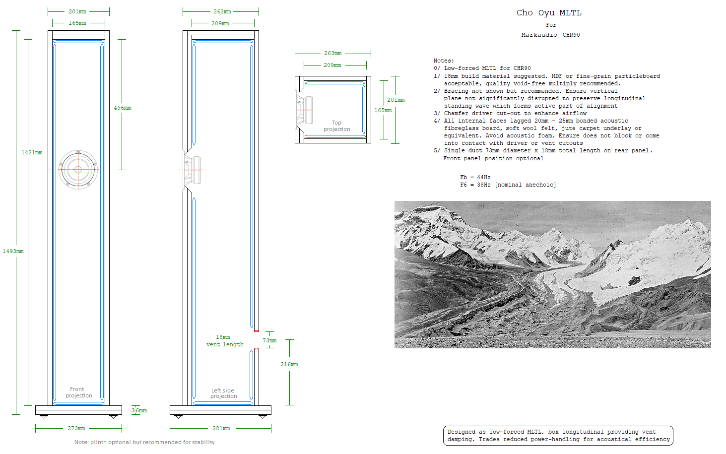

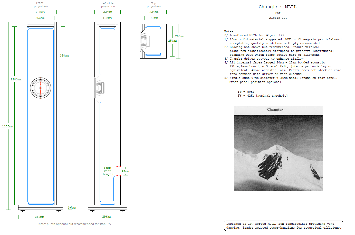

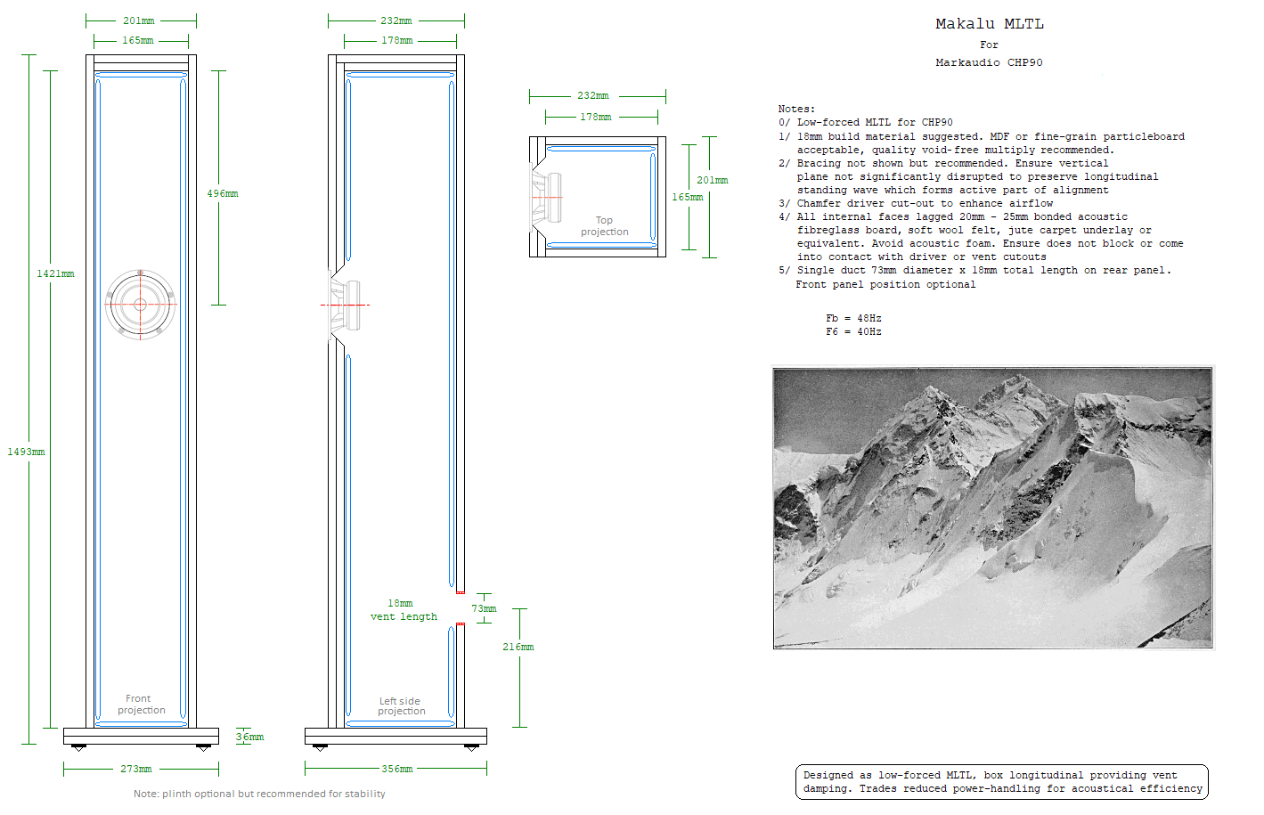

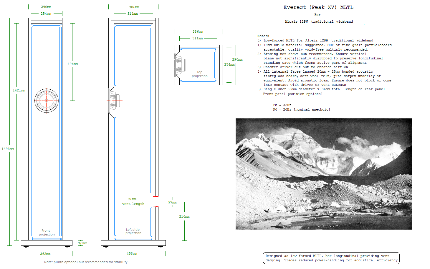

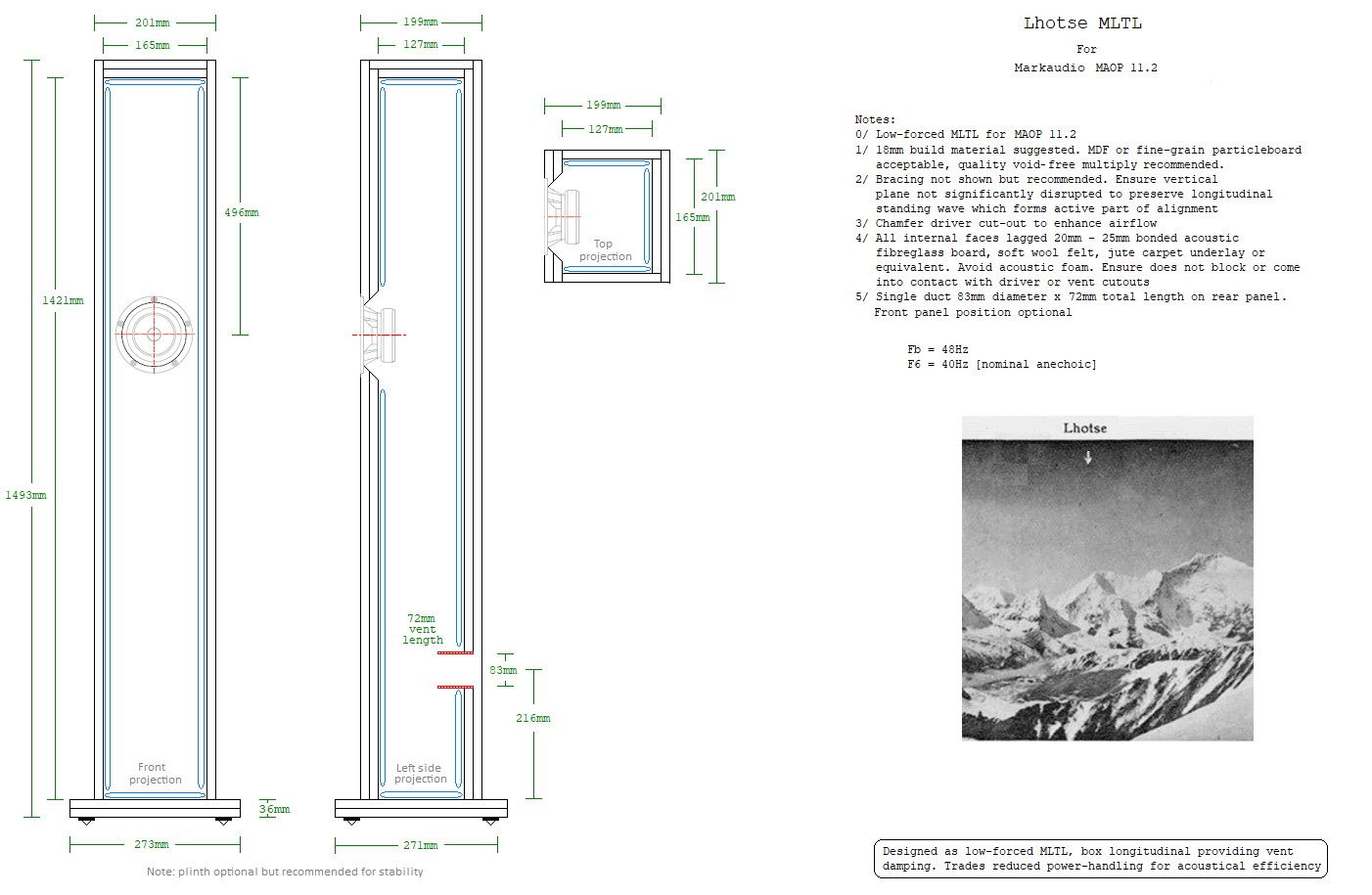

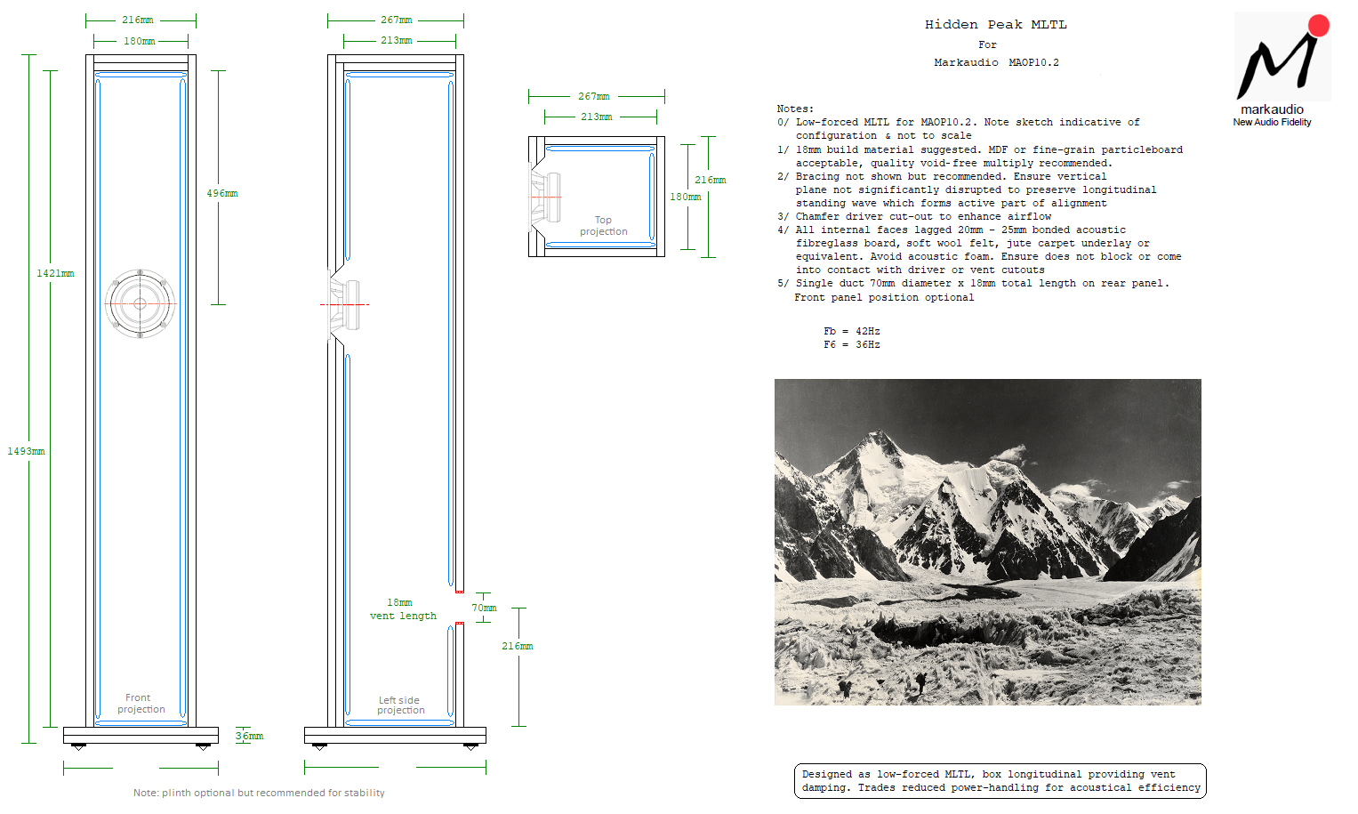

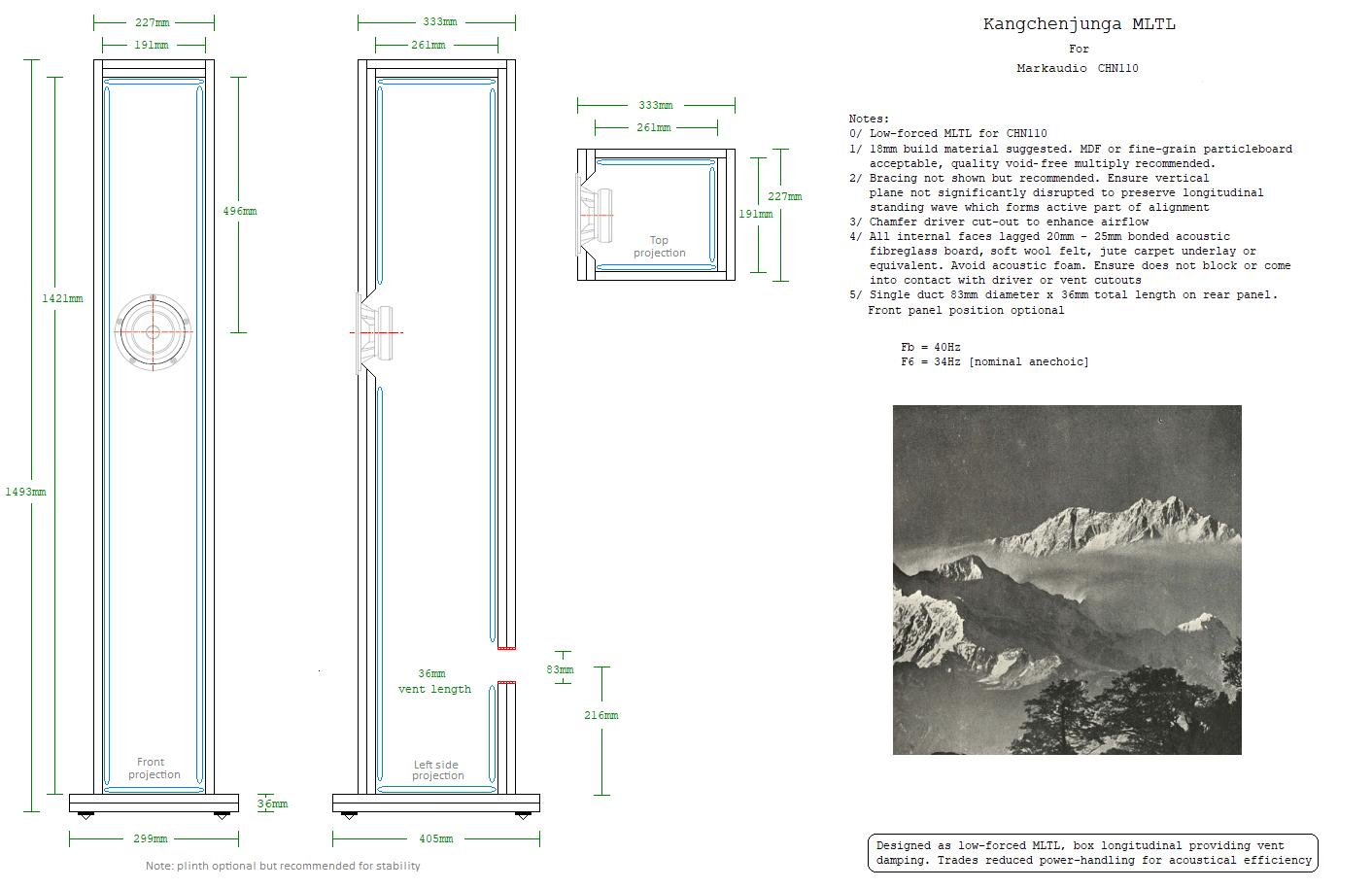

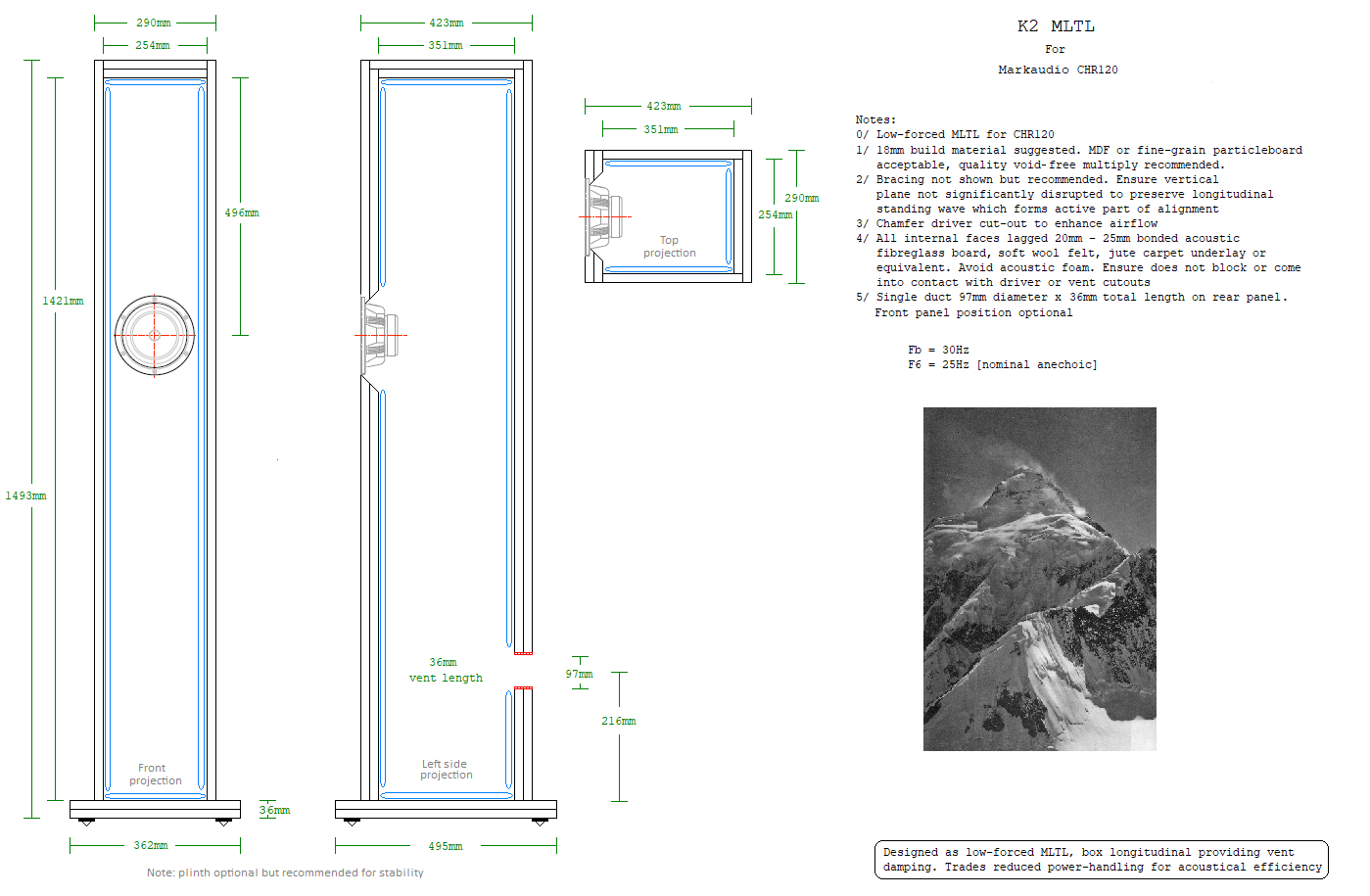

They're on the MA site, but might as well add them here as they're done for this purpose: Himalaya series of (relatively) tall MLTLs. These are low[er] forced designs using more of the longitudinal for vent-damping & trade outright power-handling for an acoustically efficient load.

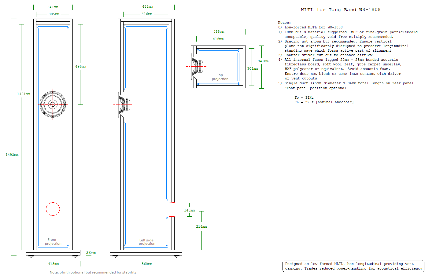

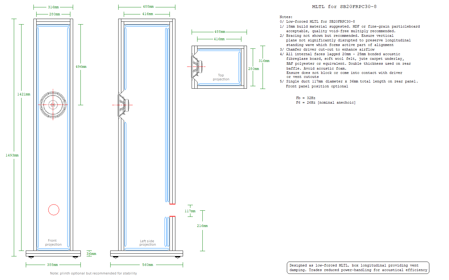

Two more, of a similar type to the above, for the SB20FRPC30-8 (love the nomenclature
) and Tang Band W8-1808. In answer to any queries, see the attached. ![rolllaugh :rofl: :rofl:](https://files.diyaudio.com/forums/images/smilies/rolllaugh.gif)

I suppose I should add re the Himalaya series: there's one there (Lhotse) that's for the MAOP11.2. As a short explanatory piece to save time in future, this was creating using a 'generic' data set since all MAOP units are individually pair-matched and have slightly different values, so there will be a minor amount of variation, but 'near enough' in the same way any other should be. Until recently I've deliberately avoided doing much for the MAOP series purely because of their semi-custom nature, but there have been so many requests (and since amplifier output impedance &c. alter things somewhat anyway) -I take the hint.
So Lhotse's the first. There are a few more for each, but for another day.

Mr Scott u r a darling I have both these drivers thanks for sharingTwo more, of a similar type to the above, for the SB20FRPC30-8 (love the nomenclature) and Tang Band W8-1808. In answer to any queries, see the attached.
