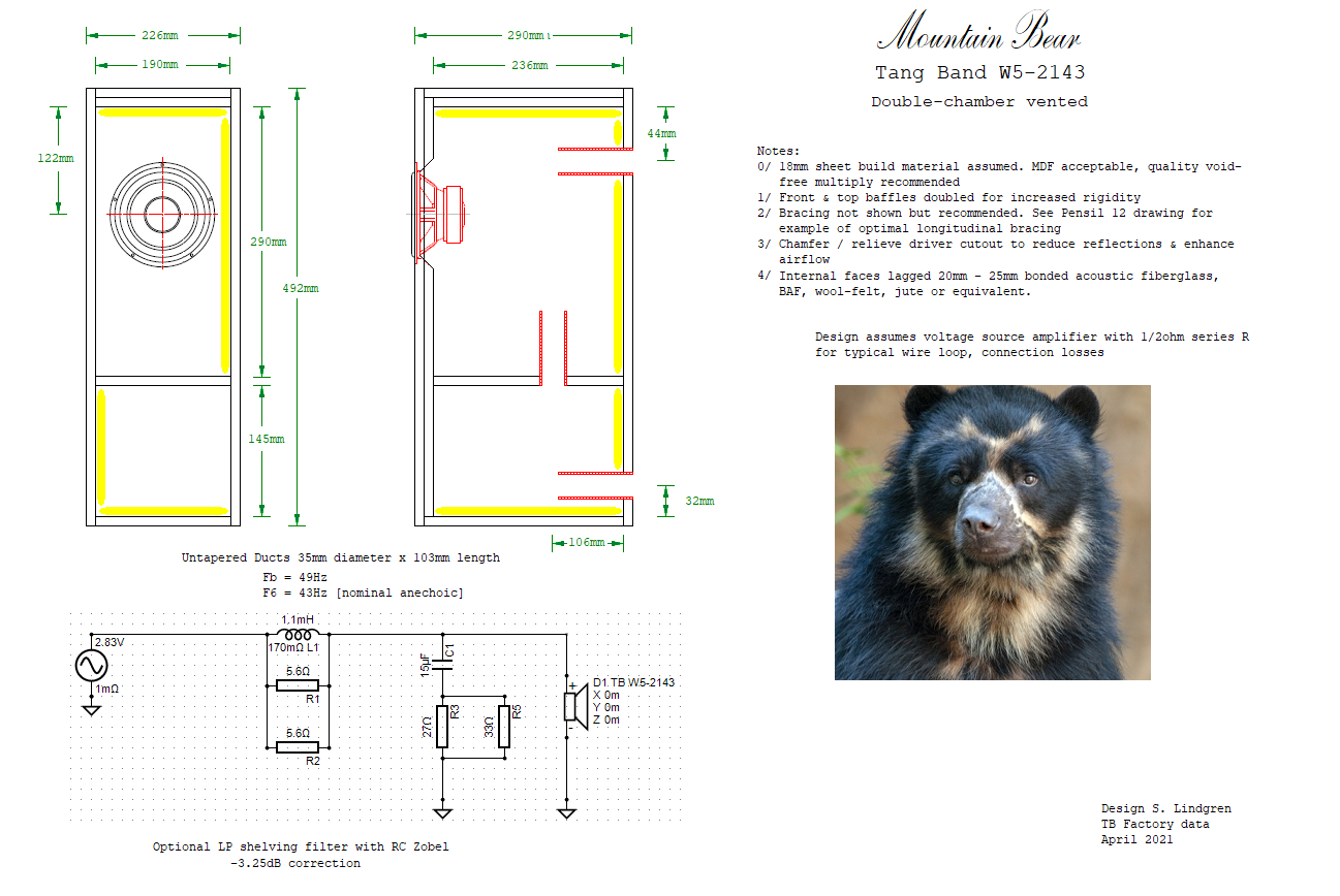

This is for Scott or someone who is better at searching for his designs than I am.
So, I have been greatly enjoying listening to the Tang Band W5 1611 in Scott's Sun Bear design cabinet. This got me to wondering how the sound would compare to the very highly regarded TB W5 2143 driver. I have therefor decided to order a pair IF I can find a cabinet design by Scott of 20L or less that he feels would do them justice. I have found several possible designs but none by Scott however I suspect he has done one or more since this is a quite popular driver. I have built two of his designs and really would like to make this upcomming build the third. Can anyone help me out with this? Thanks!

Found it. Quickly tweaked the sketch a bit. Filter is optional, roughly -3.25dB shelving as given some of the measurements I'm a bit wary about its tonal balance as-is / sans correction in a smaller box.
Many, many thanks Scott. I have never built a double chamber speaker so this will be a new adventure for me. The drivers are now ordered and I will start on the cabinets once the drivers arrive and are checked for functionality.
One question at this point. I have both 3/4 inch plywood and MDF on hand. Although it would probably be hard to quantify, based on your experience, how large a difference in sound quality would result from using the MDF? I too prefer plywood because it is more durable and much nicer to work with in the finishing stage. I have not, however, noticed any characteristic differences in sound between plywood and MDF cabinets. I would appreciate your thoughts as to why MDF is acceptable but not preferred. Baltic birch plywood has gotten so expensive I only want to use it if the changes in overall sound quality in this aplication are more than "quite subtle". I will be driving them with very good quality electronics if that is a factor.
Thanks again for your help. There is a great deal more to designing a top notch cabinet than sitting down with WinISD or Xbox and going for the lowest f3. Your expertiese is greatly appreciated.

FWIW, my general take is that for bass enclosures, if it's a choice of MDF or nothing at all, I'd take MDF as the preferred option any day. A compromise in materials is better than having no music, which I think we'd all accept is fair enough. However, a quality void-free multiply will generally result in less colouration for a given panel thickness, as would a high quality chipboard (particleboard), so if the choice is available, would be what I'd use.
