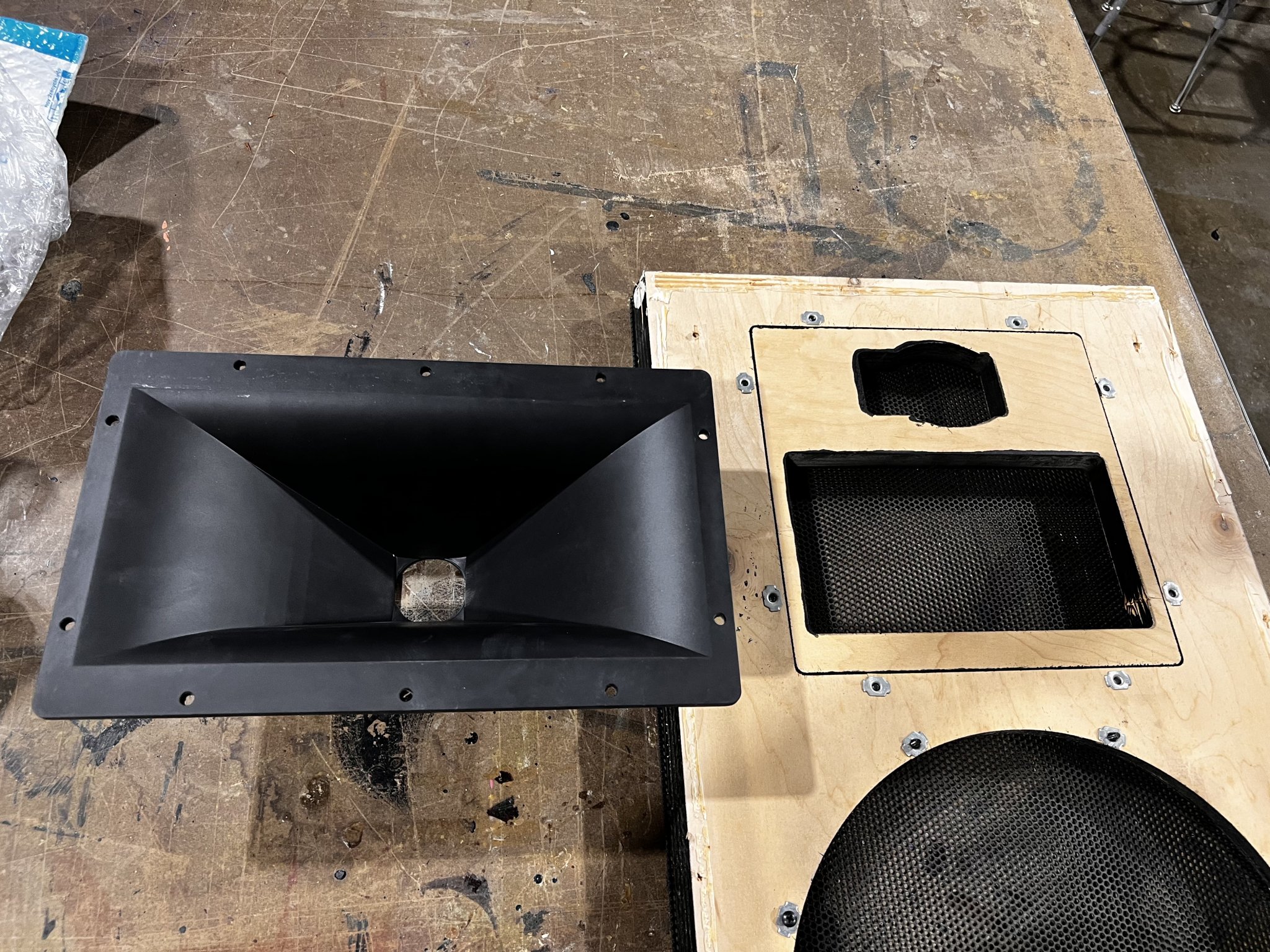

on Sunday, i drilled and installed the ports and terminals
And attached the backs to the cabinets
I also installed the K-701 horns and K-53 drivers

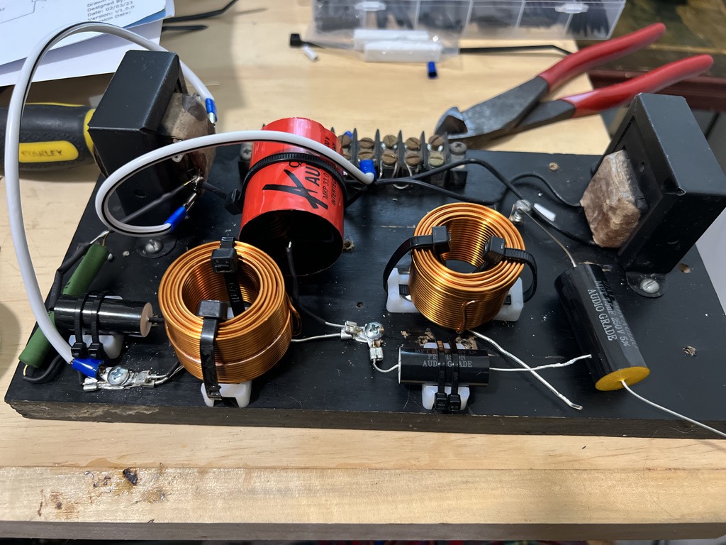

And cut new network boards out of some scrap mahogany planks I had in the shop. I gave them a few coats of grain filler; later this week, I’ll sand & seal them and hopefully on thanksgiving, solder up new networks and put everything together. The cabinets alone are as heavy as the H700’s are, completely assembled. This alone may be reason enough to upgrade them from 1.5 to 2.5 with a pair of Kappalite 3012’s.
I reconfigured the network and put it on a piece of scrap mahogany that I had in my shop.

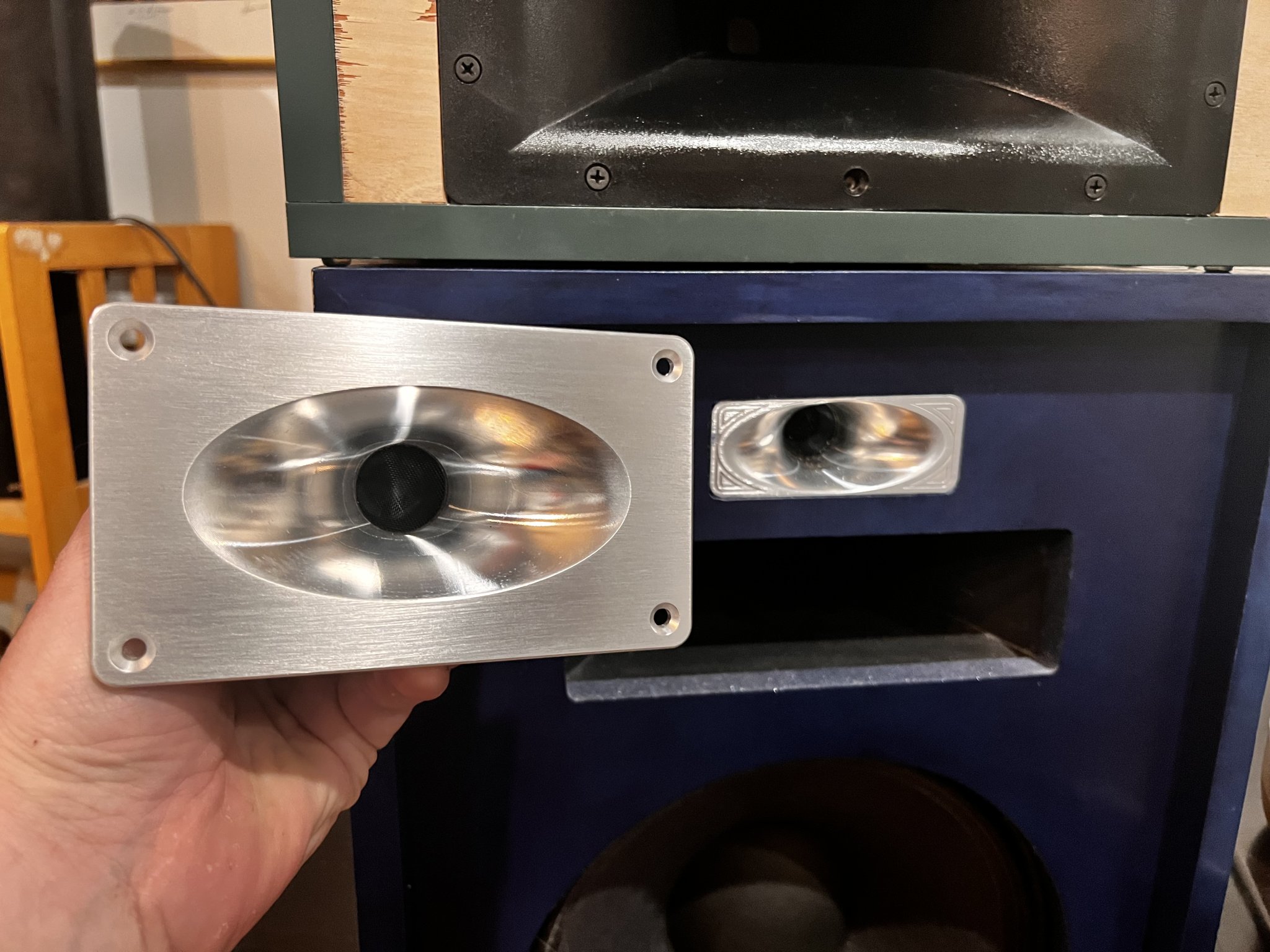

First impressions vs my Baby Cornwall 1.0: the damped k701 horn and K-53-K driver make this speaker more forward than the K700/K-55 combo. Staging & imaging is better; vocals and acoustic instruments sound really great. I spiked the cabs as well and had to turn my subwoofers down, as well as turn my power amp down from 90%, to 75%. the solution, per @claudej12000 was to drop the input capacitor value from 2µf, to 1µf and drop the squawker output in the autoformer. That did the trick!

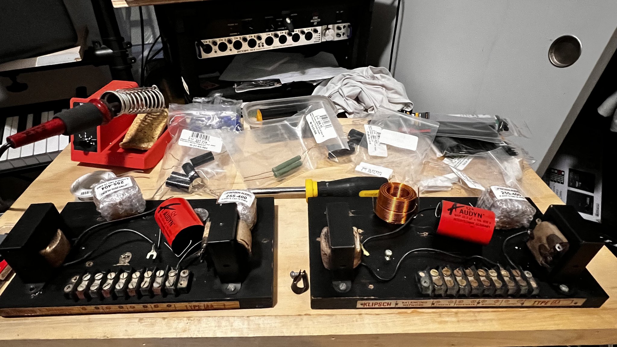

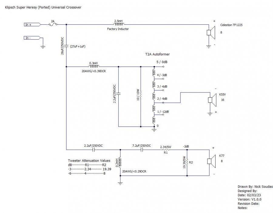

Still, this driver had 8 ohms of impedance, while the crossover network was designed for a 16Ω driver, which combined with a 2dB of gain from the horn, meant it was still a bit more forward. So, I used a variable L-Pad to better dial it in.
I also changed the capacitor value to allow the horn to pass from 600Hz and had managed to pick up a 2nd horn, PRV Driver and L-pad. The sound was remarkably better! Still, I kept hearing that to completely tame driver overlap and unleash the true potential of the speaker, I really needed to use a universal crossover network. Frankly, I found it hard to believe that the speakers could sound any better than they already did, but curiosity got the better of me, as it usually does. So, I found a schematic that was optimized for Super Heresy speakers, made an adjustment to drop the mid values and put together an order from Parts Express.

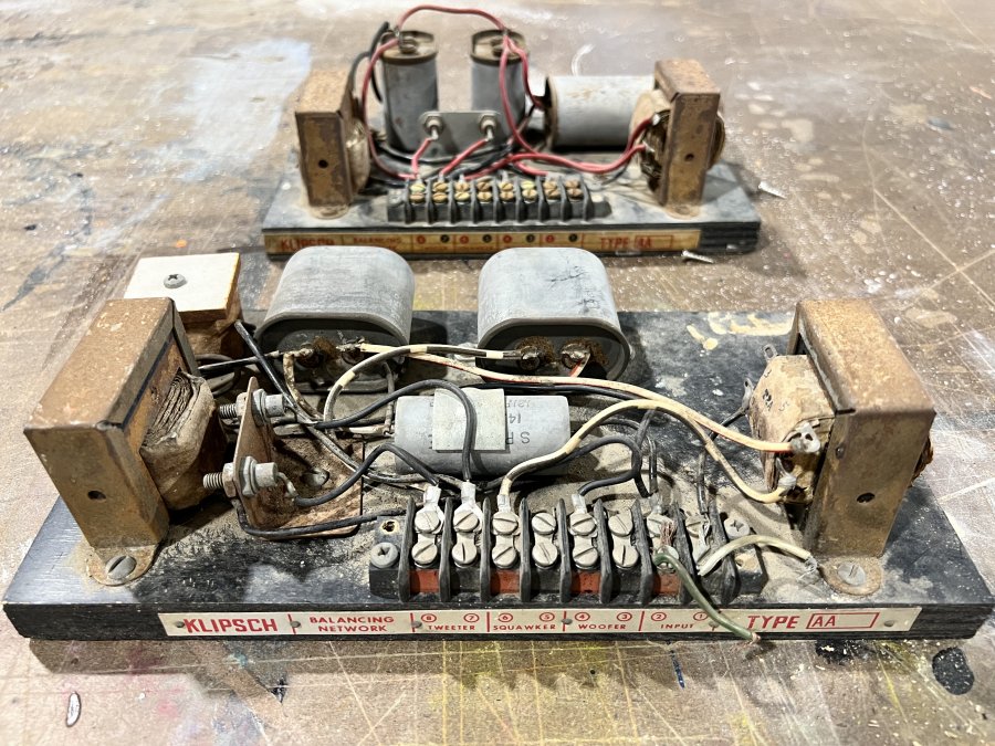

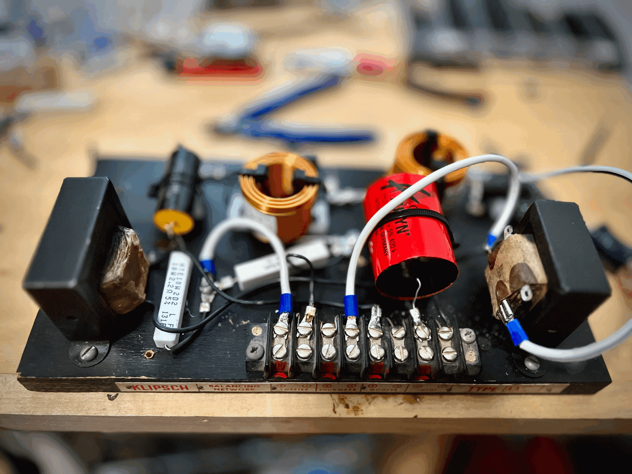

I also picked up another set of networks to build from, rather than cannibalize the ones I had, in case I didn't like it. I found these Klipsch AA networks for $55, but they needed a little work:
after a little cleaning, some sanding and paint, they'll do:

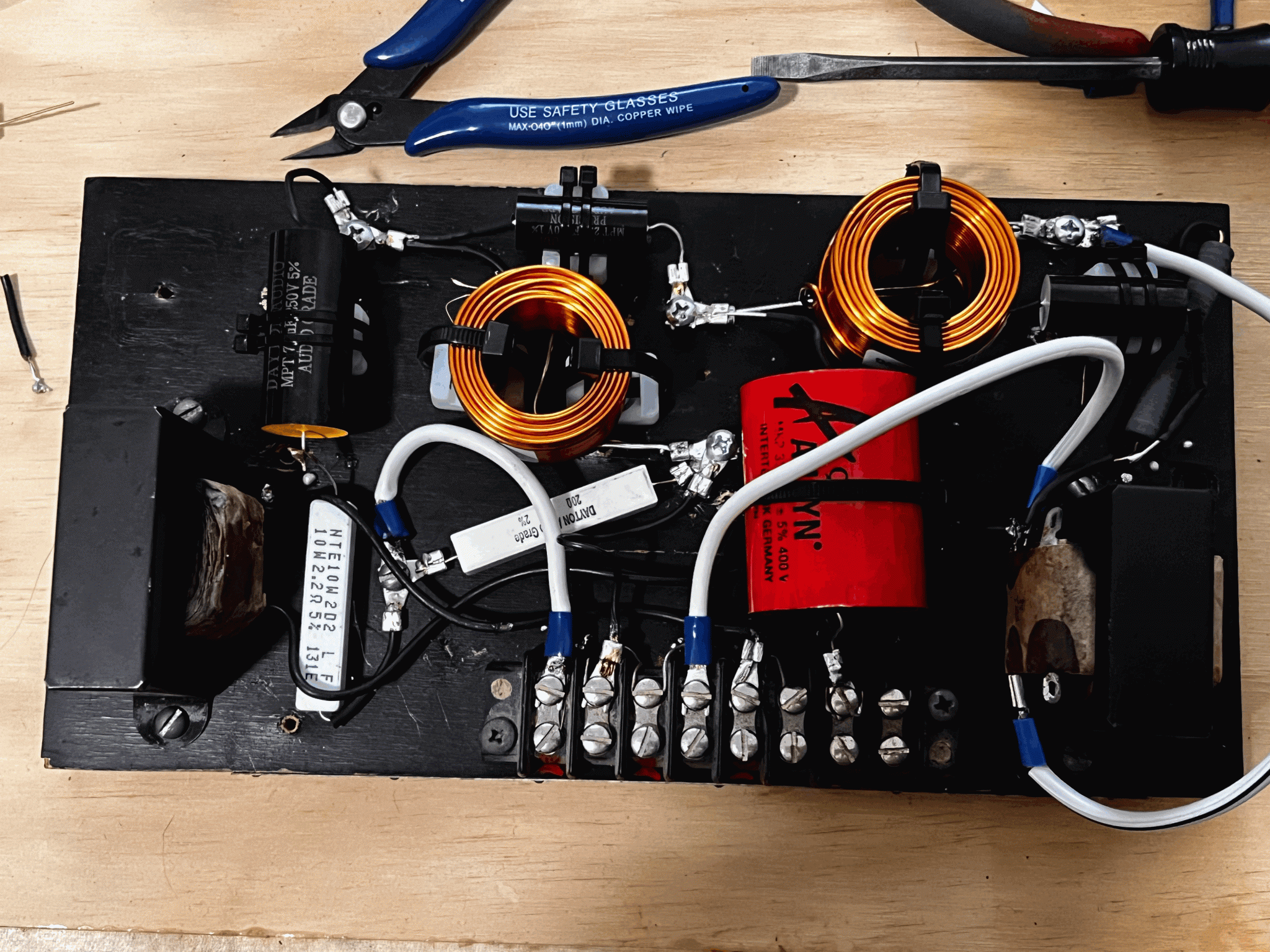

The universal network is an order of magnitude more complex than the modified Type E crossovers I've built previously. I used spade terminals and screws for most of the connections, in case I needed to make changes or inadvertently screwed something up.
First impressions: Amazingly, it works! The differences are pretty subtle, in the left channel, where the universal network is, there seems to be a little more clarity and definition between instruments and voices, whereas the E/B network on the right channel seems a little more blurred, something I hadn’t noticed previously. My partner says it sounds “richer.” With the universal installed in the 2nd speaker, the difference does from "subtle" to extremely obvious; it's a significant improvement. More clarity, separation and better staging; they’re simply incredible sounding!

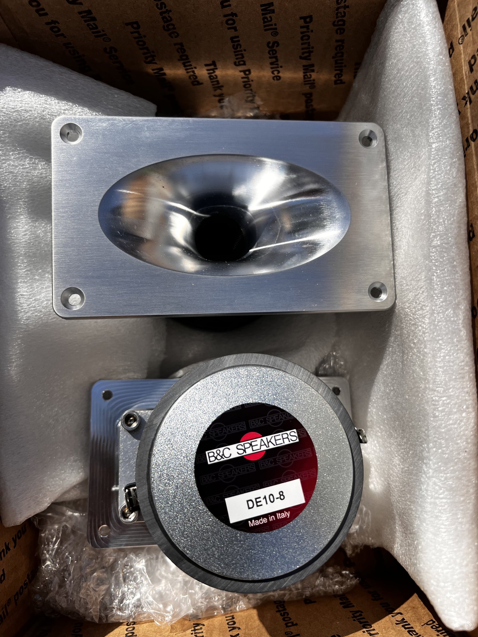

one last thing t address: Appearance. The K604s in a separate enclosure is clunky, at best. It did have better WAF compared to the bare horn, but it's awkward and the K701 in the original enclosure is disconnected and redundant. To mount them in the cabinet, I'd have to lose the tweeter. My initial tests indicated that the K604 with pro drivers work ok in a two-way system, but anyone who's heard a MAHL will tell you, they're more than mere tweeters- Amazingly, they have incredible high end extension and will go all of the way up to 20kHz, beyond the limits of most human hearing. After a lifetime spent around loud things: growing up on a farm, serving in the US Army in an 8" Howitzer battalion, playing in bands through my 20's, racing motorcycles in my 30's and 40's and working as a carpenter for the better part of 30 years, my hearing is a little worse for the wear, topping out with a mass roll-off at 9750 Hz. Yet, the MAHL improves the sound, even though I can't hear the higher end of its range, highlighting transients all of the way down to the bass frequencies. Doing without is a non-starter.
so, the next step will be getting a pair of free-standing MAHLs from Dave Ault, similar to these, but in Maple:
These have the added benefit of improved time alignment, too. Then, i'll disassemble the cabinets and mount the K-604's in place of the existing tweeters and squawkers. I'll also reveneer the boxes, as they have some flaws that I'm less than happy with. I'm also considering a few more mods while I have them in the shop, but I'll save them for later.

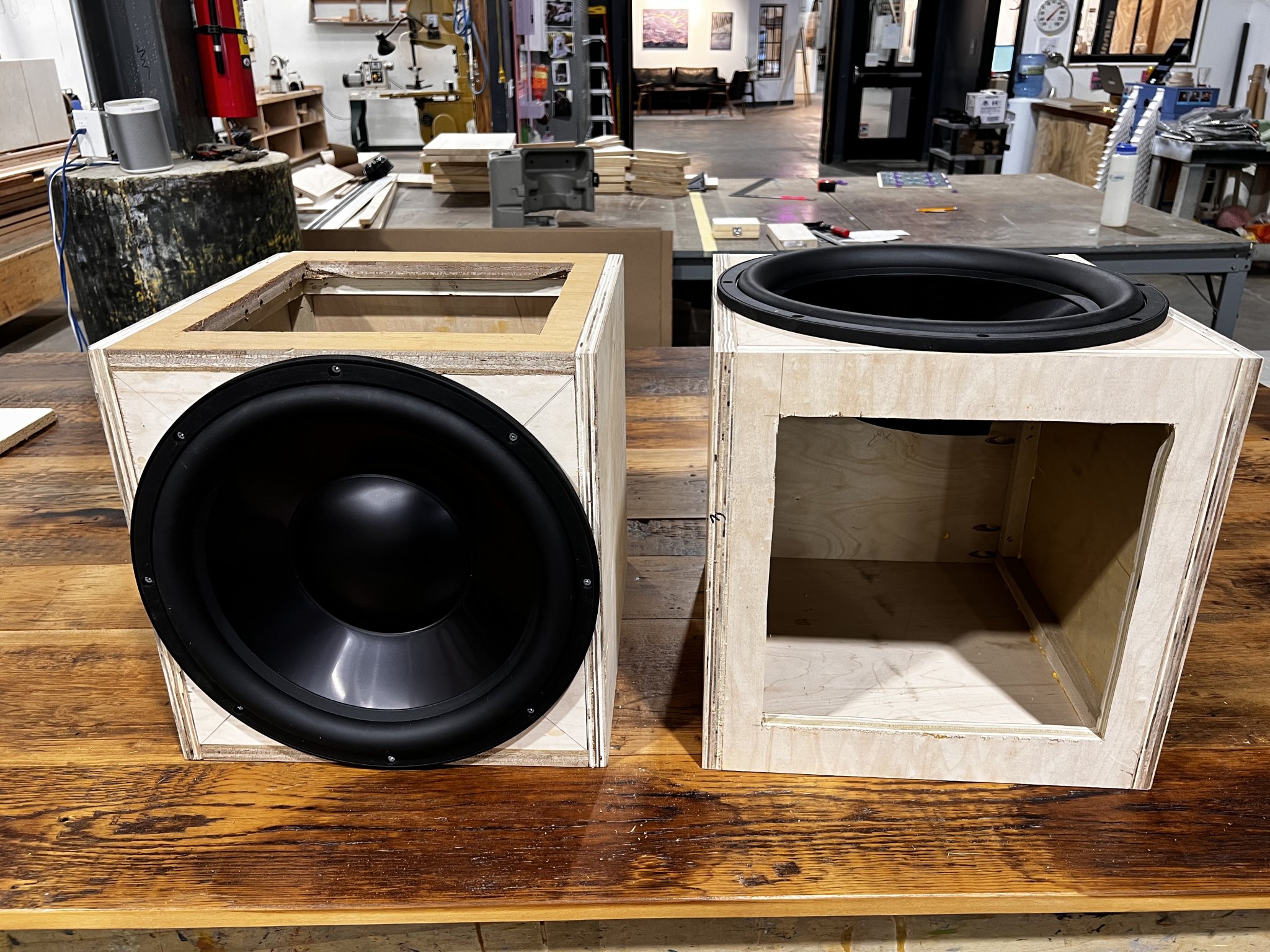

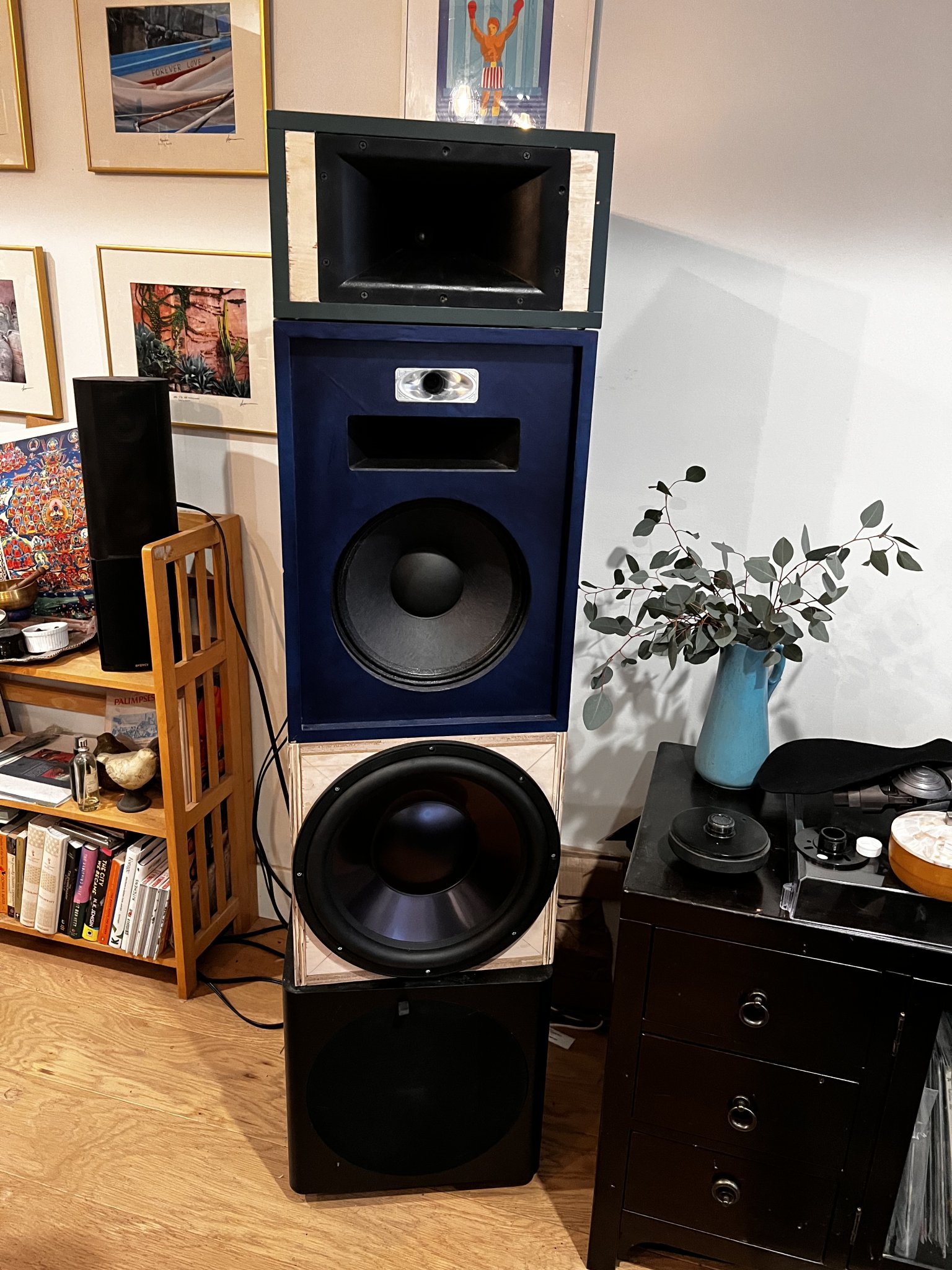

sooo... since I last posted, there have been a few changes. In the quest for even better low end response, I had an idea: why not a bass extension cabinet with a passive radiator? I got out my tape measure and calculator and did some crunching: I found that a 15.5" x 15.5" x15.5" enclosure attached to the bottom of my heresy clone cabinet would give the same displacement as a Forte and moreover, a 15" radiator would just fit. better yet, I found a pair of Dayton Audio 15" radiators on open box closeout... Game on!
I got to work in my shop and made a pair of boxes- since this was purely an experiment, I used scrap 3/4 ply that I had in my studio and aesthetics were a secondary concern- first and foremost, I wanted to see whether it worked.
with the boxes thrown together, I brought them home to test how they'd match up- Here they are atop my Heresy clones, with the passive in front for emphasis:

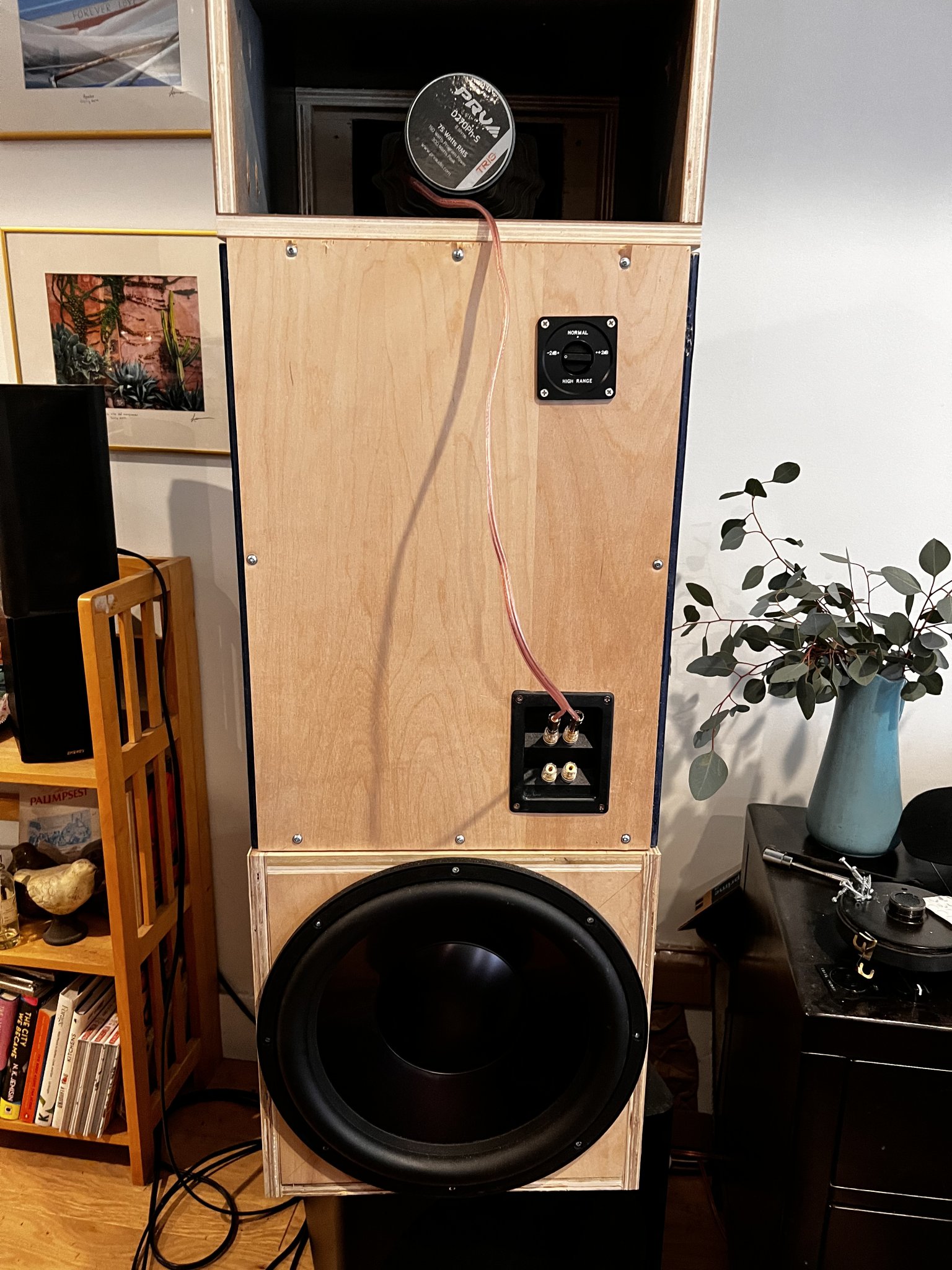

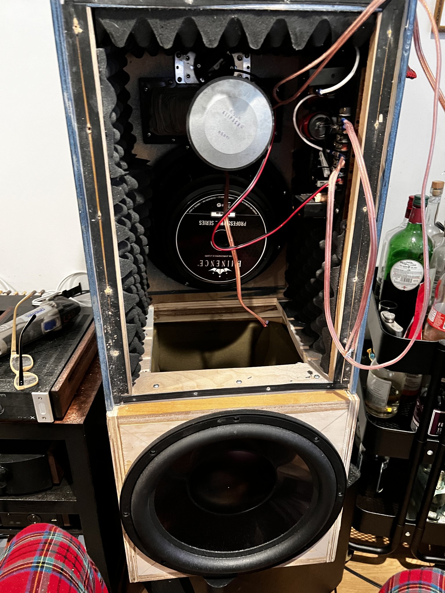

next comes the scary part: cutting holes in the bottom of perfectly functioning speakers and putting them togethe; there's no turning back nowr:
next, I installed foam in the bass bins, aligned the boxes and screwed them together:
the last step was to vacuum the sawdust, connect the drivers and install a sealed back on the original cabinet. Since I wasn't sure if I was ready to truly commit to the mods (yes, the holes in the bottom of the box are drastic, but reversible) I used a bi-ampable terminal, removed the jumpers and connected the mid extension horns to the top pair of terminals:

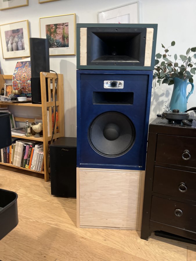

Here we have the final result. Admittedly, it's a bit crude and clunky, but the sound was remarkably good right off the bat, even though the passive definitely needs to break-in:

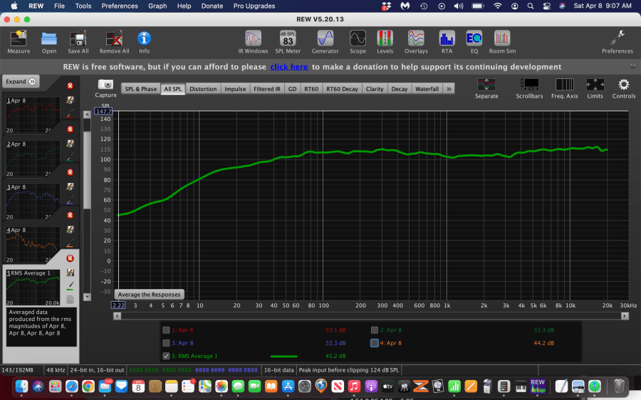

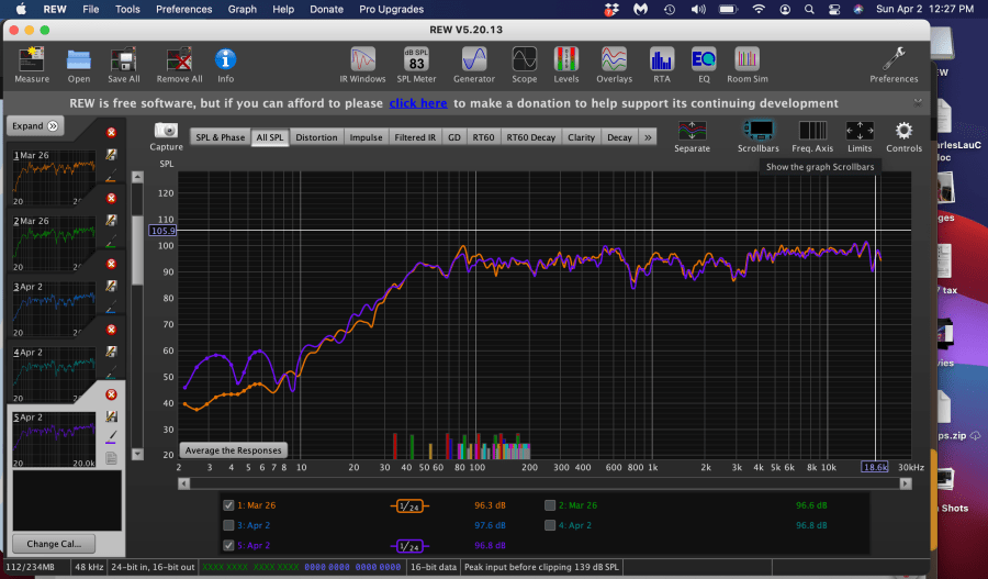

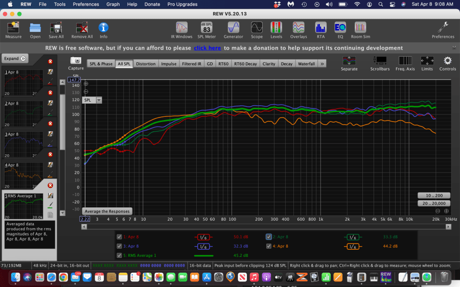

I could type all day about the sound, but words are meaningless without measurement data to back it up. My first few passes with REW were promising, taken with the mic set .8 meters from the floor and a meter away from the speaker. however, with bass starting to roll off in the mid 40's and -3dB at approximately 42-43 Hz, I feel that the graphs don't entirely represent what my ears were telling me.
with that in mind, I gave the speakers another week of playing, about 20 hours, thirty total, to let the passive break-in a little better. I then took measurements of the individual drivers with the mic at 30 cm from the drivers. In the graph below, the sMAHL tweeter is in dark green, the mid horn is in red, the woofer is in purple, while the passive is in orange; the averaged curve of all of the drivers is in orange:
while still not anywhere near as accurate as measurements taken an anechoic chamber, accounting for room gain, this represents a much clearer picture of what my ears are telling me. Here is the averaged curve in isolation:
Ultimately, I've found this to be a very worthwhile experiment and it has exceeded my expectations for both SQ and low end response. My conclusion: If you have a pair of vintage Klipsch Heresies or a pair of clones and find the tone to be lacking, you should absolutely do Claude's Super Heresy mods; dollar for dollar, the Super Heresy is one of the best bangs for the buck in all of audio. You can take a pair of 45 year-old speakers that were until recently, selling for $500 a pair and add $700-$1200 worth of ports, woofers and tweeters, depending on your selection, and make a speaker that will easily go toe to toe with brand K's latest and greatest, $3200 Heresy IV. Really, doing this is a no brainer. If you want still more bass, adding bass extension cabinets, as I've done, will get you there and bigger squawkers with good drivers will easily get you into Forte II territory, if not better.
As to the elephant in the room, yes, they're hideous looking. If I were a 20 something bachelor, I could live with the lack of aesthetics and simply wallow and revel in the glorious sound. As a grown-*** man who also has to contend with a reasonable modicum of WAF, the glorious sound deserves a better enclosure. With that in mind and goaded on by the enabling mentorship of @claudej12000 and Dave Ault, I'm not only not leave well enough alone, but take things a step or three further, because isn't that what we do? So, new cabinets are in order, with veneered baltic birch construction and at this point, I'm considering using 5/4" thick, solid wood motor boards, in either walnut or mahogany. While I could do a straight replica of the Forte with better parts, that doesn't seem very sporting, so we'll make the boxes bigger, for even deeper bass response. we'll also add bigger horns, because more bigger is more better-er!

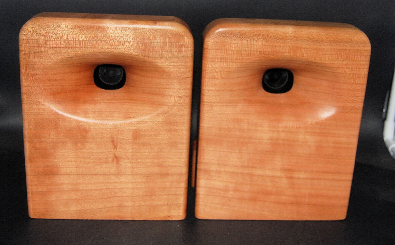

to start, I've picked up a pair of L-MAHLS from machinedaudiohornlens.com -the L-MAHLs take everything that's great about their sMAHL siblings and improve on it with a larger machined alloy horn lens, driven by a pair of B&C DE-10s that are said to measure and sound even better than the sMAHL's neodymium, mylar diaphragm-ed B&C DE120 drivers.
