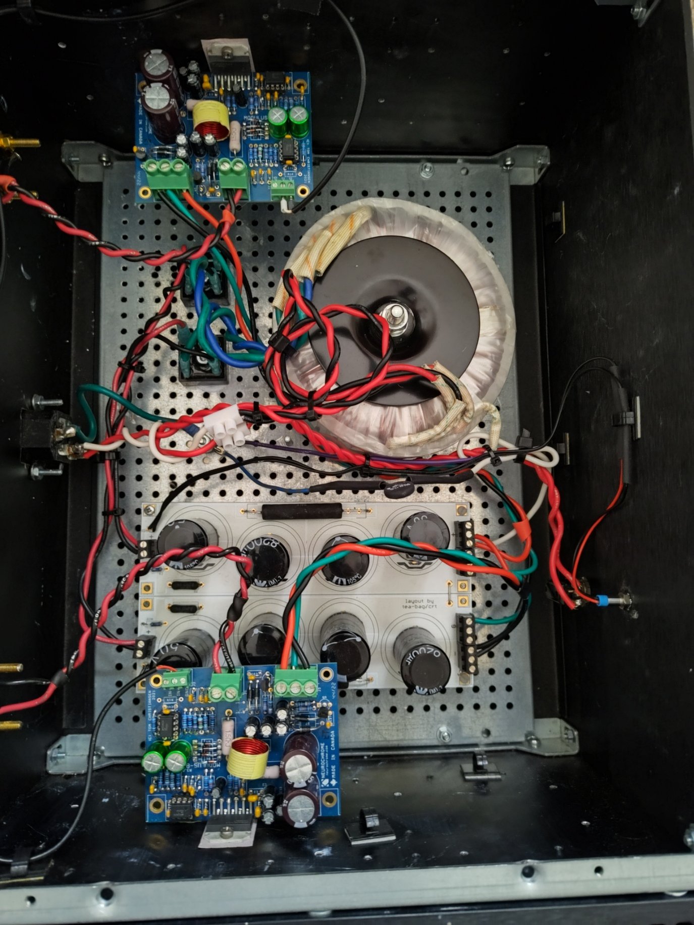

Another pair of Modulus-86s are alive! No pictures yet as it is just roughed in my old F5 case for testing.
My initial assessment is that I can finally understand why so many builds here involve expensive cases and speaker protection circuits. This is a quality amp.
I had been a bit worried about the output power, because one of my other amps (60W) sounds strained and loses a lot of clarity when I turn the music up. This one does not and I'm currently only running it on 24V rails.

Not a bad temporary home. Even though it's only temporary I would still do something to brace at least the front edge of the board. I often use some long standoffs, screws, or threaded rod for this. Just 'tune' it to the right length. All you need is something to fight gravity so the chip doesn't do all the work. Of course, once yo find a permanent home you'll secure the boards by all corners.

After several 16 hour days, I have to say I'm impressed. I was worried it might sound harsh but it just sounds like the music. With my last couple SS amps I used a preamp that had a bass boost option that would lift up everything below 500hz and with this I don't need that. There is nothing lacking from the bottom to the top in the music. Even running it at 24V I don't run out of power. I have fallen asleep listening to it fairly loudly a couple of times and to me, that is a good sign.

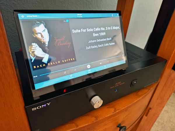

I think the 2U chassis has a nice modern, high end look to it.invaderzim,
My Modulus-86 is also running from a +/- 25V SMPS. Have mine in a 2U chassis.
