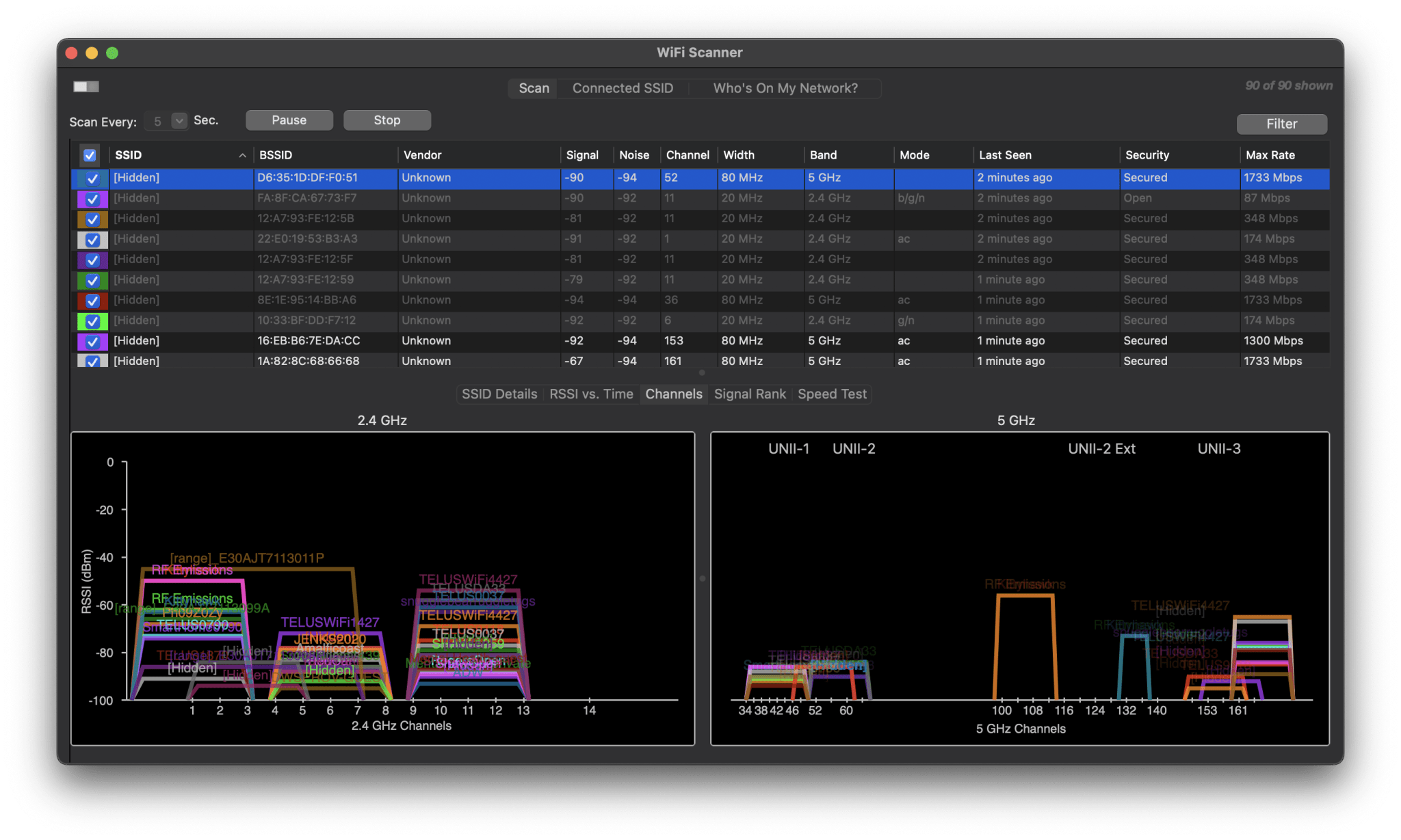

Also keep in mind that 50/60 Hz hum may not be from the mains. I've been poking around in the lab lately and on occasion I'll get some 25 Hz and harmonics showing up, which is remarkable given that I'm on 60 Hz mains. It wouldn't surprise me one bit if that's related to wifi SSID broadcasts. The wifi bands are crowded here to say the least. #innerCityLiving.
The 25 Hz and harmonics I see are maybe 10 dB above the noise floor on the APx555, so it's not like this has any real consequences except it doesn't look pretty in the plot. Part of the reason for this is also that I have the circuit sitting 'naked' on the lab bench. Once it's in a metal chassis the RF will be shunted to ground (and attenuated heavily by the chassis).

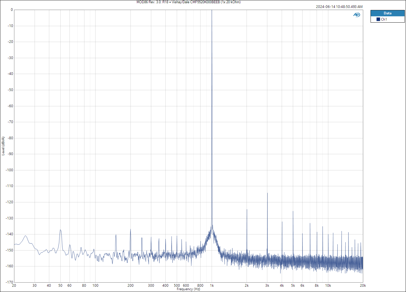

The Dale RN55 "military grade" metal film resistors get a fair amount of press here. The "civilian grade" CMF55 is identical to the RN55 and I decided to give that a whirl. After all, the CMF55 has a pretty detailed spec sheet and seems like an overall good product. I decided to compare it against a TE YR1B-series resistor of the same resistance. The YR1B is roughly half the cost of the CMF55. Both resistors were 20 kΩ, ±0.1 % tolerance.
Here's an FFT of 50 W into 8 Ω at 1 kHz with the TE YR1B-series resistor.
And here is the same measurement with the Vishay/Dale CMF55 (= RN55) resistor:
Seems pretty obvious that the extra money doesn't buy you better performance.
These results are repeatable, by the way. I tried various combinations of resistors. The result is the same: The CMF55 is about 10 dB worse than the plain vanilla TE YR1B.

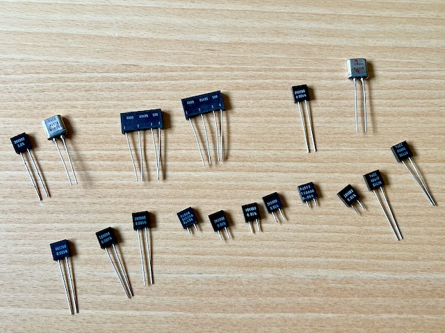

A few years back a friend of mine sent me these:
Wouldn't you know it? They're all from TxCC (Texas Components Corporation). Some have incredibly tight tolerances (±0.001 %). Not that the absolute tolerance matters much for the MOD86, but it does indicate that these are pretty fancy resistors (as does the HC-49 package). There's a 20 kΩ and two 10 kΩ in the mix, so I can test with those.
Now, I don't know if these qualify as "naked". If you still see value in measuring the performance with a current generation TxCC Naked Foil resistor, toss me a PM and we can exchange address info. I'm happy to ship the resistors to you after testing if you would like as I won't have much use for them after.

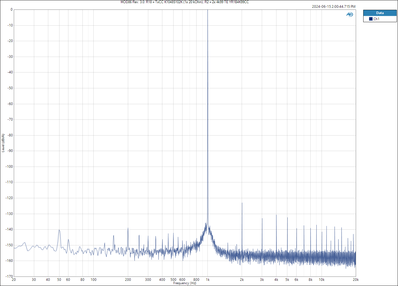

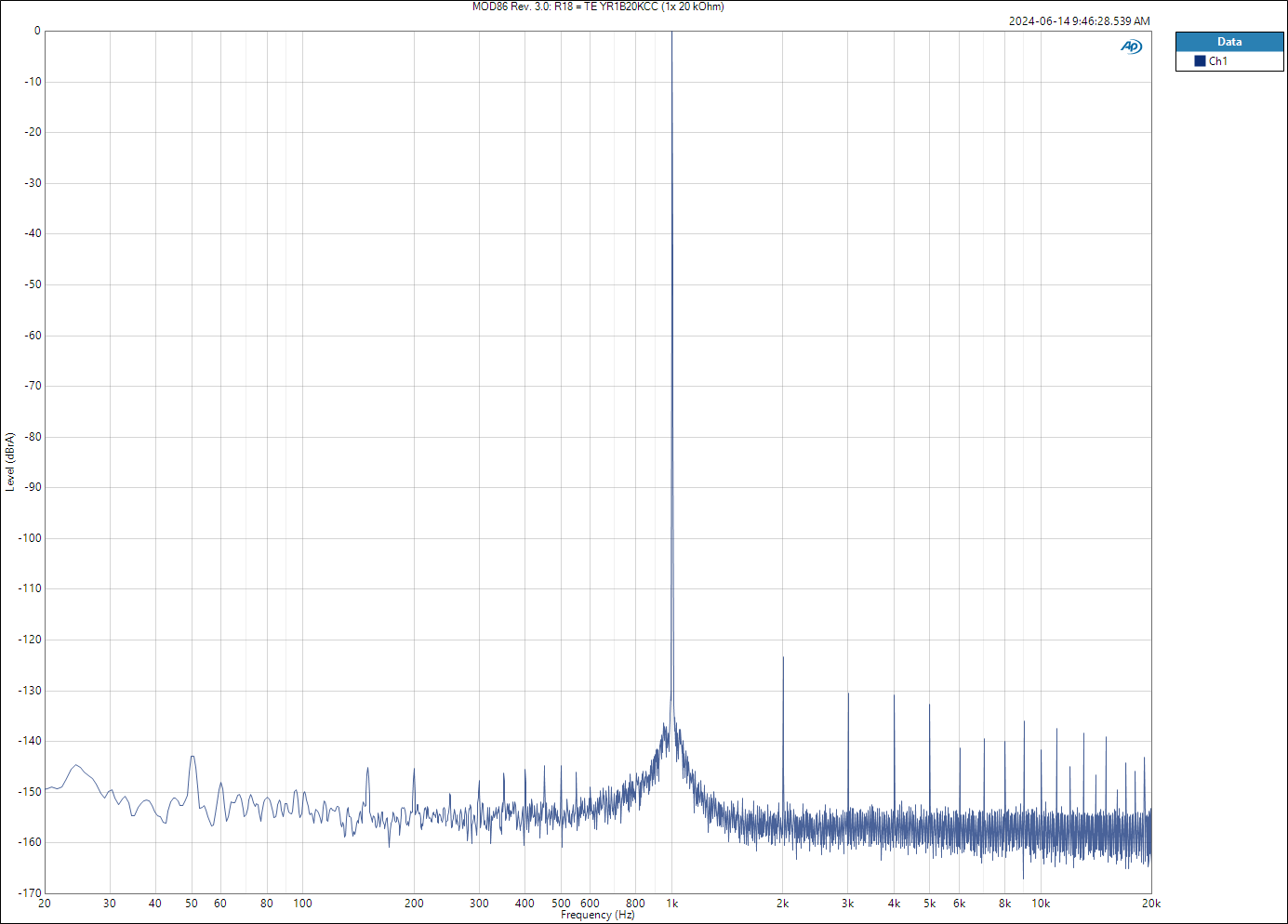

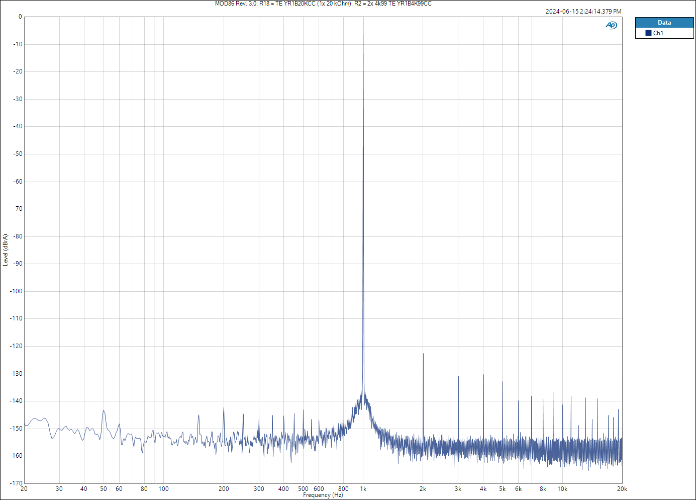

More measurements. Note that I've also now swapped the local feedback resistor around the LM3886. That's R2. It's 10 kΩ and I swapped it for 2x 4.99kOhm to see if it would make any difference. It didn't.
Here are the measurements with the fancy TxCC resistors. I had two 20 kΩ resistors. One with ±0.01% tolerance (boo!) and one with ±0.001% tolerance (yay!) in an HC-49 package (extra fancy!).
But the reference plot with $0.44/each (QTY 1) TE YR1B20KCC (20 kΩ, ±0.1 %, 15 ppm/ºC):
And the TxCC 20 kΩ ±0.01% (K1048S102K):
And the fanciest of them all, the TxCC 20 kΩ, ±0.001 %, K0624VHP202:
It looks like H3 is a smidge lower with the TxCC resistors but not dramatically so. The difference is 2.1 dB.
Tom
Tom
