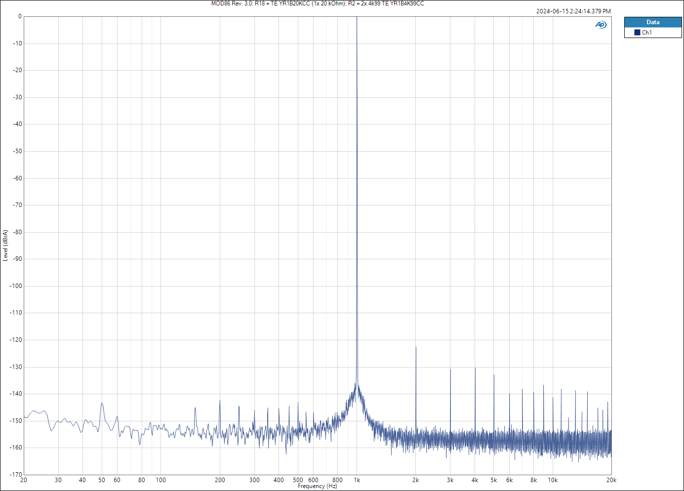

Without any questions the YR1B20KCC gives great results, but if anyone wants to try Dale Ptf56 1% 10ppm ( on sale for 0.25$/piece)

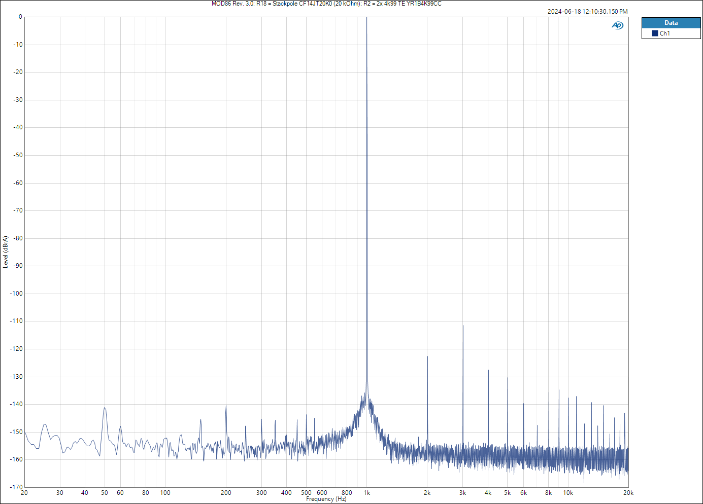

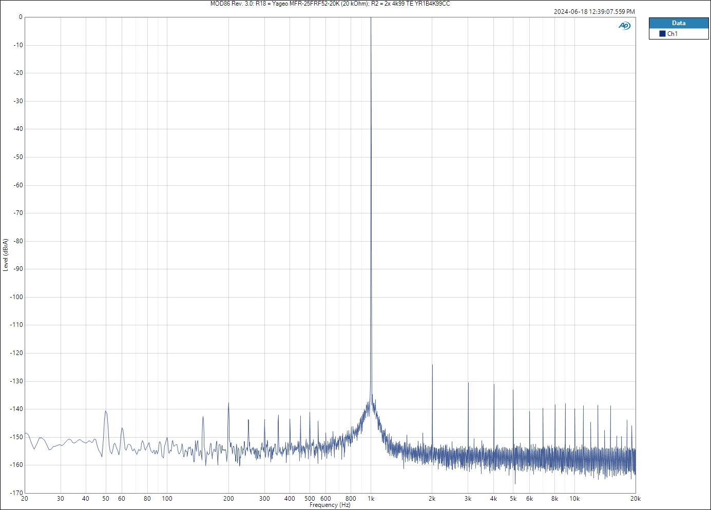

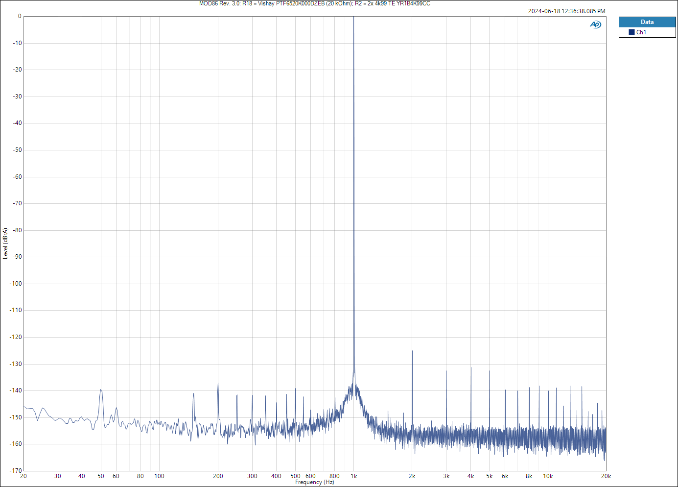

I just took delivery of about $200 worth of resistors, which is impressive given that the highest quantity of any individual part number was 10.
First, let's see what happens if we go cheap.
This is a plain vanilla carbon film resistor. Stackpole CF14JT20K0 (20 kΩ, ±5 %, +0/-500 ppm/ºC, $0.10/EA)
Upgrading to a plain vanilla metal film gets us to the Yageo MFR-25FRF52-20K (20 kΩ, ±1 %, ±100 ppm/ºC, $0.10/EA):

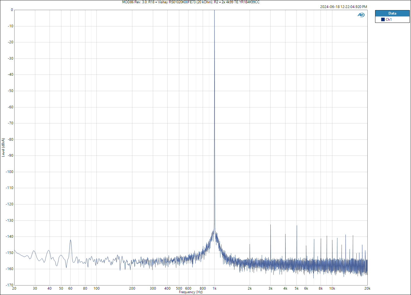

Now let's just try something different. This time a wirewound power resistor (Vishay RS01020K00FE73, 20 kΩ, ±1 %; 20 ppm/ºC, 10 W, $2.89/EA). This thing is a honking monster at 9.5 mm Ø x 45 mm length, so I had to mount it vertically.
And now back to the fancy (and expensive!!) resistors:

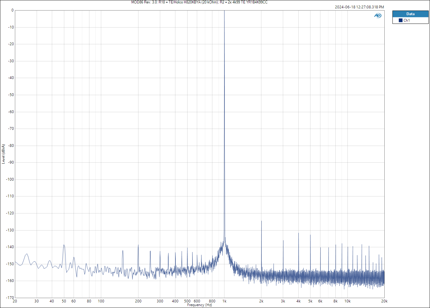

First up of the fancy resistors is the Holco (now TE) H820KBYA (20 kΩ, ±0.1 %, ±15 ppm/ºC, $1.75/EA):
.... and the Vishay PTF6520K000DZEB (20 kΩ, ±0.5 %, ±5 ppm/ºC, $4.79/EA):
Tom

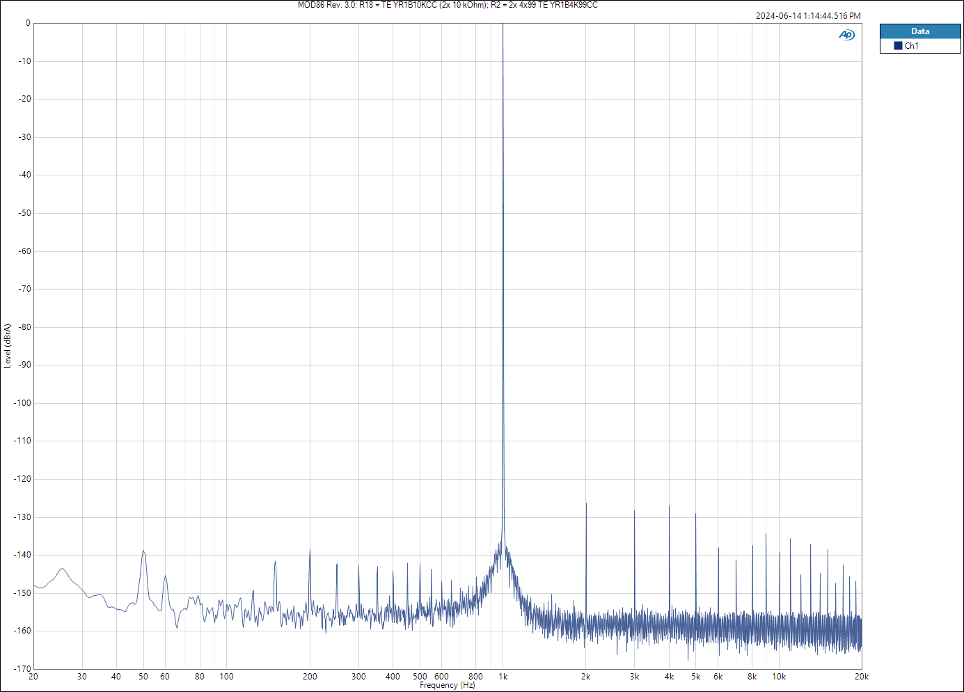

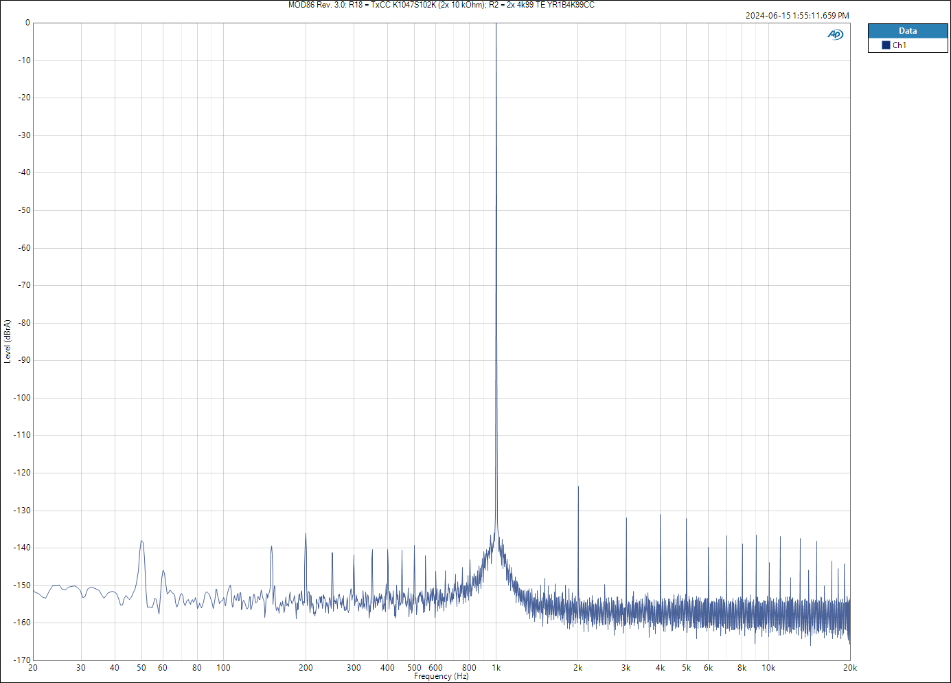

One wonders what happens if we spend even more to get even fancier resistors. More fancy, more better, right?
The fancy resistors tend to not be available in 20 kΩ, but they are often available in 10 kΩ. Two in series makes 20 kΩ. Yay! But now the dissipated power is also spread between two resistors, so that alone could provide a benefit. Lower self-heating -> less resistance shift through the signal swing -> lower distortion. So we need to compare against something.
All tests below use two identical resistors in series for the feedback network.
This is the THD with the TE YR1B10KCC (10 kΩ, ±0.1 %, ±15 ppm/ºC, $0.60/EA):

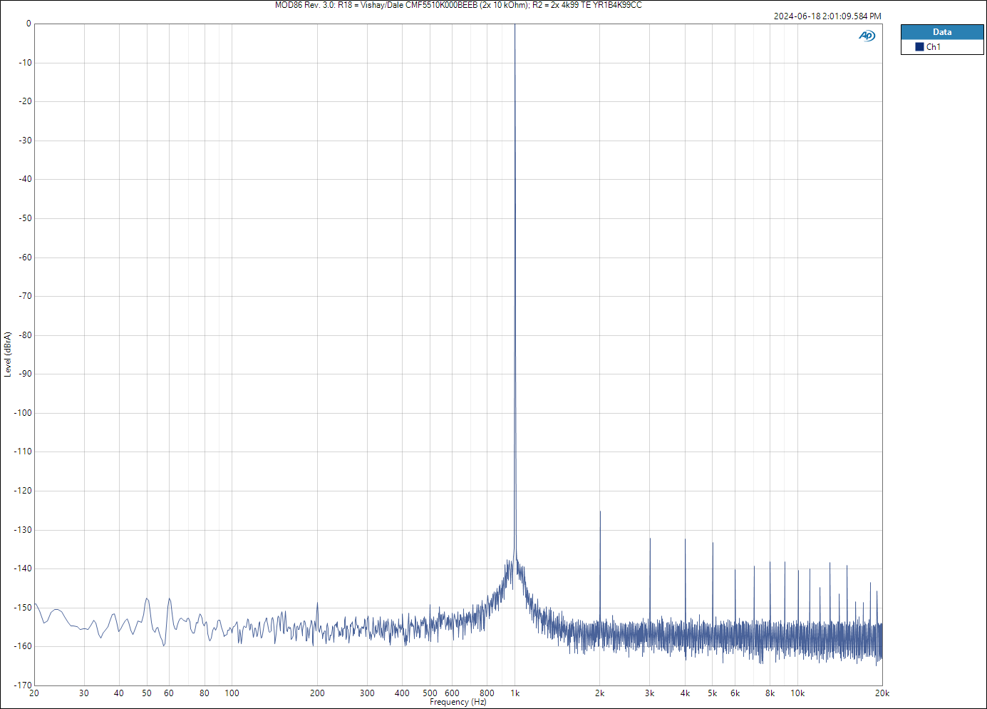

Now let's look at the Vishay/Dale CMF5510K000BEEB (10 kΩ, ±0.1 %, ±25 ppm ºC, $1.15/EA):
It's interesting to note that H3 is quite a bit lower than it was for the single 20 kΩ CMF55 that I posted a few days ago. More on that later.

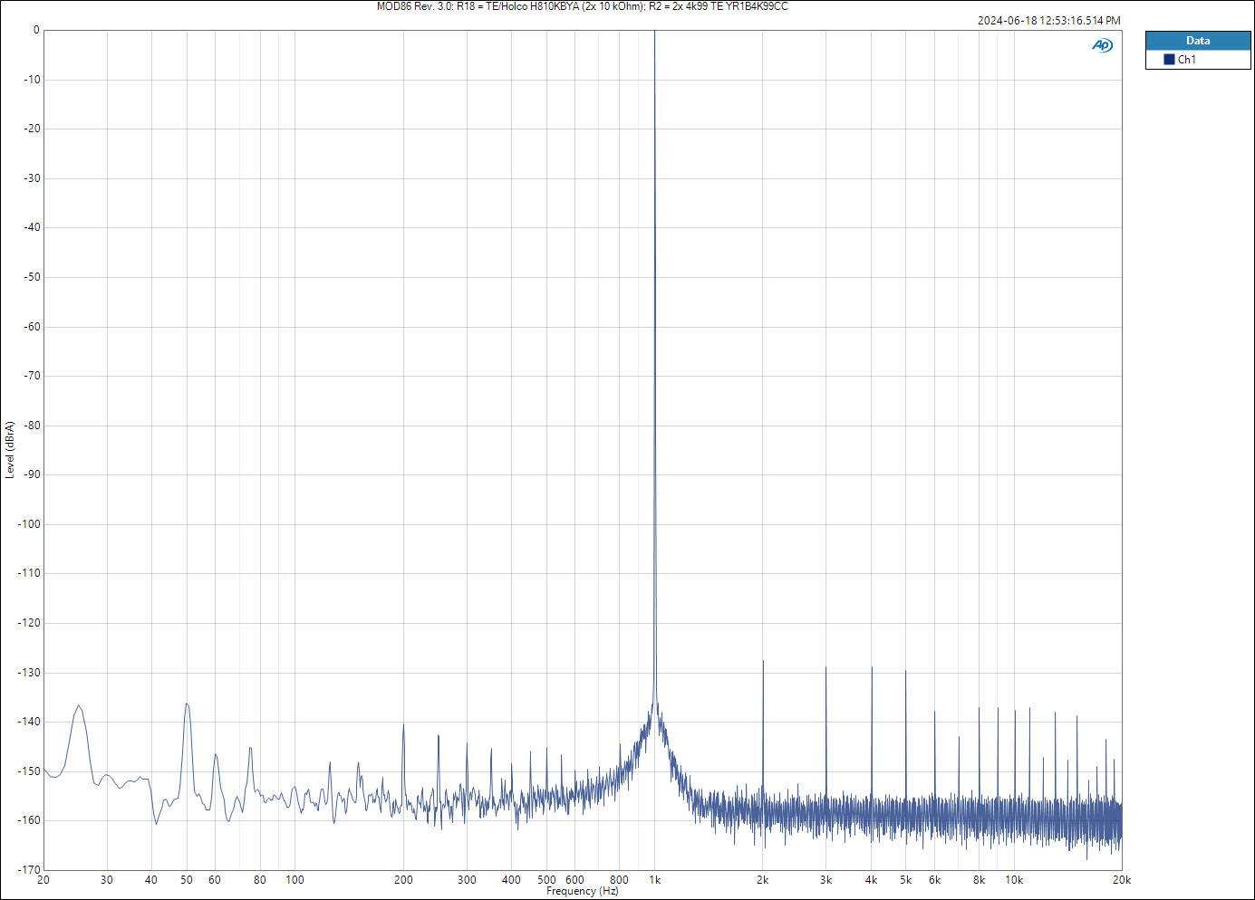

Next up is the Holco (now TE) H810KBYA (10 kΩ, ±0.1 %, ±15 ppm/ºC, $1.15/EA):

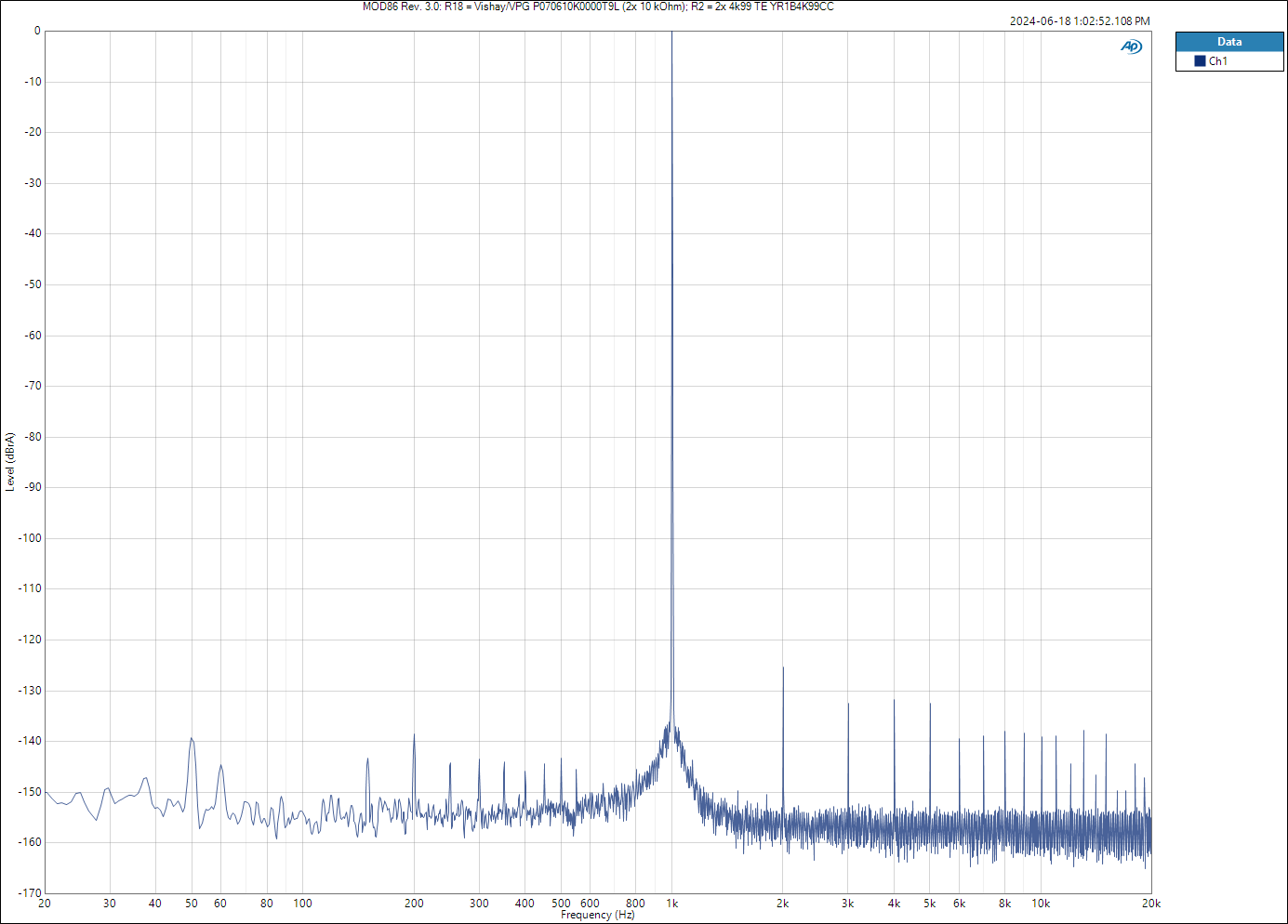

And now let's just throw stupid money at resistors:
Vishay (VPG) Y070610K0000T9L (10 kΩ, ±0.01 %, ±0.2 ppm/ºC, $15.68/EA). Sorry about the typo in the graph title. The correct part number is Y070610K0000T9L. These are the naked Z-foil. Fancy, fancy. Mucho dinero.
And in the collection of resistors that my friend provided me (see Post #6330), I was able to find two TxCC (= Vishay/VPG) 10 kΩ, ±0.01 %, probably ±2 ppm/C, price unknown:
Tom

Yep. I like the ISS for many reasons. I use it to control the power to the Connex supplies (which do benefit from a bit of extra soft start) and the Hypex supplies (which have their own soft start). I like the LED dimmers, low voltage control, etc.I don't see that as a problem, your ISS module covers that, and some....
That stood out to me immediately as well. I've measured at different frequencies and have repeated the measurement after measuring some other resistors (that did show the 25 Hz + harmonics). The effect is repeatable. The big fella doesn't show the 25 Hz + harmonics. It does show a tad more 60 Hz. That's not a shock. After all it adds quite an antenna in series with the feedback loop, so it should be more susceptible to 60 Hz induction.Wow, that big fella is doing well at multiples of 50hz.
I also note that H2 is quite a bit lower, which is intriguing.
I'm not rushing to recommend large wire wound resistors in the MOD86. If I ever find a, say, 1-2 W wire wound one I could see maybe doing that. But they're going the way of the dodo, so maybe not... There are some options in 1-2 W wire wound SMD resistors, though. They could maybe be interesting as an option in addition to the PTH resistors. Reidon S3-10KF1 (10 kΩ, ±1%, ±20 ppm/ºC, 3 W, $2.06/EA) could maybe be interesting.
I mentioned yesterday that the amp doesn't care about the absolute tolerance of the resistors. That's not entirely true. The amp itself doesn't care. The resistor sets the gain and so what if the gain is off by a picobell? But the resistor is also part of the differential receiver, so the absolute tolerance does play into the CMRR of the input. Tighter tolerance -> higher CMRR.
Tom

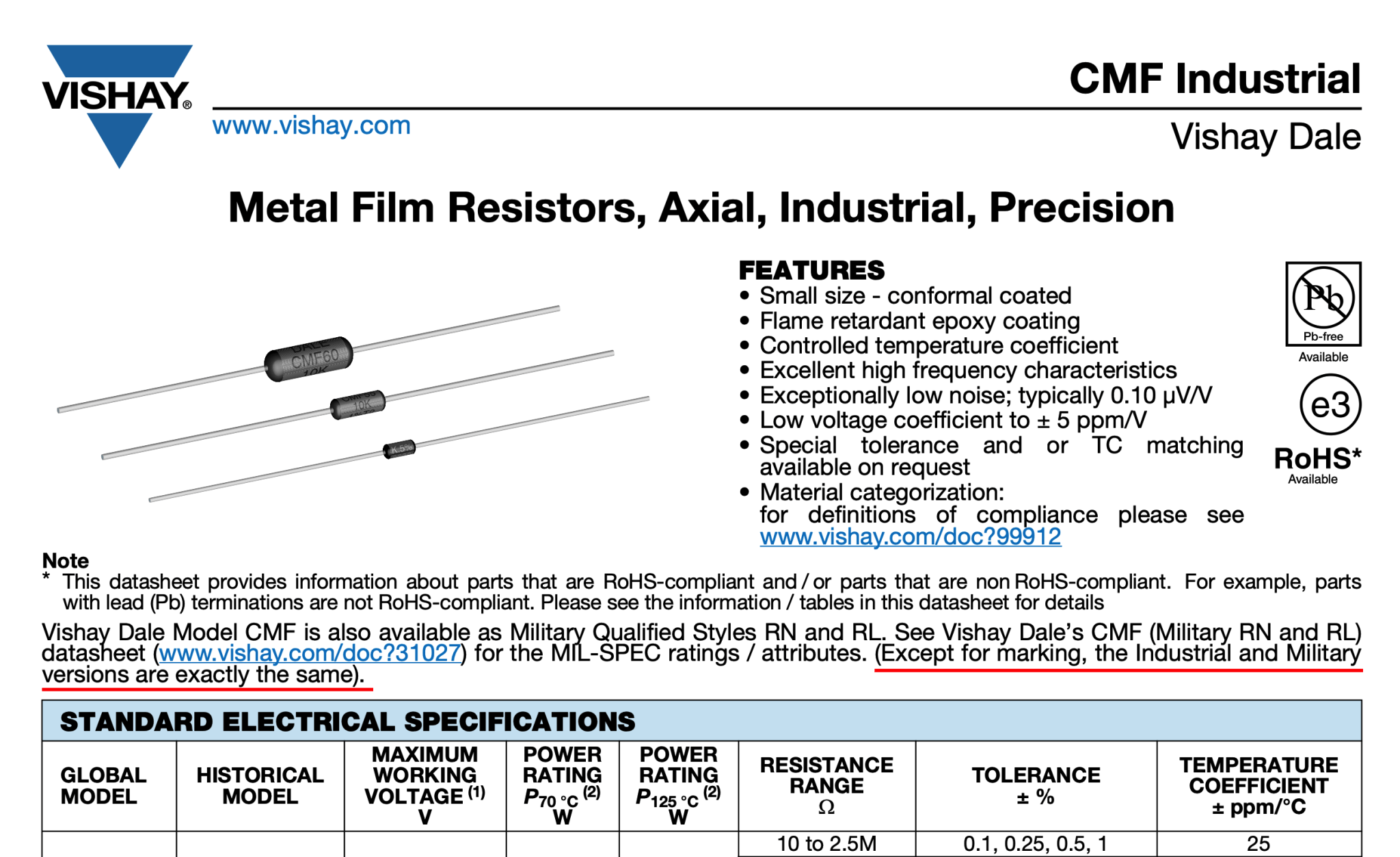

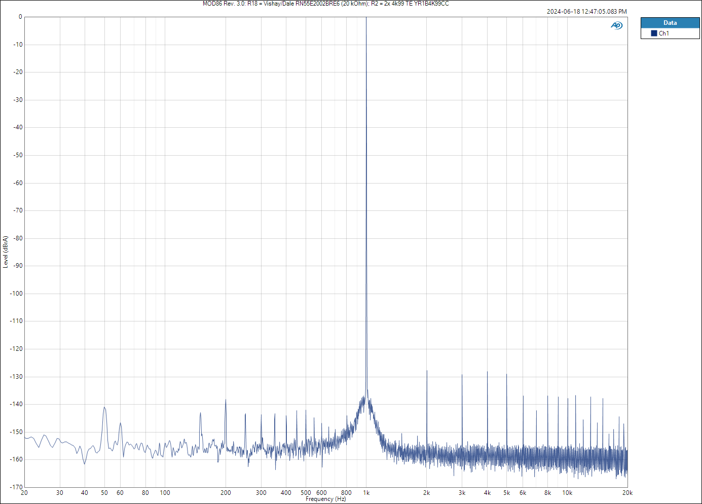

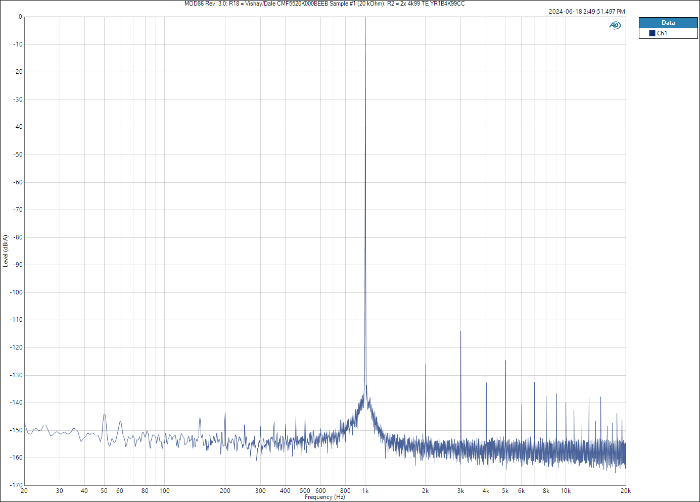

And, finally... Let's take a look at the Vishay/Dale CMF55 vs RN55.
I don't normally do requests, but Dario (@ClaveFremen) mentioned in a PM that he'd heard a difference between the CMF55 and the RN55. As you can probably imagine, I was pretty skeptical of that, especially given that the manufacturer states in the data sheet, a legally binding document, that the resistors are exactly the same except for the markings on them.
But I figured I'd give him the benefit of the doubt, so I threw in an RN55 with my most recent Digikey order.
Here's the performance with the RN55E2002BRE6 (20 kΩ, ±0.1 %; ±25 ppm/ºC, $0.87/EA)
Here's the CMF5520K000BEEB (20 kΩ, ±0.1 %, ±25 ppm/ºC, $0.64/EA):
It's pretty easy to conclude that the CMF55 is much worse than the RN55, which doesn't really jibe with the manufacturer's claim of the resistors being identical except for their markings.
I only ordered one RN55 so I don't know if I somehow got a golden unit. I did order a couple CMF55, so I measured two more of those:
These both measure about the same. H2 is a quite a bit higher for Sample #3 but none of them show the much higher H3 of Sample #1.
Vishay makes no promises about the distortion in their data sheet, so I guarantee you that distortion is not measured in production. I'm not aware of any resistor manufacturer that does specify distortion other than claiming that it is "low" (whatever that means) in their marketing materials. If Vishay says that the CMF and RN resistors are identical, then I will believe them. So that means the difference between Sample #1 and Samples #2 and #3 is part-to-part variation.
I haven't seen part-to-part variation that severe on any of the other resistors I tested. Is that because the other resistors are of higher quality? Or maybe I just got lucky with the others? Or maybe the one 'bad' CMF55 was just a single random flaw that happened to be exposed in my test? I don't know.
I do know that I'll stick to the TE YR1B-series because none of the other resistors provide any significant advantage. If anything, I could consider making the feedback network from two 10 kΩ in series instead of a single 20 kΩ. That approach does show a reliable advantage of a few dB on all harmonics. That's still a pretty small difference, though. If you already have a working Modulus-86 I wouldn't rush out and modify it.

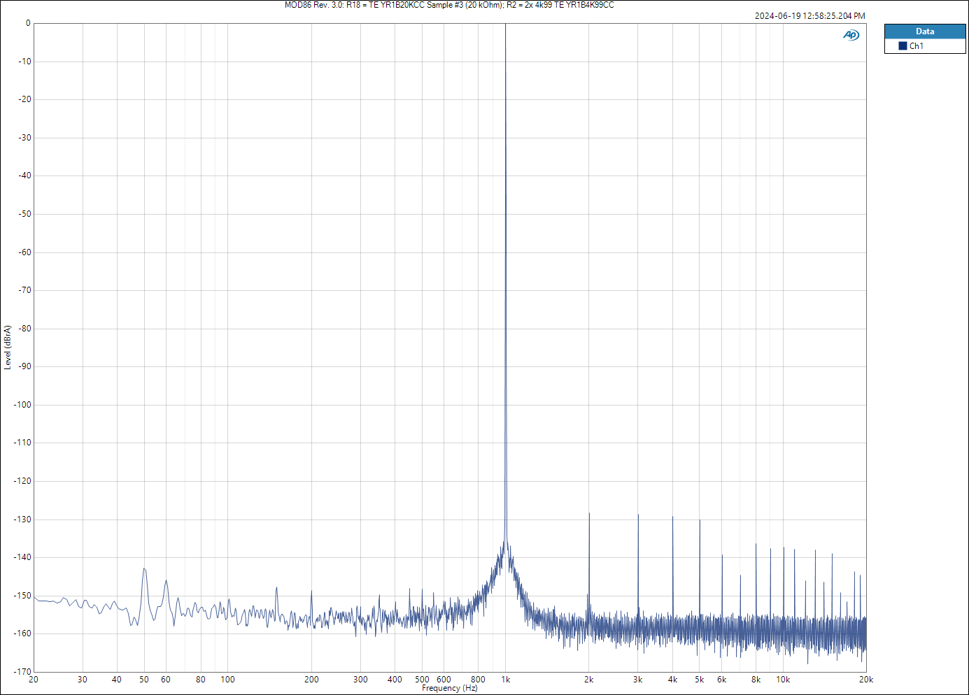

I bet it's sample-to-sample variability. The three parts were next to each other on the tape. The RN55 obviously came from a different tape. It performs about as well as CMF55 Sample #2.Looks like sample to sample variance or maybe there's some unknown peach magic at work!
Resistors are well understood by now. Not thereby said that they aren't complex or that there couldn't be a peach magic effect, but I doubt such an effect wouldn't have been exposed by now. Those further interested in the topic of resistors should peruse Sandman, Simon, & Szwarc, "Resistor Theory and Technology". It was published by SciTech Publishing in 2001. It's "only" 300+ pages. The authors are two guys from Vishay and a consultant.
Tom

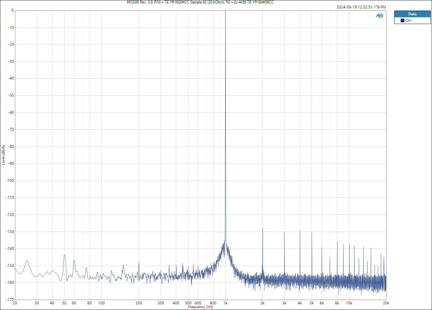

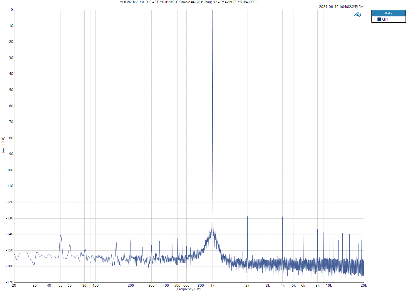

For completeness, I decided to take a look at the sample-to-sample variability for the TE YR1B20KCC (20 kΩ, ±0.1 %, ±15 ppm/ºC, $0.60/EA). Sample #1 you've seen before. Samples #2 through #4 were measured today.
Sample #2:
Sample #3:
Sample #4:
Interesting that I happened to pick the worst of the bunch on the first try with these as well. Oh, well...
Tom
