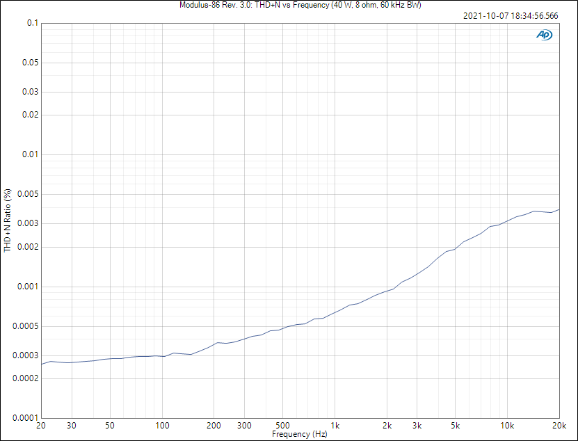

Great. Now go measure the distortion of a 100 uF, 35 V Nichicon MUSE UES-series when loaded by 2.2 kΩ, ±0.1 % metal film. Let me know what you find.
Here's the distortion of the Modulus-86, including the two Muse UES caps, at just below clipping levels. Let me know which part of this distortion curve you believe is from the capacitors.
Tom
Tom

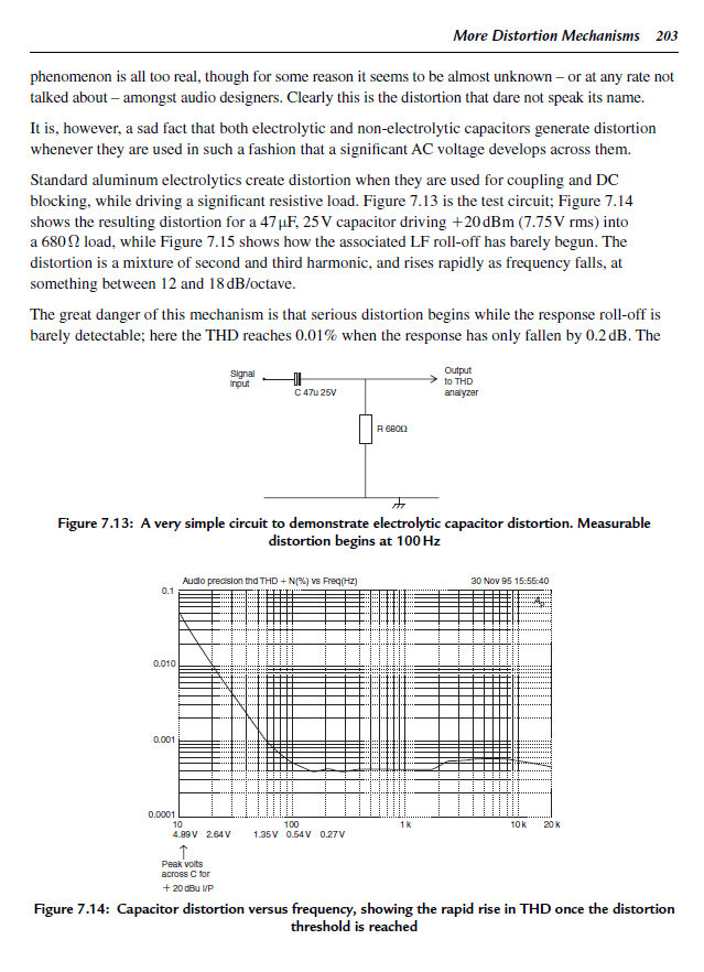

My reading of Self’s book is not “Do not use electrolytics in the signal path” it is “When you use an electrolytic in the signal path, ensure that it is sized such that there is always less than 80mv across the capacitor at the lowest frequency of interest.” Not following that advice means you would see a kick in distortion at low frequencies. There is no such kick in Tom’s distortion graph which means that Tom has done this correctly.
If you’re so hung up about it why don’t you design and market you’re own version?An electrolytic capacitor introduces distortion, this is a fact.
If the goal is to minimize distortion of the audio path, then electrical capacitors should be eliminated. This is the logic.
When you make the next version you can take this fact into account.
Except that the evidence suggests otherwise. Done right it isn’t a problem.But it’s better when there are no capacitors in the sound path

Bruce Hofer of Audio Precision fame has made similar observations.My reading of Self’s book is not “Do not use electrolytics in the signal path” it is “When you use an electrolytic in the signal path, ensure that it is sized such that there is always less than 80mv across the capacitor at the lowest frequency of interest.”
It's like many other things. A tool in skilled hands can produce great results. The same tool in unskilled hands can produce disaster.
Yep. Measurements don't lie.Not following that advice means you would see a kick in distortion at low frequencies. There is no such kick in Tom’s distortion graph which means that Tom has done this correctly.
