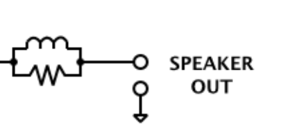

My speakers are all just full-range single drivers of relatively easy load, and I do not intend to own speakers with crossovers in the near future. Is the inductor/resistor combo needed? I assume they are included for stability reasons. I am more of less-is-more person. Thanks!
If you want the amp to remain stable with a reactive load, such as a speaker, I highly recommend that you keep the Thiele network (L||R) in place. It has no impact in the audio band, but great impact in the 0.5-10 MHz region that's important for stability with the LM3886.
