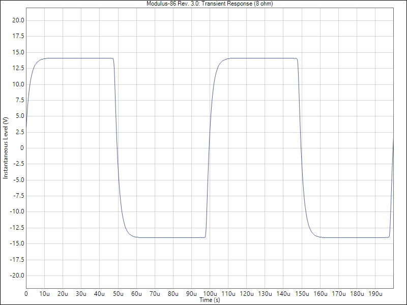

The LM3886 itself and any composite amplifier with the LM3886 will have some amount of rail sticking and occasionally a short-lived parasitic oscillation where it exits clipping. The clipping behaviour of the Modulus-86 is actually very clean for a composite amp. That's not just my opinion. Others have verified this and commented in this thread and/or the Modulus-86 Build Thread.
I've made the Modulus-86 as well-behaved as I can. It's stable even with 2.2 uF in parallel with 8 Ω and marginally stable with 4.7 uF || 8 Ω load.
Tom
Tom
Thank you the answer.This is a typical example of the large-signal transient response of the Modulus-86 Rev. 3.0. 10 kHz, square wave input. 8 Ω load. No signs of oscillation or instability here.
Tom

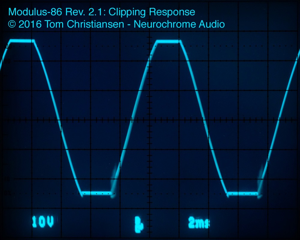

Ok, but the square wave not equal the clipping behaviour. Can you show me the modulus clipping level on a scope?
I don't have the plot handy for Rev. 3.0, but here's Rev. 2.1:
Note that the rail buzz is very low in amplitude, short-lived, and only show up with hard clipping. I'm hoping my builders have the savvy to turn the music down once it sounds distorted.
I would obviously rather be without the rail buzz and I spent considerable design effort reducing it. I'm trading off performance below clipping for performance during clipping. I hope we can agree that it's desirable to have an amp that has good performance below clipping.
Unfortunately I don't have access to the internal nodes in the LM3886 so I can't turn its protection circuits off. I suspect the SPiKe protection is what's causing the rail buzz. Either that or saturation in the VAS. I don't have access to that node either.
